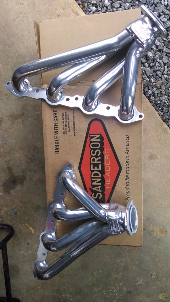

Sanderson ceramic coated shorty blockhuggers!!!

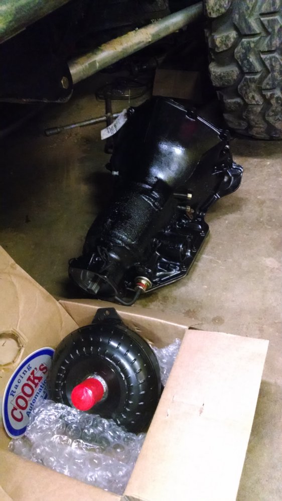

Should be picking up my tranny Wednesday.

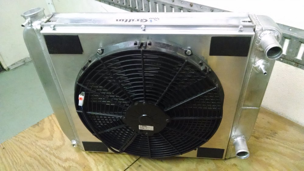

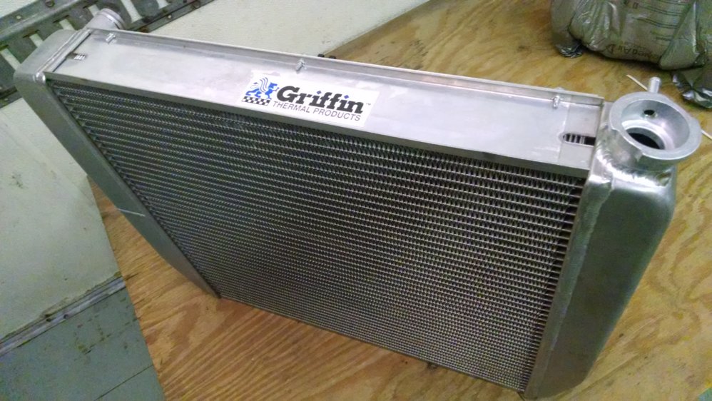

Here is what I got today. Thanks to Ryan at 4Wheel Parts. He's awesome!! Hopefully I won't have any cooling issues with this.

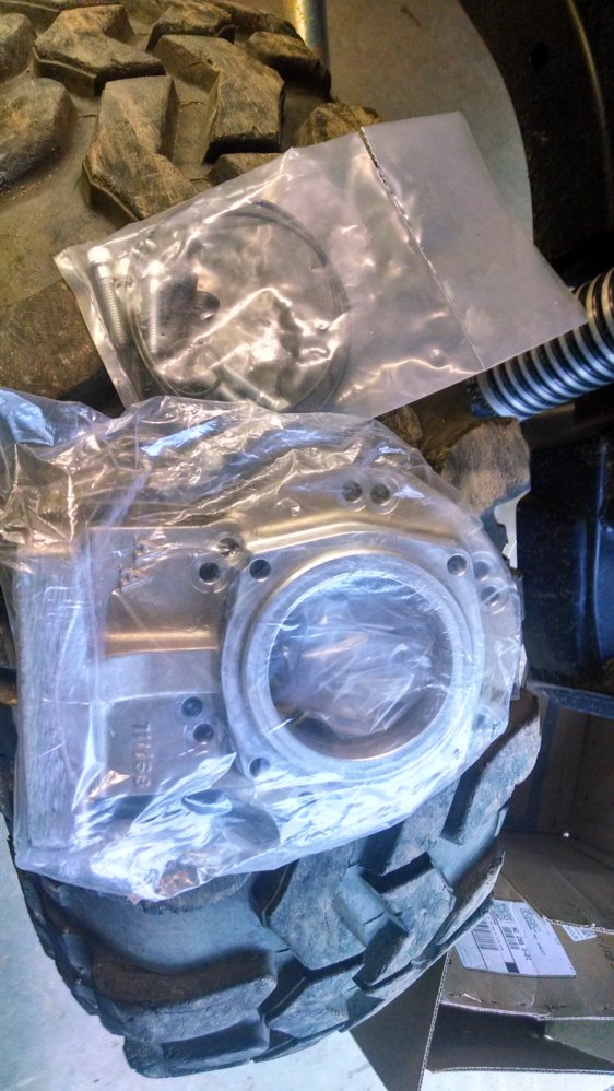

I also got my atlas adapter and 27 spline input for my atlas this week.

Today's additions! TH350 with 700r4 gears. Normal shift with upgraded valve body and shift kit.
Transmission Specialist 2600 stall with built in LS flywheel spacer.
Built by Cooks Racing in Cowpens,SC
