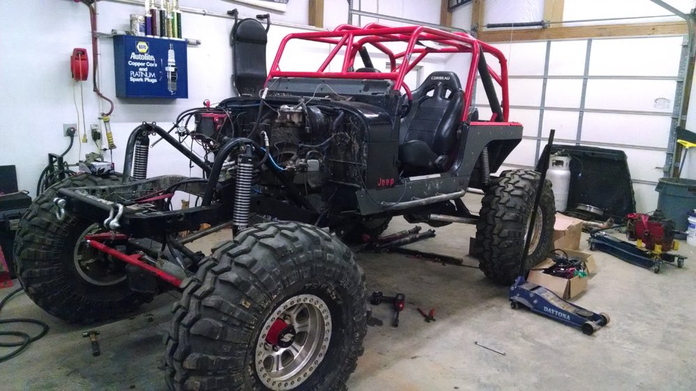

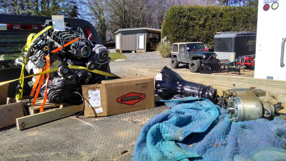

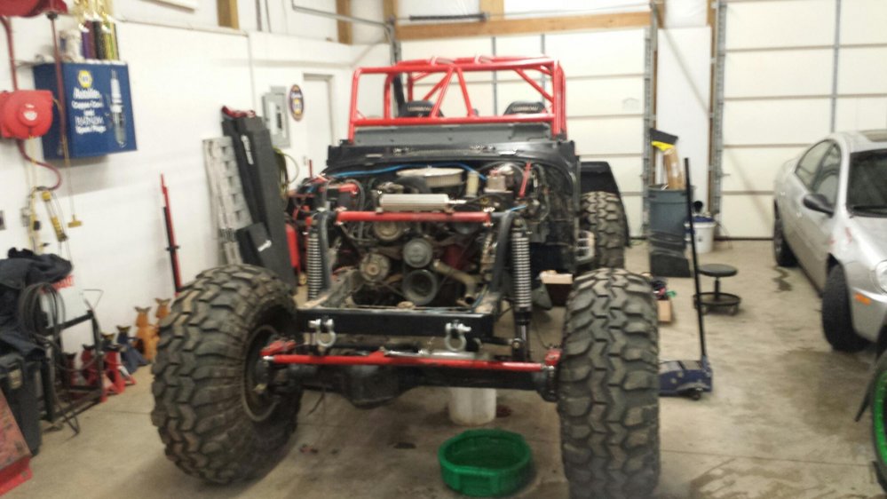

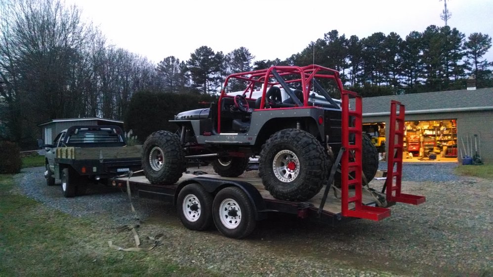

Well I loaded her up to take her and put her under the knife! Hated to take it with snow coming but the sooner its started the sooner its completed!! Should be a different jeep in a few weeks. Can't wait!

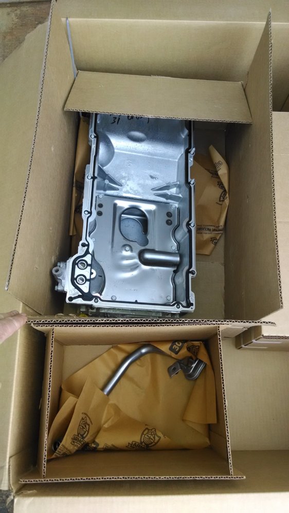

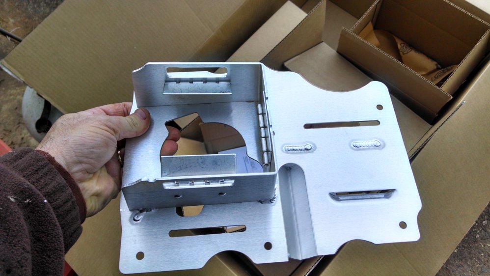

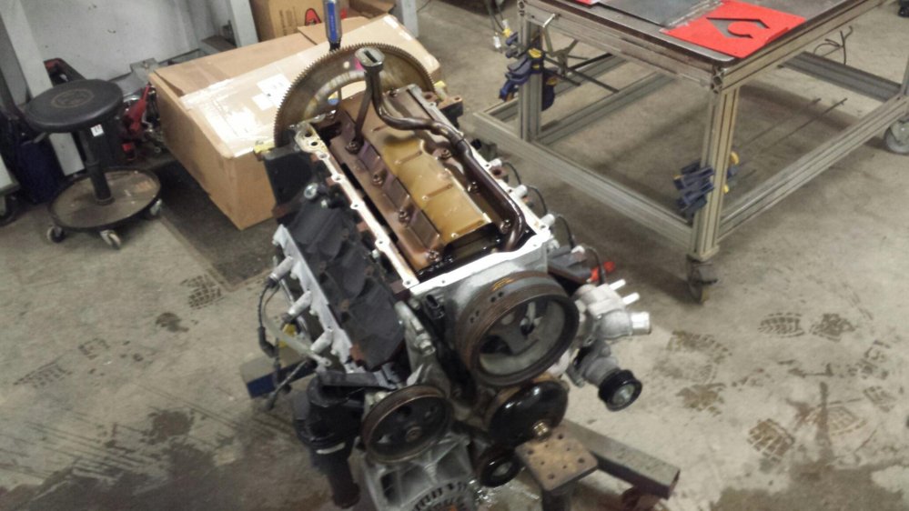

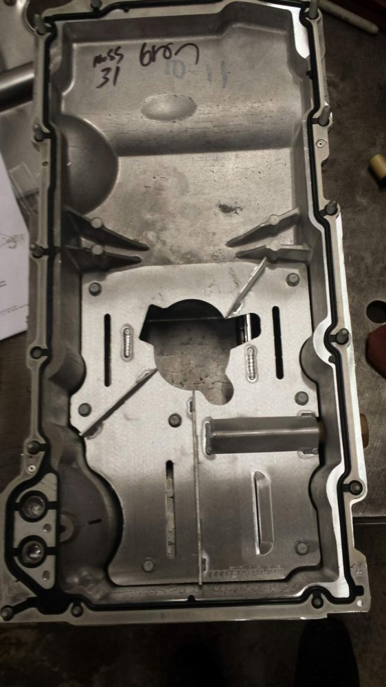

I ordered the wrong oil pan the first time so hopefully this one will be right. I went with the Improved Racing kit which included the trap door baffle. Sure hope it keeps the oil pressure up like I'm hoping.
Better than nothing, but looks a little gimmicky. Might not take much grit or crude to lock those hinges. But, that's what filters are suppose to handle.

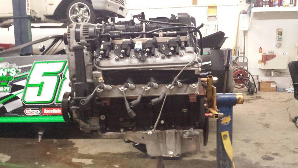

You gunna keep it DBW or swap over to a DBC throttle body?
Doing a VVT delete? I'm always worried about those lifters crapping out.
I had the AFM function on my mind, not VVT. My bad! I know they had lifter problems and oil consumption problems with some of the AFM engines, but that being a 6.0, it won't have it.
