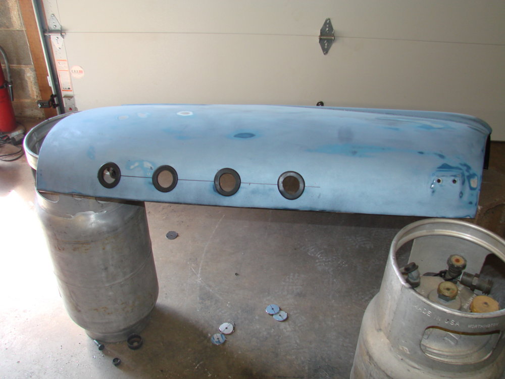

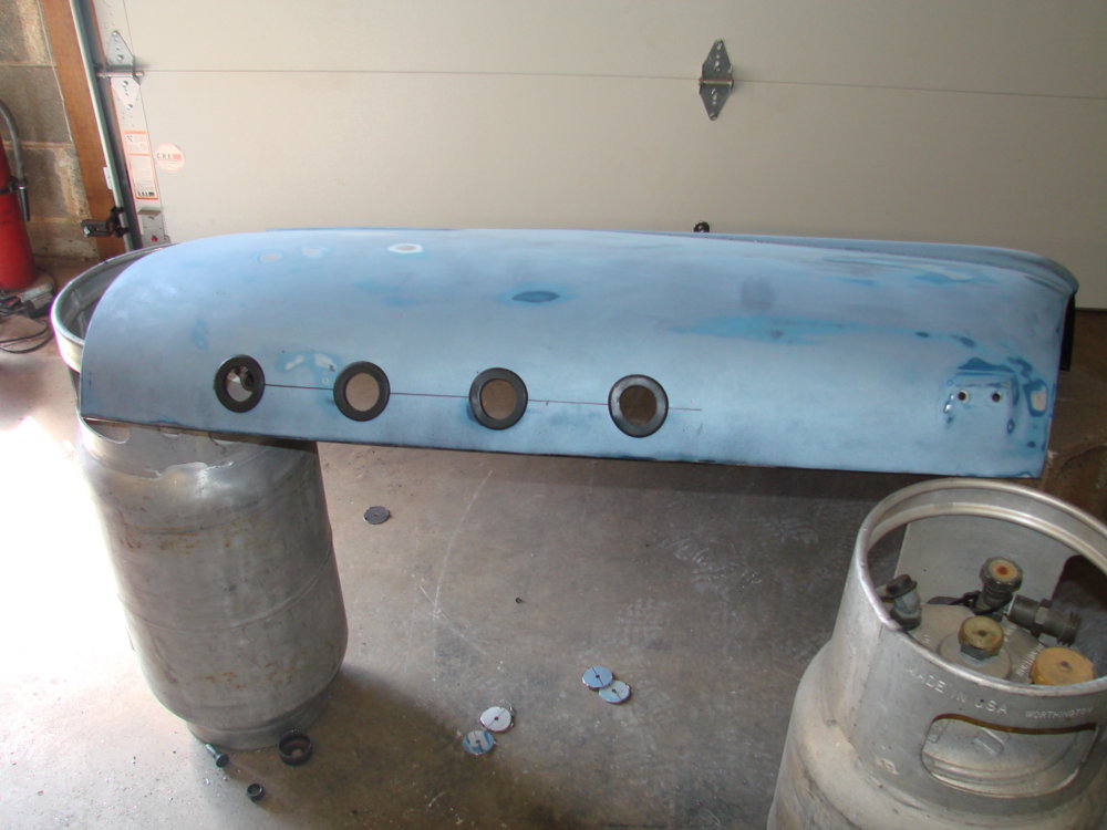

I drilled some holes in the hood mainly to help cool the engine but also for looks. I was going to do some hood louvers but just couldn't find any that I liked so I settled for just plain old holes.

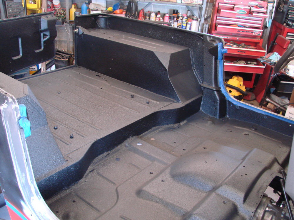

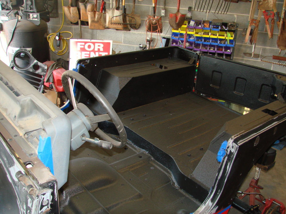

Next I did something to save alot of money. In a previous post I talked about getting a bedliner sprayed in but I just couldn't stand $800 to have it done so I bought a DIY kit. SEM is the name brand I used and it only costed me $120 and a lot of elbow grease. My buddy Rodcycle flew in with me and we sanded, cleaned, and taped everything up good in about two hours. And it only took about 10 minutes to spray it. I was very pleased with the way it turned out. It was super easy and layed in nice and even. I just hope it holds up good and doesn't start to peel.
View attachment 76853 View attachment 76854
Everything with in a 5-6 foot radius of the Jeep now has atleast one if not 100 black dots on it.

WHAT? No hydraulic hole puncher?:uzi:
Well I was going to dimple die it but was afraid w/ the contour of the sides of the hood that it wouldn't form right or may be even warp the hood. So really drilling holes was my only choice. I did use some rubber grommets I had laying around to outline the holes with. Just wish they were red.
