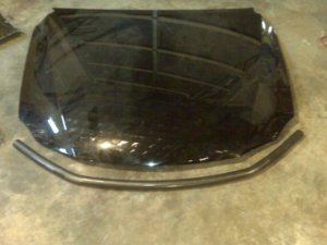

Got the hoodbar bent today.... It is rolled in the tube roller then bent to match the contour of the hood.....
