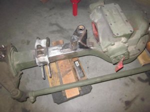

I got the rear mount for the steering ram welded up today. It still needs to be cleaned up a bit with the grinder. I beefed it up quite a bit. I plan on adding another gusset to the front Ram mount as well........

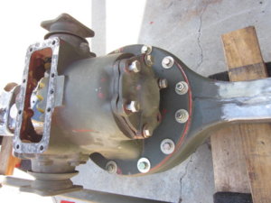

Finally, got the chunk turned 180 degrees, holes-drilled, tapped, and sealed.

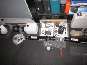

I have also been collecting hydraulic steering parts. I almost have everything I need for the front and rear steer. I still need lines, and a few other odds and ends.....

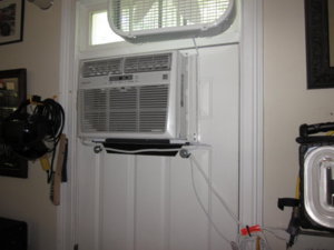

Got some motivation last week. I finally broke down and installed an AC unit in the garage, no excuses now? Right..... I also got a few other projects out of the way so I am back on the YOTA again.

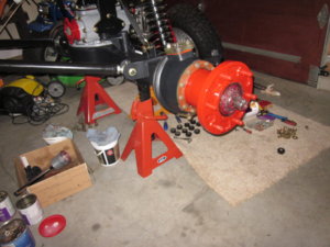

I assembled the Chunk, top hat, disc brake, and 4-link bars. I still need to replace the knuckle boots and paint the knuckles, hubs and a few other things.

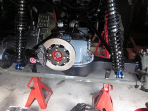

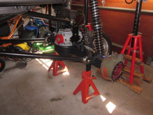

Here is my rear brake set up........ Now on to the hubs
I bought the pinion brake kit (brackets) on ebay a while back. The rotors I bought from summit and the callipers are 1986 Toyota Style Callipers that I bought from PEP Boys. I didn't want to spend a fortune on the brakes and these turned out nice. I really wanted Overson's Kit but just couldn't swing it.
Thanks, I've got the same (?) on My '79 Bronco with 53s on rocks (for sale on here). Caliper is clocked different. I was just trying to ID the rotor and rotor bracket. I like that set-up.
Awesome Build you got going on there!!!
Thanks! My set up is clockable. If you need a part number on the rotor, caliper, or specifics on the brake kit itself let me know and I will dig them up.

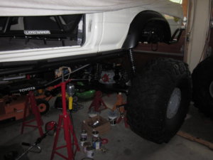

Got a little done on the 4th before heading out for work. I got the rear driver-side boot, hub and wheel installed........

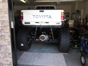

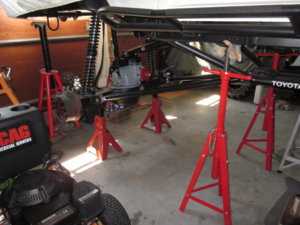

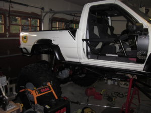

The truck is back on all four wheels finally..... I adjusted the suspension a little this weekend. I still have a few adjustments to make but so far, so good.
This is not the first time someone has asked me that.......... You reminded me to add some more info. I measured the truck yesturday. It is 100 inches wide 8'5". It measures 8'2" tall. My garage door is approx 108 inches wide and 8ft tall. I hope that if I let a little air out of the tires I will be able to sqeeze out. Also the rear steer should help get the truck lined up to get through the door a little easier. I guess we will see..... I am like the crazy old man that builds the sail boat in the basement and then has to take the house apart to get the sail boat out.....
I got some 32's we can put on to get you out. lol
