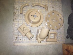

I sandblasted and painted the first batch of parts (painted everything Cummins beige of course). I also got a surprise from UPS yesturday (An Aluminum radiator).........

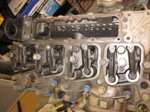

I ended up finding some time last night and early this morning to get a little more work done.

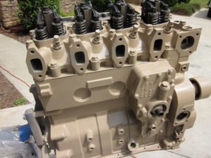

I have continued to pull parts off the engine to paint. I am also replacing several seals as well. The engine was rebuilt a few years ago so I figure I might as well freshen it up a bit while I'm at it.

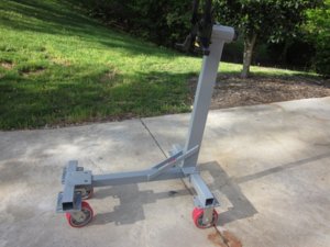

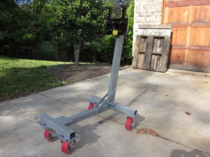

Lastly, I rebuilt my engine stand. It should be a lot stronger now. The weight of the Cummins put a hurtin on it the first go round. I cut up the blue truck stand that I am no longer needing and came up with this......

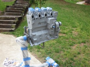

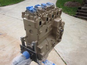

Sandblasted, primed and waiting. I hope the UPS guy brings my OEM Cummins paint today!!!!

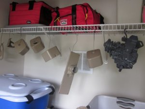

WOW, I have never seen anybody hang there injection pump, valve covers, and Marlboro bag on the same race before! Haha
Looks good.

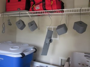

:lol:I use my laundry room as a place to let my painted items dry. My wife loves it. Also my 49" inch Irocs are currently in our family room to make more room in the garage.

Not gettin a lot done this week. I don't have any days off at work this week. I am gettin done as much as I can in the AM. I did clean up the engine, primed it, and painted it. Going to try to get a few more things done so I can start putting the motor back together soon.....

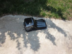

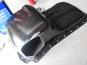

I also cut a corner off the oil pan to make room for my upper link bar....

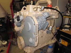

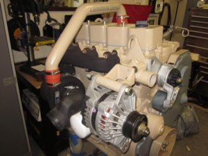

I started picking up the pace a little bit. I almost have the engine put back together. Still waiting on a few parts from Cummins.
I also welded up the hole I cut on the driver side of the oil pan. I needed a little more clearence and this should do the trick.

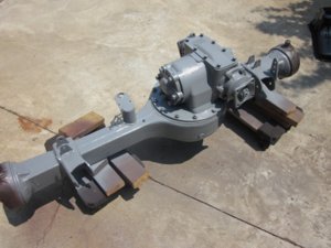

Finally, I took apart my front Rockwell Axle and Painted it. Now I just need to put it back together and replace a few seals along the way....
