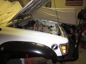

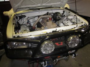

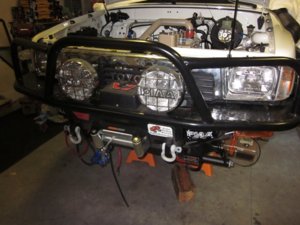

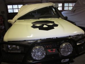

It is getting too hot outside!.......I did manage to get a lot done the last few days anyway. I got the engine put back in. I also installed the front bumper and added two more lights to the underside of the bumper. Lastly I added some art work to the hood. Next week I plan on putting in the C6. Not looking forword to that.

Snorkle
Also, I put the air filter on the top of the snorkle. I plan on re-plumbing this set up soon. This will be much nicer than before.

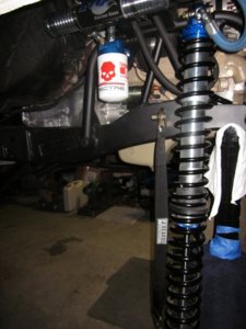

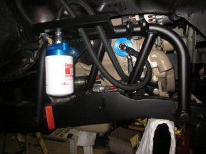

Oil Filter relocation
I had to relocate the oil filter. I am using an over-sized alternator and there was no room for the filter. I welded a steel plate to the shock hoop and came up with this......

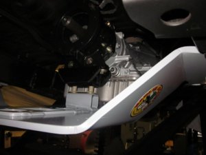

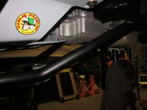

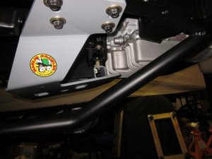

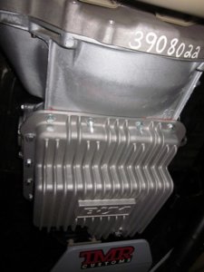

C-6
I got the tranny installed be myself, with the help of a sissor lift table. I also installed a larger oil pan. Next week I plan to hook up an oil cooler with a built in fan. I want to keep this thing runnin as cool as possible....

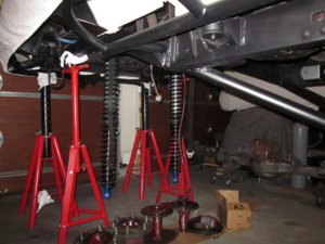

Springs
I hung the coilovers and limiting straps......... I still need to finish up the axles so I can get the suspension back together.

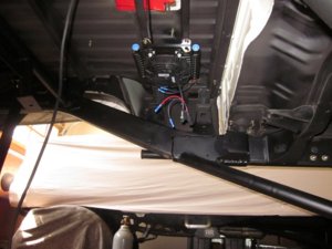

Trans Cooler

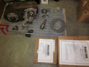

Got a little bit done this morning. I mounted the tranny cooler and started digging out everything I need for the D300 rebuild.
Dana 300 upgrades:
Advanced Adaptors clockable adaptor kit
32 spline out put shaft with heavy duty tail housing
32 spline in put shaft
Twin sticks
New seals, etc....

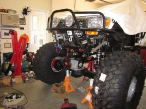

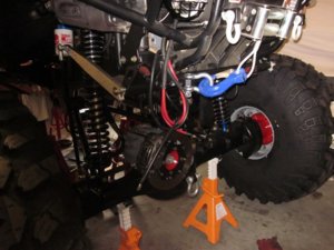

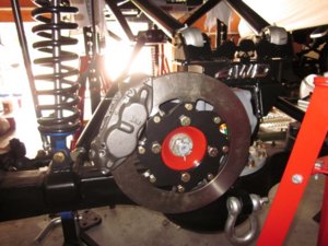

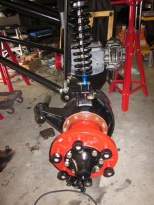

Front End Rebuild
I got the front axle put back together. I replaced the knuckle boots, the flange gaskets and siliconed everything up. I also finished painting the axle.......... The front end is ready to roll. Now on to the back....:rolleyes:

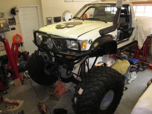

Poser shot
I made a few adjustments on the front end. I think I got both front wheels pointing fairly straight ahead. Here is another pic of the front of the truck......
