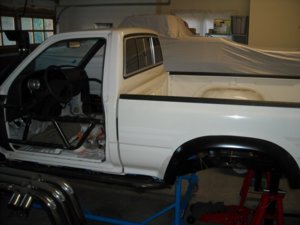

Toyota Truck Rolling Stand
I am finally finished with my XJ, so I decided it was about time to get back on my Toyota Project.
I mentioned before that I almost rolled my truck over in my garage. After that incident I decided that moving the truck on dollys was not a good idea.
I found some heavy duty furniture moving wheels on ebay for 39 dollars. I used some scrap steel that was taking up space in my garage and created a custom dolly.
I also found some blue paint that I knew I would never use and created this masterpiece.
The plan is to be able to roll the truck outside. I need to finish up the frame and engine mounts and then paint everthing flat black.
I also need to wash the truck and lay down some decals on the body before I put the truck up in the air again....

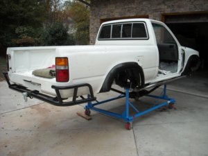

Toyota Progress

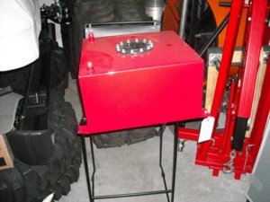

I have had this truck for 18 years and it has seen many changes. Will at 4wheel parts has been getting on me about removing the roll bar. It really does not go with the current state of the truck so I decided to remove the roll bar and everything in the bed. I plan on welding up the holes then lay down some bed liner paint. Also, I will mount the gas tank and power tank in the bed and that will probably be it. I will also put the tail gate back on.

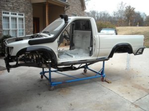

Toy Roller
My dolly works. I was a little nervous about trying this but I think the dolly is way over built which is good. It rolls really well. I was able to roll it out side, turn the truck around and roll it back in with ease. I ordered my paint yesturday for the frame. I still need to smooth out the frame in places and weld in my motor mounts before I can begin painting.

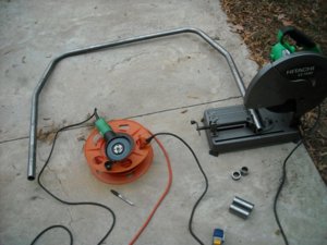

Roll Cage
I bought a Marlin Crawler Roll Cage about a year ago. I decided to start on the cage tonight. The main hoop turned out to be about 5 inches to long so I made some adjustments..... I am sure many more adjustments wil be needed. I plan on tacking everything in place, then removing the cage to finish welding it up.

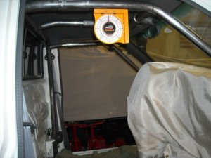

Roll Cage
I got the roll cage tacked in place today. It is not as close to the roof as I would like. I wanted to clear my grab handle on the passenger side. I think it will look better when I rap it in some foam padding, the cage should look closer to the roof then. I think the cage turned out well over all. I still need to weld in my gussets and finish welding it together after I pull it back out of the truck.
