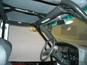

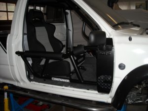

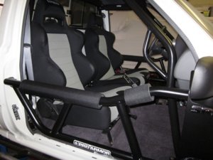

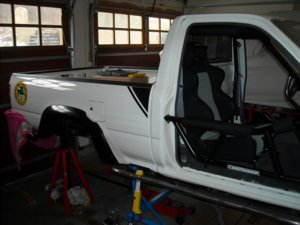

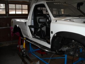

I got the carpet in and cut the holes that were needed for the role cage. I then put the roll cage in as well. I got both seat brackets installed. I put in the passenger seat and tube door. I still need to finish up the driver's side. I am getting there.
Last week I finished removing the old pin stripping. I then put a few decals of my own on the truck. I also installed WADE bedrail caps.

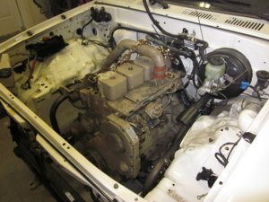

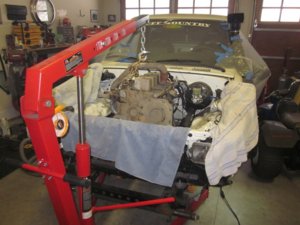

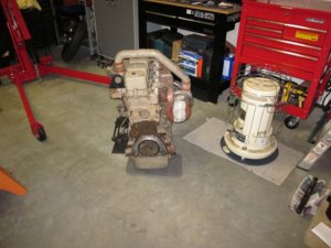

I installed the driver seat and tube door yesturday morning. I also purchased the bolts I needed to install the motor mount brackets to the motor. I am about ready to drop this thing in.....

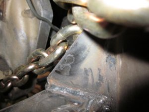

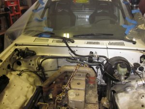

Cummins Install!
I got the motor mounts in this morning. The engine fits up nicely with plenty of room to spare.....

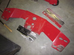

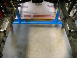

I got a little more work done today. I modified my BudBuilt Cross Member/Skidplate to mount to the C-6. I cut the front of the skidplate about half way through with a cut off wheel. Hammered it out close to straight and welded it back up. I welded a transmission mount and also cut the back of the skid plate off. It turned out an easier job than I originally anticipated. I still need to relocate the rear shock mounts and make a few minor adjustments. After that, I should be ready to paint the frame.

Finished welding up the front end, hoops, etc..... I also added gussets behind the hoops. I am currently jacking the truck back up on jack stands. I wish I had a lift about now. I decided to fit everything back up before painting. With the bigger tires, a few changes are probably on the way. I also decided to add bump stops to limit up travel. I want to keep the truck as low as possible and I don't want to tear off a fender as the suspension flexes. More pics coming soon......

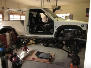

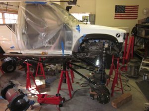

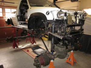

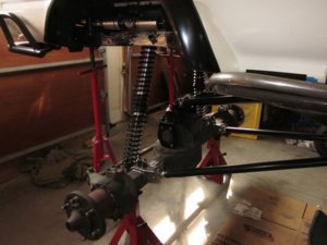

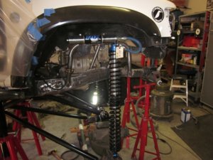

I got the front end together yesturday. Things don't want to fit back together as they should, but I did get it done! I also made some brackets out of some steel tube to mount the shock reseviors. I think they turned out well. Now on to the rear of the truck. I am relocating the shock mounts in the rear to bring the truck down some. Pics on that coming soon....
I got the suspension back together. I still have a few minor bugs to work out. Also installed the front sway bar links. The connecting rods are too short so I will have to find some longer threaded rods. The front upper link bars will have to be spread apart at the top hat. The engine oil pan is making contact with them. I will have to make another top hat. I ordered what I needed from Ballistic Fab yesturday.
