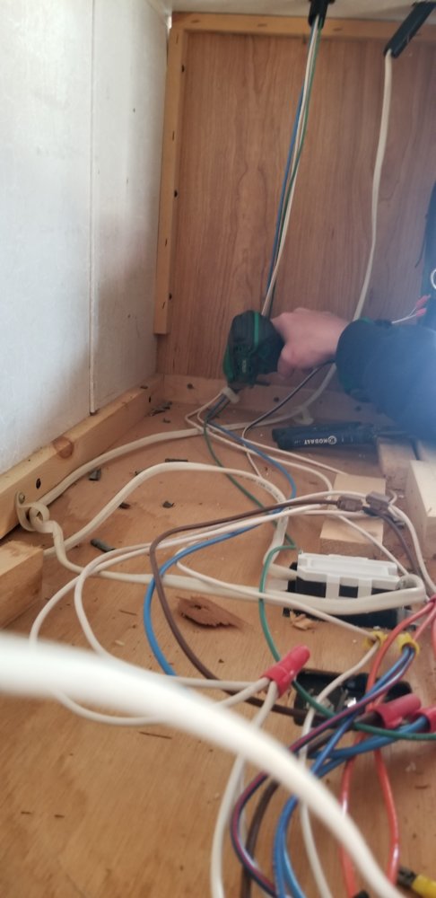

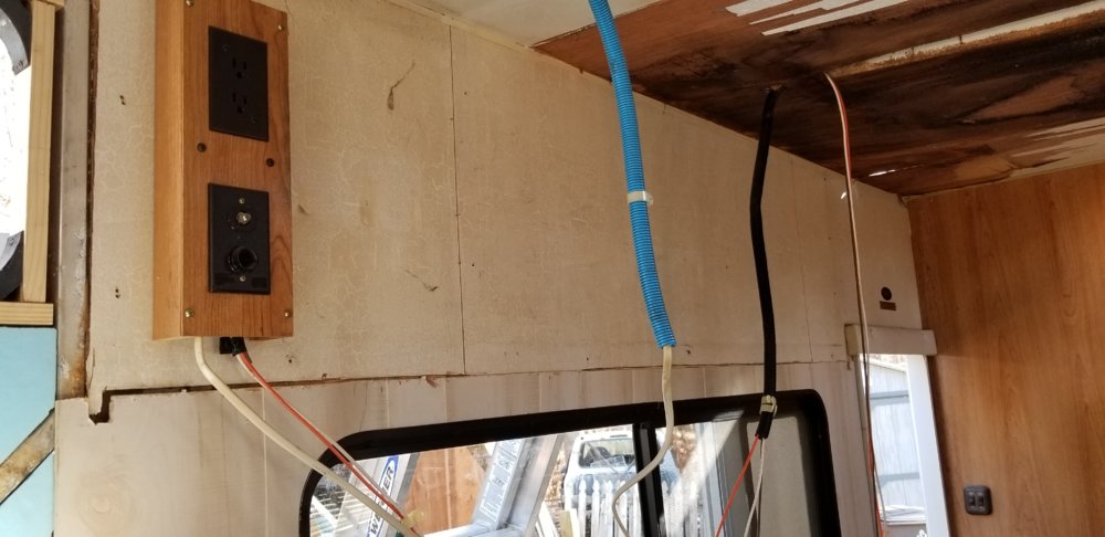

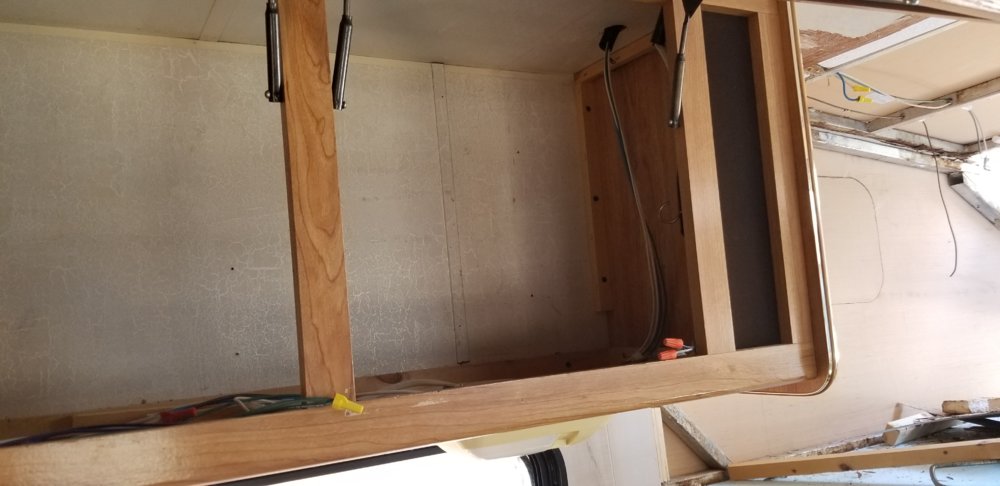

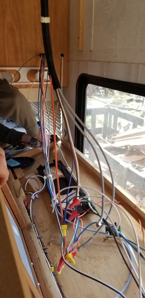

Somewhere in the mix, I decided to take down the upper cabinates. The walls are not rotted, but the ceiling is in rough shape, and removing the cabinets is the best way to go. Aaargh!
The factory hid the wires inside the cabinets nicely. Although...I'm not quite sure the factory used these wire connectors, or if this is work from either previous owners
With the cabinets out of the way, I can get to all of the ceiling edges. This will make it simpler to install the new ceilings.

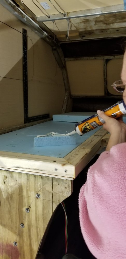

Next...and before you ask...YES, I jump around on different parts of this job all the time. FOCUS...easier said than done, especially when I have good helpers on the clock. So for now, while they're working on back bedroom, I'll get back to refoaming the front.

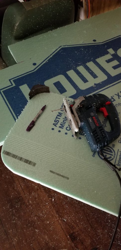

The square pieces are easy. Measure cut glue.
But that window has been deleted. I want to make this foam in 1 peice... it has round corners...ahhhhhh. length.. width...and round corner things! I'm glad I saved these from another deleted window.
Here it is. New foam Lt. Dan.. you got new foam!

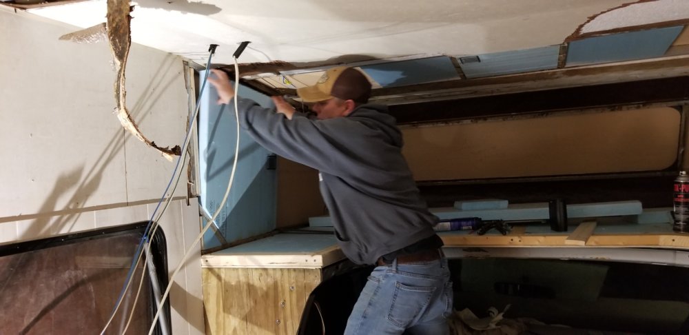

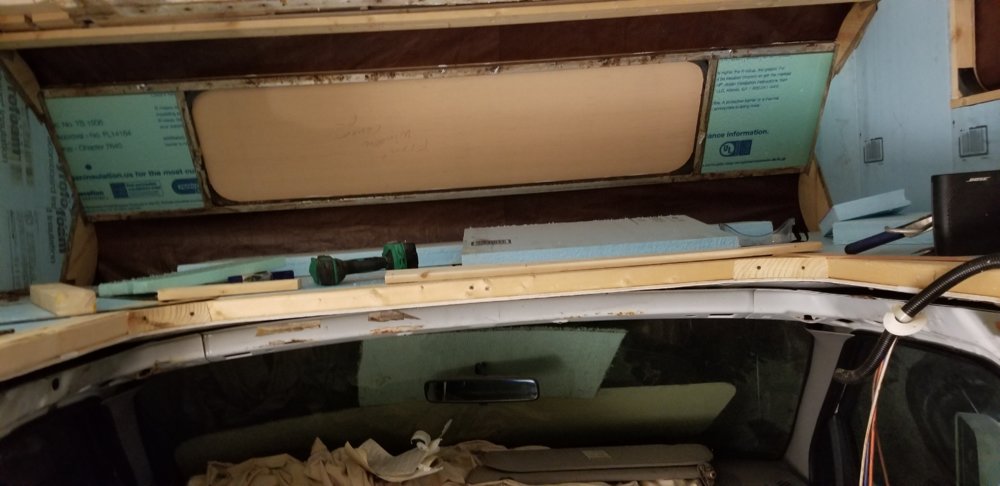

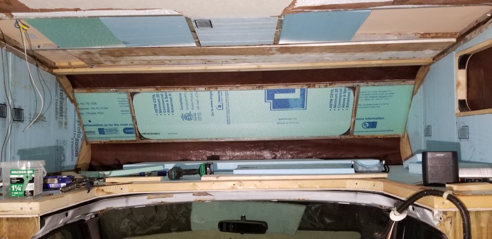

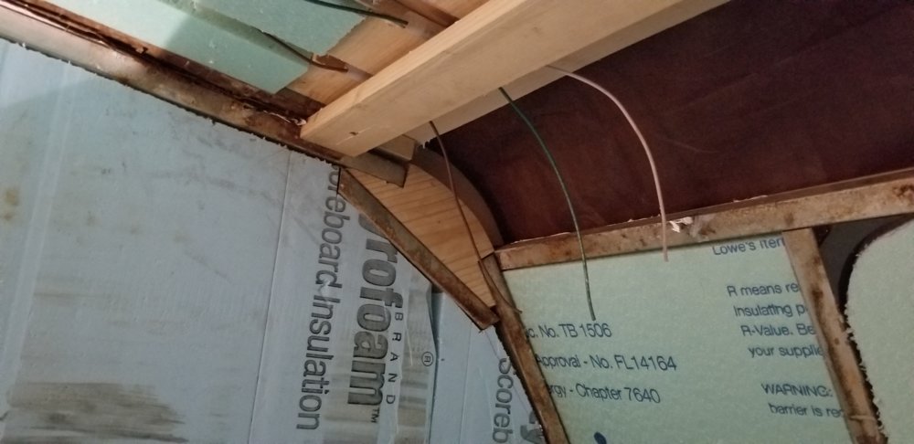

and.. as @WARRIORWELDING mentioned just a couple posts ago.. You can see, the ceilings...I have started replacing foam in between rafters. Using the technique of 2" in the middle at highest peaks, then 1 1/2 then 1" on the edges Its all I could come up with. That'll do!
Had to leave a couple gaps in the foam to run my wires. Hindsight, I could have done this a bit nicer, but I'm getting tired. It'll do.

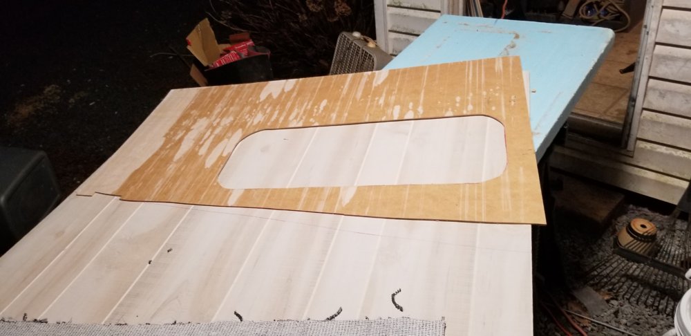

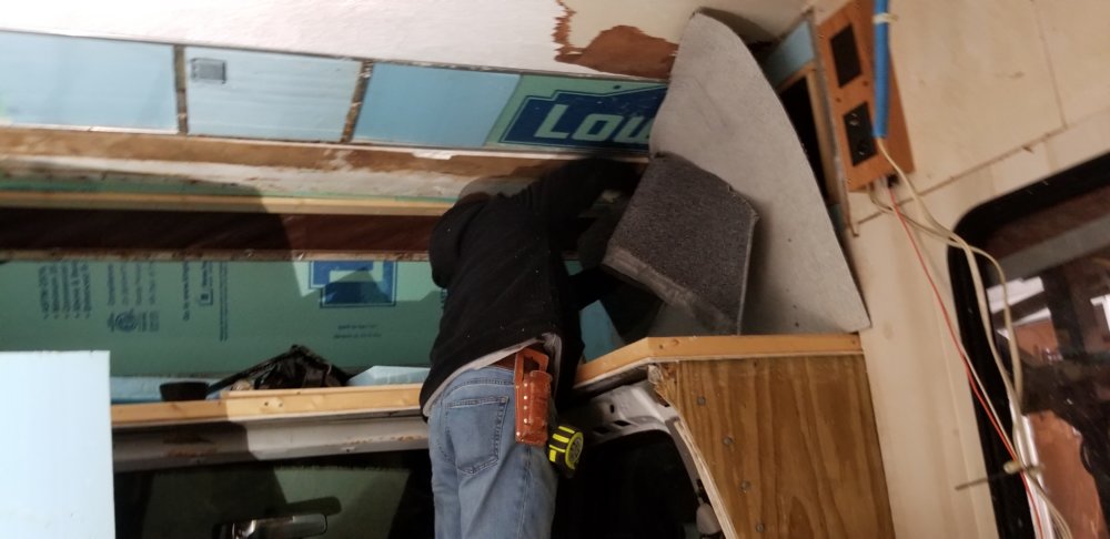

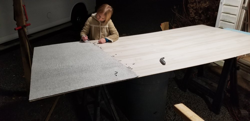

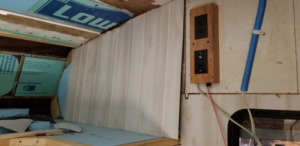

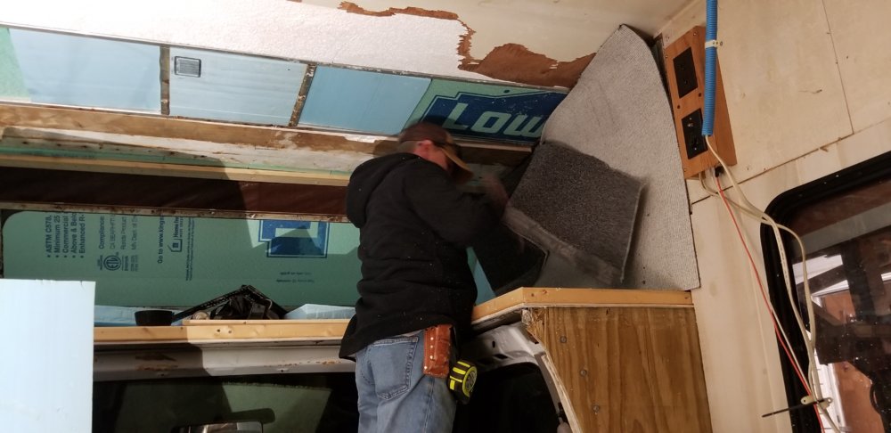

Now that Ella's bedroom foam is finished, it's time to add new paneling to her walls. It's a tight spot, and the roof line tapers down.
I figure I'll need a pattern of some sort.
I cut off a section of commercial carpet and started whittling it down into the proper size.
Then..I simply lined the pattern up with my paneling and let Ella do some work. With a sharpie in hand, and strict instructions to trace carefully, she was happy to help.

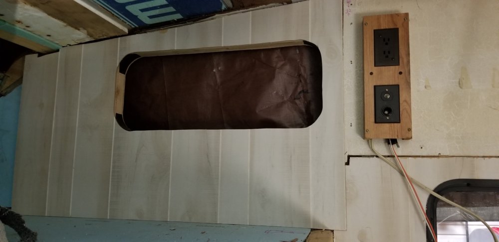

Looks like it'll fit..now it's time to trace out the window hole and cut it out.
Yeah! That's it!
For the other side, I simply used the first side, flipped it over and traced it onto the second pc. Both side walls are up. That's 2 less things!

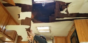

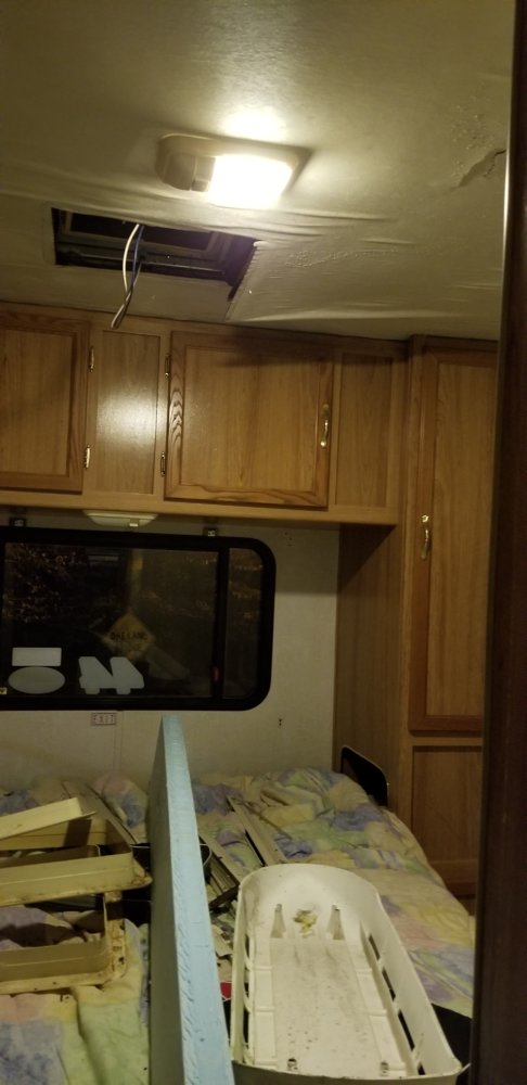

Looks like the entire ceiling needs to go! And I'll bet Brooke will be happy if I remove the mattress and bedding before I start.
I guess I failed to take better before pics..but the bedroom walls around the windows look like the front walls did. I'm thinking they'll need the same rebuild treatment as the front walls. Well _$#!÷!

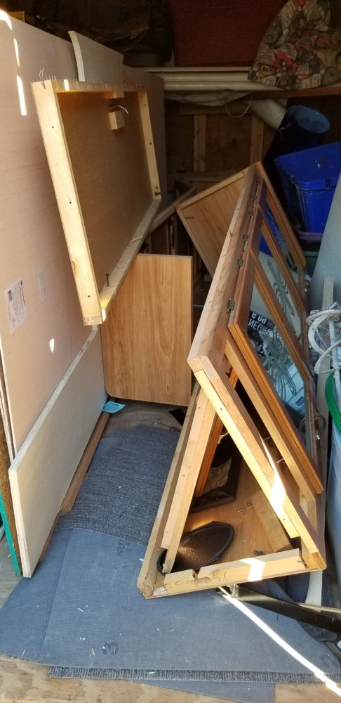

Ive stored the cabinates in the building. I have not decided if I will reuse or build new..probably a mixture of both. Theres really not much to them, but then again, they dont need to be built to strongly.

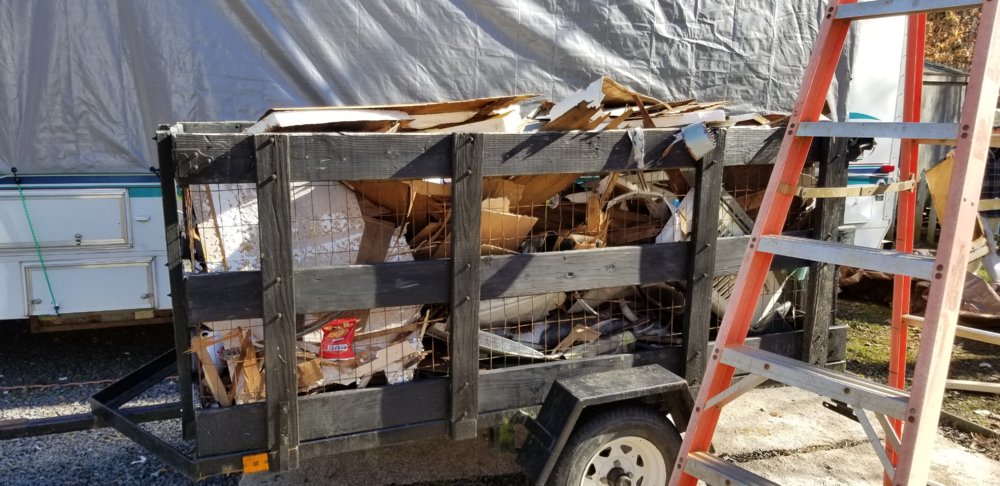

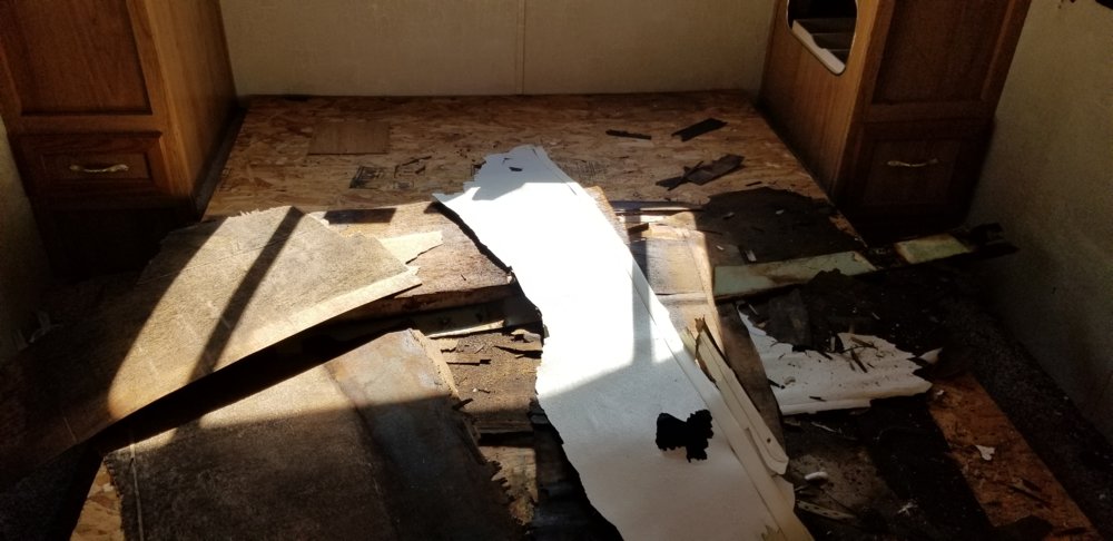

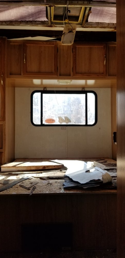

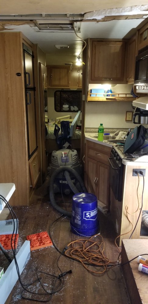

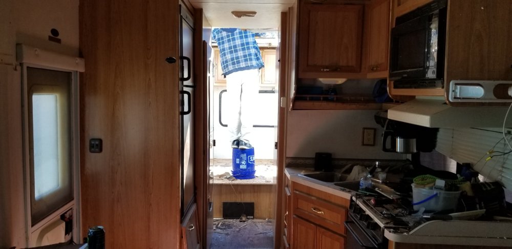

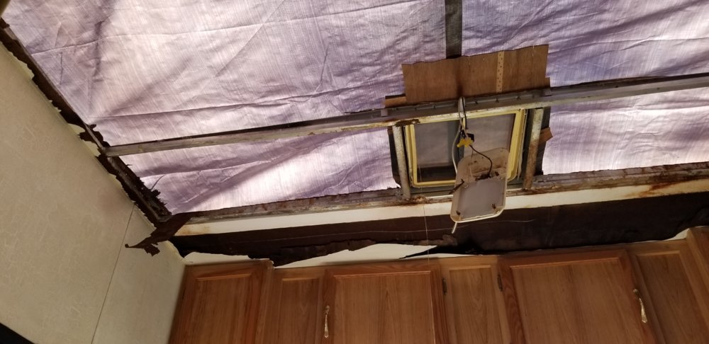

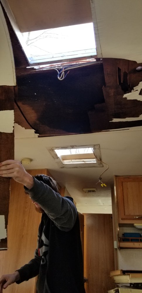

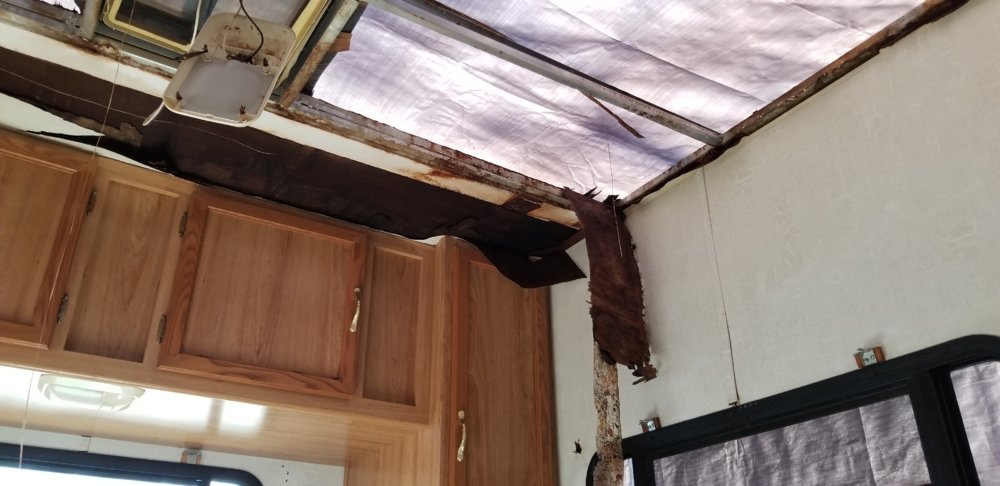

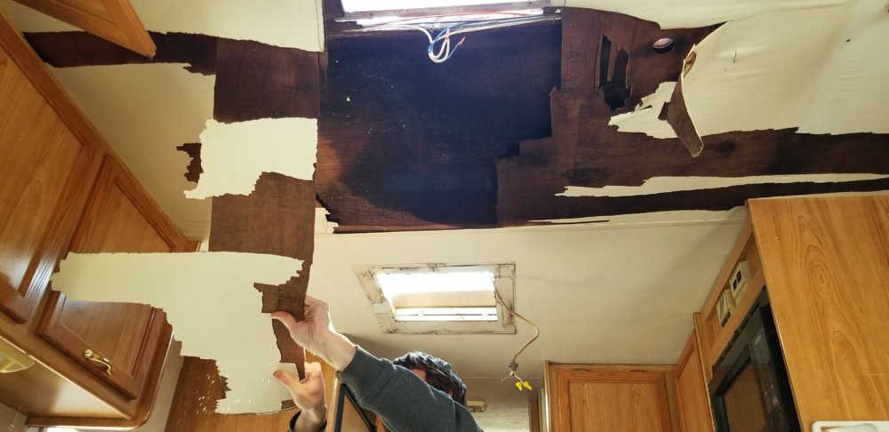

Didnt take much of an effort to RIP the entire bedroom ceiling out. Unfortunately , I was not able to salvage any foam, as it was waterlogged.
It takes mere seconds to create a big mess!
And this trailer fills up fast. So far 3 trips to the dump with rv debris alone.

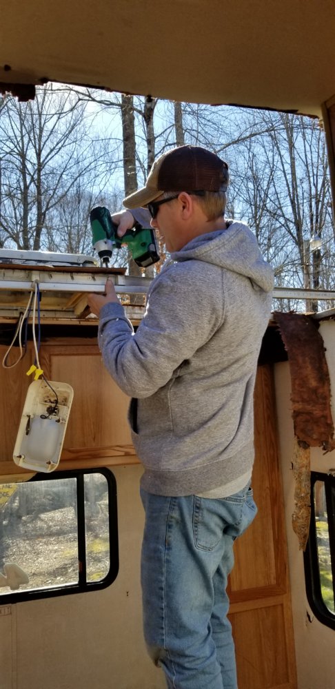

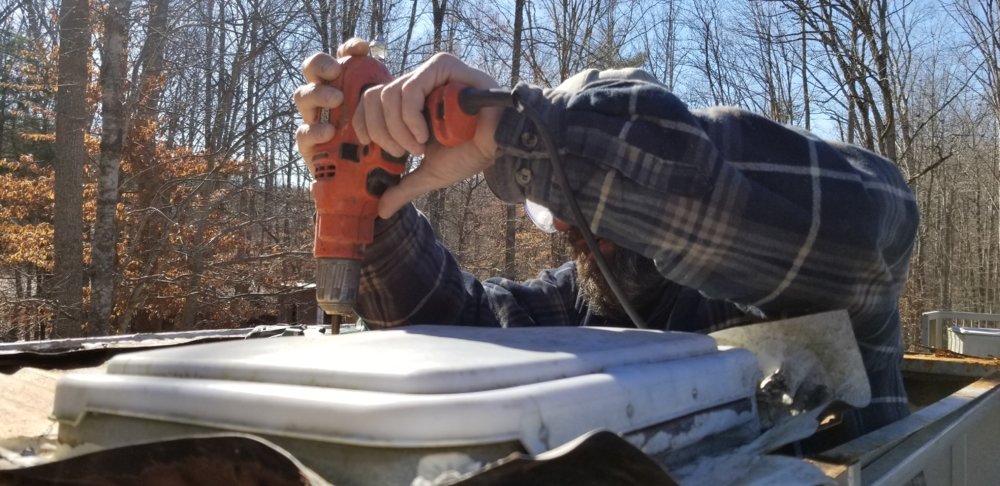

Ok, now that the ceiling is gone...its time to work on removing this stubborn vent. So far, it has 5 stripped screws..rusted.
Damnit man!!..this things killing me man!
"Bobby!..we gotta get a drill on this piece of $#!+ !
