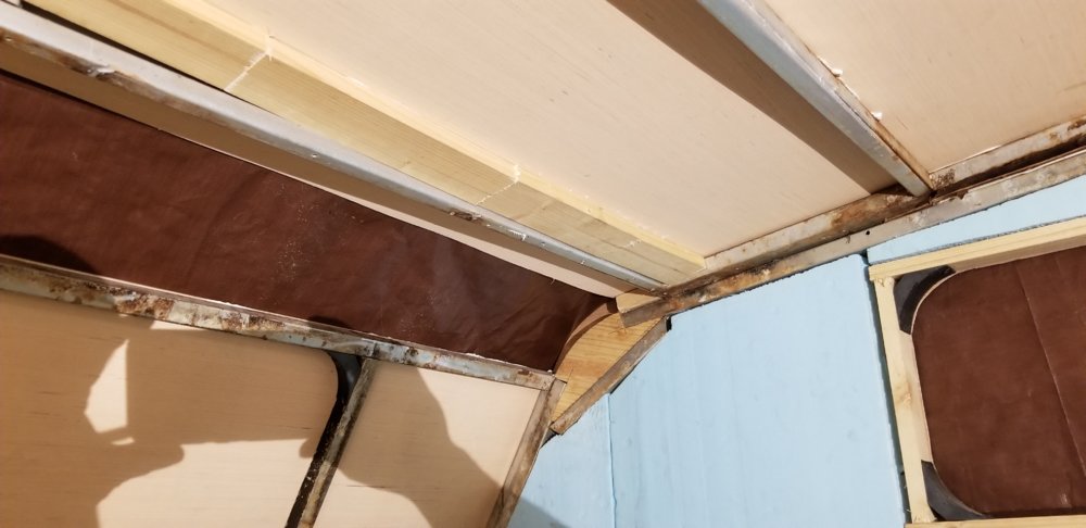

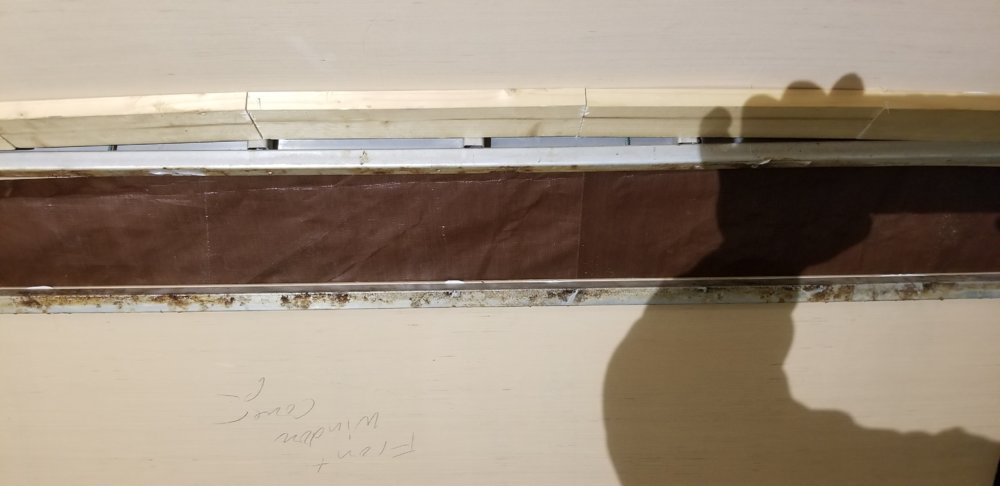

Maybe a thought but could you lay the blue foam flat in relation to the inner ceiling panels. Then, fasten the Luan to the exterior roof frame work (with the arch). Drill small holes inside through the blue board and insert a expanding foam straw and squirt it in there effectively eliminating the “gap” as it expands filling the area left above the blue board but below the luan? Just a thought but not sure of its actual outcome.
