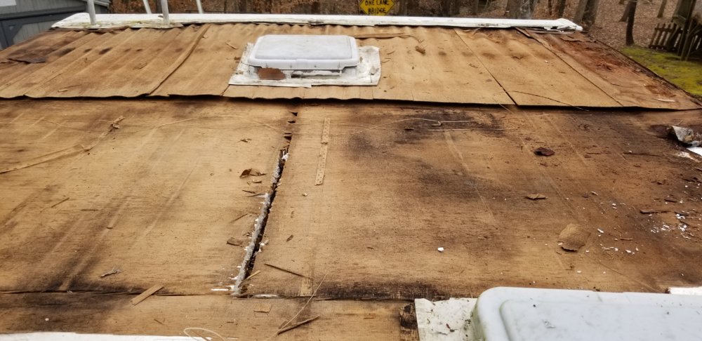

So for starters..let's have a look at what needs fixin'.

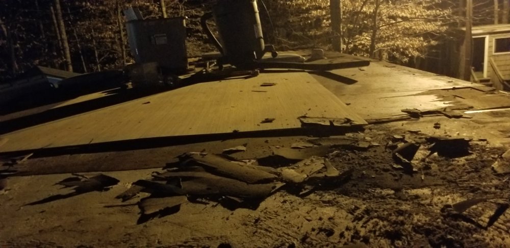

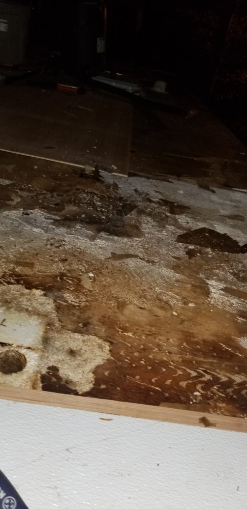

How about some rotted roof?

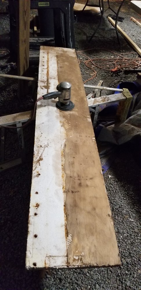

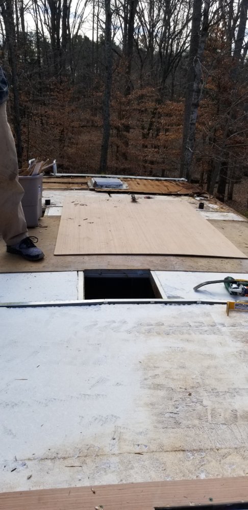

In this picture you can see(at very bottom of pic.) The edge of new luan, then the white, which is the old foamboard. Some of the foamboard is salvageable, you just have to work for it. It takes a while, but scraping the old rotted luan off leaves a nice clean surface to work with. And it means I wont have to replace this section.

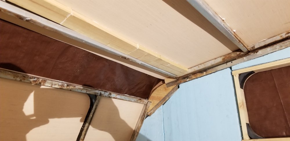

As the roof is being replaced essentially 1 panel at a time, I am also working inside on the ceilings. Trying to finish several different phases on each panel,top,middle and bottom.. as we go. Alot of the foamboard is junk and will be tossed out. I'll have to replace it with new.

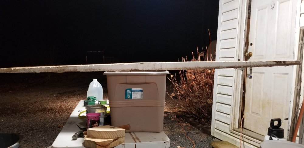

So theres one major PITA that I'm dealing with. The aluminium rafters are arched upwards in the middle, with close to 2 inches of fall on each side. Which is no problem for the roof, the luan curves nicely...my problem is the middle foam...its gotta be humped too. I'm just going to salvage what I can then figure out the rest as I go. One things certain...I can not cut new flat foamboard into this shape.
The trickiest Part of salvaging an original foamboard, is getting it down in one piece. If the piece starts to break , it all ends up busted ..you just gotta get a new piece.
Then...you use the scraper to remove as much of the old luan as you can. Next, use the sander and smooth down what is left. In some spots it is too hard to get it all off without ripping chunks. So I just did the best I could. That'll do.

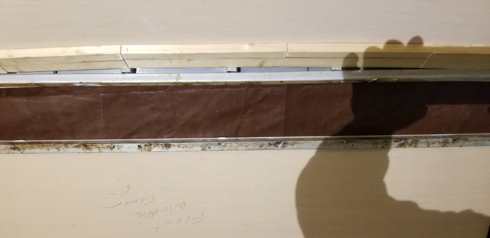

Ok...up on the roof, where the front nose cover meets the rubber roofing, there is what's called a termination bar. It's the trim piece that connects the two. Screws go down through the trim, on through the FRP, through the rubber roof, down into the ceiling. The factory used a strip of thick metal tape(think 1/8 thick) it sticks to the foam, and creates a nice place to fasten screws. The factory used this in ton of places. Unfortunately, I dont have any, so I'll utilize built in wood,in areas requiring screws.
Here, I've cut a 1×4 into small lengths, and glued them directly to the underside of the luan. Now, I have a place for the screws to catch. (I'll use this method in a lot of areas later in this build. I cut it into sections to accommodate the roof curve easier.

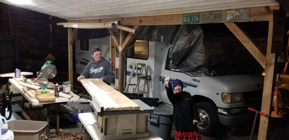

Now I needed to rip my foamboard down some. Ella right by my side.
