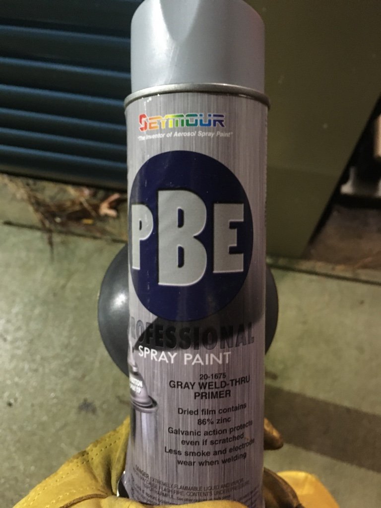

Thank you, good to know for future reference. Guy already ordered stuff.This is what I use. Amazon prime. Can’t recall how it was but I did a full set of frame stiffeners and a rear axle with it with some juice still left in the can.
If you haven't touched it yet, assuming you are still in the planning phase, then why are you worried about parts sitting for long enough to need weldable paint?I haven't even touched the truck..hold your horses there cowboy

PS I've never worried about weld-thru primer.
Cause he brought the axle that's just been sand blasted so that's allthen why are you worried about parts sitting for long enough to need weldable paint?
Lol you know I'm too cheap for my stuff to use that stuff too haha. Obviously it's customer demandPS I've never worried about weld-thru primer
