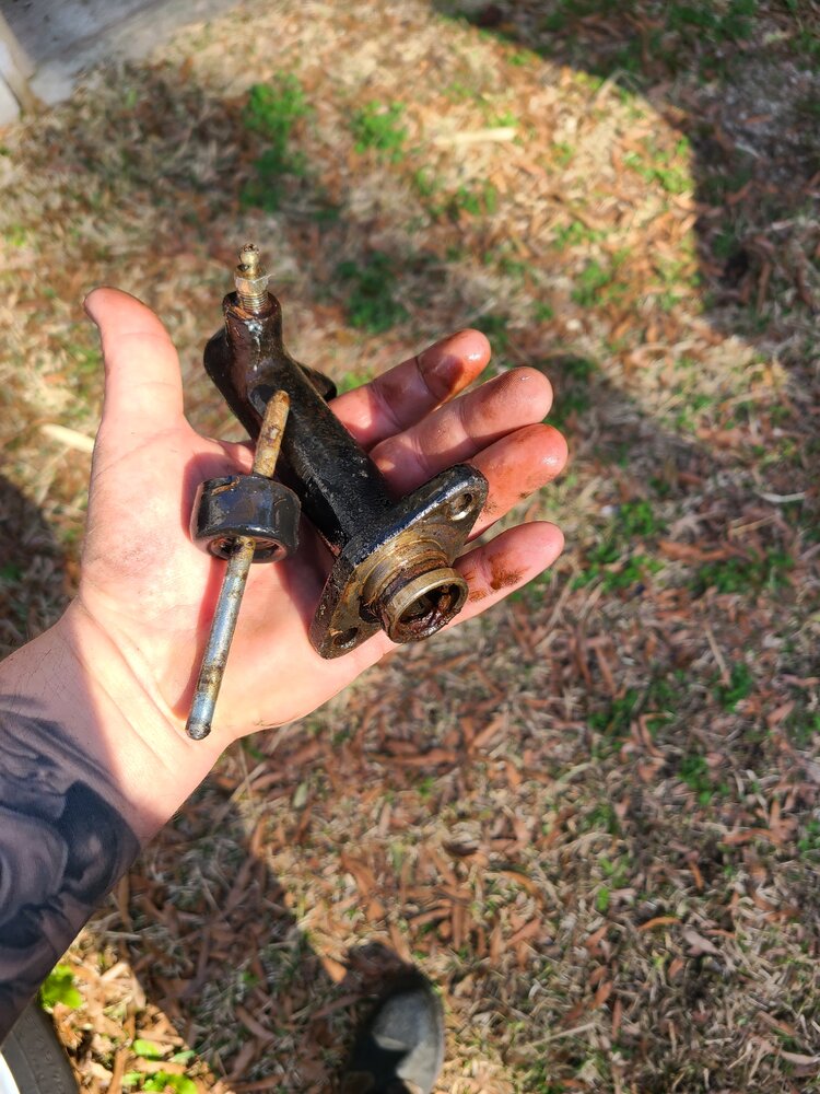

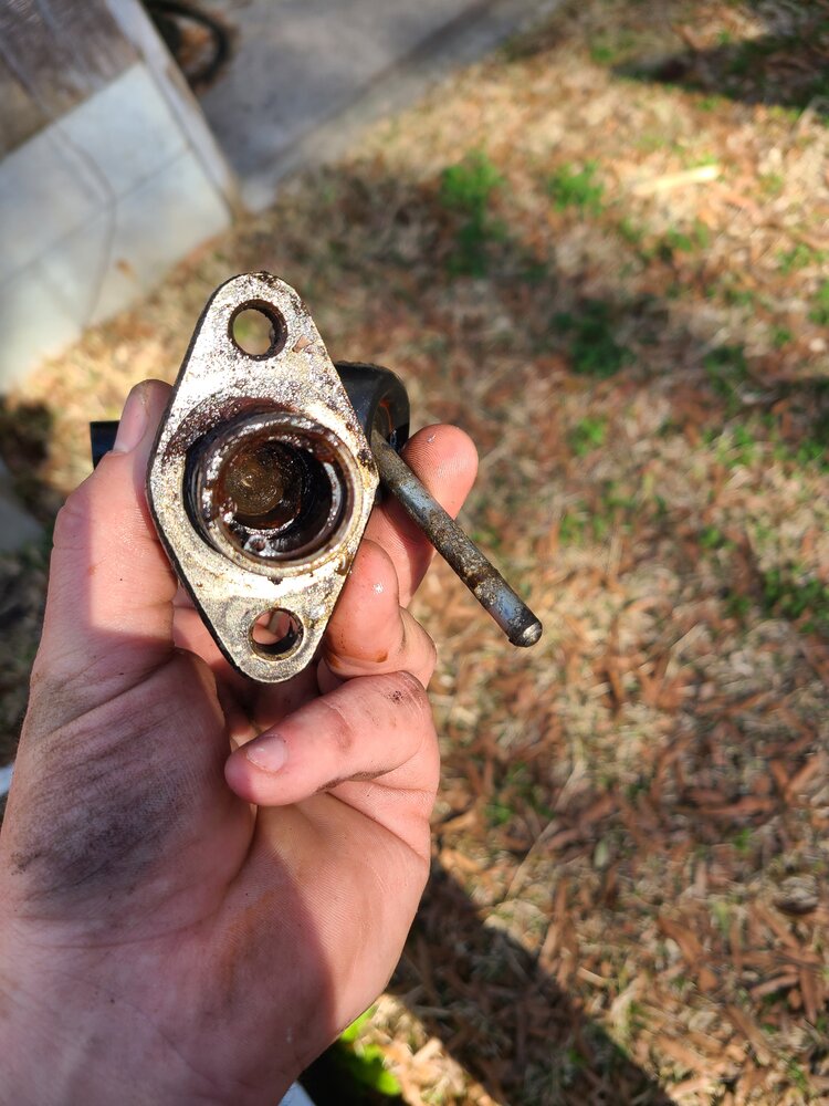

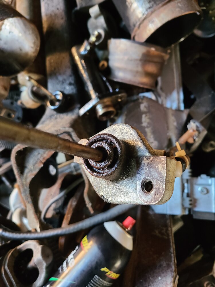

Naturally, after sitting for several years, the clutch master and slave started leaking after I drove it some. So it got new ones today. Another 75 bucks between the O2, master, and slave. She's good to go now!
I think I need to bleed it one or two more times, but as I've done in the past...I replaced and bled everything by myself. Hard to push the clutch pedal and crack the bleeder at the same time with a bad right shoulder.

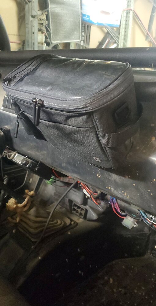

Meanwhile, I installed the best.thing.ever.
(drumroll please)
GRAB HANDLE SNACK BAG!!!! 😯😍
Snacks is important! Can't have anybody getting hangry out in the middle of the woods :D

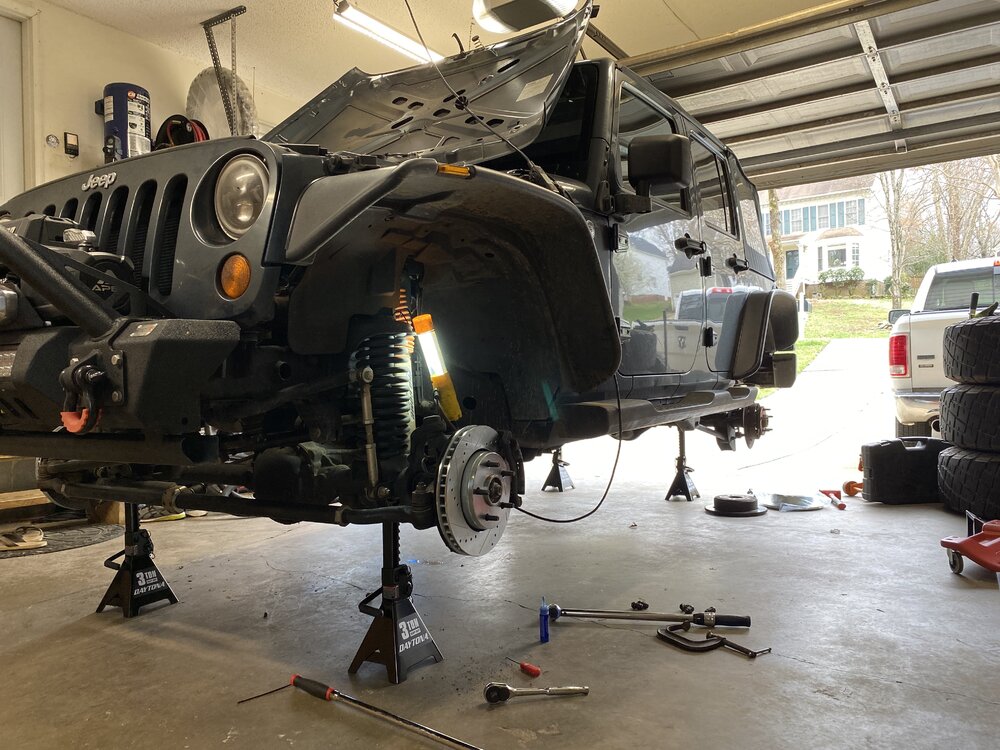

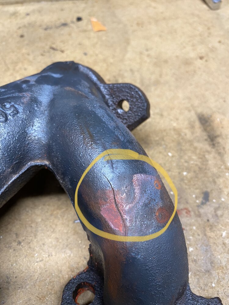

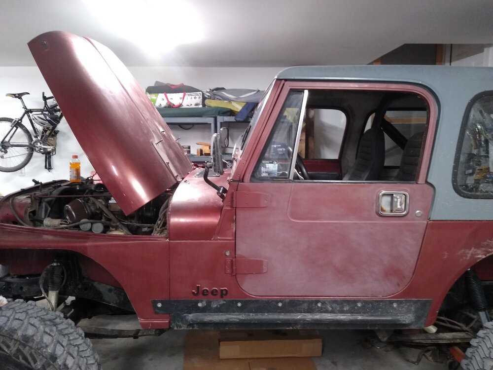

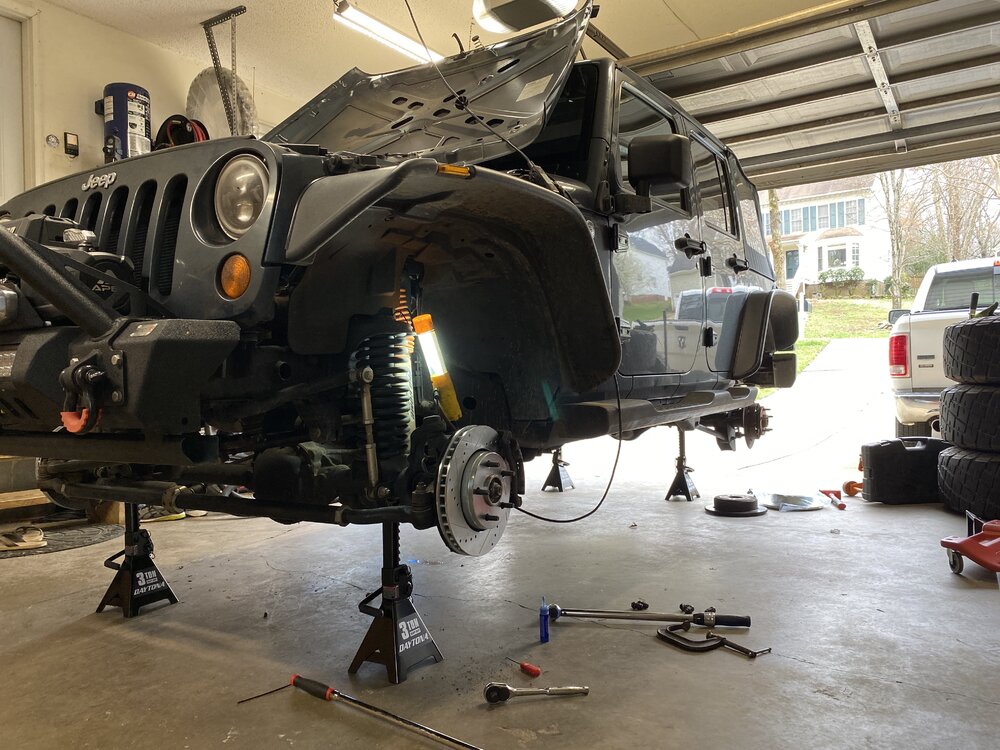

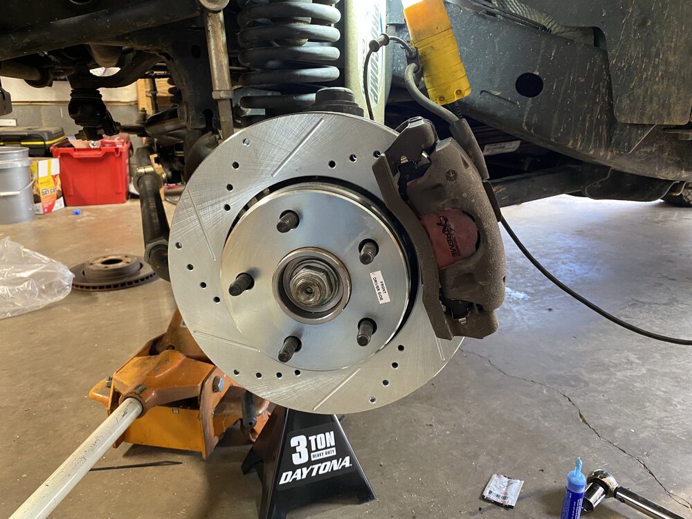

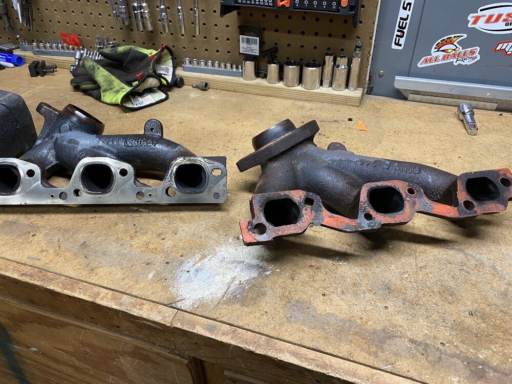

Lots of work today. Replaced both exhaust manifolds. Passenger side was cracked and I also found several of the bolts loose. It looks like the PO attempted (very poorly) to repair it. There was some red stuff on the crack and attempting to seal with the gasket. And some of the bolts were mismatched.
Also replaced plugs and wires. I have no idea how long the current ones were in it but figured it can't hurt.

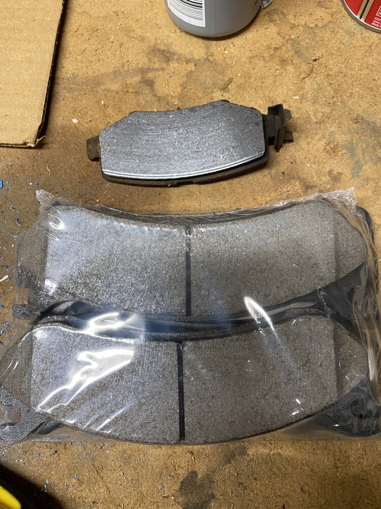

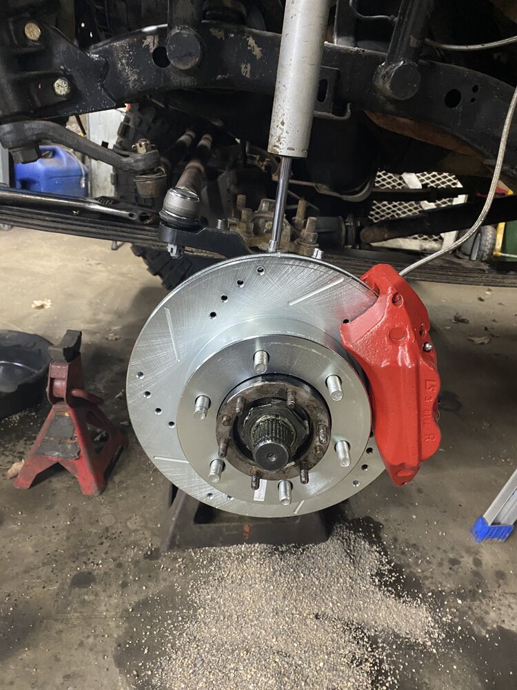

Last, I upgraded the brakes to PowerStop Z36 drilled and slotted all around. My day was going perfectly until I found they sent the wrong rear pads. Oops. Luckily they're overnighting replacements.

So now my jeep sits like this. Does this mean I'm finally an official web wheeler and part of the in crowd here?
They making you return the 0785 pads? If not, I'd be interested in them

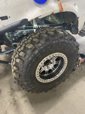

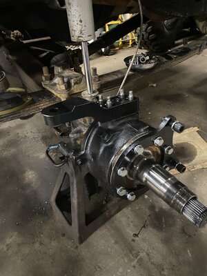

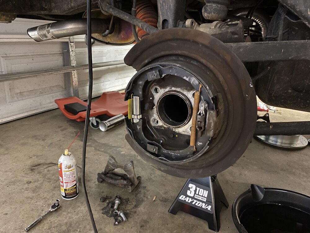

Well, what started as a one day project to replace exhaust manifolds as well as pads and rotors has snowballed. I really should stop paying attention to things. I was happier when I was blissfully ignorant.

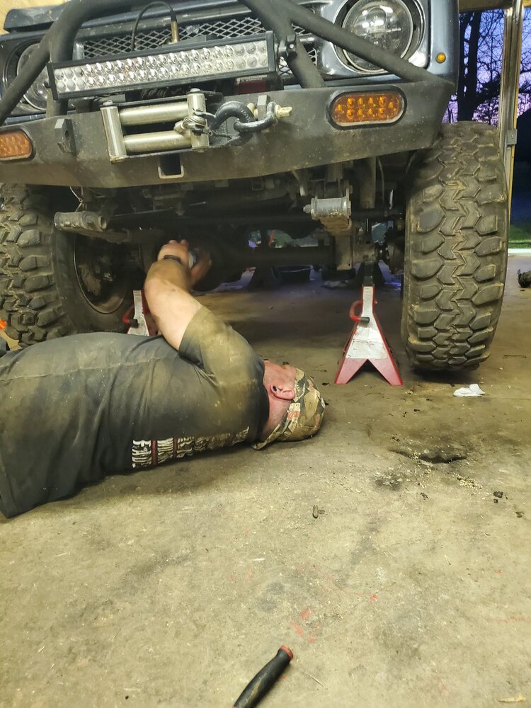

Noticed ball joints had play. So ordered some Teraflex HD ball joints.
Also noticed that I had a parking brake shoe that was sticking and constantly rubbing the drum no matter how much I adjusted it.
Then I noticed that the rear axle shaft felt funny when I turned it.
My one day job turned into a whole ordeal. New ball joints, rebuilt parking brakes. All four axle shafts out of the jeep and now I'll be getting new bearings and seals on the rear. Maybe when this is all done I can stop spending money for a while. Ah, who am I kidding?

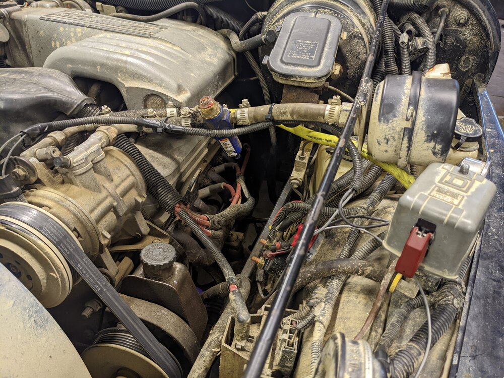

I ordered a TPS for the Super10 and got rid of some unnecessary vacuum lines to clean stuff up. Don't need lines for the heat up valve or EGR. The MAP sensor definitely works, which is good, as that will be the only sensor I haven't replaced.

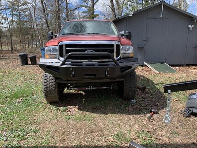

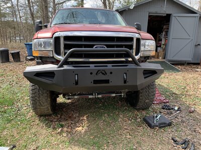

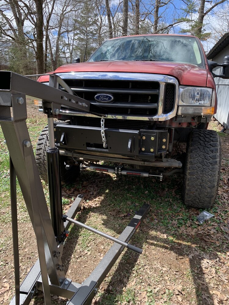

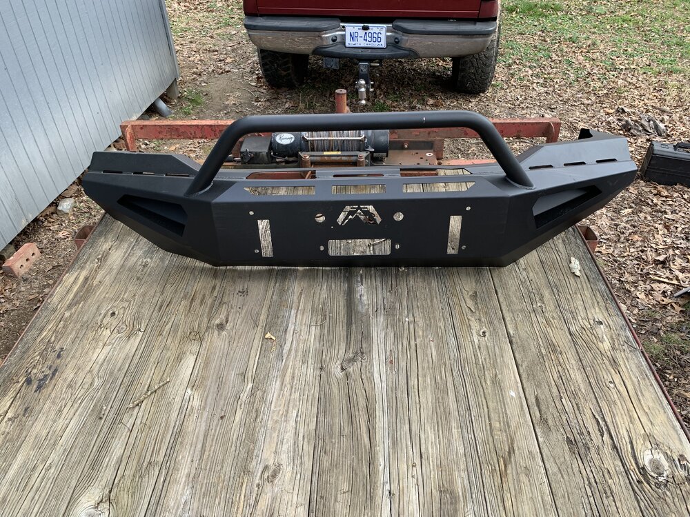

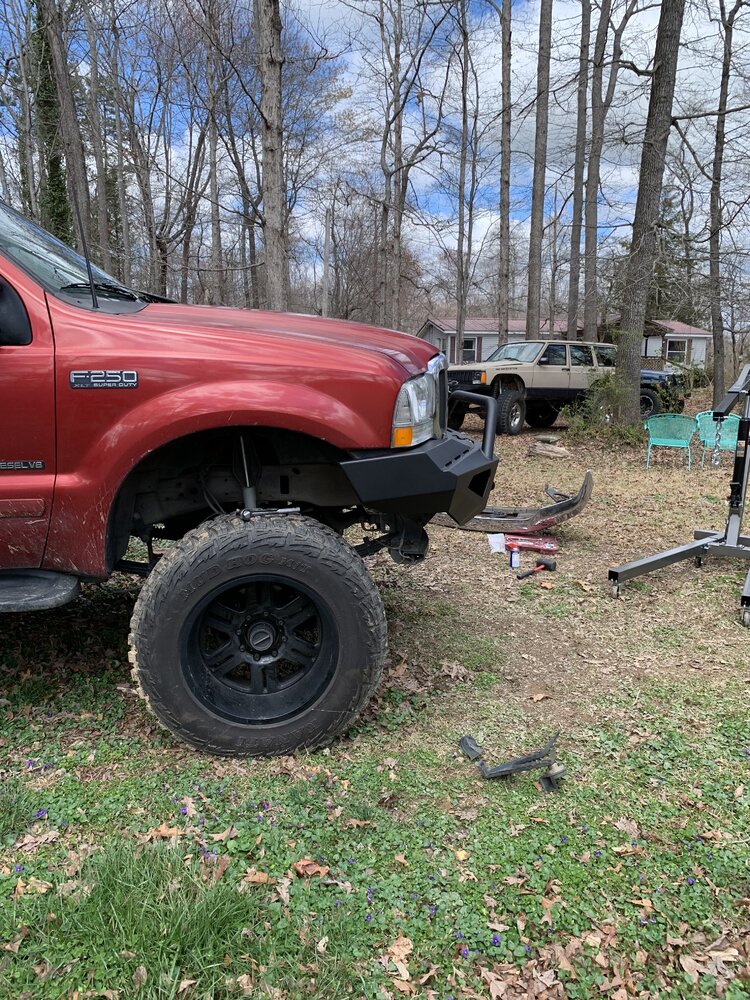

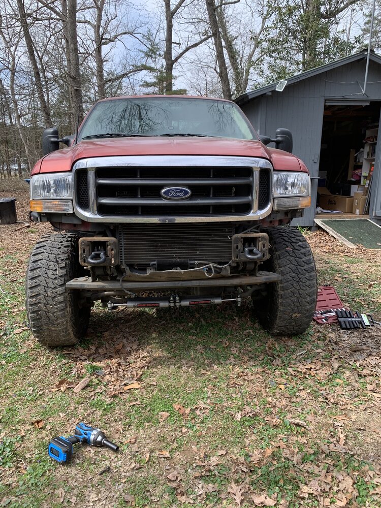

Started this project today. But running solo on it kinda sucks, can’t lift bumper into place properly and line it up. So here it rests, hoping my brother can ride down to give a hand….the floor Jack didn’t help any except to serve as a drink holder

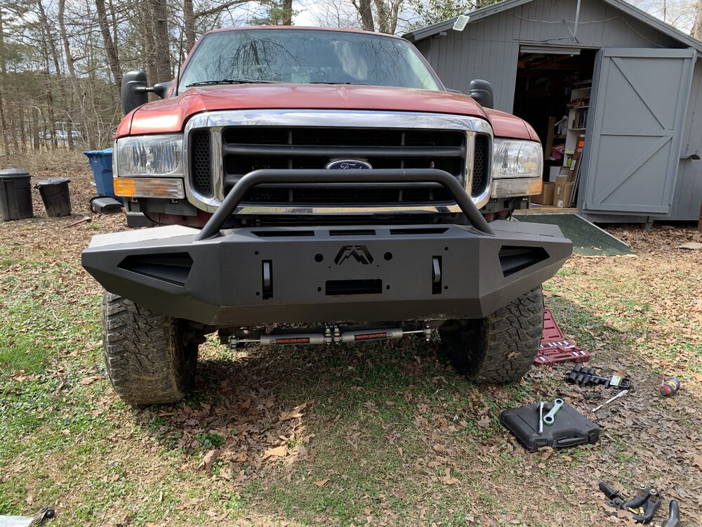

After being rained out yesterday, I was able to get back at it today. Finally got the brackets all in the right place and bumper fully mounted. I enlisted the help of my engine hoist to help get the winch plate adjusted, I also destroyed a bolt, that’s kind of my specialty. This bumper was damaged during the shipping process, I bought it this way so I was well aware, but I’m still happy with how it turned out

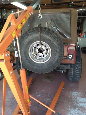

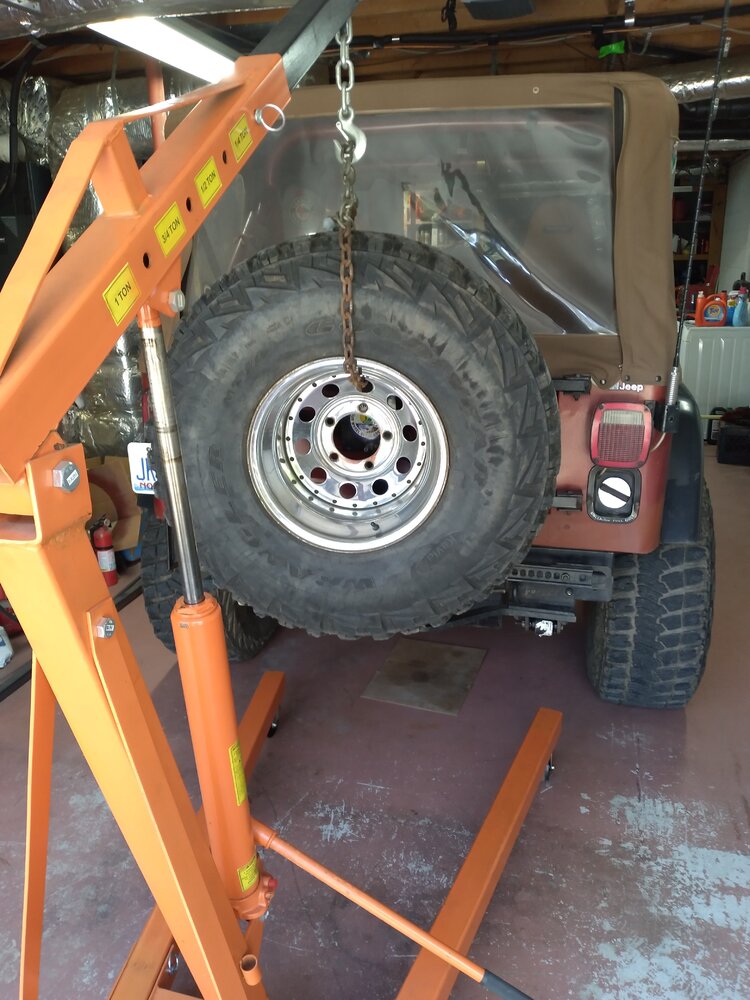

I had new BDS springs installed a couple weeks back, & had shocks on order. Just been putting off installing them, until Saturday. Going in Monday for back surgery, & won't be doing anything like this for 2 months, so I Had to get it done. Also swapped my spare for a front tire. Guess my tires have gotten to damn heavy, to lift, so out came the cherry picker! :laughing:
