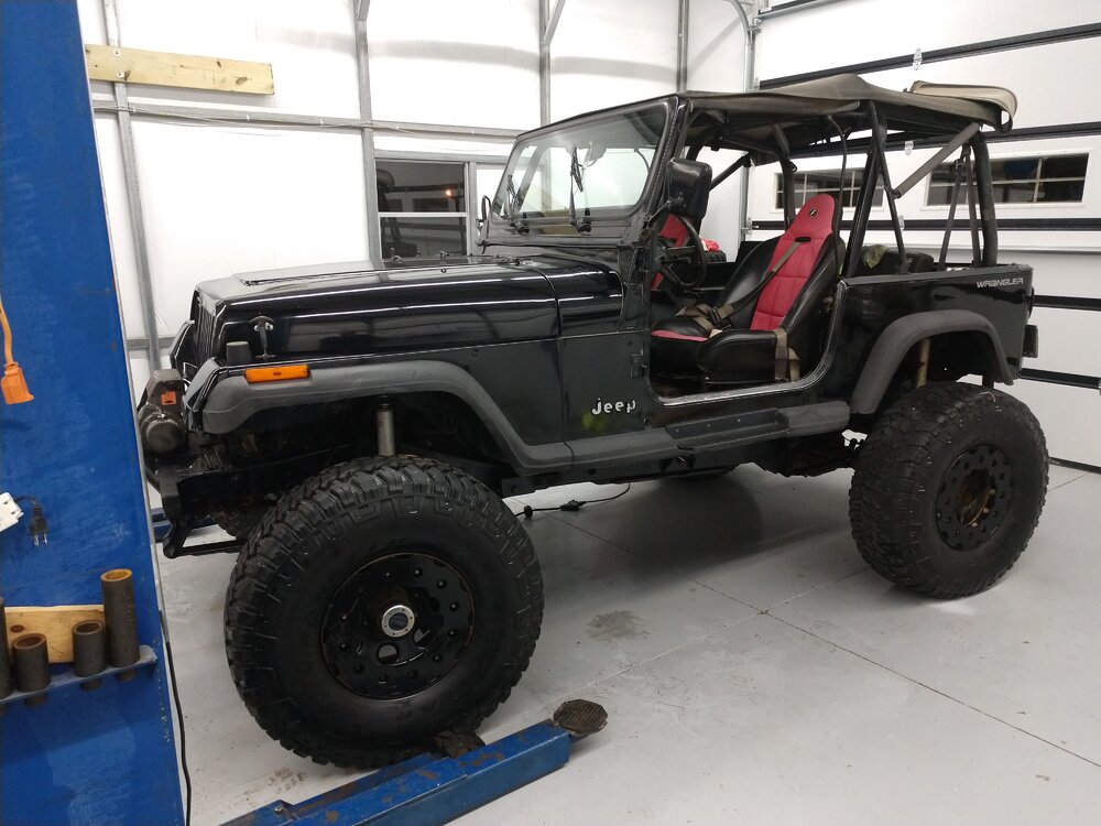

Got mine off the jack stands.
Everything I touched is buttoned back up and seems to be working as intended.
In the past month it's gotten:
New muffler and intermediate pipe
New exhaust manifolds
New ball joints
New brake pads and rotors all around
New parking brake shoes
New bearings ands seals on rear axle
New power steering pump
I've probably forgotten something at this point. At least I've done just about all of it myself and saved a ton in labor costs.

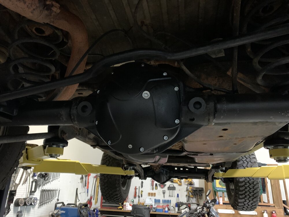

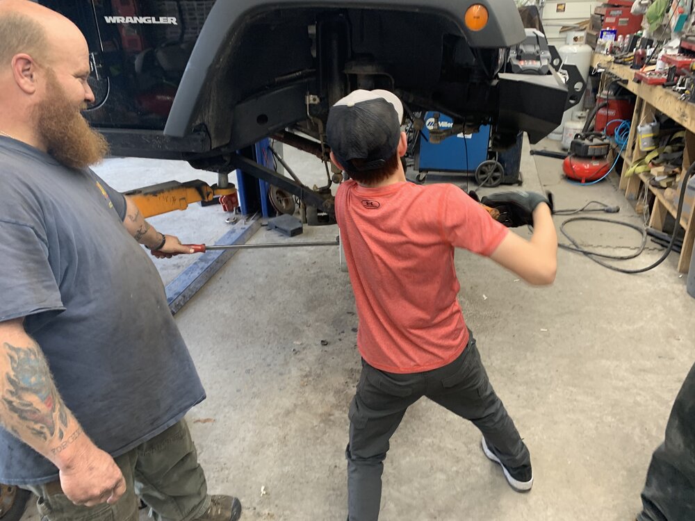

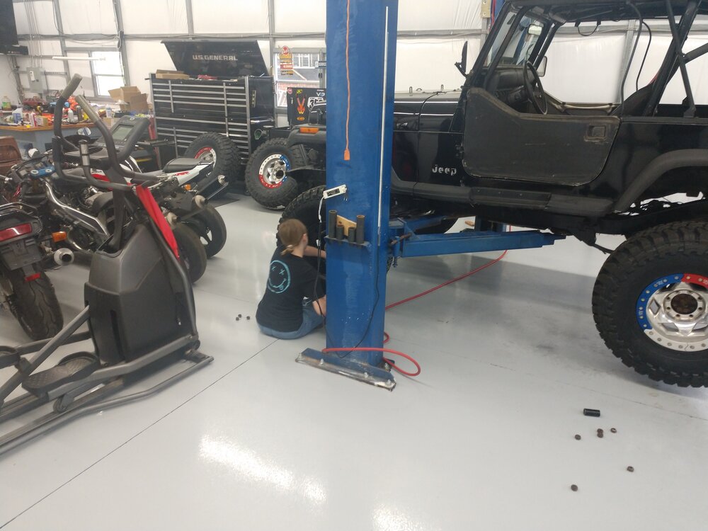

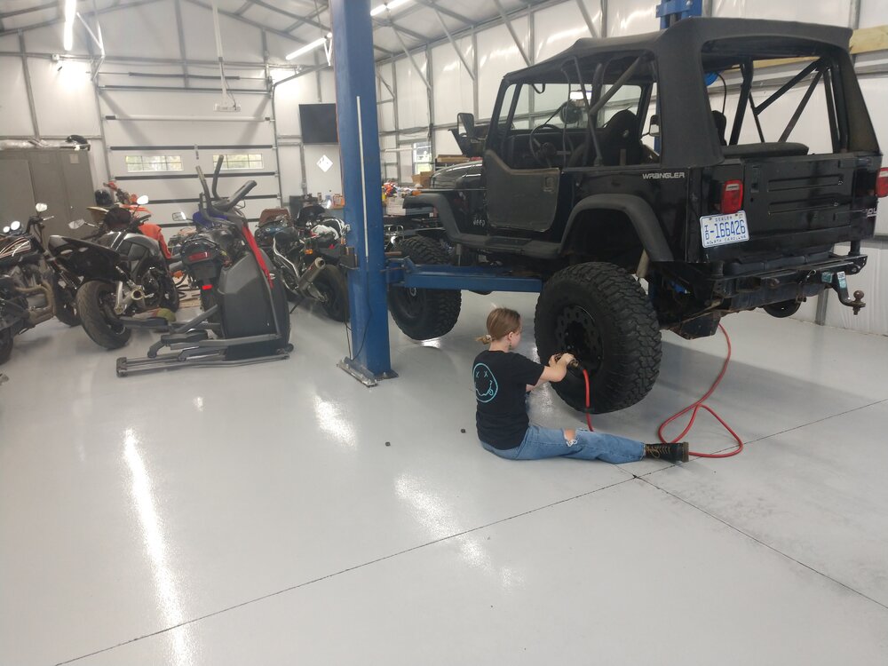

Plan B got a few upgrades thanks to @josh$$ and @Jason W. over at J&J Broken Skull Garage. Front axle got a JCR Offroad truss, inner C gussets, lower control arm gussets, new MOOG ball joints, u-joint caps tacked, and a Metalcloak diff cover.
The rear axle got the axle tubes welded up solid and a matching Metalcloak diff cover.
They even got my boy involved in things so he can start learning about his future Jeep. He gave the ball joints everything he had.

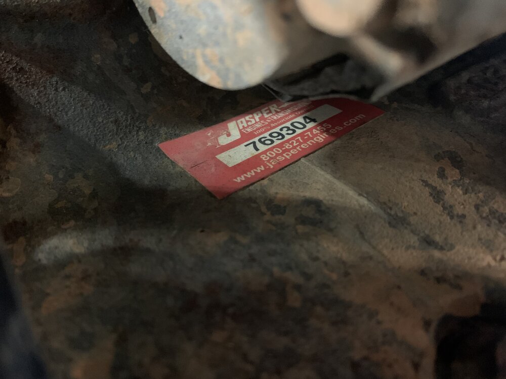

We also spotted this little gem hiding under the hood. Turns out we’ve got a Jasper reman motor that was installed back in 11/2015. That means it’s only got about 45K on the motor. We’ll take it.

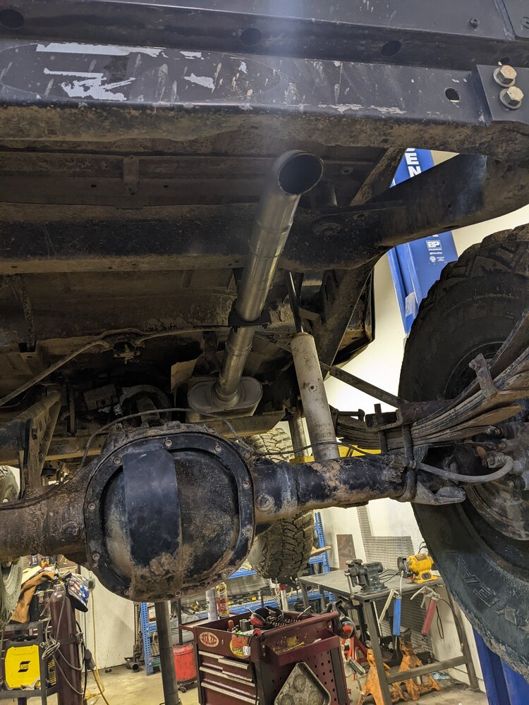

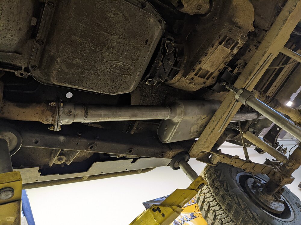

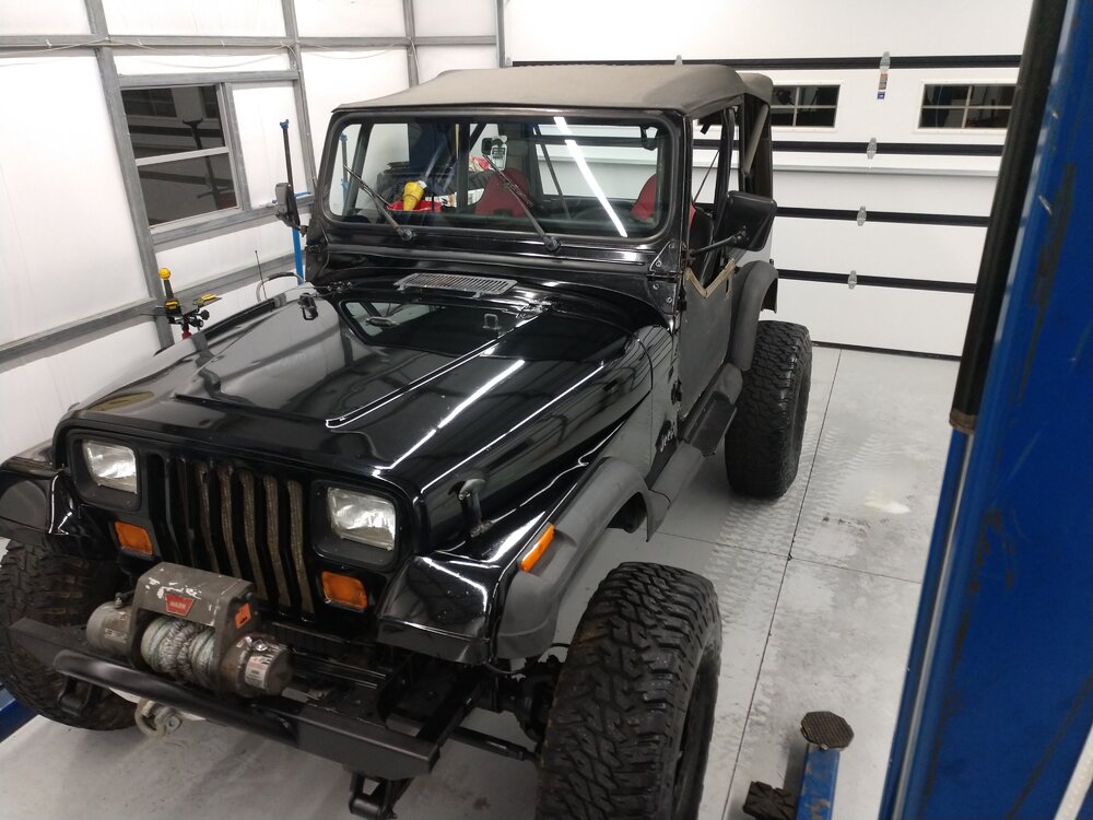

New exhaust on the YJ.
Had a huge exhaust leak at the Y pipe. Also had a turndown right behind the muffler. The cat converter was God knows how old. All of these combined made for some strong fumes while wheeling.
Leftover Summit builder kit we used on @thebrotherinlaw XJ, some parts store reducers and a cheapo Flowmaster knockoff later and it sounds great.

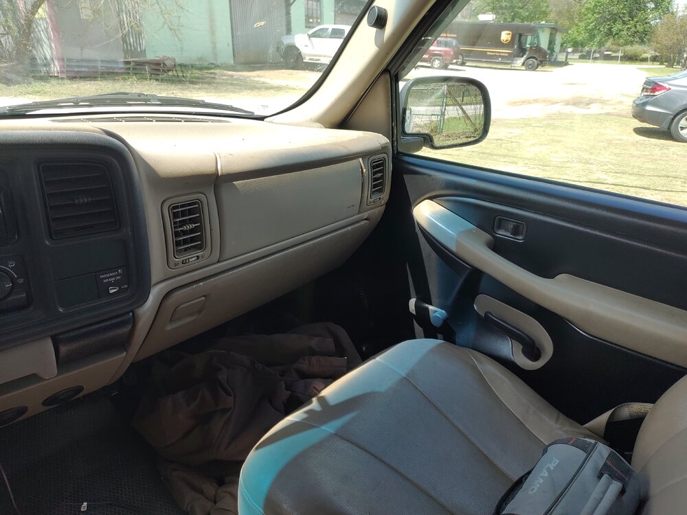

Last weekend I worked on putting the dash back together; aside from some dust and typical grime this truck is insanely clean! Someone cared about this truck.

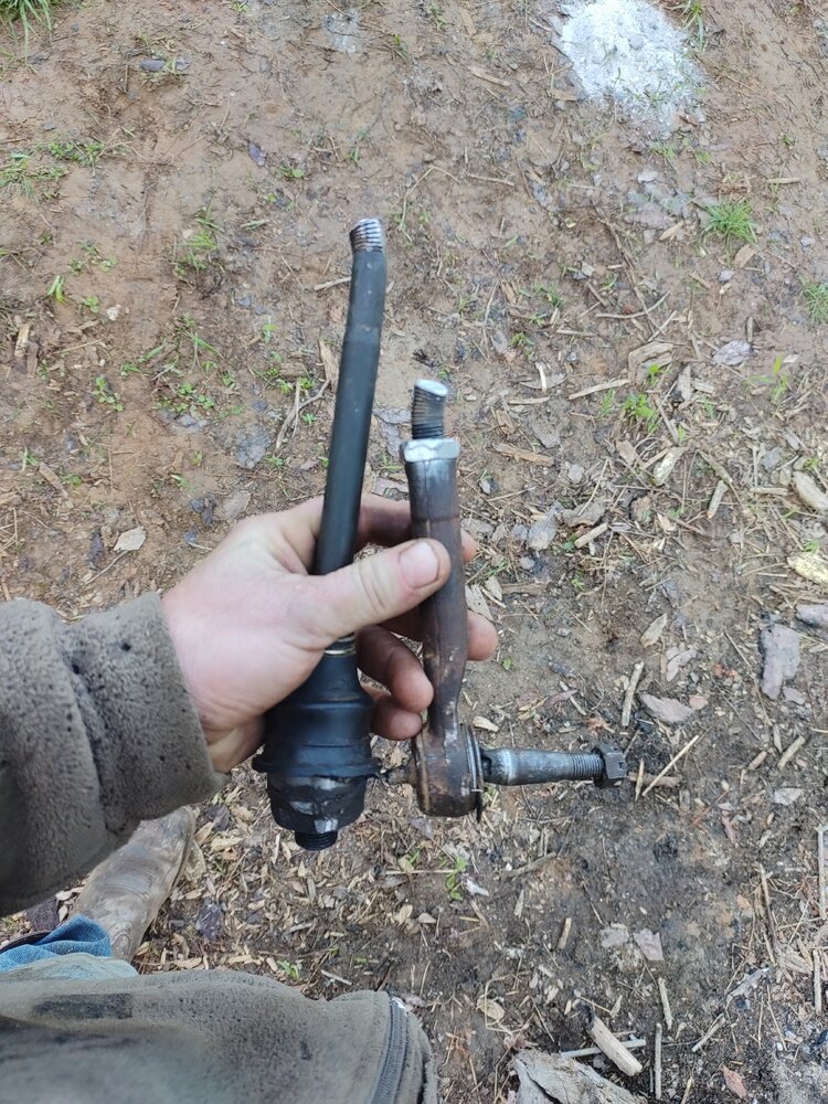

Found out that stock GM tie rods suck, as if I didn't already know.

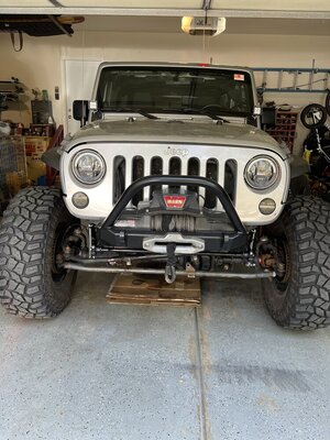

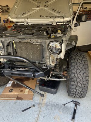

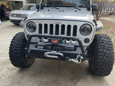

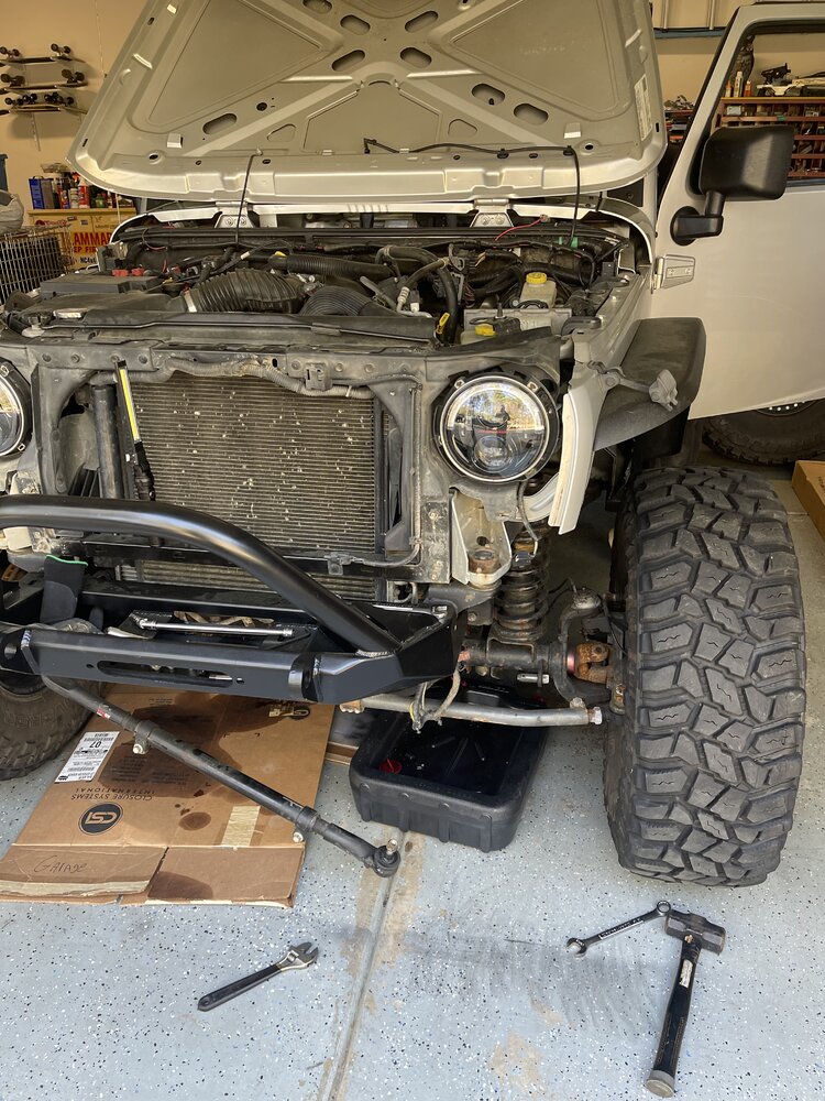

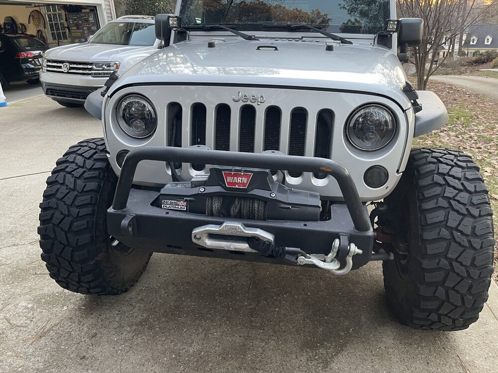

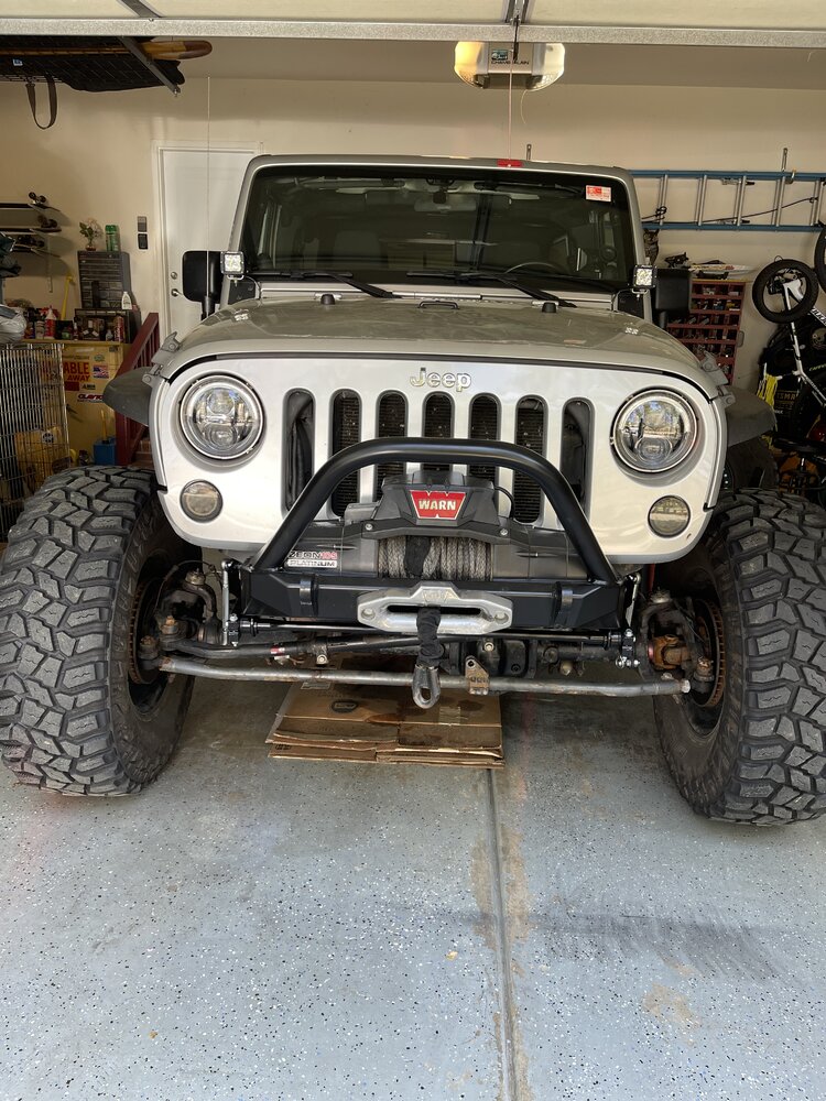

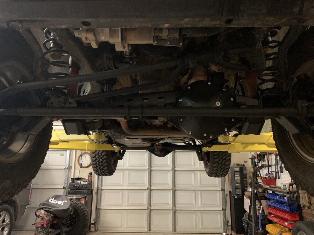

Changed out the front bumpers on the JKU. New front is motobilt tomahawk frame chop. New rear frame chop is going on this week. Also added PAC racing front sway bar.

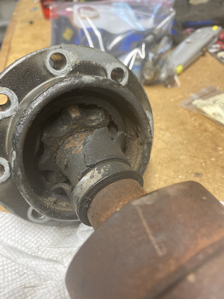

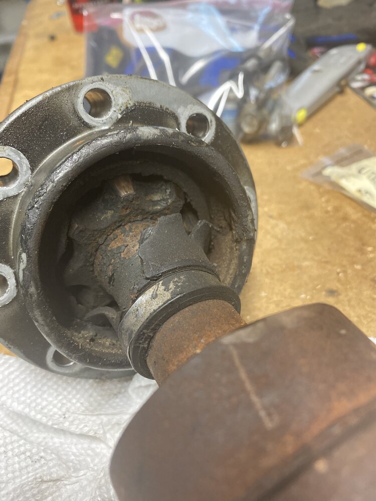

Finally chased down an annoying noise under the Jeep. Time for a new front drive shaft. This joint lived a good life.
Anyone know why Chrysler prefers these over a U joint? Or rather, why they'd put a U joint on one end and this on the other on the front shaft, and two of these on the rear? I assume these are CV joints, but the driveshaft place I called said it's a pancake joint. Someone educate me cause I'm very curious.

Call Dave at Oliver's
Actually, when you call you'll likely talk to Libby she'll get you set up for a replacement shaft and get rid of that junk

Not as fast as just pressing in a new ujoint but you can replace that end of the shaft in like half an hour. My WJ front driveshaft uses that at both ends.

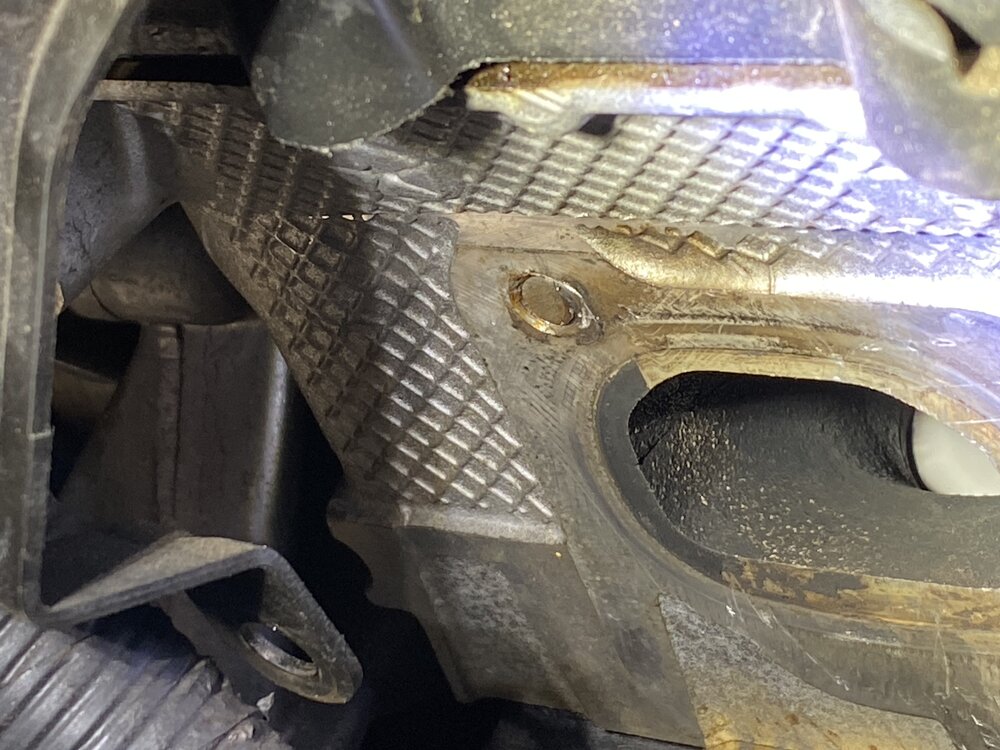

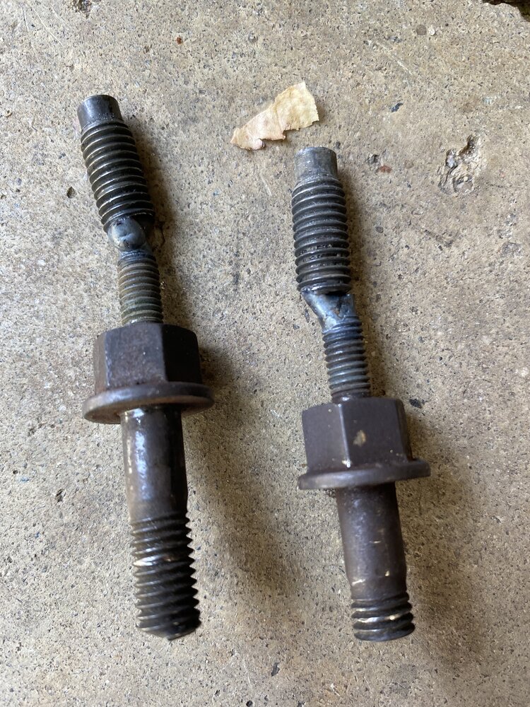

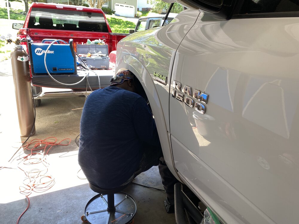

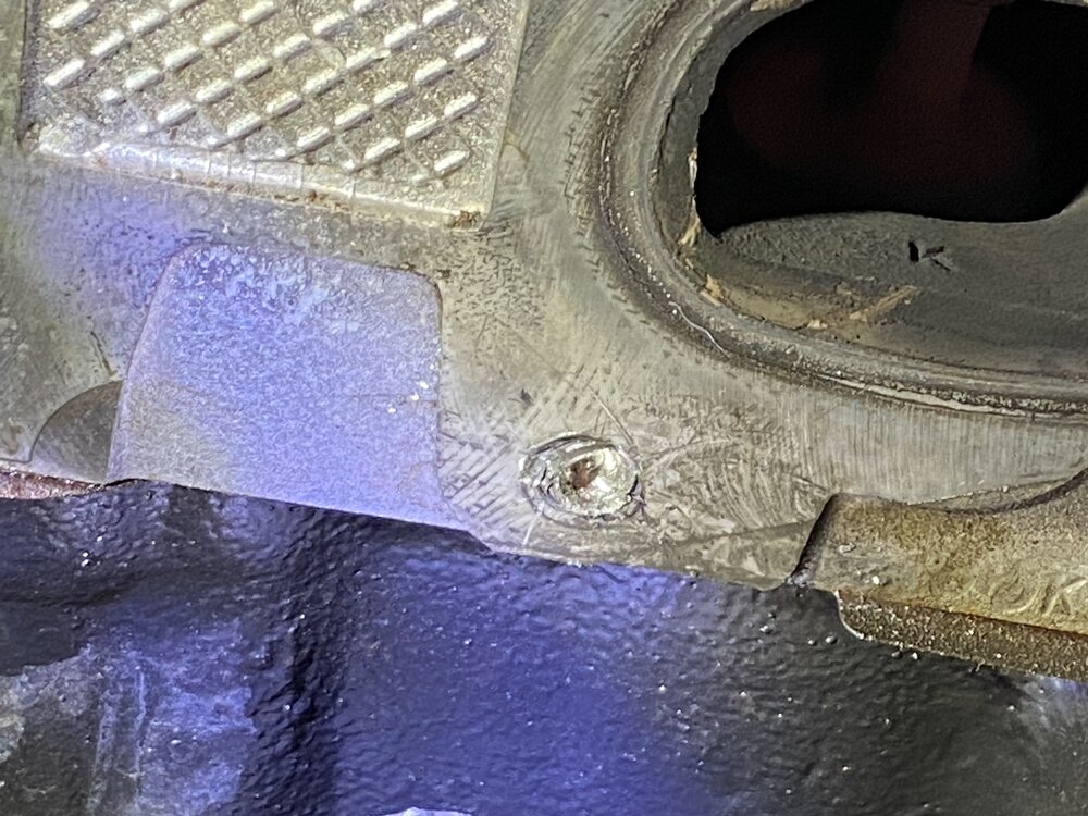

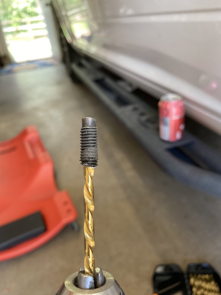

After putting it off for almost two years, I finally tackled the broken exhaust manifold bolts on the Ram. Dealership wanted $2000 for the job, which didn't include new manifolds. I knew I could do it cheaper. Evan after buying tools and parts and hiring a welder to get two of the bolts out, I'm still ahead by $1200 by my estimates. I'd say the aggravation was worth it. And now not hearing the exhaust leak ticking under the hood, smelling exhaust or hearing a heat shield rattling makes this money and time well spent.

That's like 90% of my job...but on airplanes. Usually stainless broken in aluminum, because engineers are smart!
Hey!!!... You're supposed to use inconel 718. It's on the drawing. Then it got gov contracted and the bean counters had to undercut the bid. Can't reduce payload or any other mission requirements to meet budget so we'll have to compromise and make this thing impossible to service and use that one time use only hardware. I bet the engineering director just shakes his head in those meetings and mumbles something like pay now or pay later it all cost the same.
That's my experience anyway. Then get harassed for years because I "designed" a machine that can't be maintained. If they only knew what was actually designed before all the "compliance compromises" happened post final design signoff. Good times...
And there's some dumb engineers too that have never wrenched on anything or run a lathe or...
