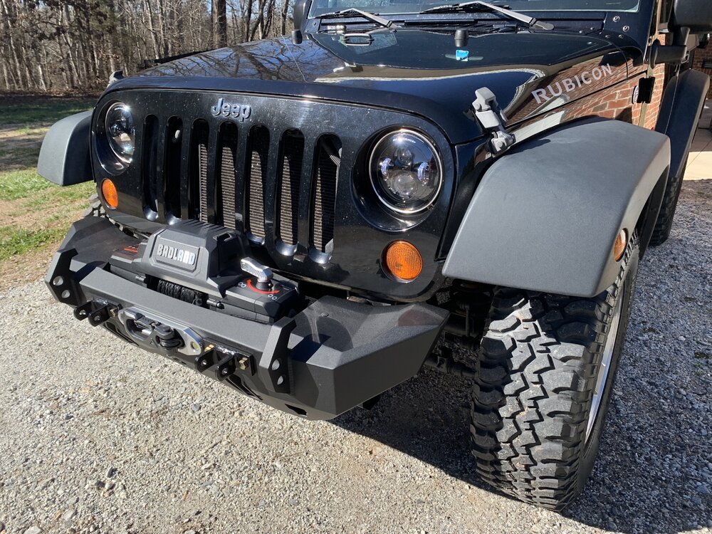

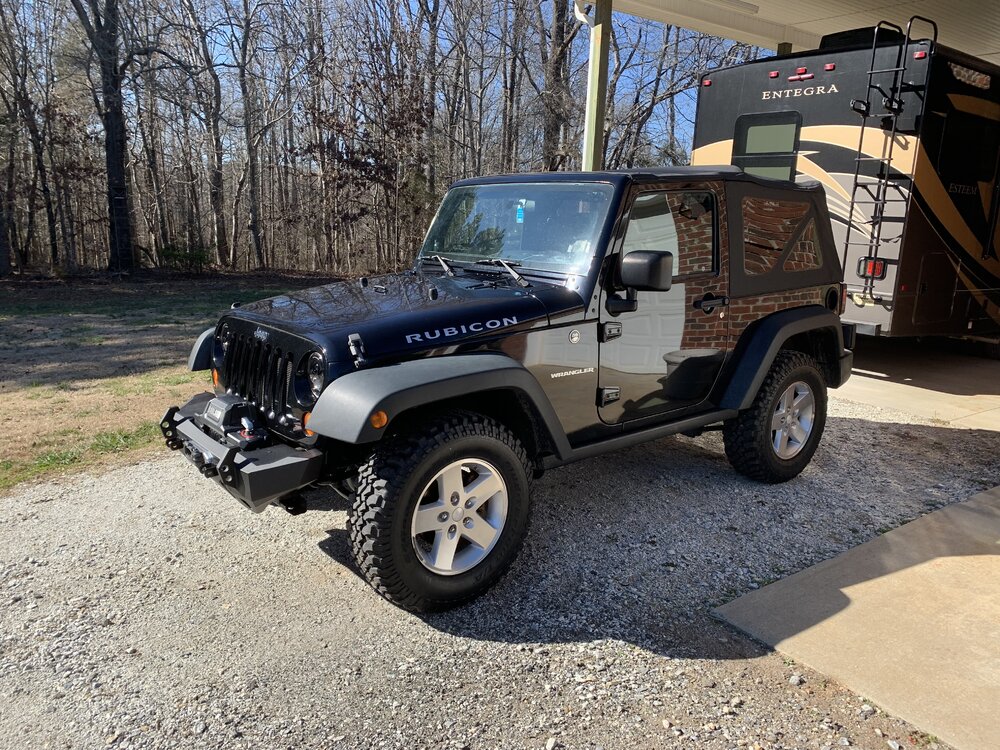

New to me 08 Rubicon. Did an oil change, installed K&N filter, added new LED headlights, installed a stubby bumper to flat tow with, and threw on a HF 12K winch because it was on sale for Prez day.

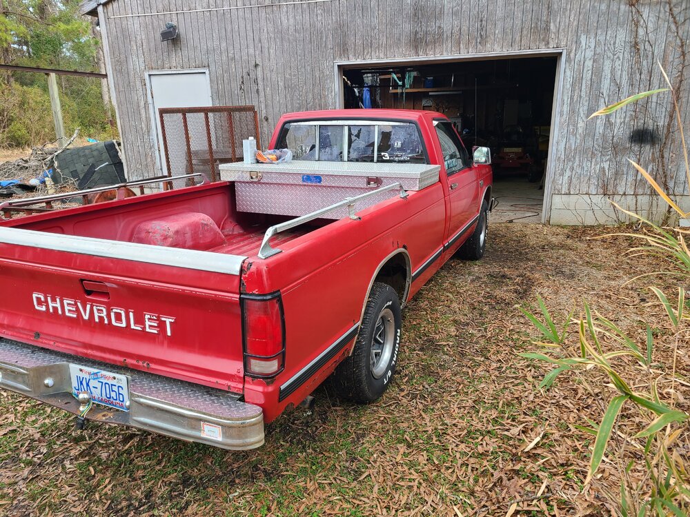

Well, I was trying to post this next update last night, but fell asleep on the couch as soon as I got home and sat down. Pretty typical...and I sleep better sitting up anyway since all of my back issues started.
Here we go. Got up Saturday morning and started by firing up my buddy's pressure washer again. I hit that early 90s vintage UWS toolbox and the very bottom lip of the truck bed that I couldn't get to when it was sitting on the ground. While it was drying in the sun, I finished my back porch (north side of the house) because it was good and filthy.
Rolled over to the shop, put some adhesive foam under the sides, mounted the toolbox, and loaded it up with some tools and various items.
From there, I ran in to Havelock to grab some lunch, headed to Walmart real quick, and went on base to the hobby shop because I didn't feel like doing the trans and rear end while laying on the ground.

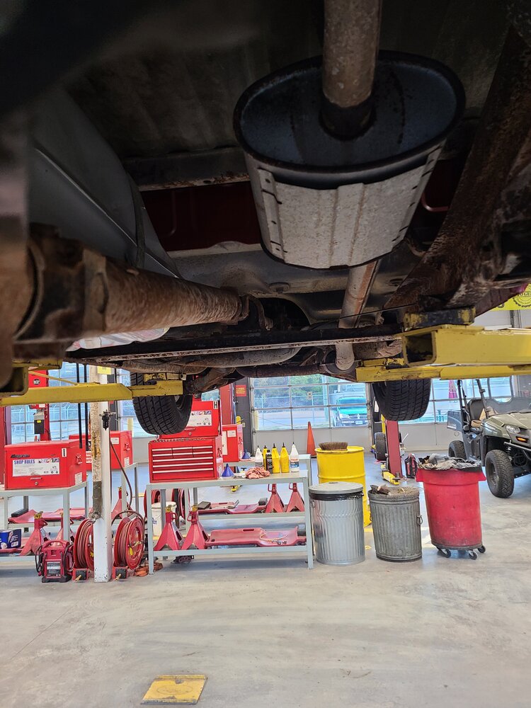

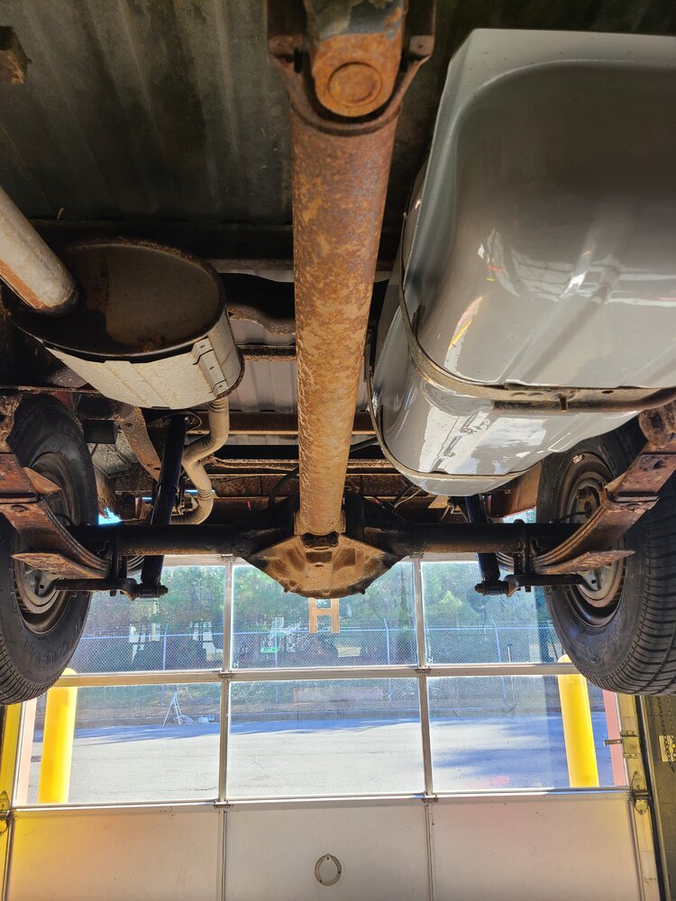

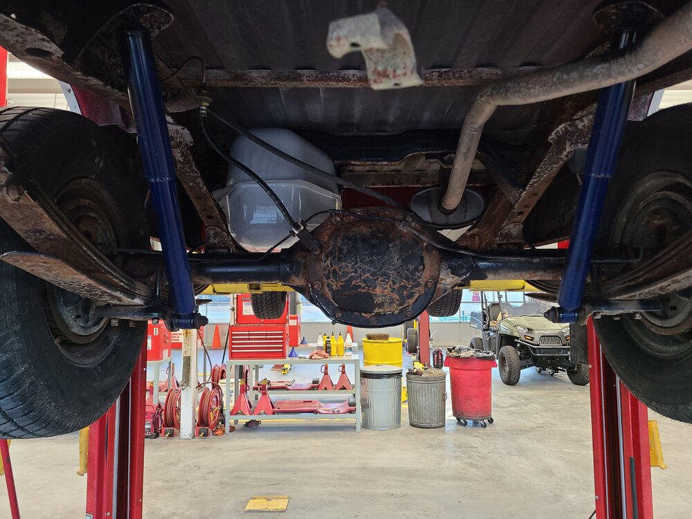

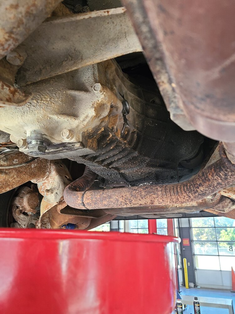

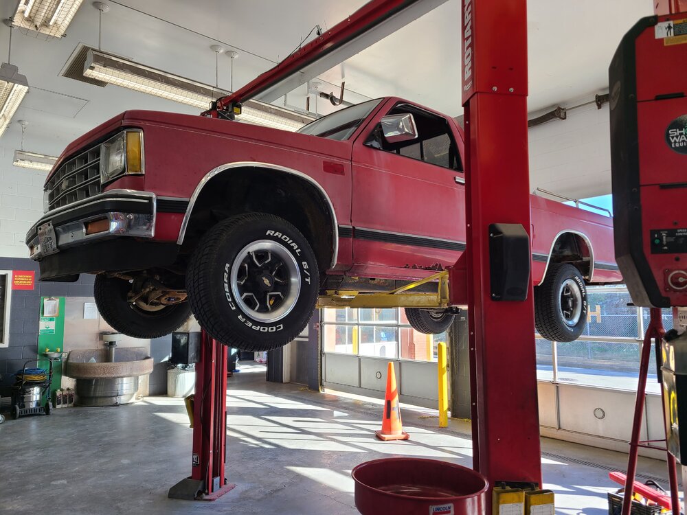

-Did the ol' drain and fill on the trans. Smelled like it had ATF in it and NOT much. Probably drained a quart out. It was lowwww. Filled it up with about 2.5 qts of Pennzoil Synchromesh. Still shifts like butter!

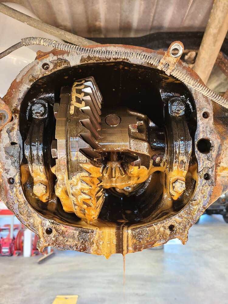

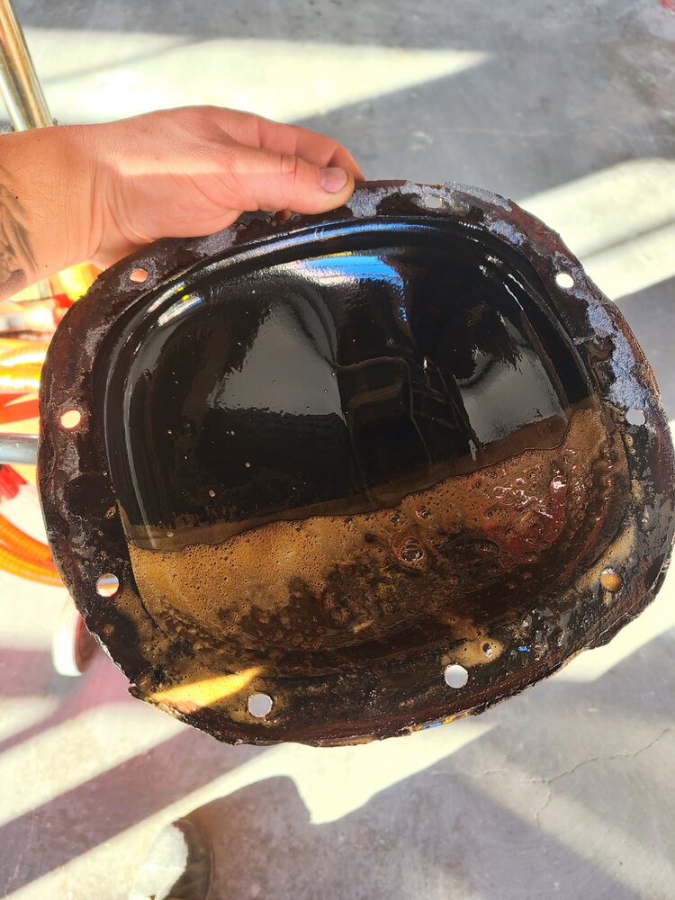

-Popped the cover off the rear end. That gear oil smelled like deathhhhh! Everything looked good, aside from what was probably years of condensation collection, but nothing rusty, crusty, or loose in there. A can of brake cleaner later, I RTV'd the cover cover back on, and filled it up with 2 qts of some high quality Fram 80w90 from Advance Auto.
-While I was under the truck and things were draining I cracked the rear bleeder screws and let them gravity bleed until them showed fluid. Looked everything over while I was waiting. Took a few pictures. Lowered the truck down, bled the rears like 3 times each, and the fronts once or twice just to get rid of some old fluid. It stops on a dime now :D Pun intended! See what I did there?
Forgot to unbolt the fuel pump/gauge ground to see if that would make the gauge work any better, but I do that Sunday. It's still easy to get to with the bed on. The pump works fine and I think the gauge is just sticky from sitting for so long. It's worked its way up to ¾ so far. I'd certainly like for it to work as I have no idea what kind of mileage this thing gets yet.

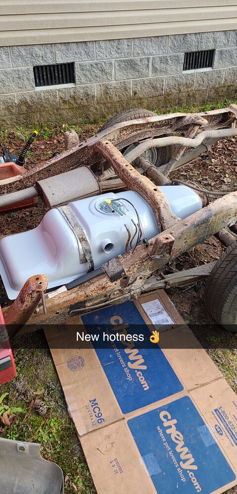

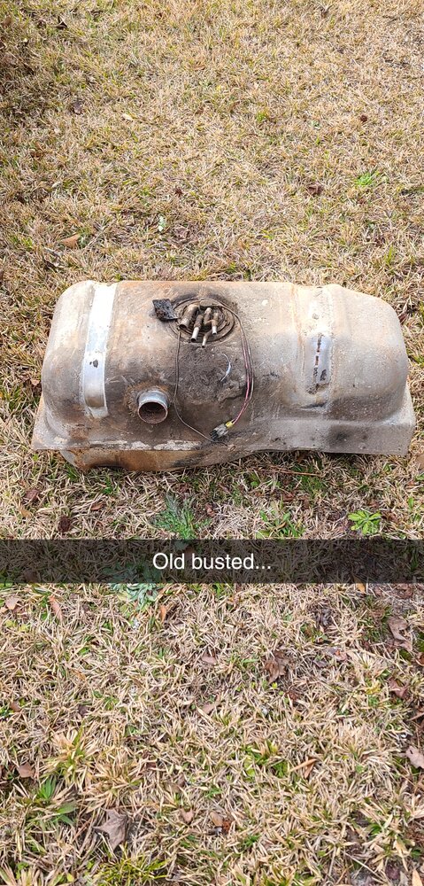

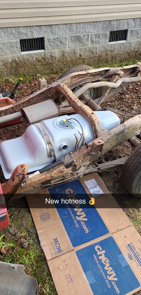

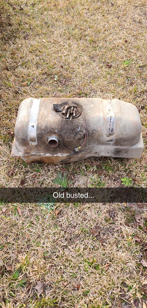

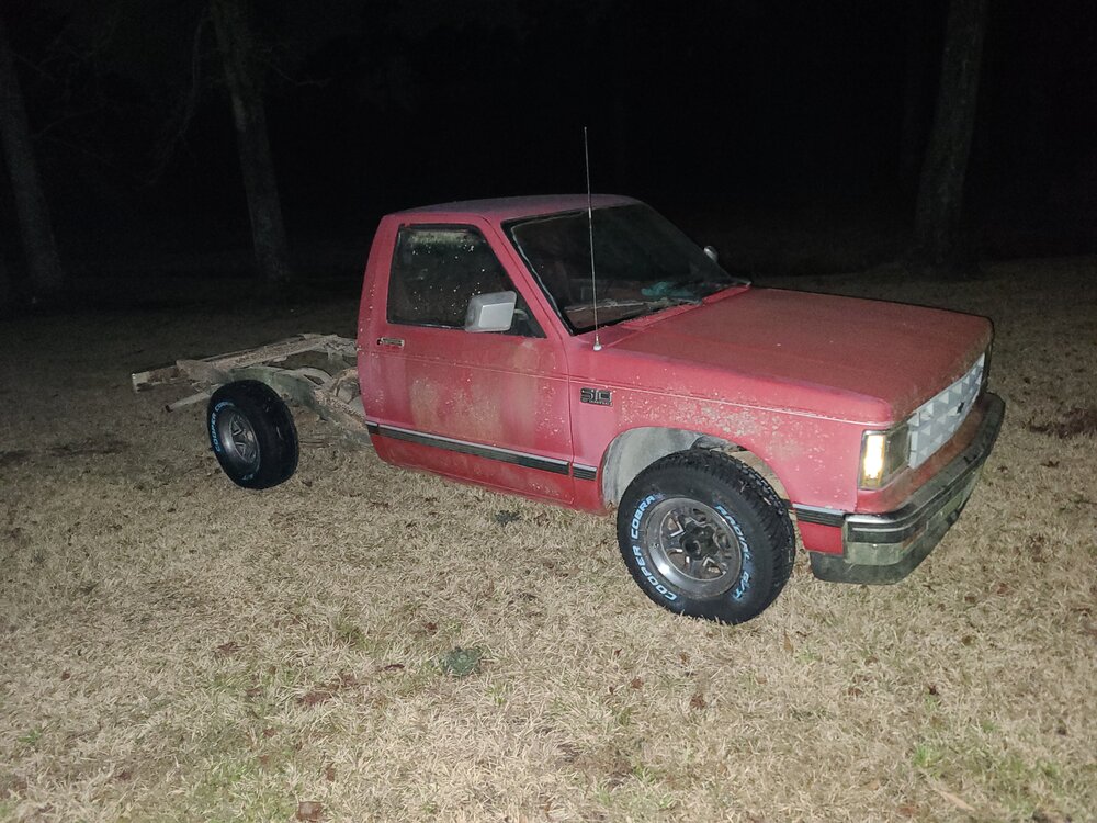

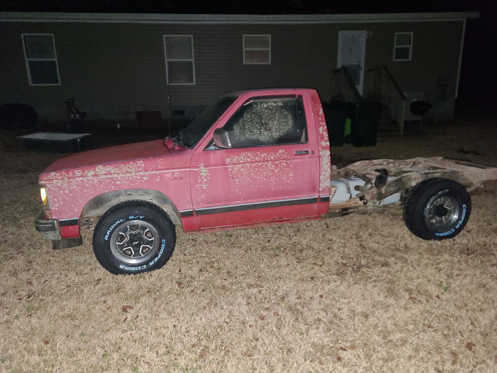

Got the old gas tank out, cut out the busted brake like that was (of course) behind the gas tank, made a new one, new rear brake hose, new gas tank in, new in-line fuel filter, new feed/vent/return hoses from the tank to the hardlines at the frame, and then bolted the new tires and rims on it. It fired right up. It's amazing how they'll do that as soon as you send some gas up to them.
Then I pulled it around to the front of the house, filled it up with water, and drove it to the end of the road and back! Oil pressure gauge, volt meter, and wipers don't work. They're likely a related issue and I'll dig in to that at a later date. I'm working on replacing the parts that I have and/or bought at the moment. After that, I'll start troubleshooting, but not before a good pressure washing...especially while the bed is still off.
Runs good though. Nice and quiet. I can't believe it doesn't have an exhaust leak somewhere around the manifold :rolleyes:

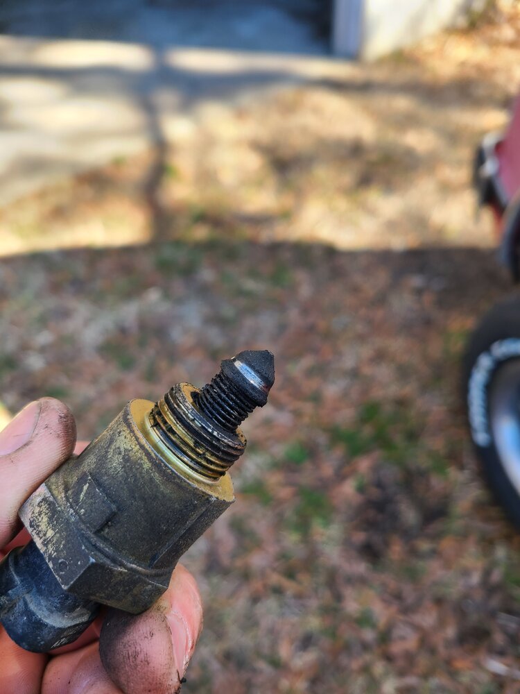

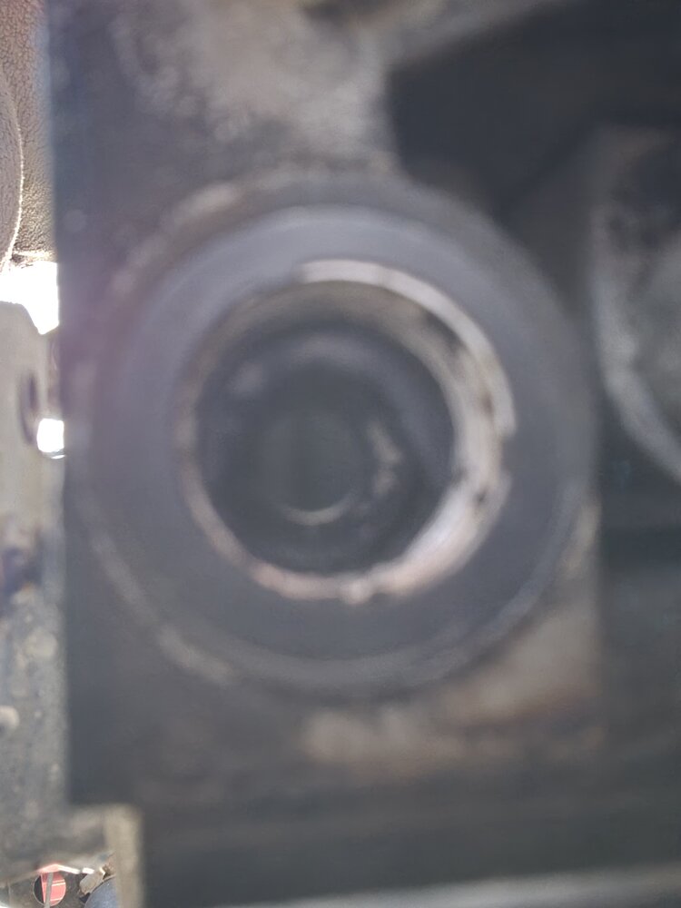

I did swap out the idle air control motor today. Runs better than it ever has. Definitely had some carbon built up in the IAC bore. The picture of the bore was with the front camera and too close, that's why it looks like I took it with a potato.

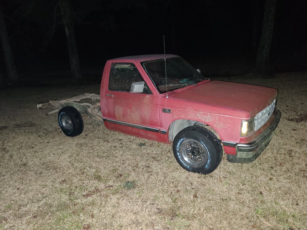

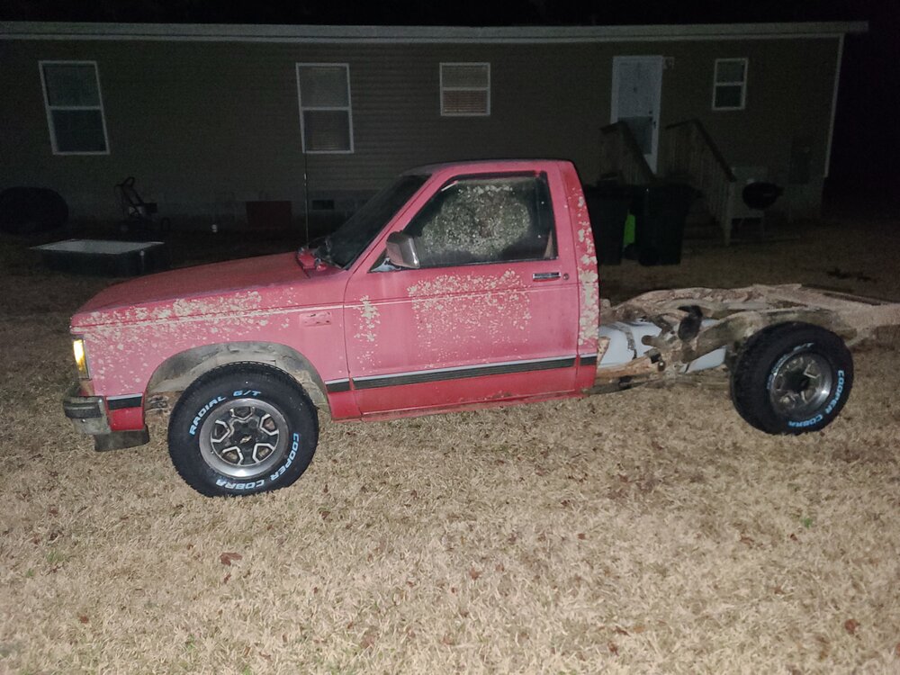

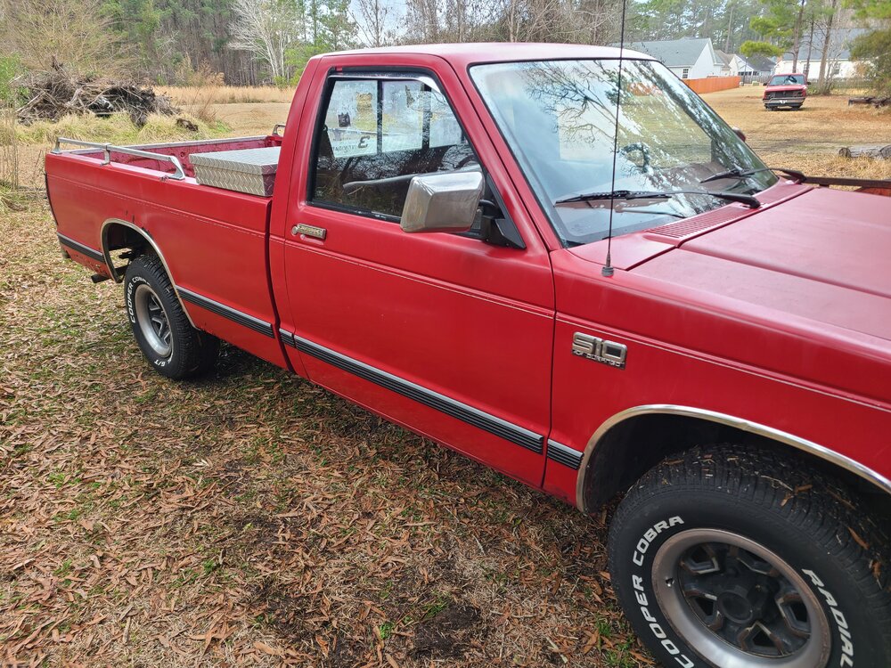

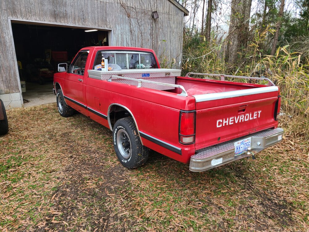

I got the last bit of super annoying things fixed today...somehow. Also scored some free parts!

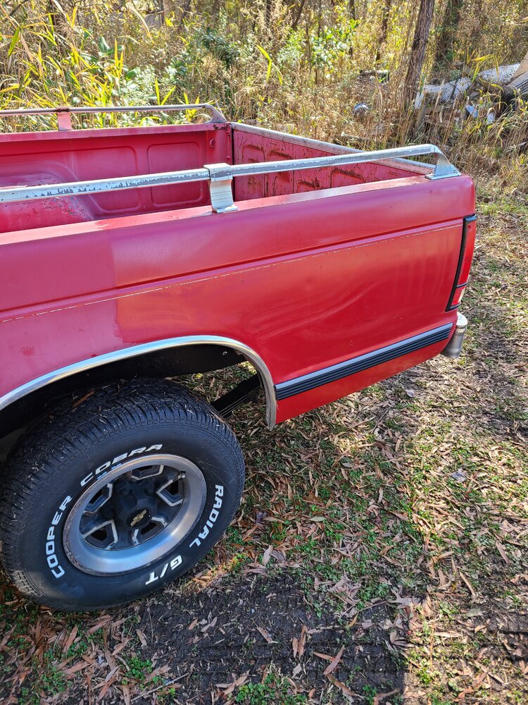

Stopped by my aunt's house and her husband gave me a set of door weather stripping, window channel felts, and the beltline mouldings :D I wasn't going to bother with them, but since I got some for free, I might as well. It'll give me an excuse to fix the regulator in the passenger's side door.
First thing when I got up today, I went out and rubbed it down with the Penetrol. It looks good and will be better after a second coat and a wipe down with a dry rag. The stuff dries really nice, isn't sticky, doesn't attract dust, and water runs off it like a duck's ass. From what I read, it'll last a year or more before you need to do it again. For 9 bucks, I'm sold. I only used a few ounces the do the whole truck. The key is to always wipe uniformly downward to make it look good and not atrract the eye to wipe marks or imperfections.

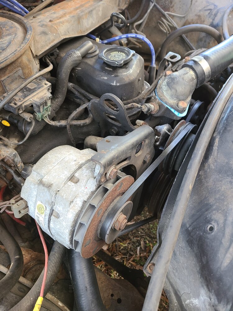

Then went over to the shop to mess with a few things. I tightened the alternator belt AGAIN. I think it's broke in and done stetching out now. No more 80s GM alternator squeal at start up. Next, I cleaned the hell out of the frame ground for the fuel pump/sending unit. The pump worked fine, but the sending unit/gauge did not. That must have been it because it works now and the pump sounds a little better. A win/win situation.

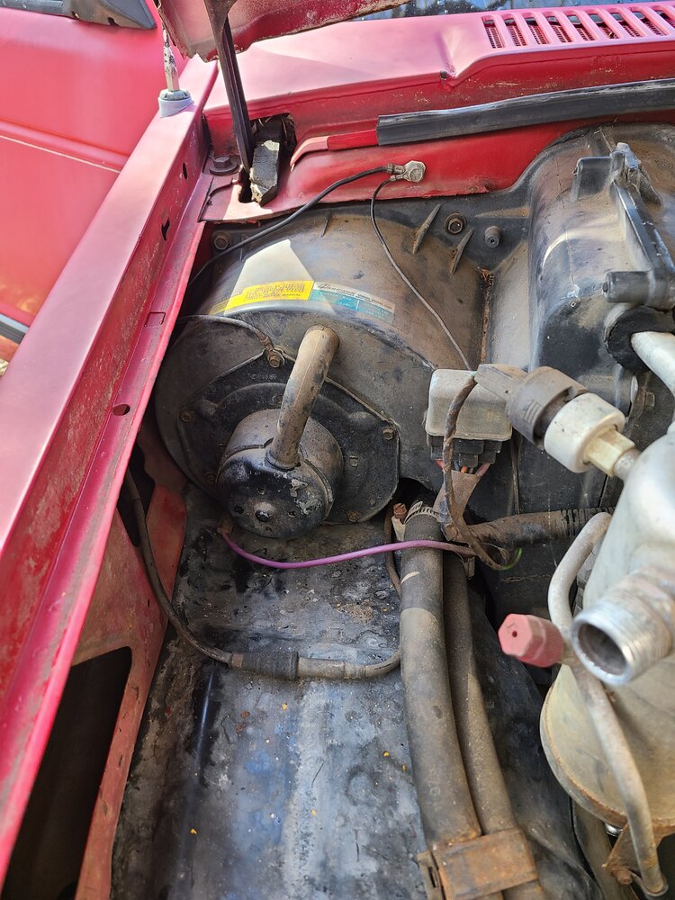

Fiddled with the blower motor. I had gotten it working when I drove it years ago. I moved the ground from a bottom screw to the top one that is MUCH easier to get to. Then I took off the little vent hose and shot some WD40 on the bearings. Lo and behold, I have a functioning blower motor and don't have to depend on the forced air through the cowling to give me heat!

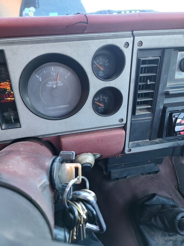

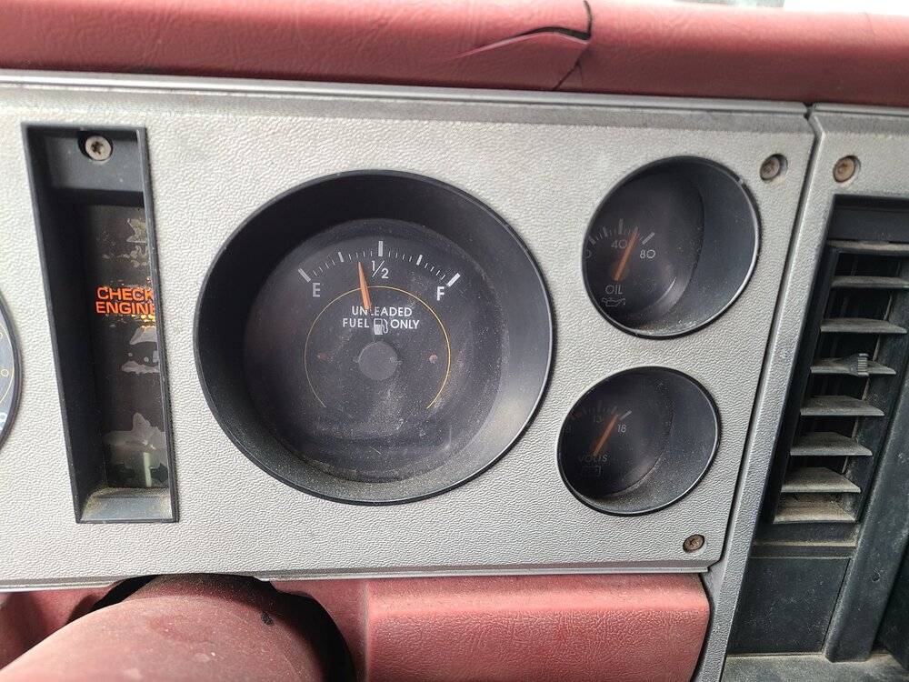

I guess messing with all those grounds jump started the oil pressure gauge and voltmeter too. They suddenly started to work. It was a welcomed, yet unexpected side effect. I was shickled titless! It was a good day!

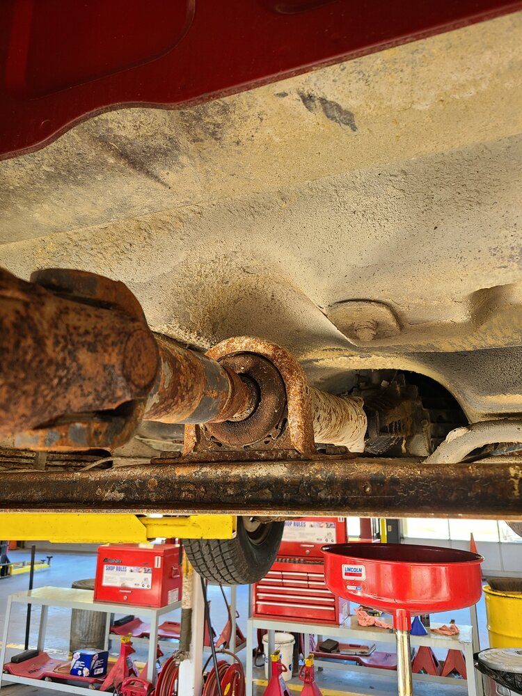

Oh, and I got smart and hit the grease zerk on the driveshaft. Who would have thunk...no more driveline vibrations! It's the little things, really :driver:

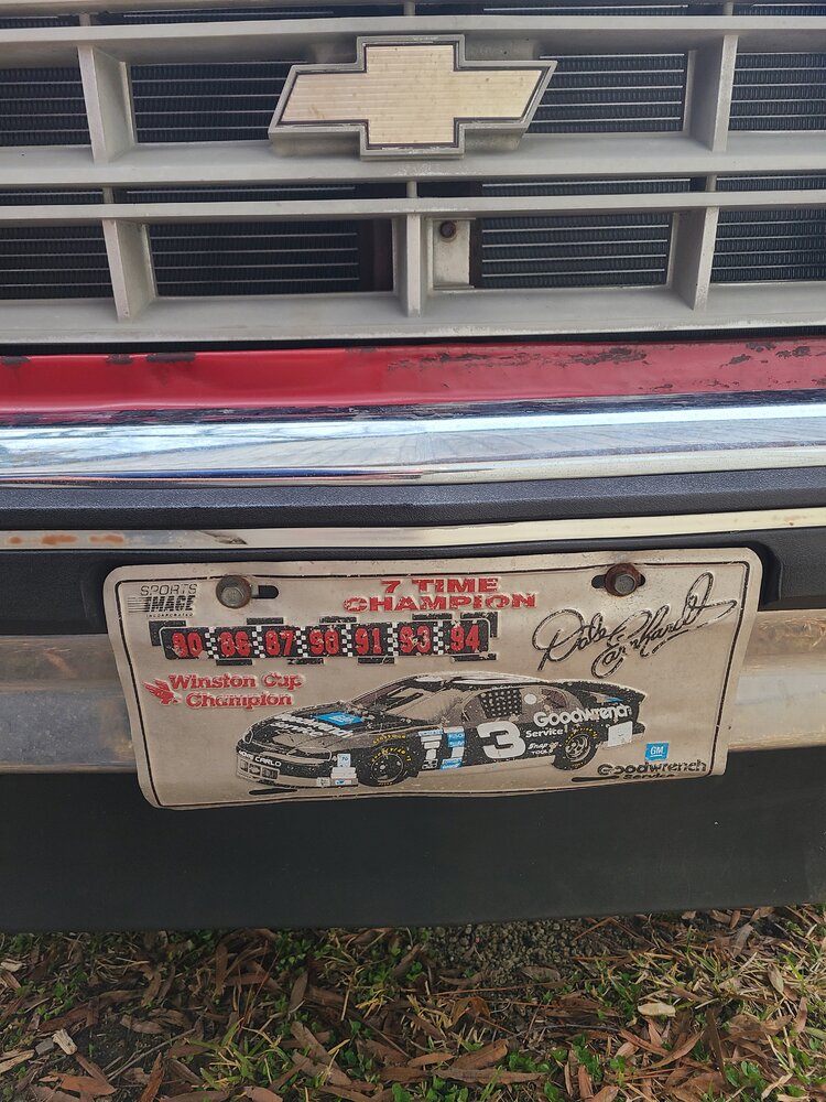

Lastly, I texted @77GreenMachine and told him I did it for Dale!

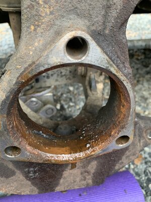

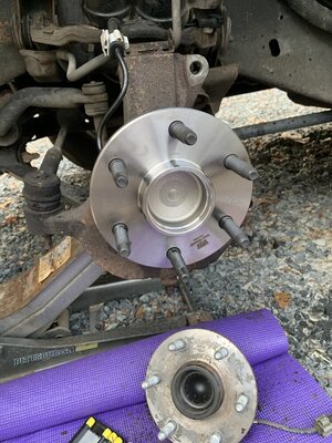

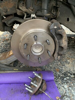

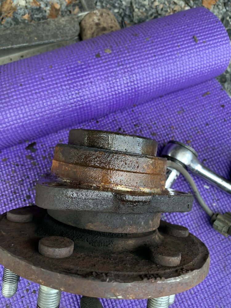

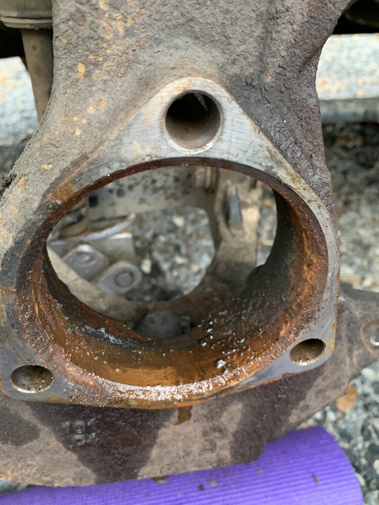

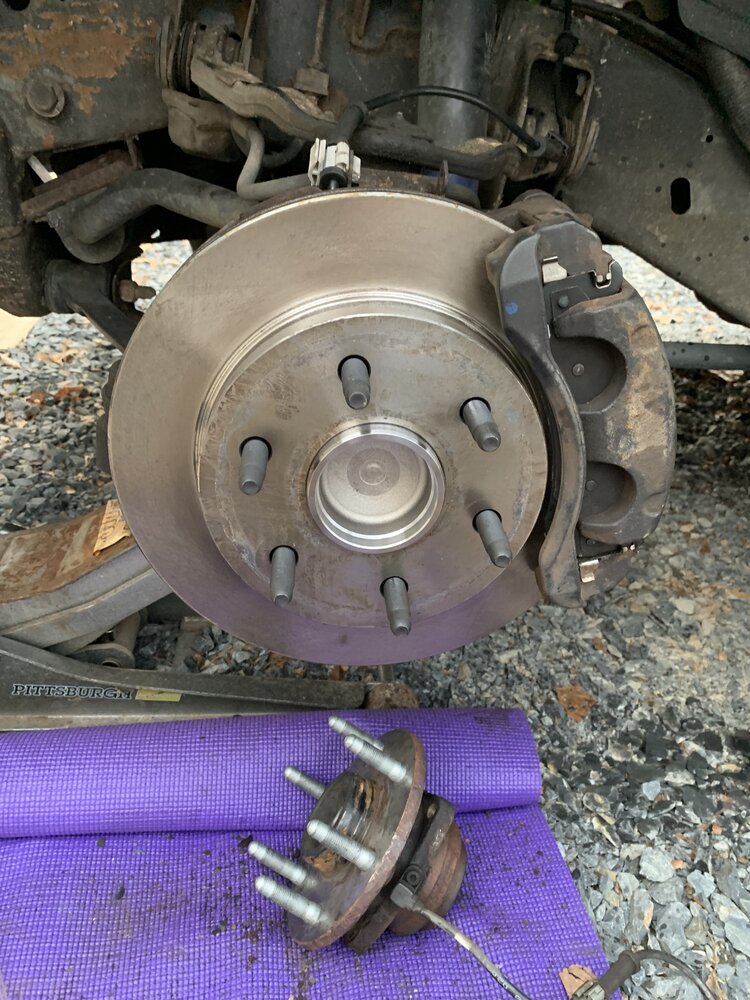

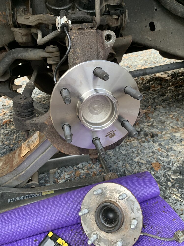

Did brakes and rotors on the Tahoe the other day and noticed I was in need of a new wheel hub. So ordered one and got around to installing that today. That thing was IN there too, beat the hell out of it for a few minutes before it finally came out. I forgot the dust shield at first but it’s in there now. Working on this thing is becoming a huge task, every 30 minute job on it turns into 3 hours

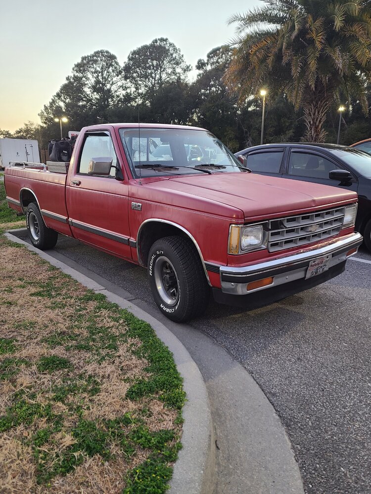

Well, filled it up with gas this morning. The first tank worked out to 16 mpg, but there was a LOT of idling and then the issue with the IAC valve.
Anyway, headed out for Beaufort, SC and ran it down 95. I ran mostly 70mph, but sometimes 75 for a little bit. 70mph is somewhere around 3100 rpm. I haven't measured the tires, but math says they're 26.25" tall and I used 26" even for my equation.
Made it all the way to Beaufort and filled up at my favorite Parker's just before you get to the hotel. Get this, 20.5 mpg! That's not too bad for what it is.
I also got fed up with the craptastic Gates belts I got from RockAuto and went to Advance and got some new Daycos. I think the ones I got were basically V shaped rubber bands. I tightened them yesterday for the fourth time and after I filled up with gas, they squalled and hollered and made racket for a solid 5 minutes. I could stretch them by hand. New belts, problem solved. It's like comparing canvas Cahartt jeans to yoga pants. Yall get the picture. Stretchy vs rugged and stiff.
I even got a few looks on the road for my sweet paint finish and likely because I was only going 70. It did good though. Coolant temp and oil pressure were solid.
Did you coat with antisieze before sticking the new one in, so you wont have to beat it out in a yr or 2?
