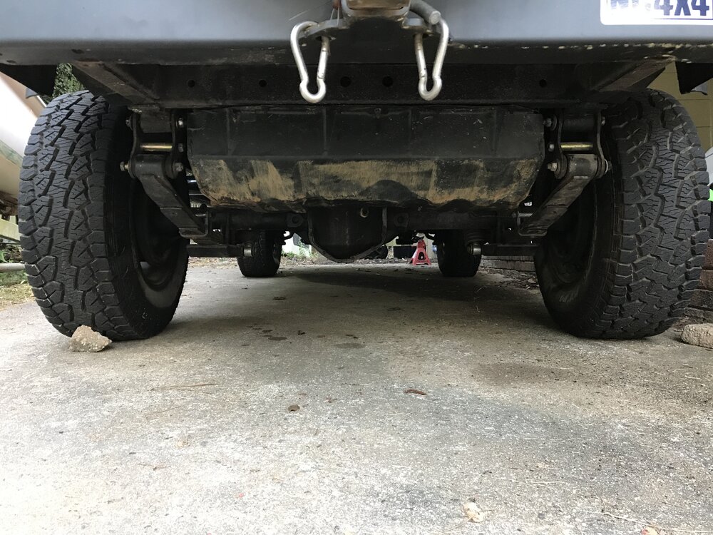

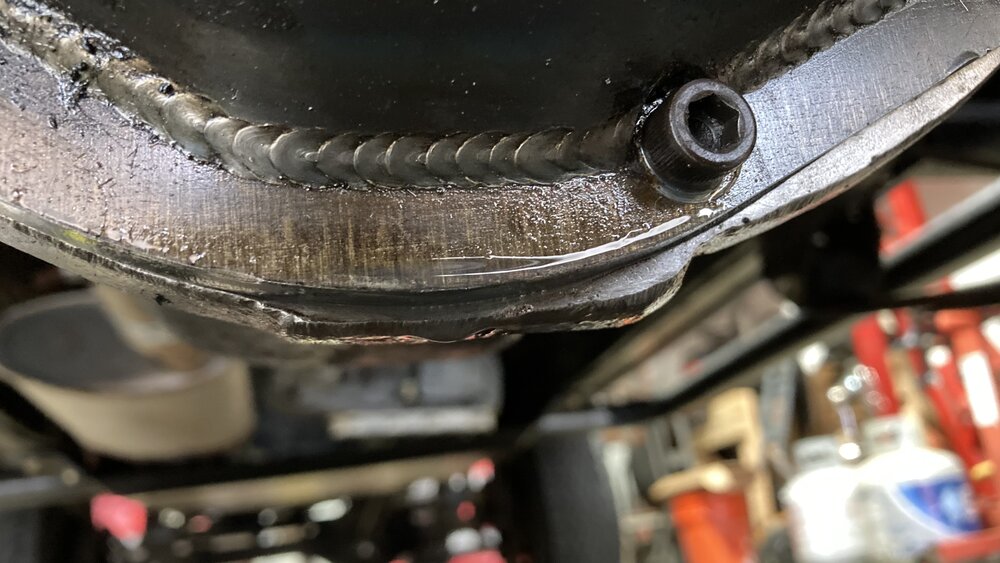

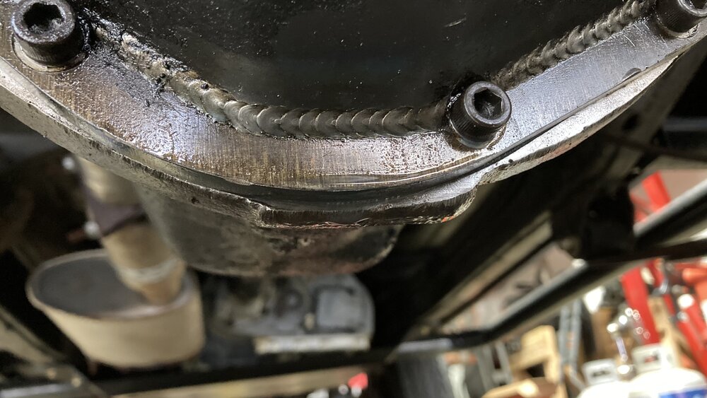

It took me five freaking hours to replace my leaking RTV gasketed rear diff cover with a lube locker yesterday.
Removed the cover, cleaned the mating surface on the Barnes diff cover, wiped the center section out and cleaned that mating surface, lined the gasket up, threw the diff cover up there, started the easy bolts (bottom 7), got the two outer top bolts in, and the center top would not go in. I could get a few threads started then it would bind up like it was cross threaded. Dammit.
Took the cover back off, tried the bolt, couldn't get it started. Brought out the tap, cleaned it up, threw the diff cover back up there, started the easy bolts (bottom 7), got one outer top bolt in, now the center and the right top would not go in. WTF!?!
Took the cover back off, tried the bolt, couldn't get it started. Brought out the tap, cleaned all the threads up, ran the bolts through a die, threw the diff cover back up there, started the easy bolts (bottom 7), got one outer top bolt in, now the center and the right top would not go in. Ran the tap in the holes with the diff cover up there, had to wiggle the two bolts to get them started right and they finally went in. Fuuuuuuu that was annoying.
I should have jacked the Jeep up so I could access those top bolts easier, but I was trying to do it "quickly" in the middle of the day. With the 20 gallon tank in the top bolts are hard to get to, compounded by the larger Barnes diff cover. There's about 1" of clearance between the diff and the gas tank.
View attachment 389499View attachment 389500
On the bright side the diff doesn't leak anymore. Now to get the D300 to stop leaking....

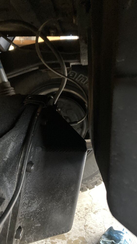

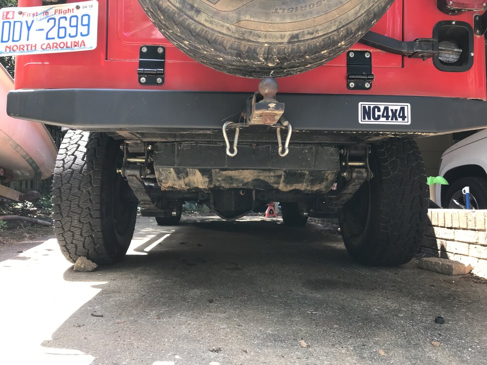

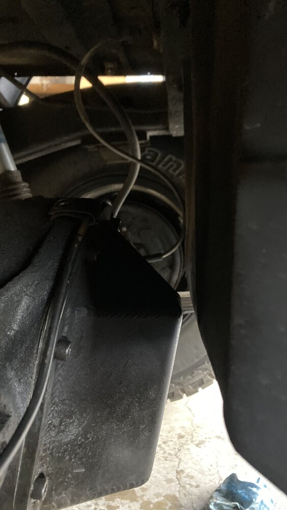

Here’s how close it is.

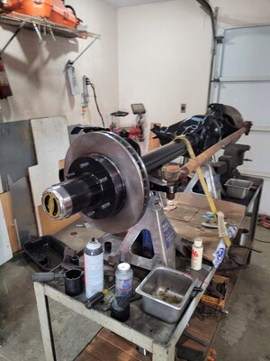

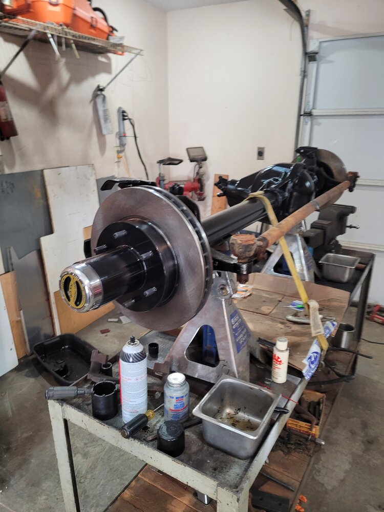

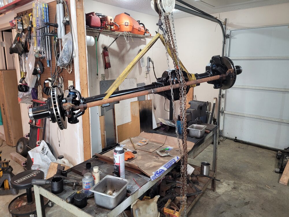

Finally moving off my table! Just need to rebuild the calipers and add brake pads. Next is converting my rear axleshafts to 6 on 5.5

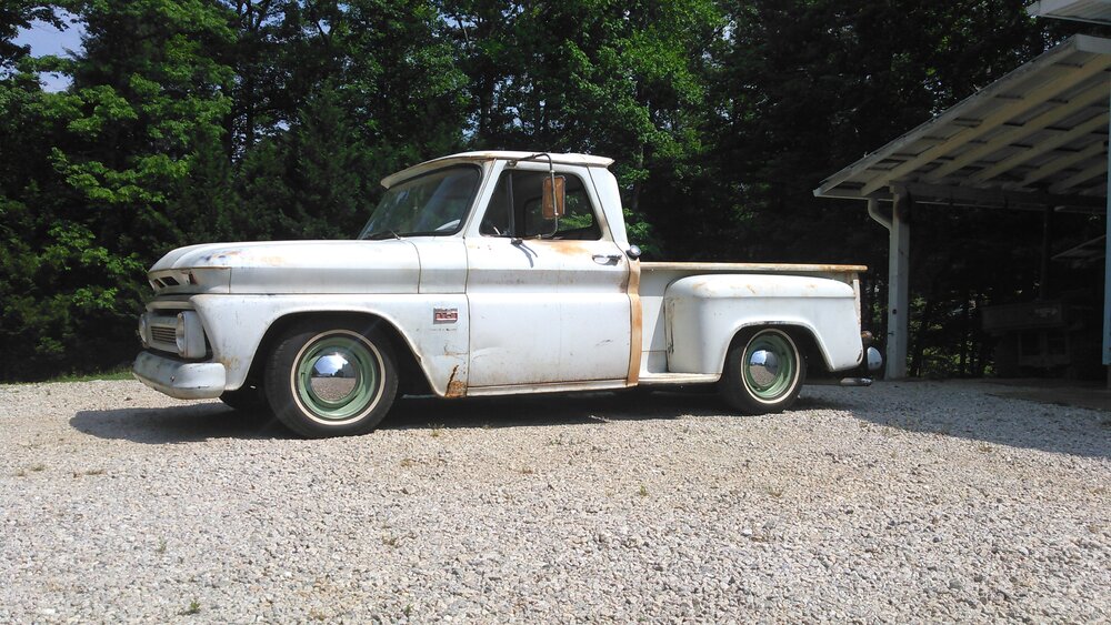

fired up the EB for the first time in a while, mostly bled the brakes and steering, and moved it to the other side of the shop. Also, put a new weber on the old truck. Got it to idle, but its going to need bigger jets.

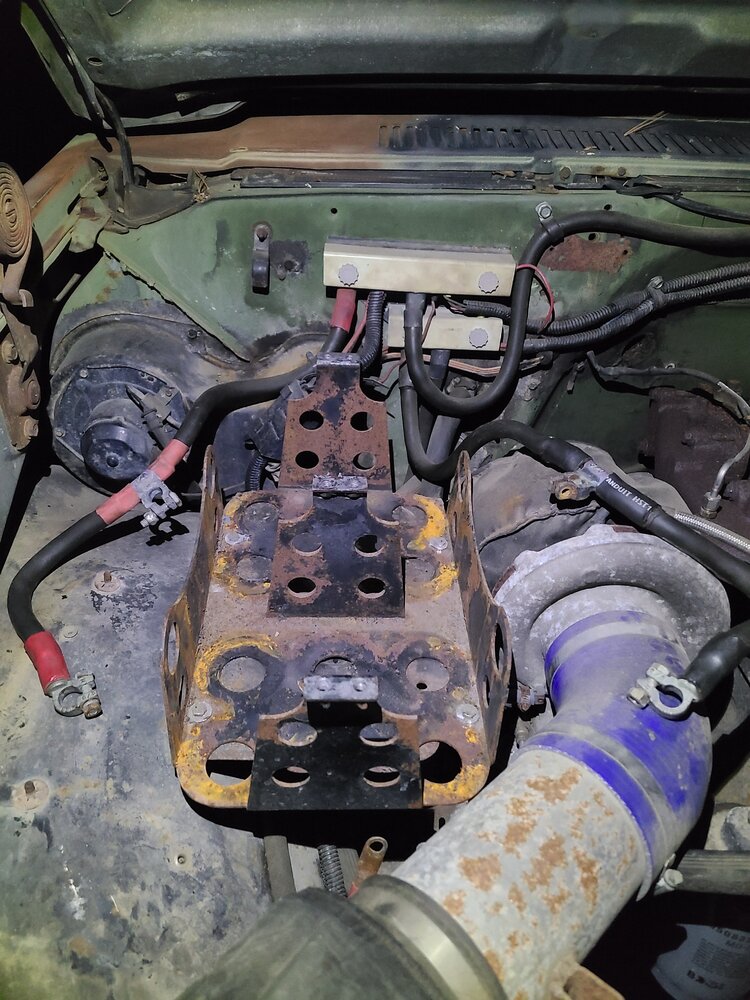

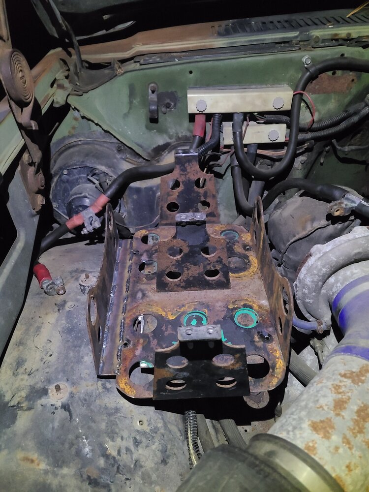

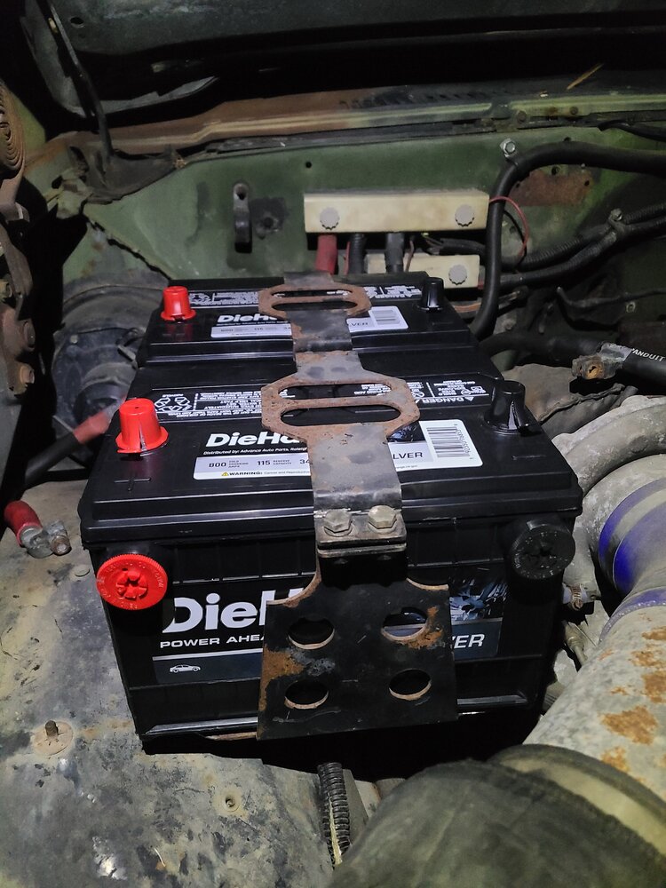

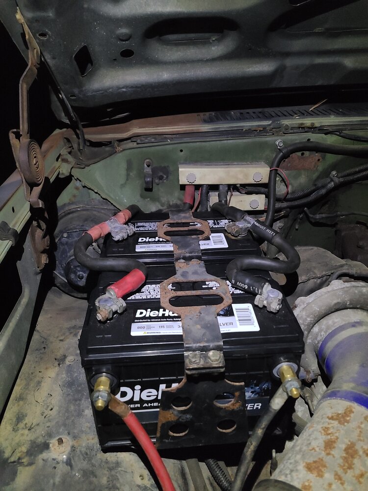

Had to widen the Ruff Stuff battery box. Naturally, nothing else is the same size as an Optima...which is fine, I won't be using any more of those. The old Red Tops started going downhill almost as soon as I bought them, but I limped them along for four years with an Optima DC-1200 battery charger. They got to where they wouldn't hold more than 12.1 volts.
Now I've got a fresh 2000 cranking amps and I wish I had done it years ago. I got out for 160 a piece. Not bad! I'm glad somebody else make 34/78 batteries that are still 1000 CA and 800 CCA. It fires up nice and fast now...again.

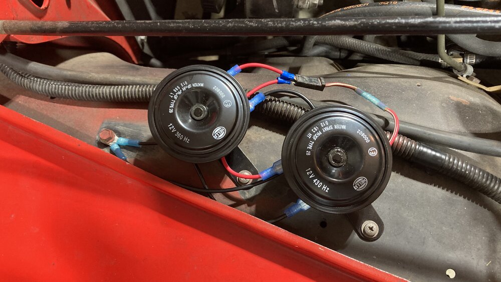

Put some universal horns in today to replace the OG 1982 CJ horn that was in the Jeep.

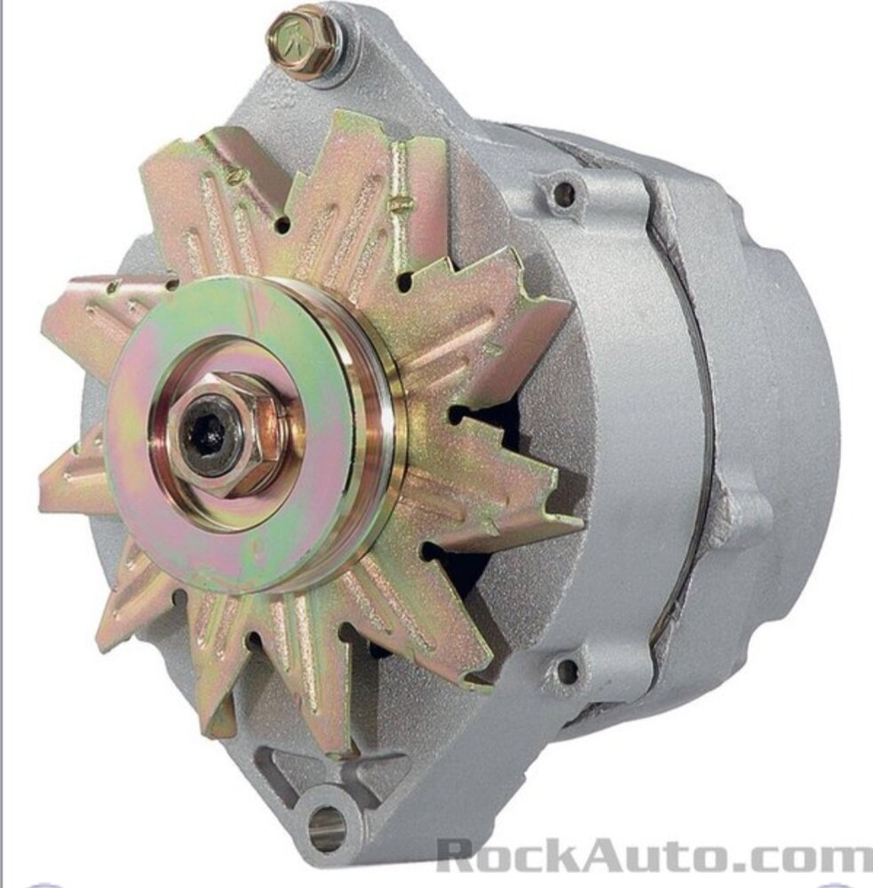

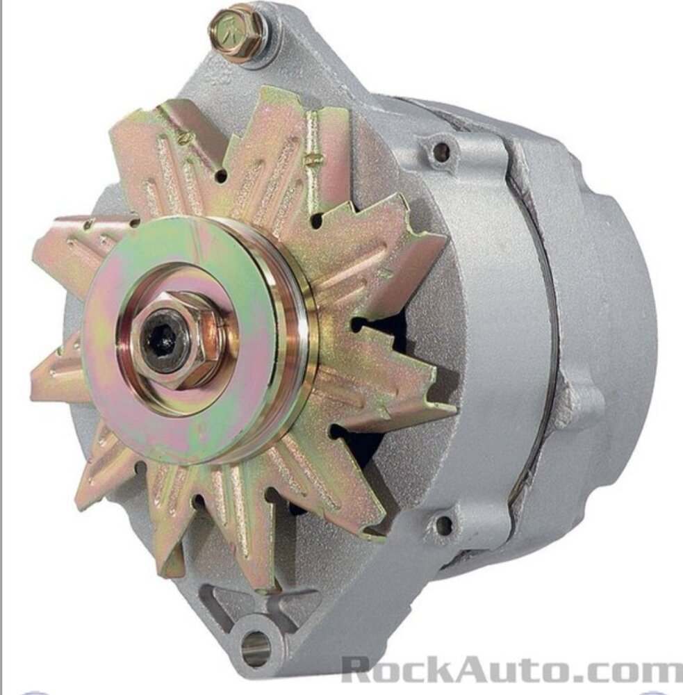

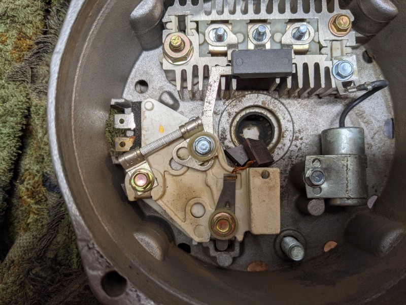

Does it have a Delco 10SI alternator? Has a through hole on the bottom and a threaded hole up top for the belt tensioner bolt? External, metal fan? Looks like the picture? If so, the capacitor in it is probably bad. They're there to filter noise.
Take the back half off and you'll see it right in there on the case.
After learning way too much about alternators, thanks to an ADHD fueled hyperfocus, I'll probably never replace an alternator again. The parts are STUPID cheap and they're really easy to fix.
If you have a 10SI and want more juice, you can always bolt in a 94 amp 12SI (1985 S10 with a 2.5L) or even a 120 amp CS130D, like this one. It puts out about 60 amps at idle and is only 90 bucks in the "bargain bin" section on the PA Performance website. You can also make any of those a 1 wire, self exciting setup.
Thanks for coming to my T.E.D. talk 🤣 Hope some of that helps. If you need a hand looking up parts, just holler at me.

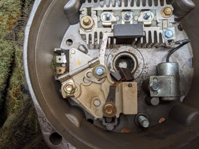

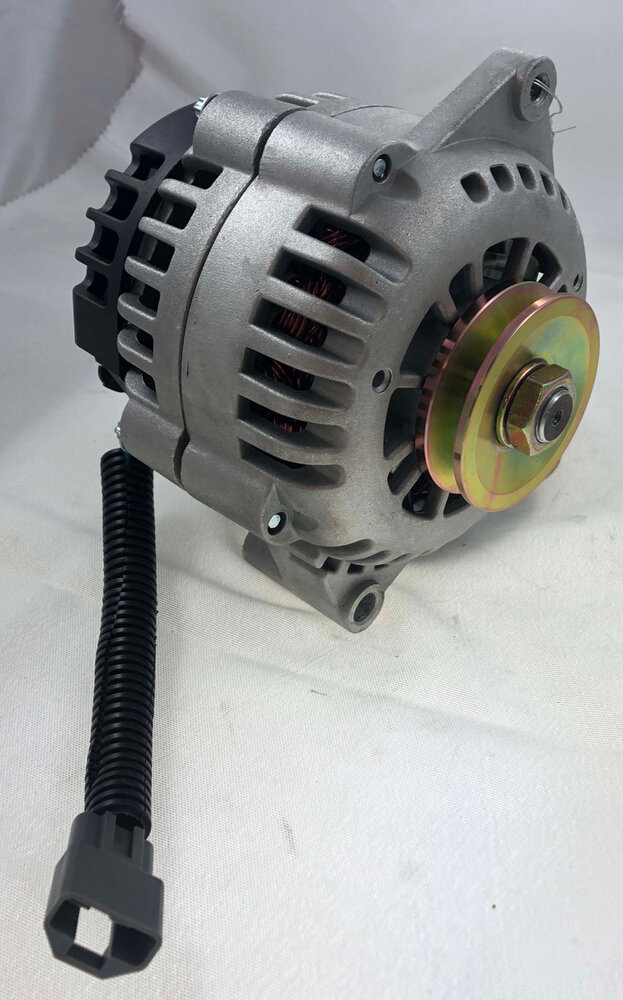

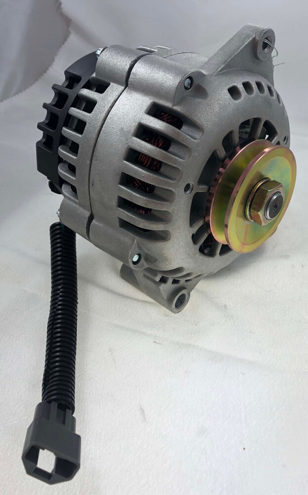

Speaking of alternators...

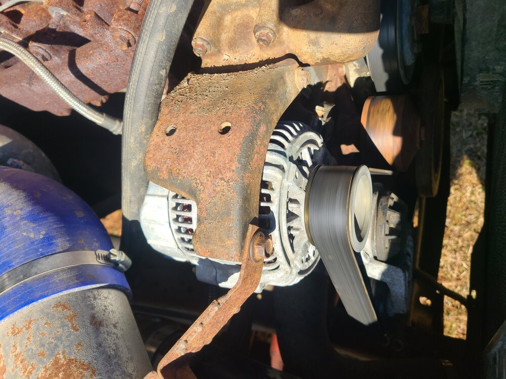

I gotta shout out to PA Performance. They definitely look out for their customers! I bought this alternator from them in May of 2010...yes...it's almost 13 years old. I had called them and asked if they'd sell me a new voltage regulator, but they said they didn't sell them individually. However, I could box it up and they'd email me a shipping label. He said it might cost me 30 or 40 bucks in parts, but...if I had the original invoice, they'd warranty it. Luckily, I had kept it for some reason. 2010 was before they had a nice, computerized sales system and I wasn't in their system. Hence the need for the invoice.
After I replaced the bearings and put it back together, I bolted it back in the truck with those new batteries I got just to check it. It was charging at 15.2 volts and that's a little much for my liking, so I sent it back. I sent it out last Thursday and it was sitting on my porch yesterday when I got home. That's pretty speedy! It didn't cost me a dime for shipping either way and when I looked at the packing slip, they replaced the voltage regulator and brushes/brush holder assembly...for FREE! They're good folks in my book.
I bolted it back in this morning. A solid 14.3 volts and no more having to rev it up to get the regulator to start working. Freaking sweeeet. I also found the part numbers for the regulator, brushes, bearings, rectifier, diodes, etc while I had it apart and took pictures. Denso and Delco alternators are pretty simple.
Nothing special, but here it is in all of its electrical glory. I noticed they also use a slight underdrive pulley; which is nice for keeping the amperage output up at idle and lower RPM.
Next alternator project is the 12SI in my S10. It's got a very undersized charge, needs a new pulley, and probably bearings. If any electrical accessories are on when you crank the truck, it gives you the famous, GM v-belt screech. High beams and blower motor on high? Pfft...forget about it. That belt is gunna holler. There's some reason the alternator is hard to spin (bad bearings? Shitty wiring making it have a higher load on it?) and the pulley is highly polished from the belt slipping for so long. Doesn't matter how tight you get it or what belt you try.
I may nab this setup and get it over with and throw on another new belt.
