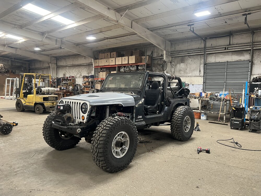

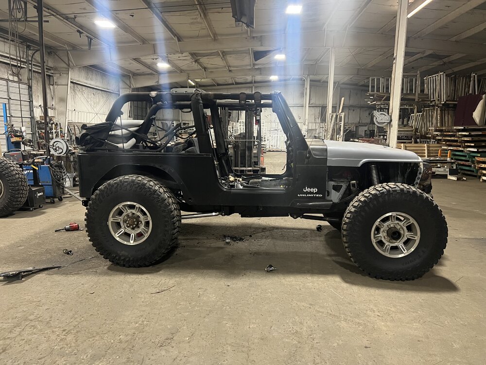

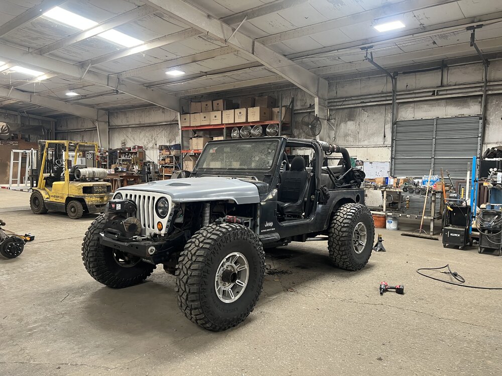

I also washed off the ranch, put the new sneakers on her and got it inspected. Got to love Rockingham County going to safety only now. Had to reprogram it for street and it never would have passed emissions due to monitors not set.

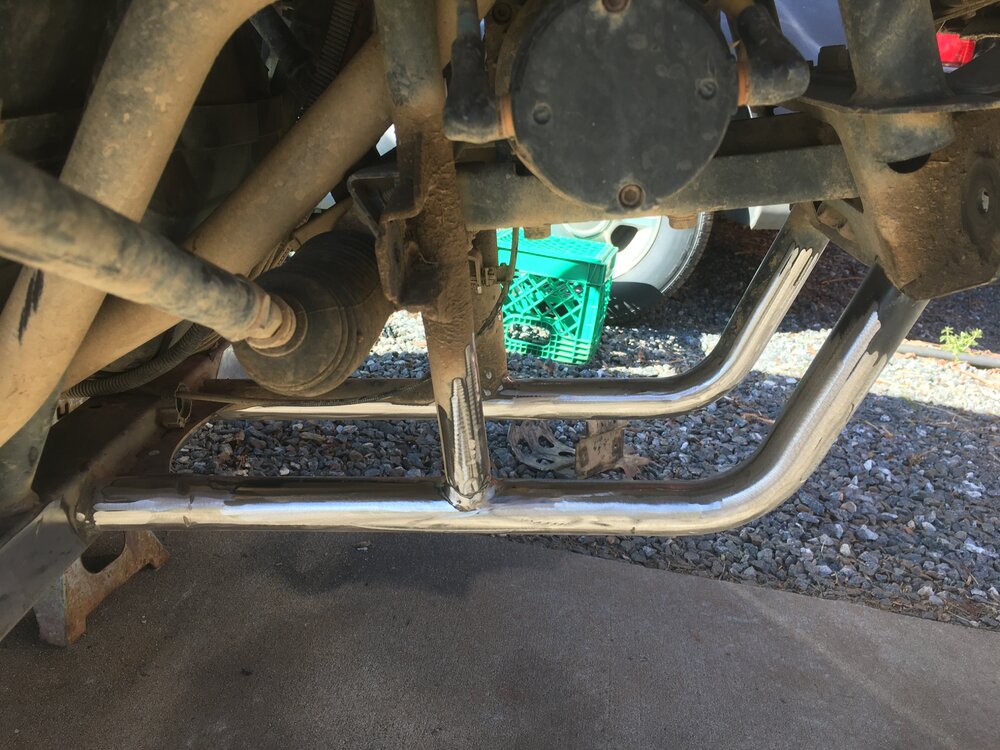

Went to swap in the 1000 diff in the little wheeler only to realize the company sent me a replacement skid plate and not a swap skid plate. :mad: I bought that expensive ass piece of metal to make this a one day job (which it would have easily been) now lord knows how long it'll be.

What is the secret sauce to getting tires that clean? I put tires cleaner on them and scrub them down and damn if they still don't look dirty. I gave up and just pressure wash the dirt off and leave them now.
New tires. :D

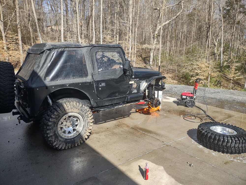

I jack the front up, put the Atlas in front dig mode, turn on the locker, then put it in 2nd gear and start the ignition (I've pulled the fuse on the clutch relay so I can start it in gear without depressing the clutch). While the front wheels spin I pressure wash off the bulk of the mud. Then while the front wheels are still spinning (my second gear is +/- stock gearing 1st gear so not spinning fast) I use a pump sprayer filled with purple power to soak the tires. Being very careful not to get it on the wheels. Then I rinse with the pressure washer. Since the treps have SO many edges you have to rinse in 3 directions or you'll end up missing a lot.
Then I cut the ignition and remove the wheels and lay them down on their backs and use chemical guys wheel cleaner on the wheels themselves.
Then I use the pump sprayer with purple power and spray the wheel wells, axles, undercarriage...etc and let that soak for a bit. Then pressure wash that till it's clean. Slap the front wheels back on and move to the back to repeat the process.
It's a lot of effort, but my OCD won't let me NOT do it. I wish I COULD just rinse off the big stuff and go back out, but I wouldn't be able to sleep at night. :dumbass: Trust me...I don't enjoy being this compulsive

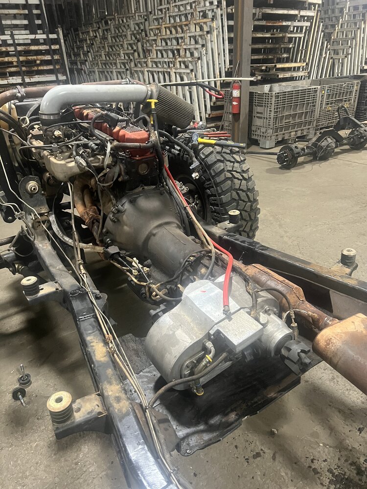

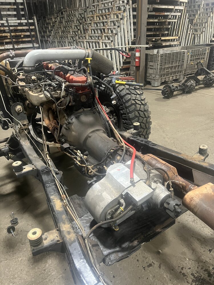

I would fishplate that frame junction, but joints in bending are a no go even with good welds
There’s a 22“ long sleeve inside the rails centered on the junction. I‘m not worried about it. The two link mounts are tied together along the bottom of the rail too. Thanks for looking out though.
It took 5 days to get a reply with the company and just now getting a return label for the product. Looks like I'm not going to make my ride on April 1st.
I use Awesome brand cleaner from the local Dollar Store. Spray on, pressure wash off.

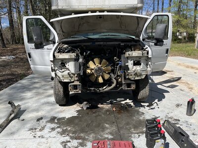

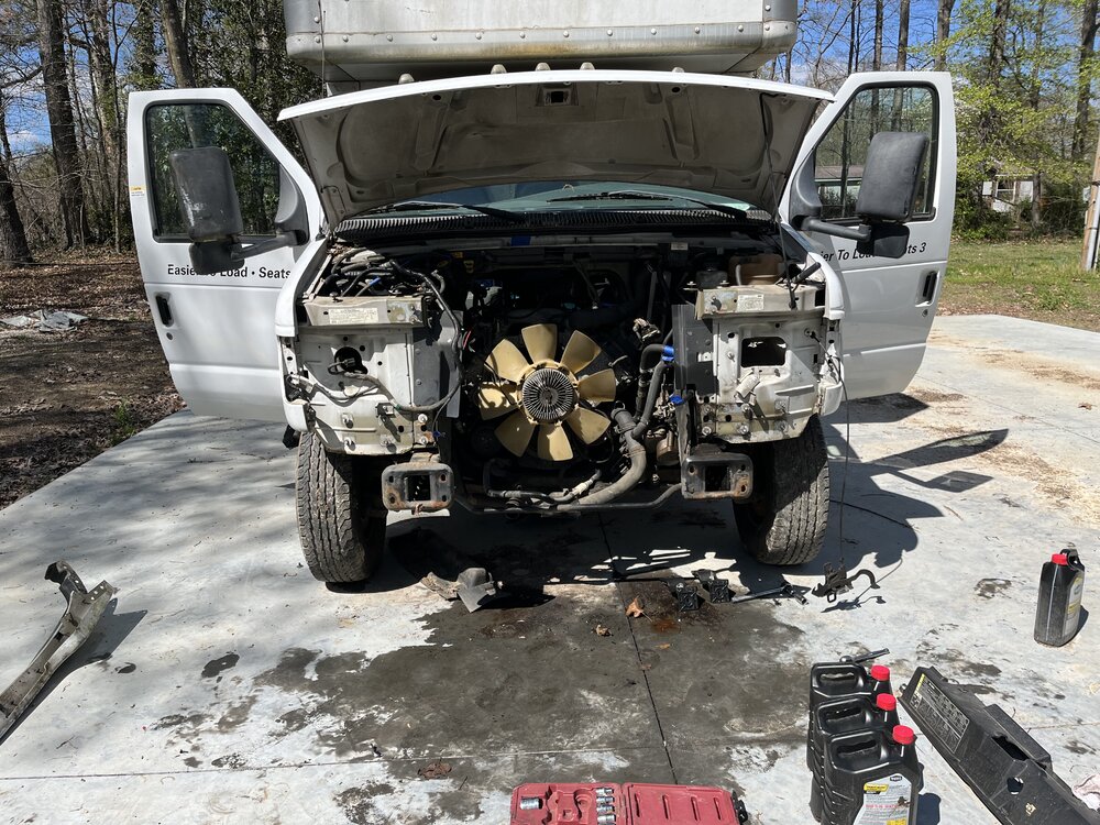

Been working on pulling the motor in order to replace all the manifold bolts. At least half are broken off in block on driver side, so far at least 4 heads of bolts are broken on passenger side. With so many broken off and limited space to work in engine bay, I decided removing engine for repairs would be easiest

Troy - you need comet and a toilet brush. That’s the secret to tires . Then after the comet shine then with whatever. Much quicker than your process
Regular tires I would agree 💯
But treps have 768% more surface area to them than other tires 🤦‍♂️
much more effective to stand back with beer in hand and spray while tires spin (both with the pump sprayer and pressure washer)
