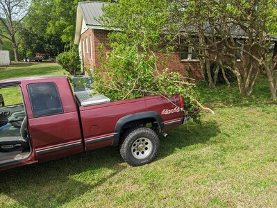

Used it as a wheelbarrow. Got carried away trying to clean my yard up and wound up trimming the crape myrtles in my side yard. I need to limb them up but I don't have a chainsaw right now.

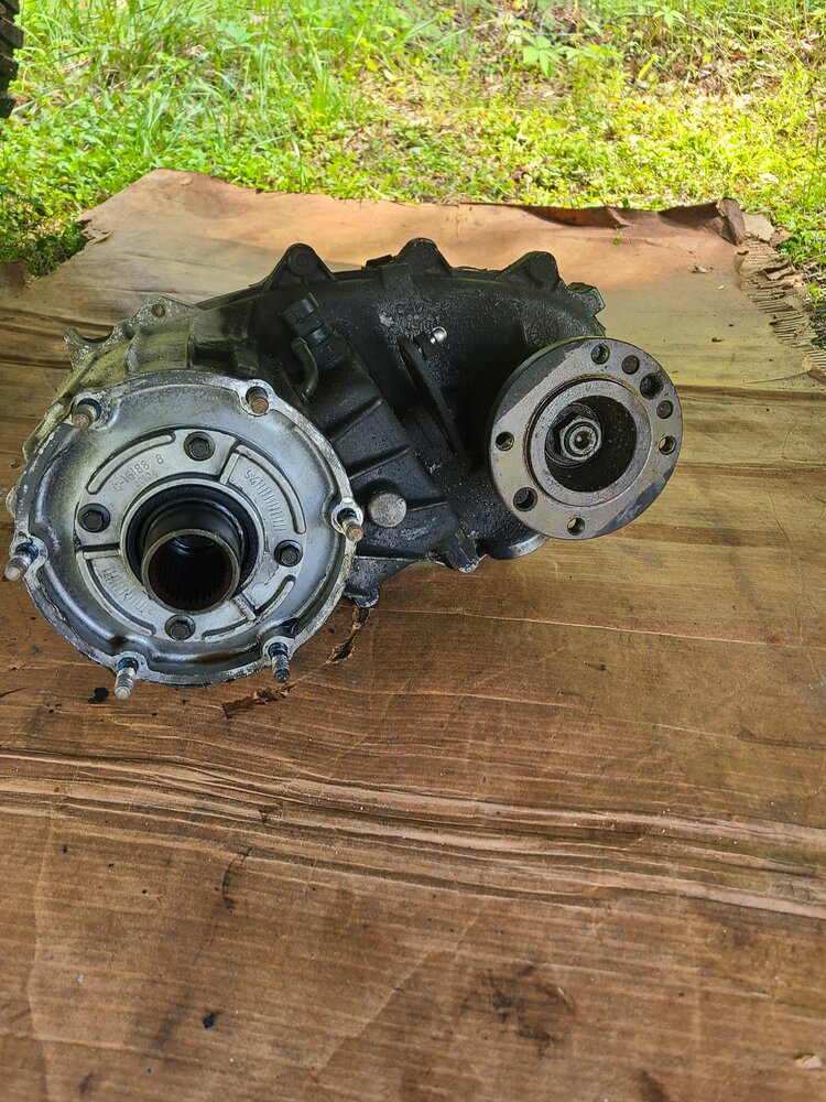

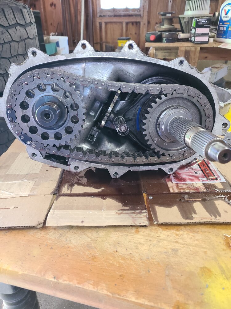

I pulled the transfer case out today before work. I'll get the internals swapped over to the new case tomorrow and bolt it back in the truck 👌

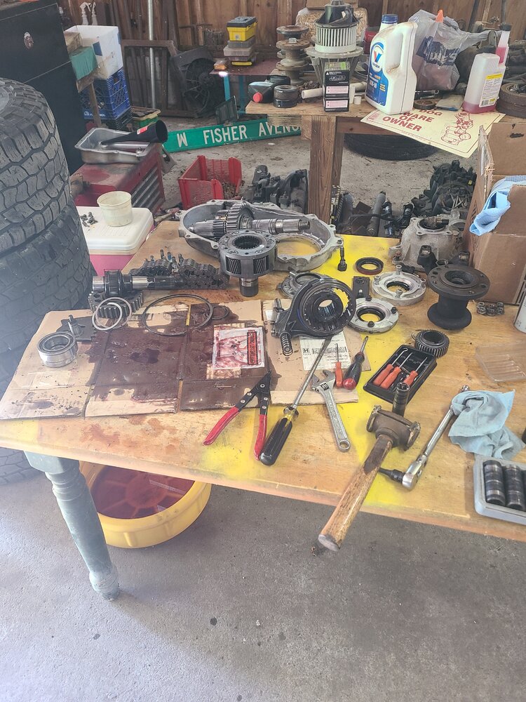

Anyway, making progress on the transfer case for my '99. Gotta tear apart the "new" one and swap the guts, but the old one is torn down and inspected. It looks better than I rightly expected it to, so I'm happy with that.
Once that's done, it's back in the truck, and mobile...I'll go give it a quick washing and get it inspected/tagged. Then it's getting a slew of new parts and upgrades. I'll probably drive it for a little bit to make sure all is well before I post it back up for sale again. I just didn't want to sell anyone a project. It'll be ready to go or modify to their liking upon arrival to its new home 👌

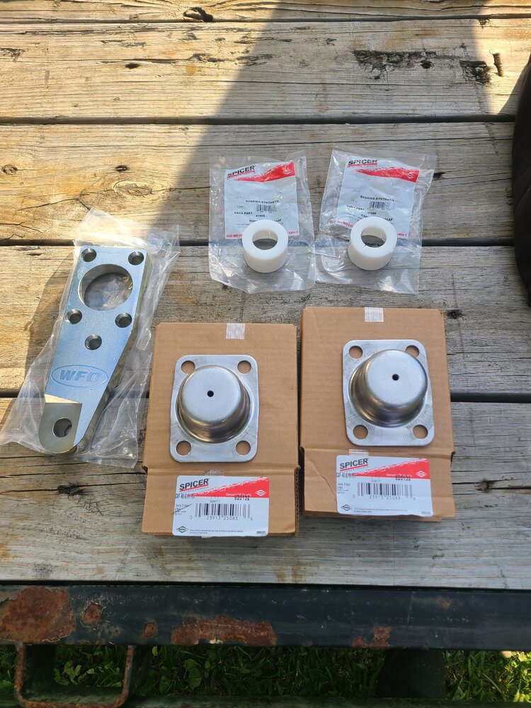

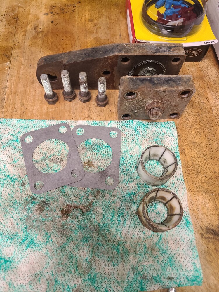

I've got a PSC steering box, PSC pump, 2011 hydroboost unit (I'll swap the master for a 2500HD if I feel like it needs it), new lines, I'll probably go ahead and add hydro assist since the box is ported for it, WFO frame plates to clean it up, new shock towers, new steering arm (has springless arms on it now and they're annoying to keep adjusted), new upper kingpin bushings, cam, timing cover gasket kit, and valve cover gaskets.

Got it all buttoned up and back in the truck yesterday. Going to pull it up on my trailer in a little bit so I have a solid and dry surface to work on while I go through the front end. For whatever reason, that was the worst of it for me. The rest will go much quicker.

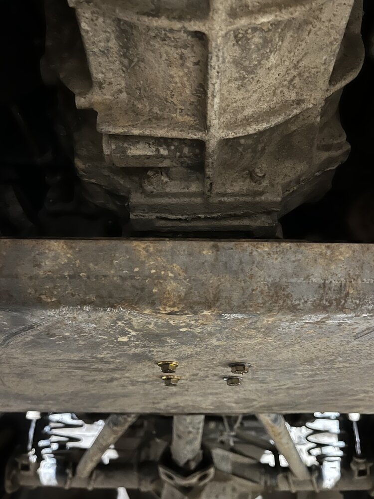

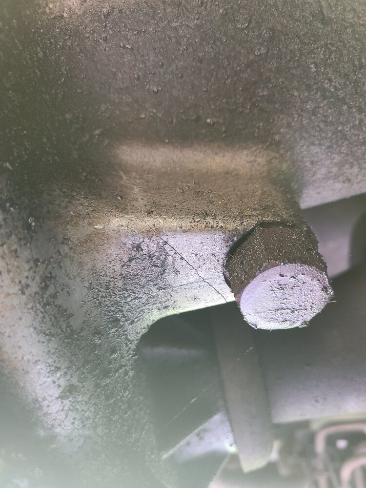

I'll probably have to cut a nub off the top side of the transfer case that's really close to the body. I don't remember doing that to the old 241, but that was 11 years ago.

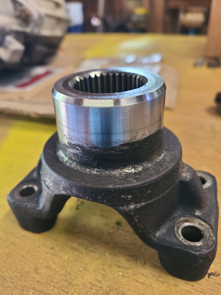

Oh, in case anybody is wondering...the JB Conversions SYE for a 241 can use a 205 yoke. I like to run 1410 rear shafts. I just had to shorten it, reestablish the bevel, and get the correct seal.

I took off the springless steering arms and put on the normal ones with springs. They're kind of a pain to keep adjusted on something you drive on the road. However, they are definitely for sale if someone wants them!
