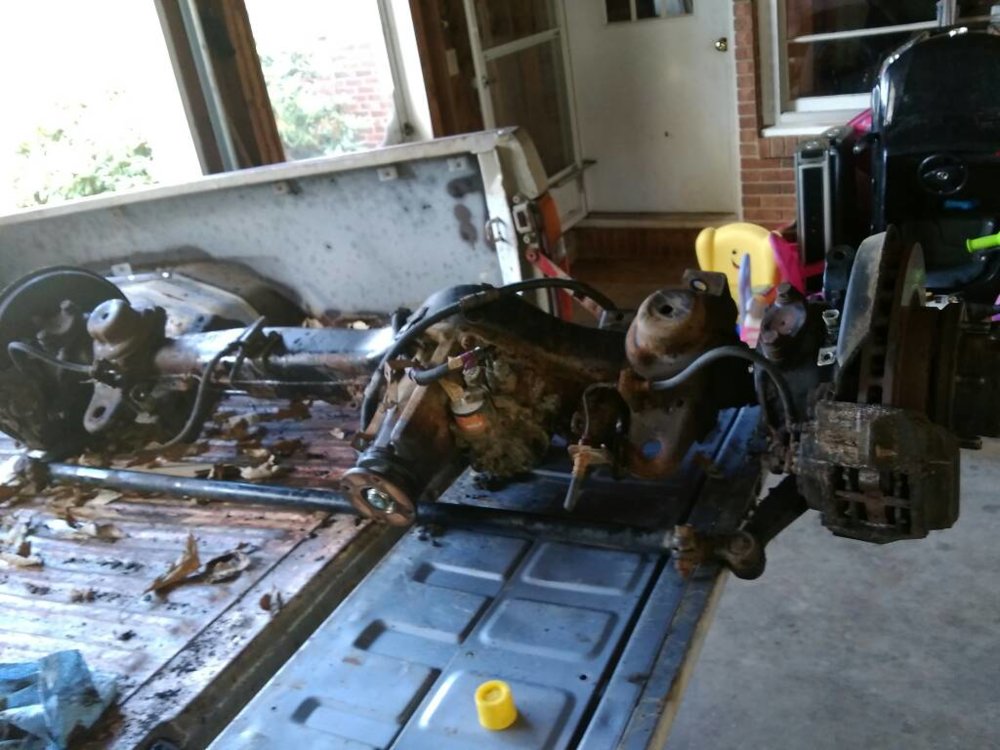

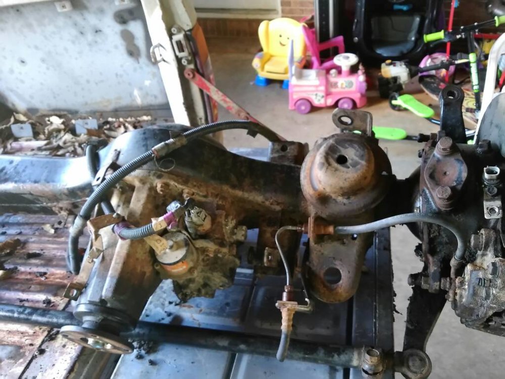

Picked up a e locked front for my 80 series and ran 5 wires from the rear locker to the plug under the dash now all I have to do is install the heavy ass things

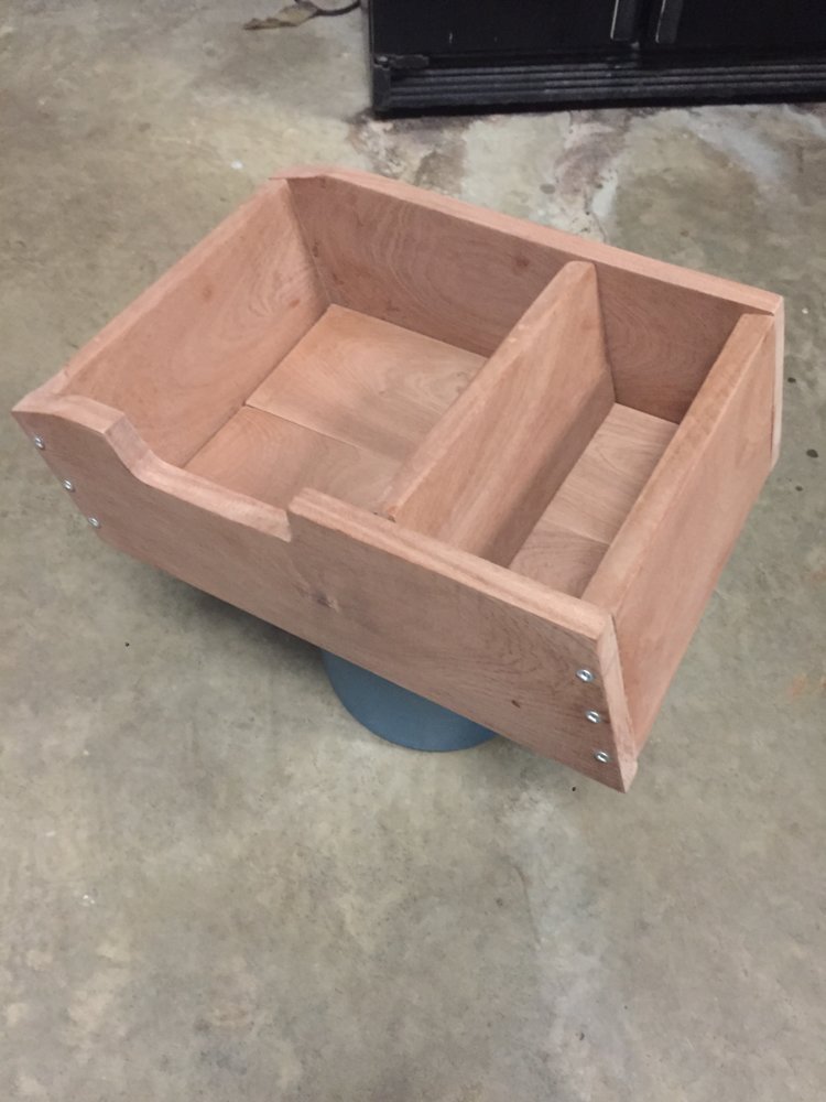

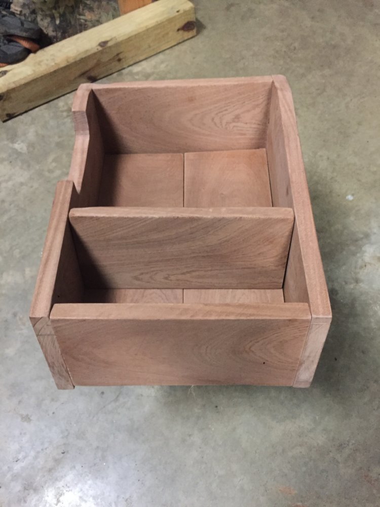

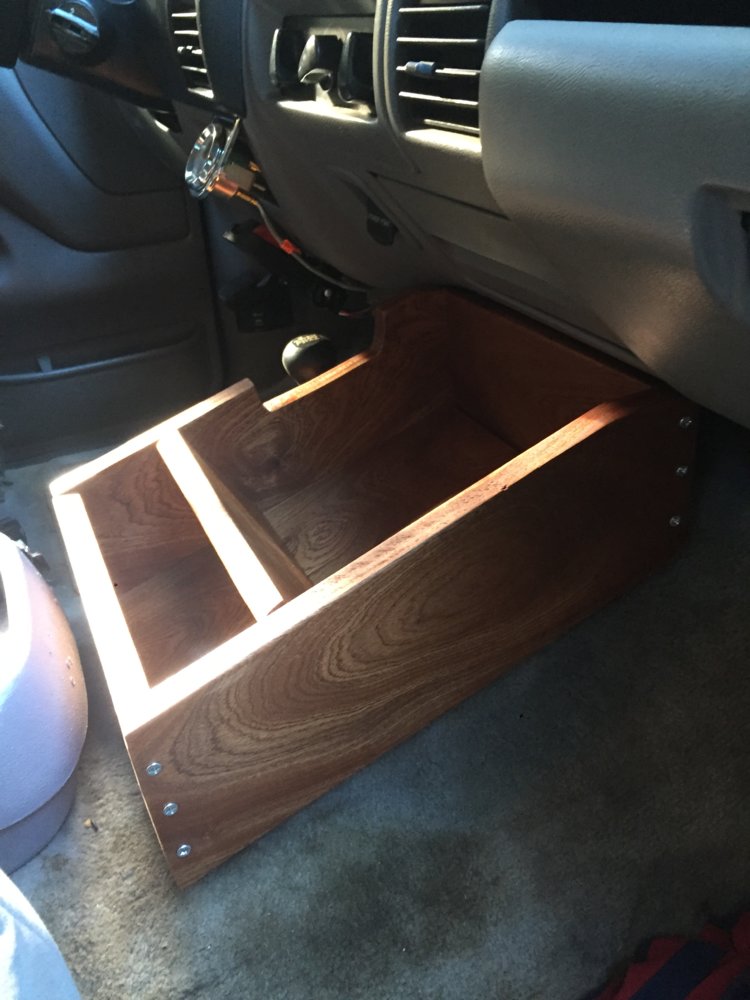

I made a cupholder/ console out of sapele mahogany for that big spot right of the 4wd shifter in my 95 f250. Poser shots to come once the poly dries.

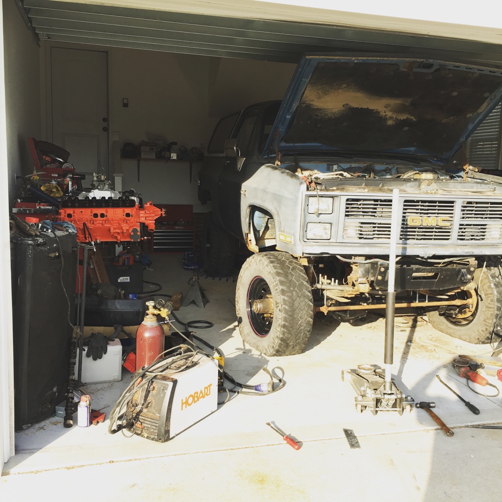

Made my k5 not be able to get out of my garage lol

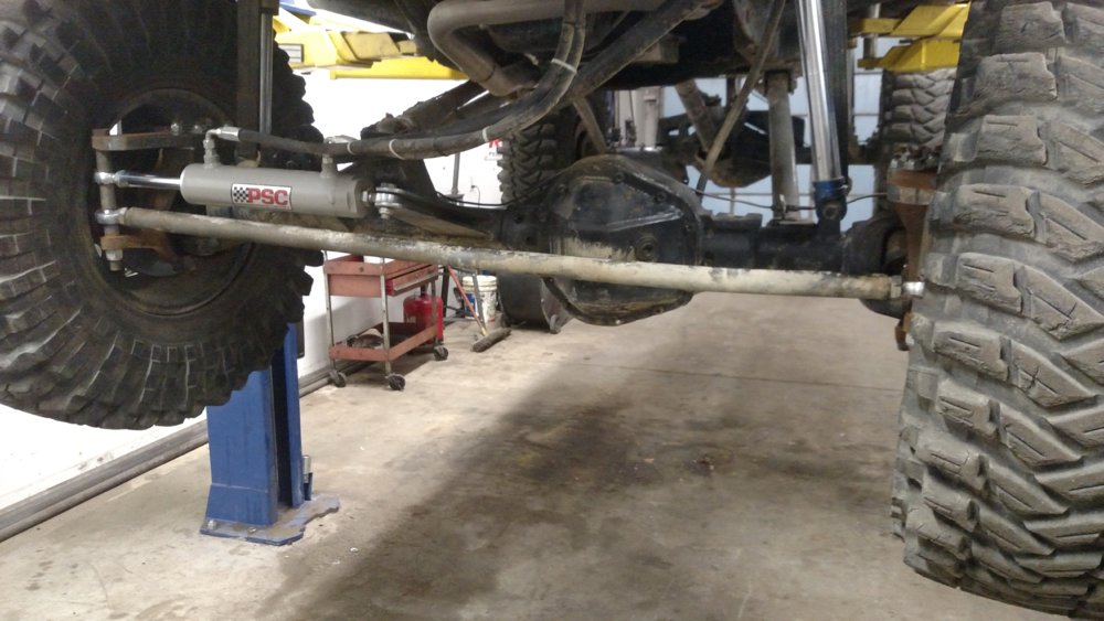

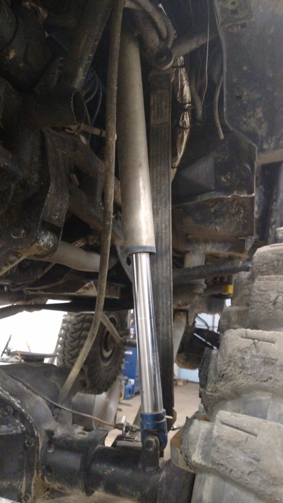

Rotated my tie rod 180* again until it bends the next time. Installed longer limit straps and measured for a 1410 series front shaft from @Oliver's. Then I can get all of my available suspension travel without binding the ujoints.

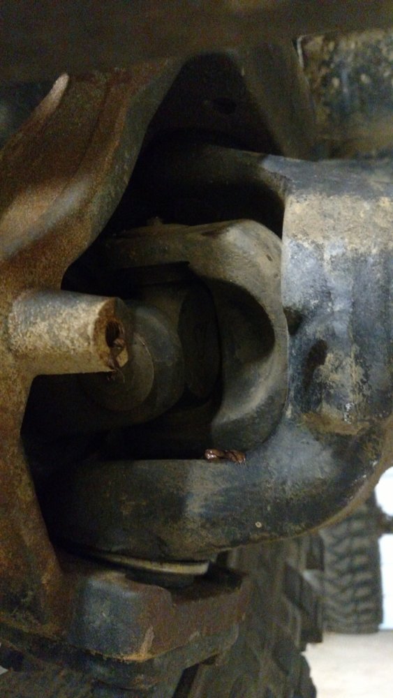

Lubed the Superjoints in the front axle shafts and gave it a good post- Harlan lookover.

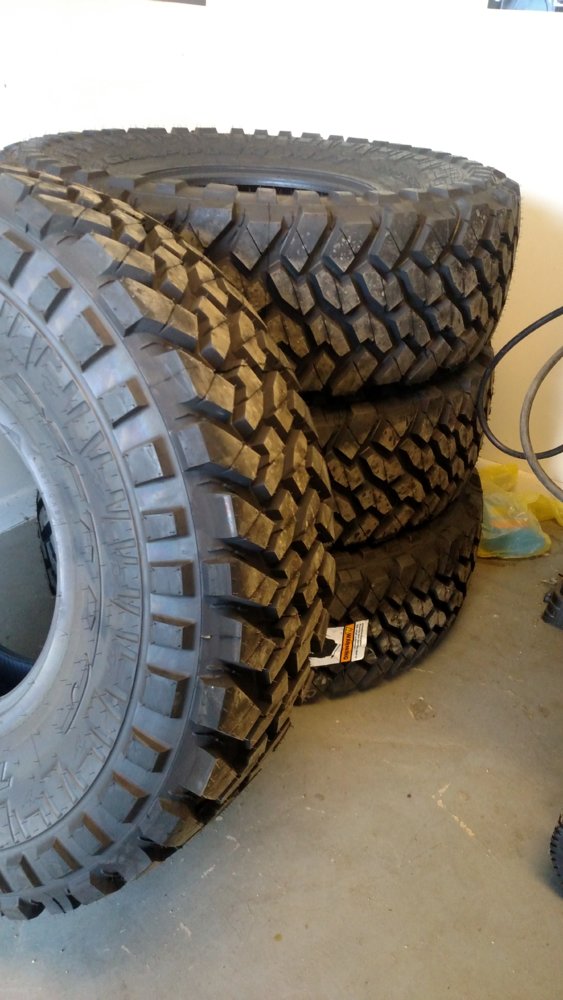

Mystery hole in sidewall at the hunt camp the other weekend. Perfect excuse to upgrade the DD/motohauler.
