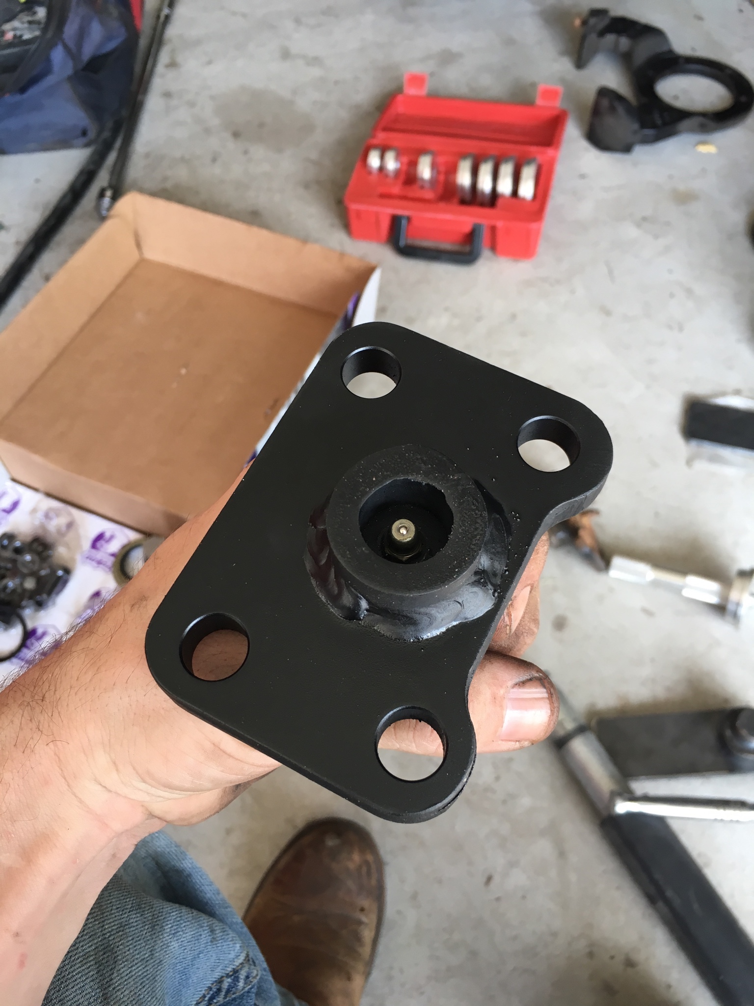

F no. The RC 2.5" lift is a bargain. Same with the RC lowers, just weld a bung into one end and thread on a Barnes joint. But I'm not running their track bars.

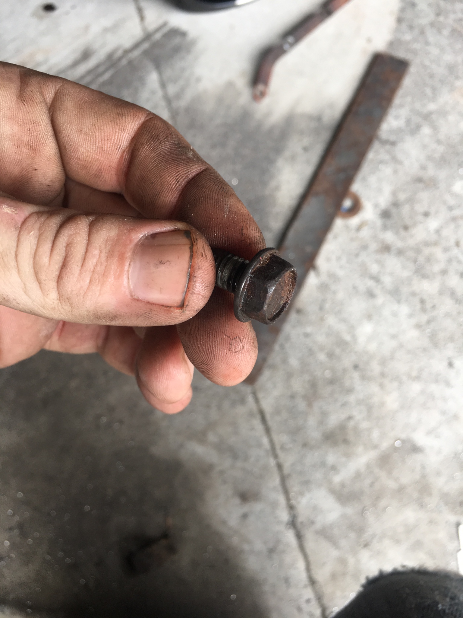

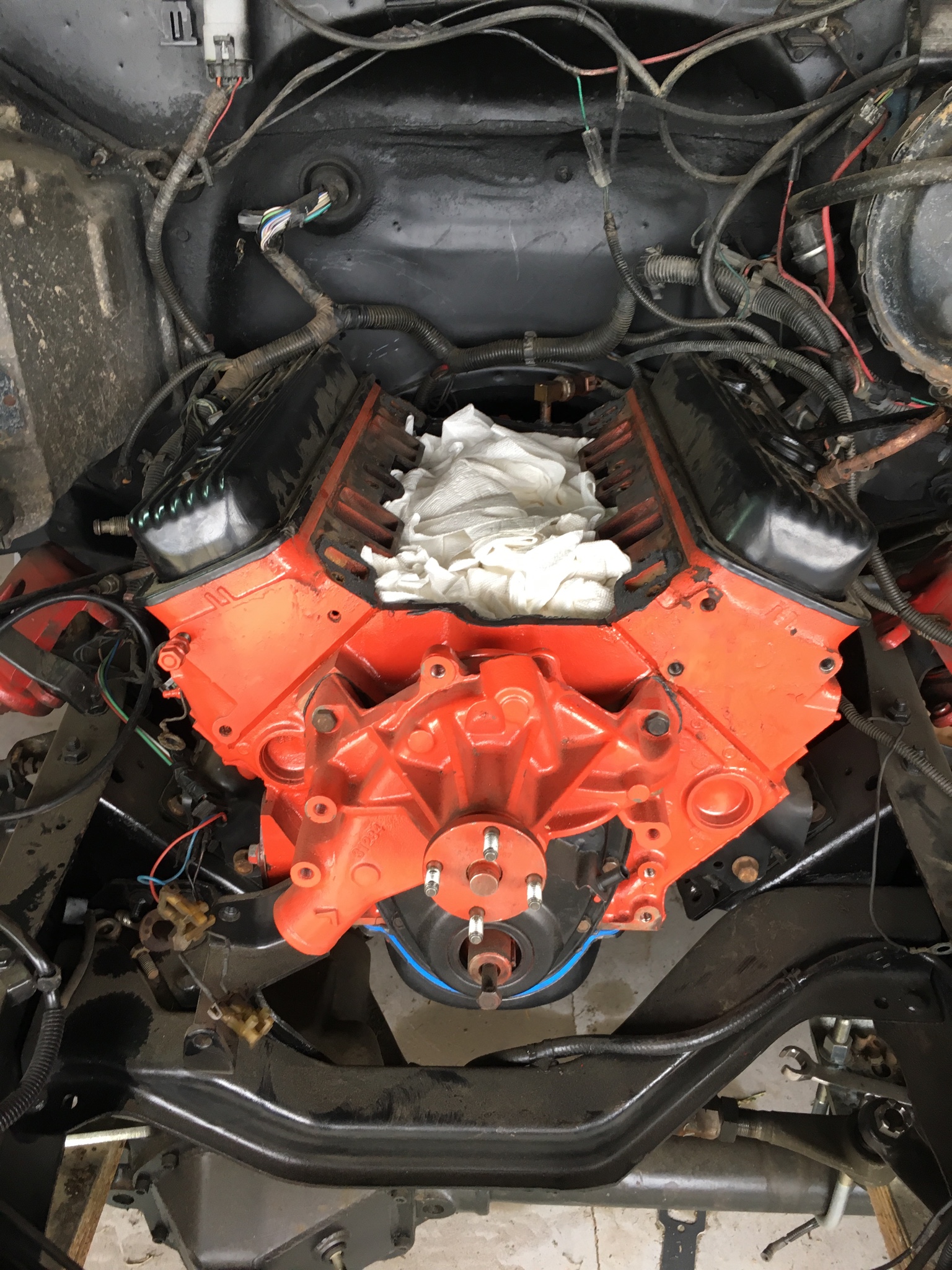

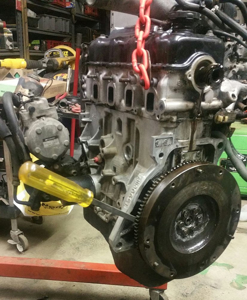

Primed the oil pump and dropped a bolt down the distributor hole so now I've got to pull the pan..... y'all sure it ain't Monday
Extendo magnets my friend...
I can only assume it bounced off the oil pump shaft and went into the pan, really dunno if I could get it with a magnet

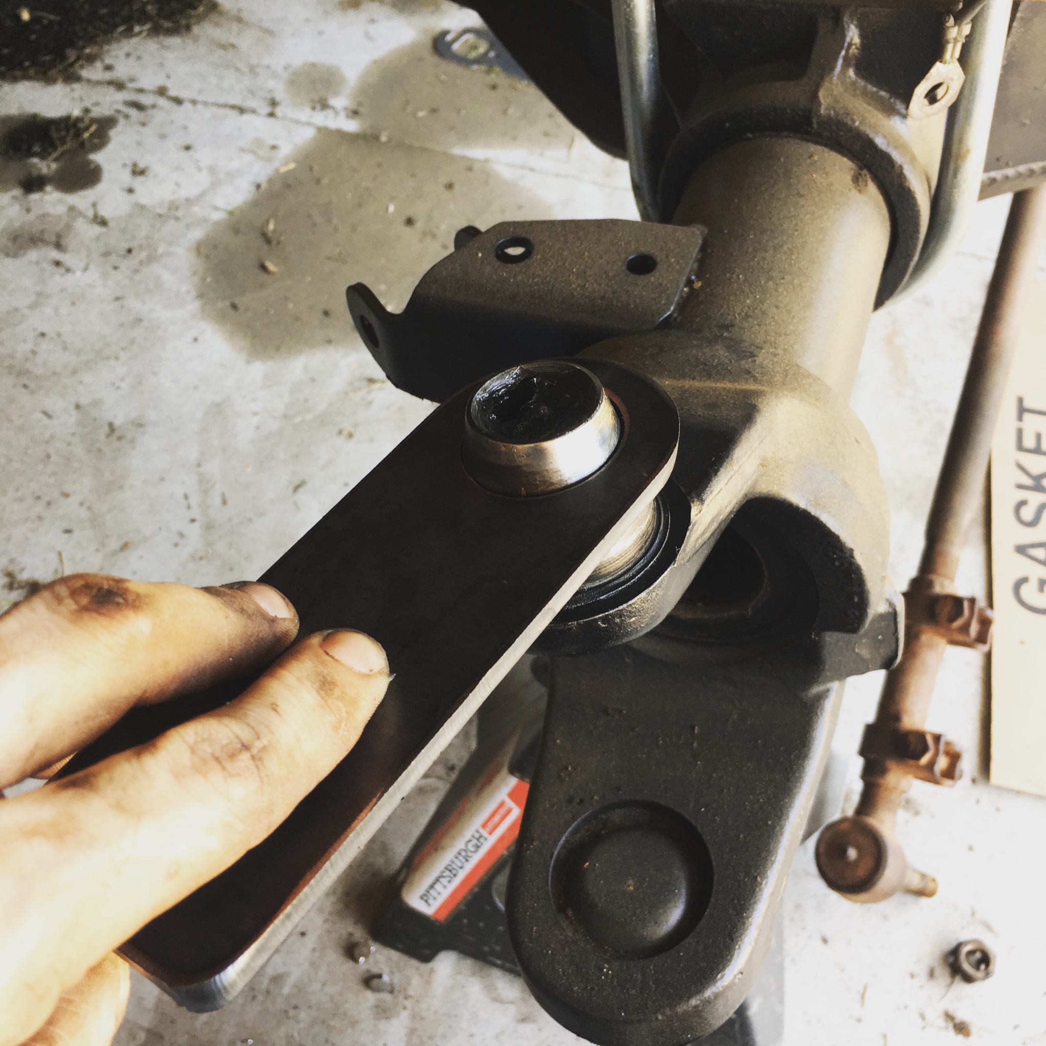

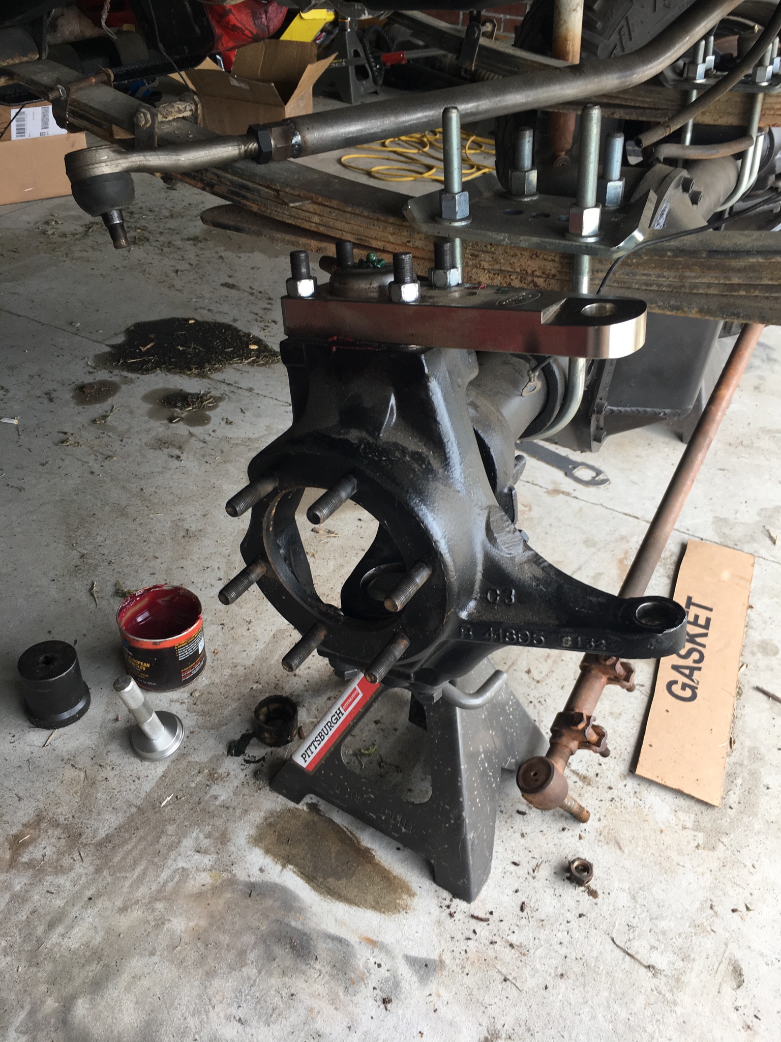

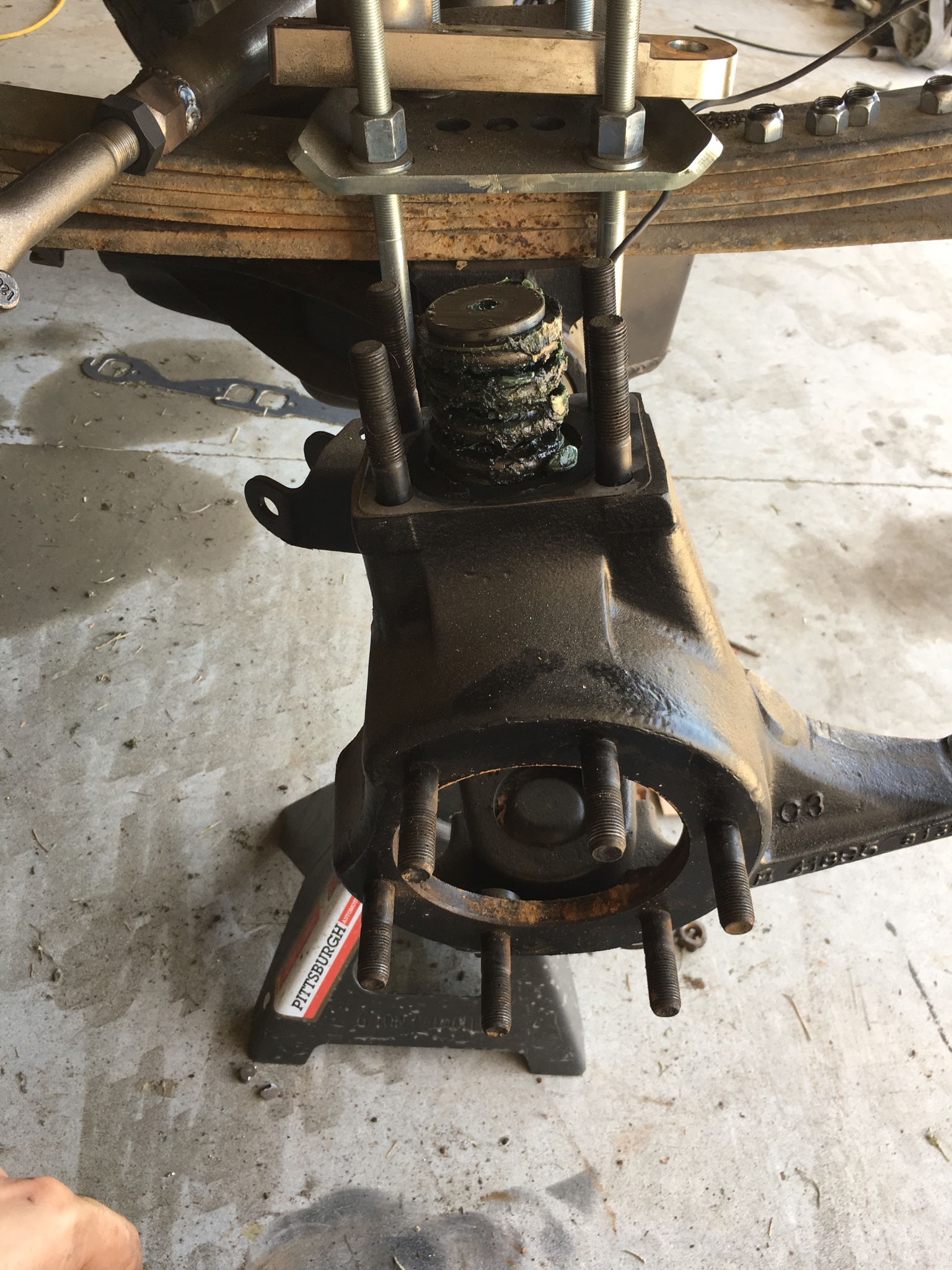

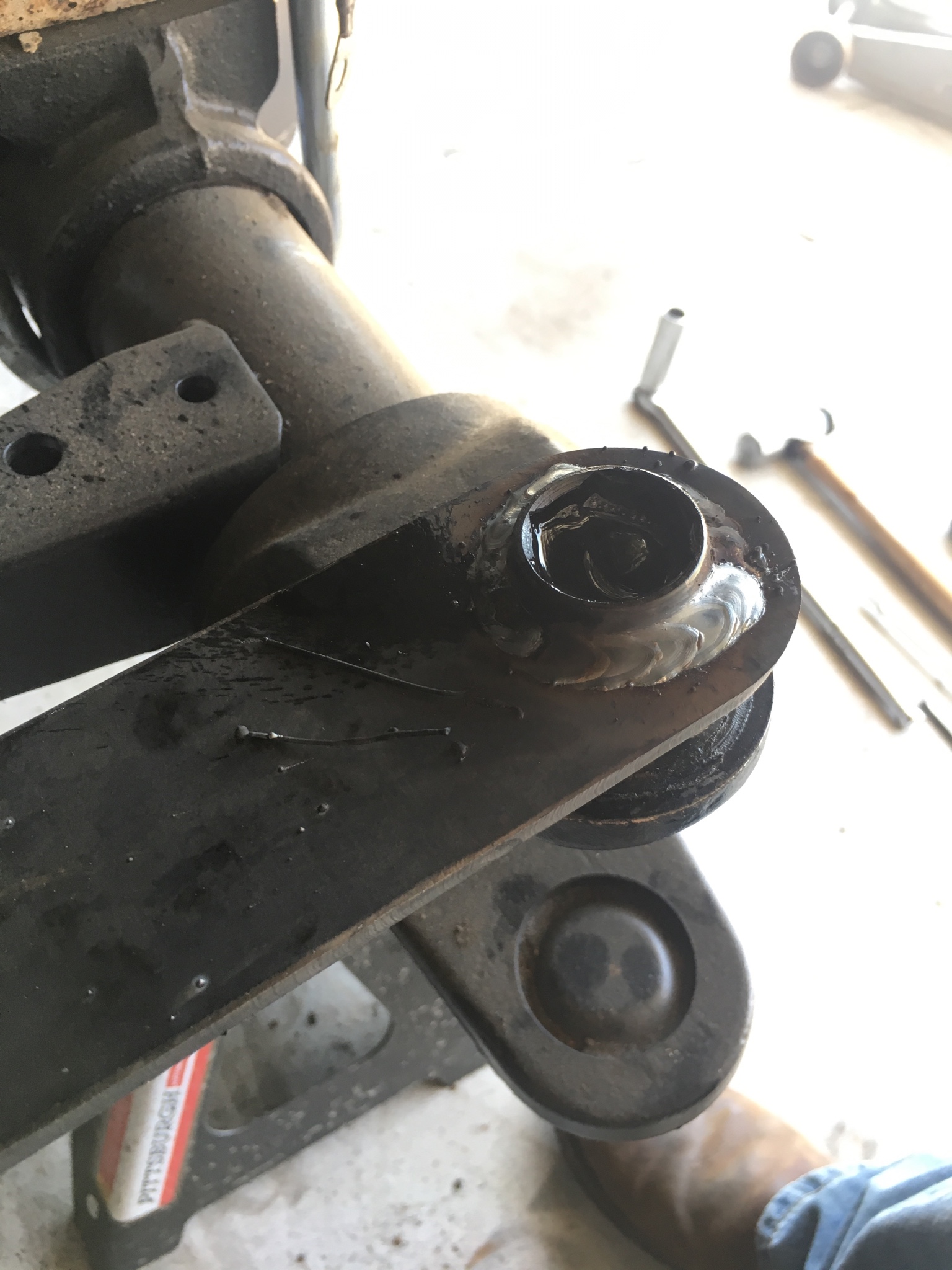

Rebuilt the king pins on the k5
That's a stainless steel shim I machined at school to add some preload to the kingpins
These you weld onto the kingpin and hit it with a BFH to bust them loose
Added some DOM to protect the zerks fitting not he bottom bearing cap

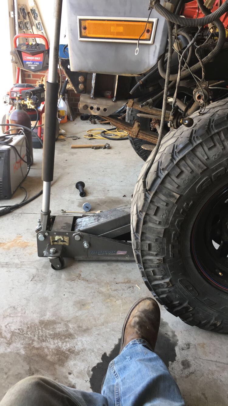

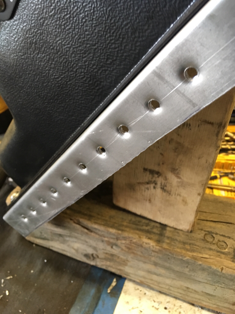

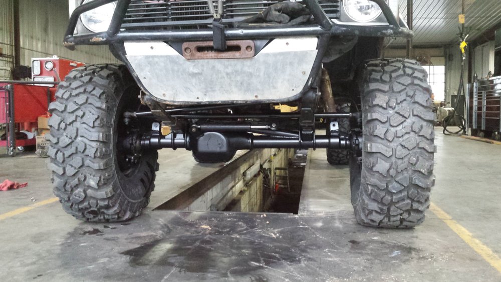

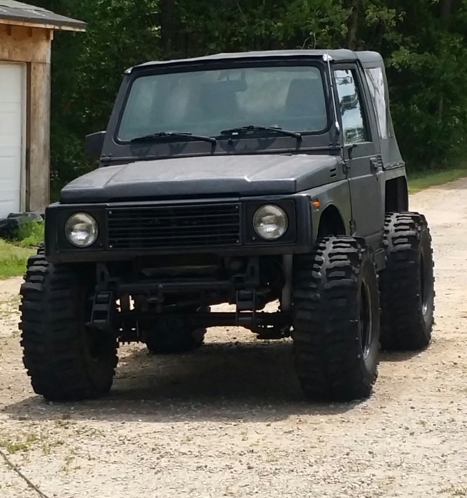

Installed some new shackle hangers, need to order some 7.25" shackles and moved the front axle forward for a better approach angle. I'm planning on buying another set of fenders and section them to make the wheel whee bigger and delete the side marker light. I'll replace it with a smaller LED one.
I've got about everything coming in tomorrow to get the engine back up and running. That'll be my weekend project.
Went fishing this morning... it was in the bottom of the pan, lol.
