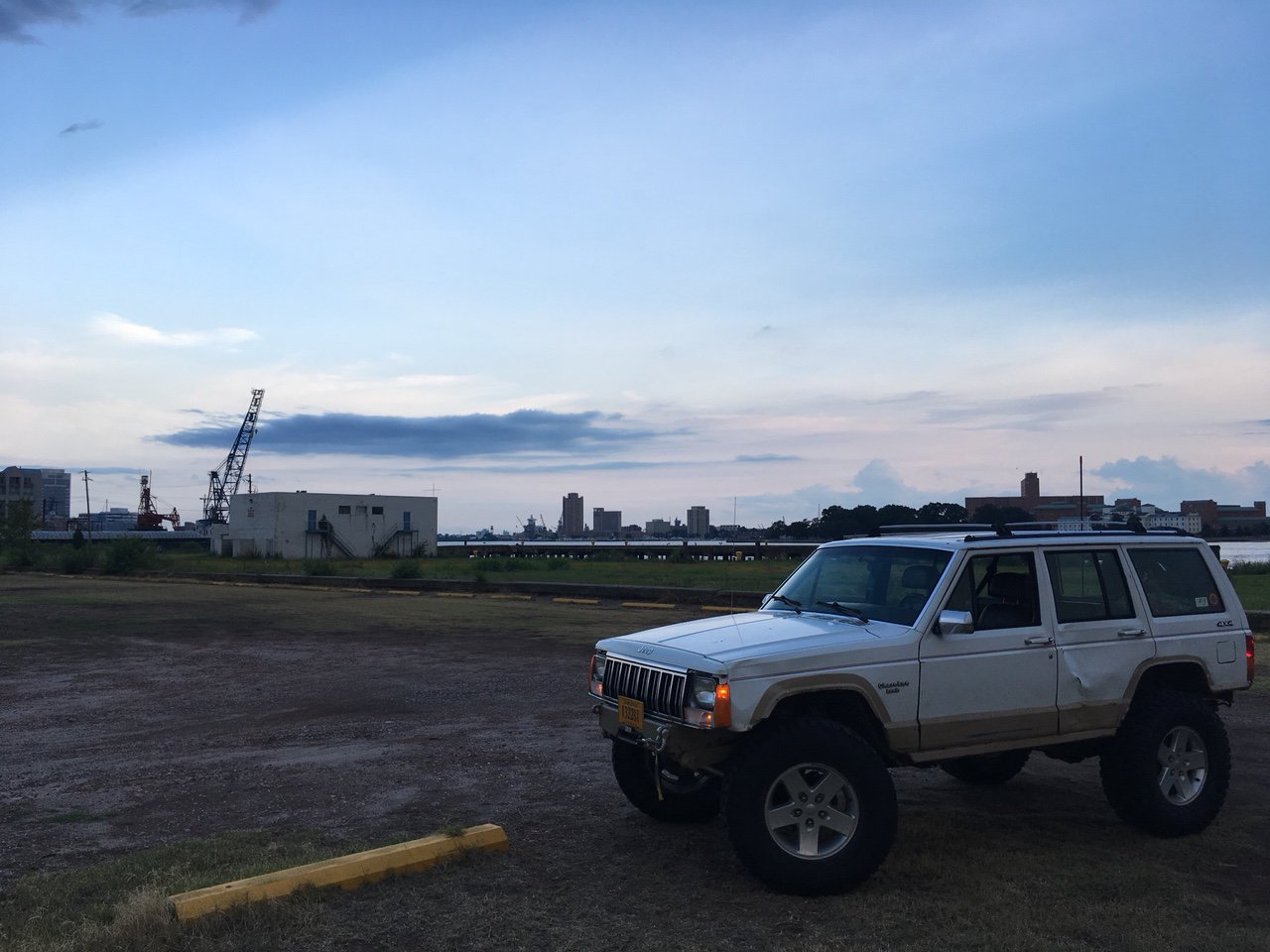

Did a thorough pre trip inspection. By that I mean the tires have air, spares and tool bag are accounted and most importantly, I have a proper coozie affixed to the shifter.
Caught it on fire around 7000 rpm. But made the climb
Video to follow I'm sure.
Edit: no cause to stop. Still wheelin

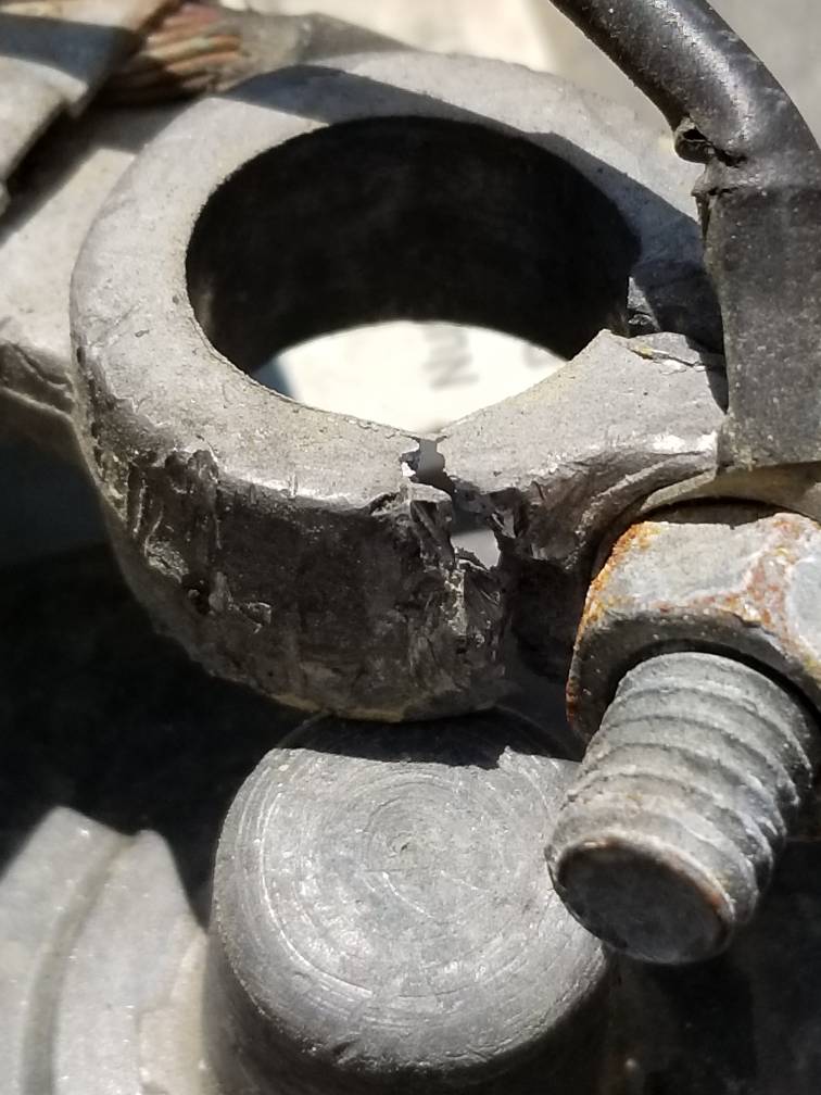

Well got back to my house went to change my battery and found my terminal was cracked. So that's going to get replaced tomorrow after I pick up one tonight.
Cant find date on the battery that was in the jeep but it came in it when I bought the jeep used.

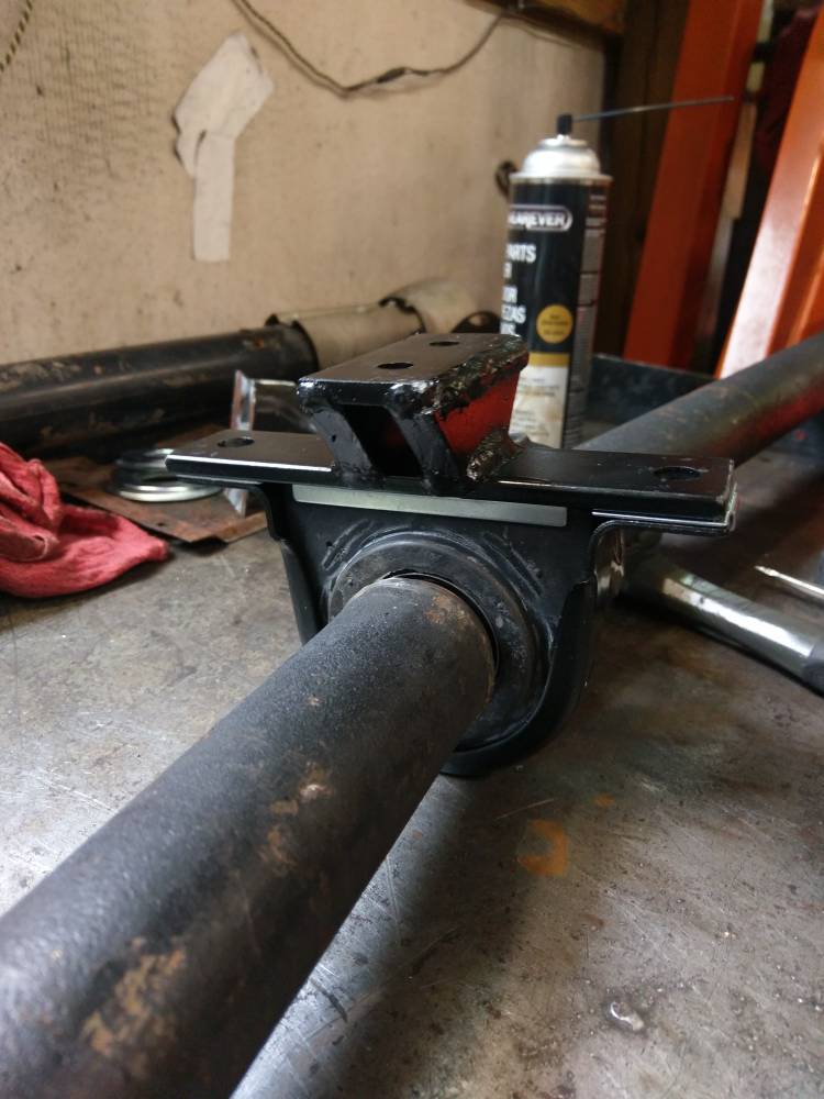

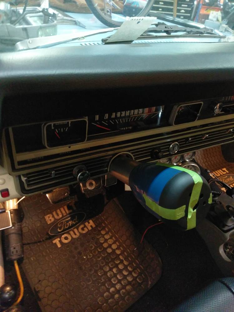

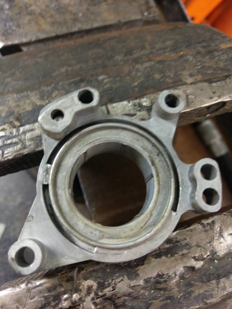

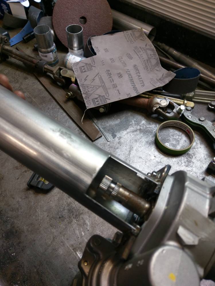

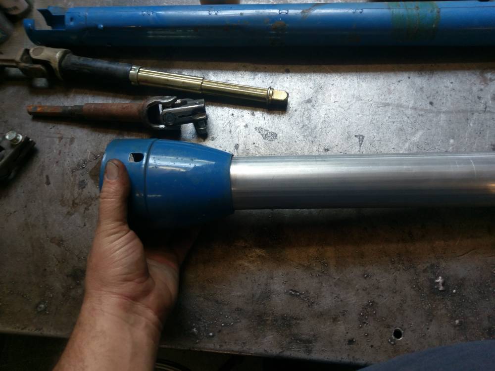

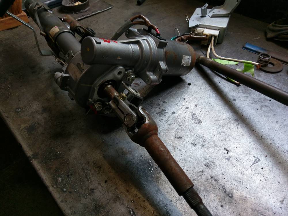

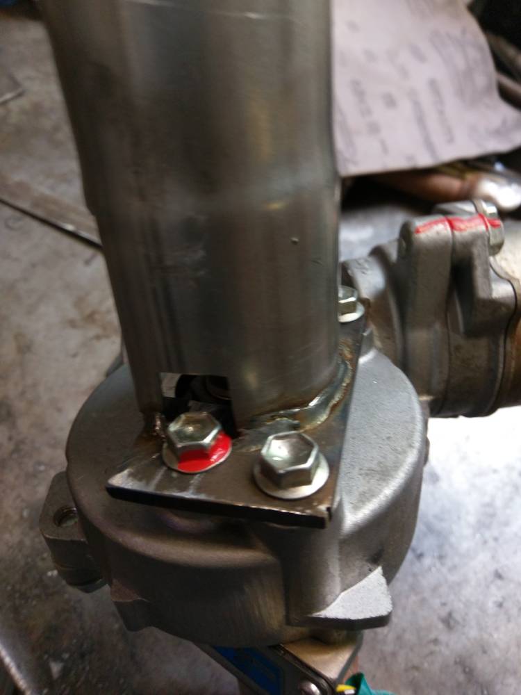

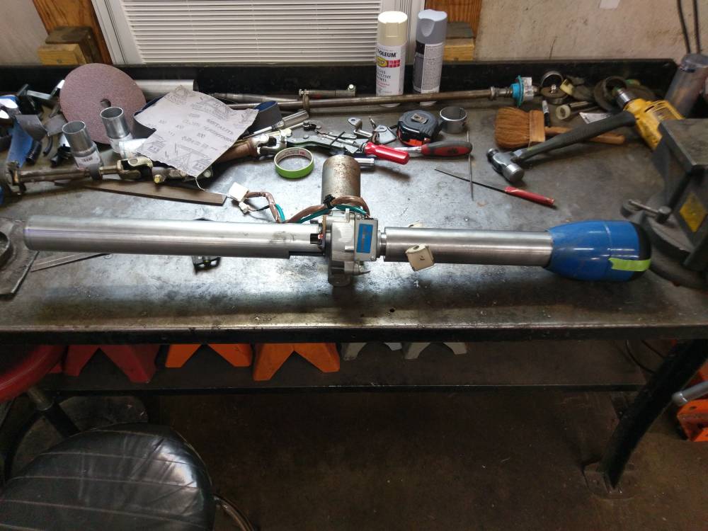

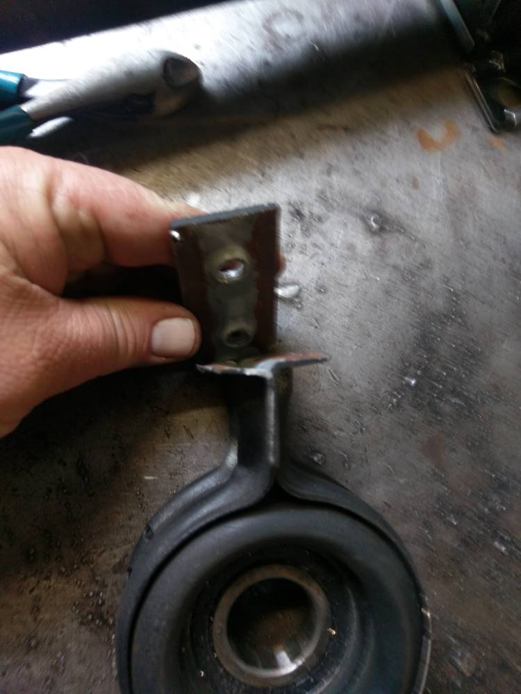

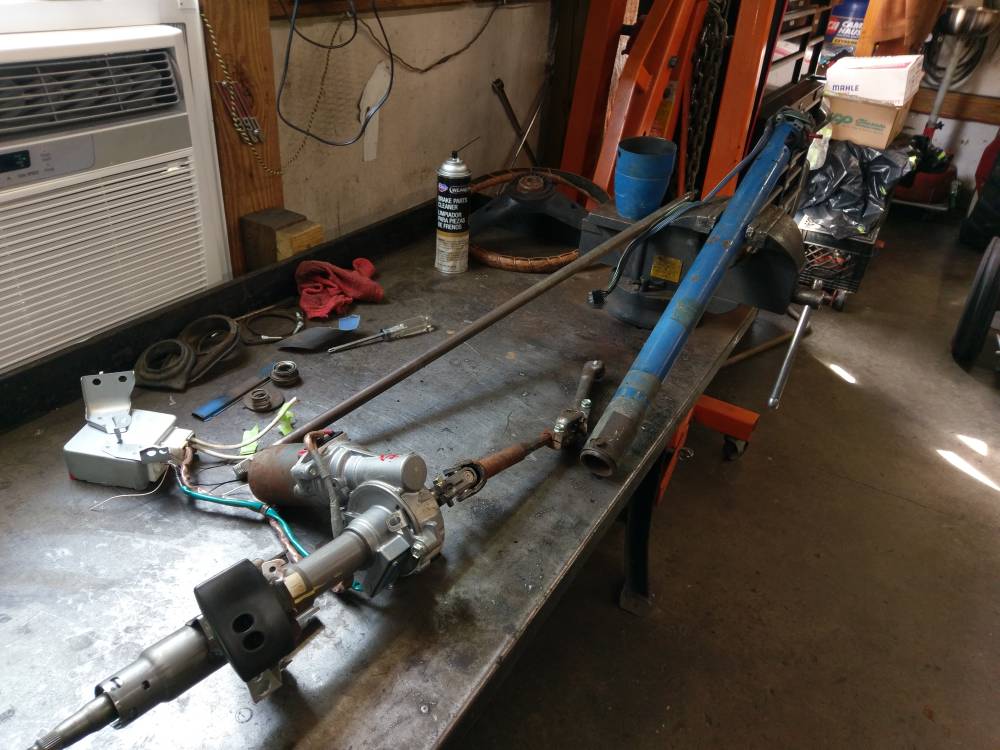

My dads 69 Fairlane leaks from the same place. I’ve tightened everything down as snug as I can get it without breaking something. It’s a small leak but annoying nonetheless.Not a wheeling rig but this weekend I made a conversion bracket to put a stronger style center bearing from a Ford Ranger on Dad's old 67 c10. I also started putting together an electric power steering setup from a Prius into my 67 Fairlane. I'm tired of fighting leaks from the antique ram assist power setup.
Sent from my HTC6545LVW using Tapatalk
Yes the ram had to be replaced and it leaked for a year. Then on the Power Tour it started wandering, I found the control valve worn. The new one is leaking around the ball stud. It's such a bitch to replace I'm just going to eliminate it all.My dads 69 Fairlane leaks from the same place. I’ve tightened everything down as snug as I can get it without breaking something. It’s a small leak but annoying nonetheless.

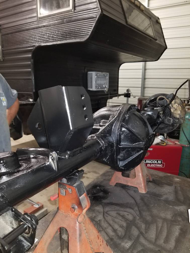

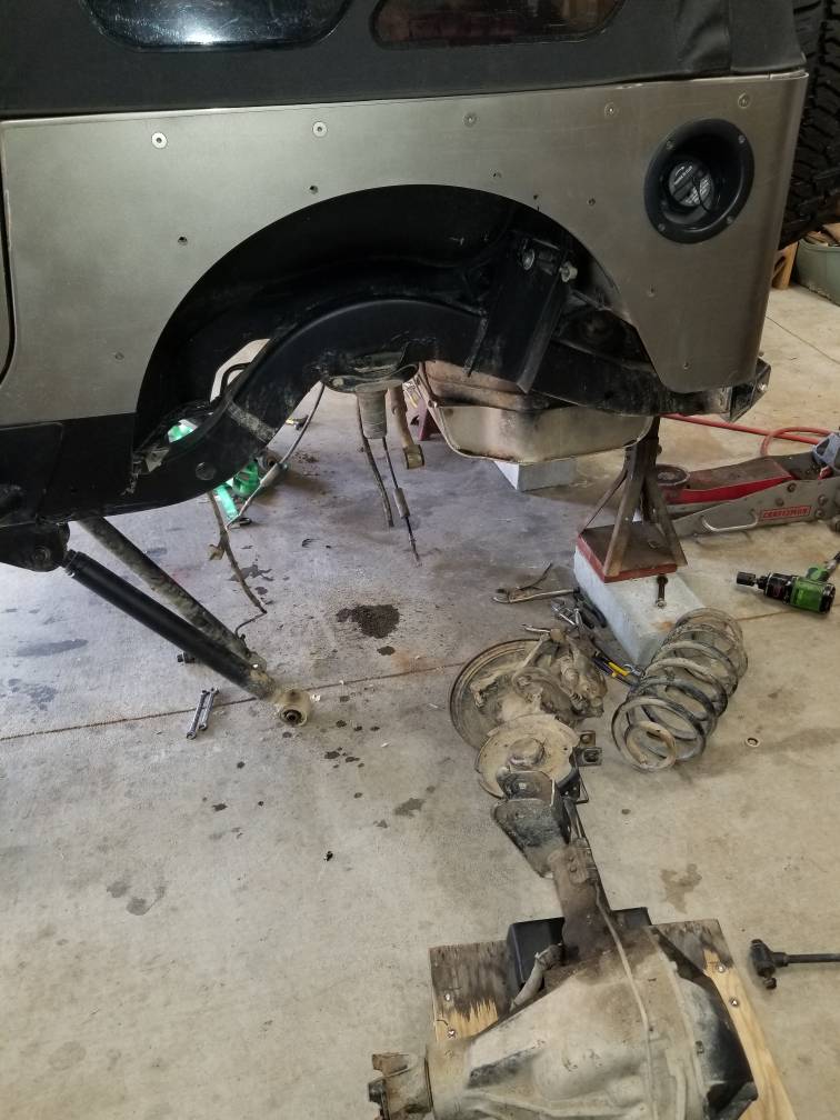

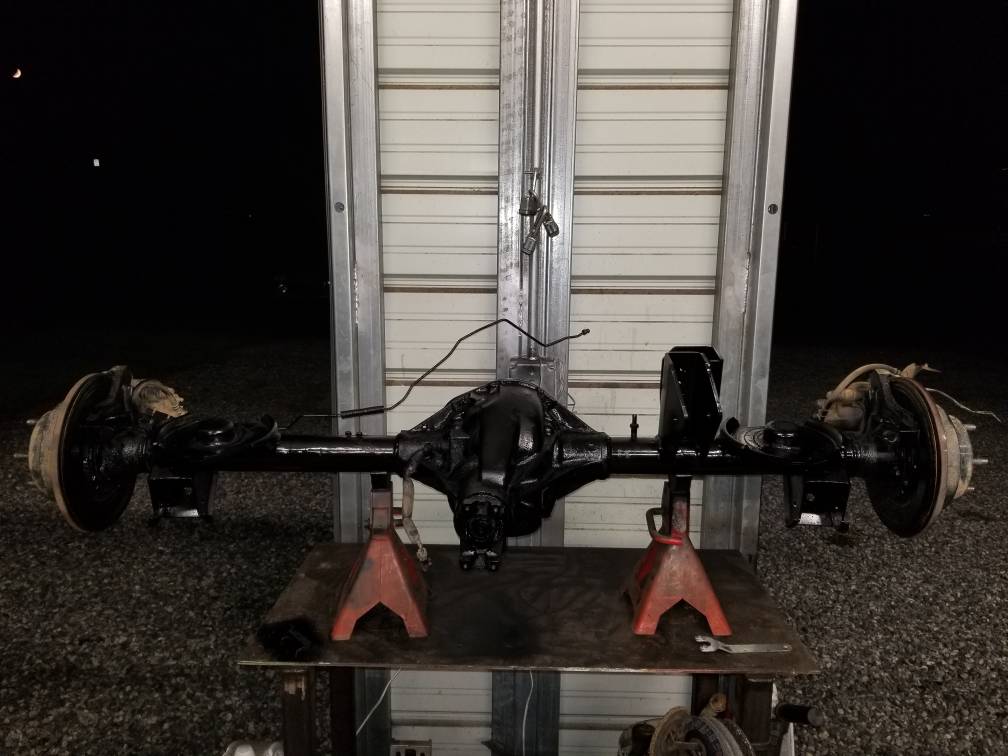

Got to working on the rear axle from where I ripped the track bar/upper control arm at Harlan. After @77GreenMachine and @adamk convinced me into the pulling the axle to weld the new bracket on. Which turned into cutting all the unused brackets off, welding the tubes, boxing in the lower mounts, and clearancing the coil buckets for the shocks to clear.
Quote of the night from @77GreenMachine "it's clean enough to get an arc" lets just say some of his weld prep was less than ideal.![]()
It'll tear the tube apart before that bracket comes off. I looked at trying to brace it but there wasn't a quick and easy way to do so with the brake line in the way.By first glance it looks like it can tear off again. I would brace it a bit more since this is your only upper link and trac bar bracket.
Put a triangle gusset coming up the outer back side of the track bar mount.. looks like you can gain about 2" going towards the spring and 3 towards the center section. Will give much more lateral strength.
The picture is deceiving. There is only about 1/2" between the link mount/coil bucket, and about 2" between the center and link mount.
