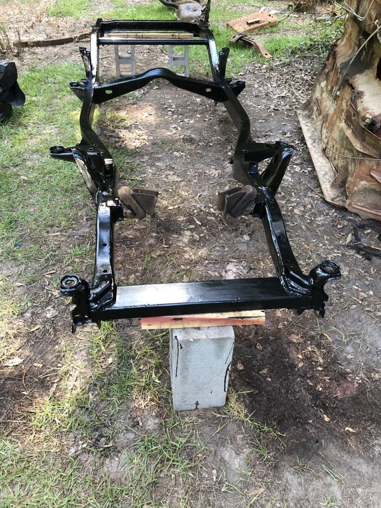

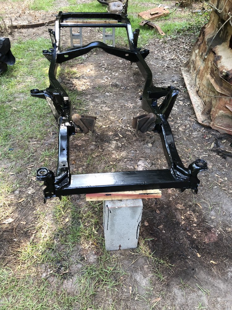

Finished painting the frame for my ‘81 Toyota P/U. (Don’t mind the cab on its side it is going to the scrap yard) I wish I had a shop
View attachment 274519 Finished painting the frame for my ‘81 Toyota P/U. (Don’t mind the cab on its side it is going to the scrap yard) I wish I had a shop
Nah man. That's good style. Been rolling that that for ever. I wish I had pics of my 79 long bed build where I used a Chestnut Oak, snatch block, old winch cable and my 84 to lift the cab and swap frames. :D
And dealt with swamp ass down in La. Did you ever run into Jody at the Legion?
That’s no joke this time of year. About an hour outside and I look like I took a shower! And no I haven’t even been back since the last time.
What kind of paint did you use on the frame?
I wire wheeled the whole thing and used rustoleum red oxide primer and low gloss black tractor paint (also rustoleum). I’d love to have used something like POR15 but this thing is a budget build and the money is going elsewhere.

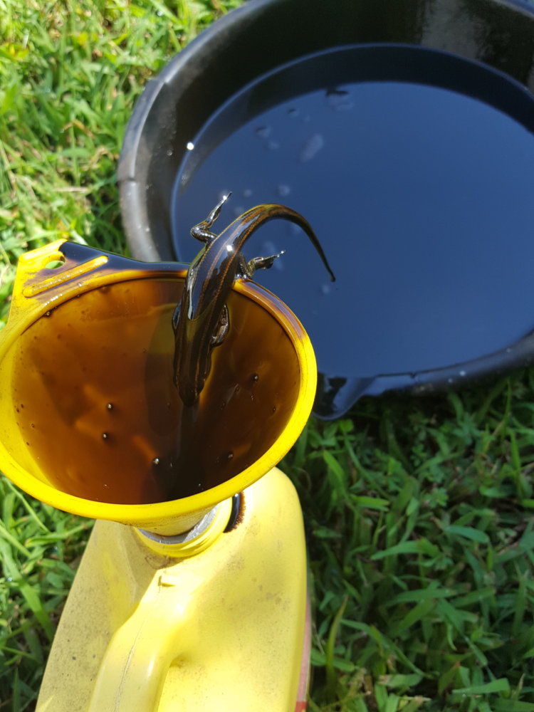

Changed the oil and replaced the spark plugs in my Ranger.
Pretty sure the oil is/was 1.5 years old. Came out nice and clean.

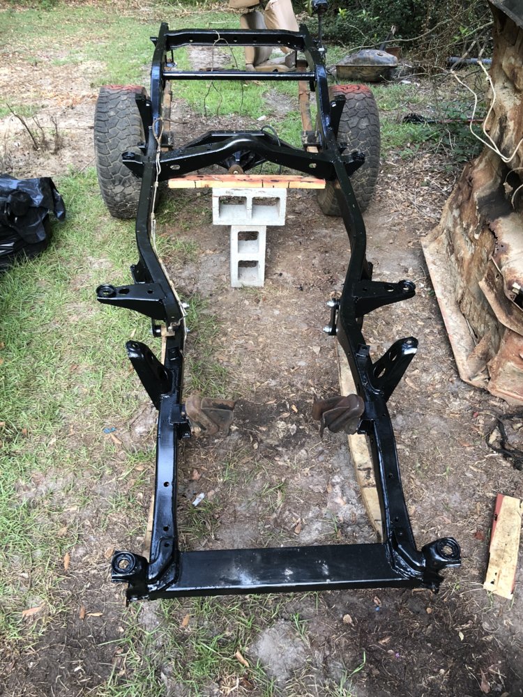

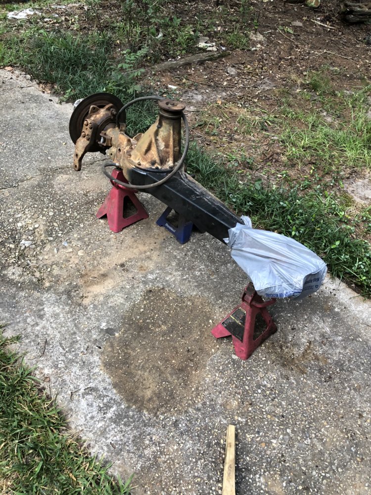

Rear axle got new brakes, bearings, seals, and truss welded and set in with Chevy 63” leafs. Front springs are hung (RUF bastard pack). Front axle started tear down for full seals/bearings/brakes rebuild. I haven’t cleaned/ painted the springs yet cause they may have to get changed to accomplish proper ride height. Front Axle will finish getting painted as it goes back together.

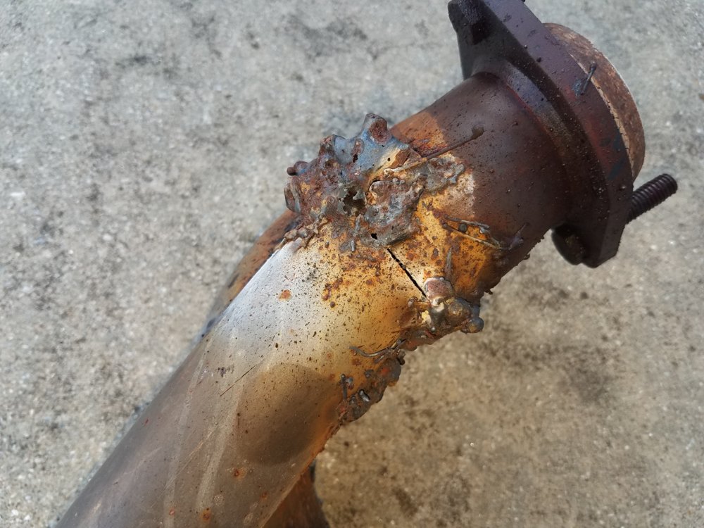

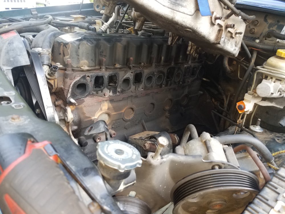

Finally decided the exhaust manifold leak had to go.
Looks like the old manifold had been patched several times. Not by me!
Not a fun job at all. Got it back together last night at 9, cranked it up and had a 2500 rpm idle. I was not happy. Loosened the intake manifold and got it seated properly this morning. The heep is now quiet! (Other than all the squeaks and rattles).....
