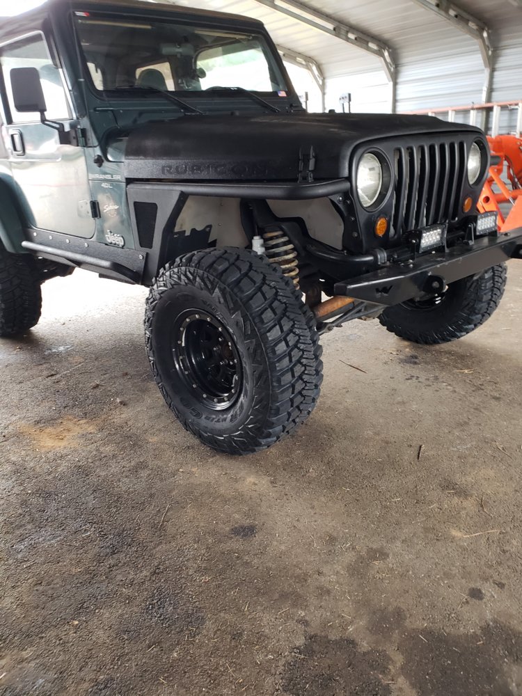

What's so wrong with Cooper? Soft compound? I actually liked my Chinese street tires I out on my xj one time. They were sticking to my hands mounting them. Lasted maybe 40k but they would never squeal and had awesome traction on asphalt (where my vehicles typically spend 99% of their time)
I've got Cooper ST Maxx on my HD and the old STTs on my other SAS truck. I freaking love Coopers. They make a LOT of tires under other names...big, well known, names too.

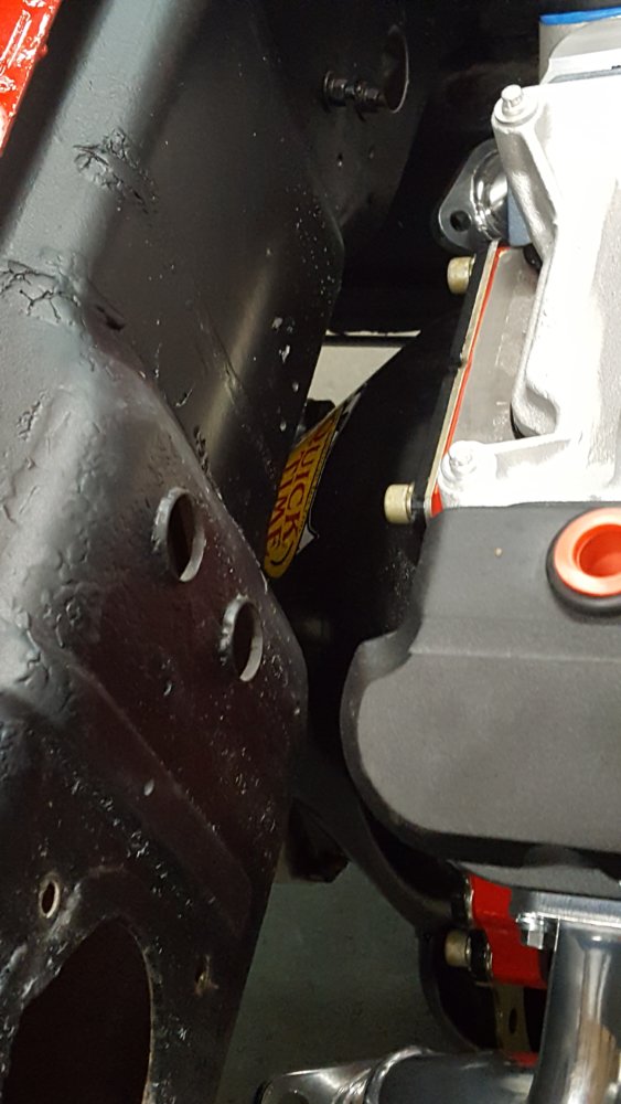

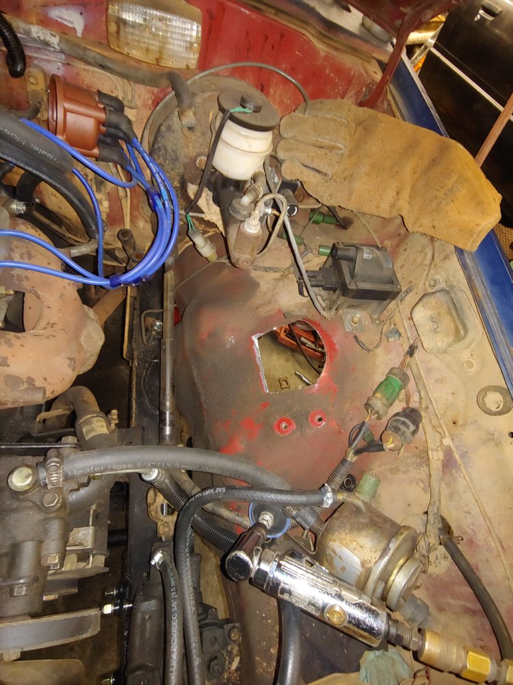

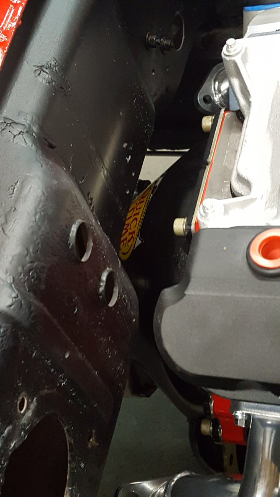

I'd take the leaf spring pack apart only leaving the main leaf put in a spacer to take up where the other leafs would be and bolt the axle on. It should be light enough to jack up one side at a time to check for clearances. Don't forget to put the wheel tire combo on and check clearance at full stuff wit the other side at full droop and turned full lock left and right. You don't want to be getting into the shock shock hoop or steering after you've welded everything in.
Boy am I glad I listened to you. My tire was making sweet love to the shock when I stuffed it in the fender.
Didn't finish but I got started on making room for the shock hoop to move in.

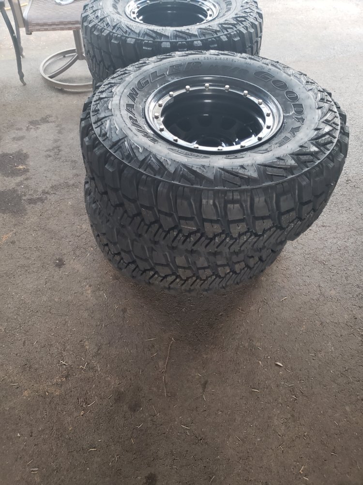

The tires i ordered are the dick cepek extreme country. A few people I know around here swear by them for anything but sticky mud, guess I will find out.....

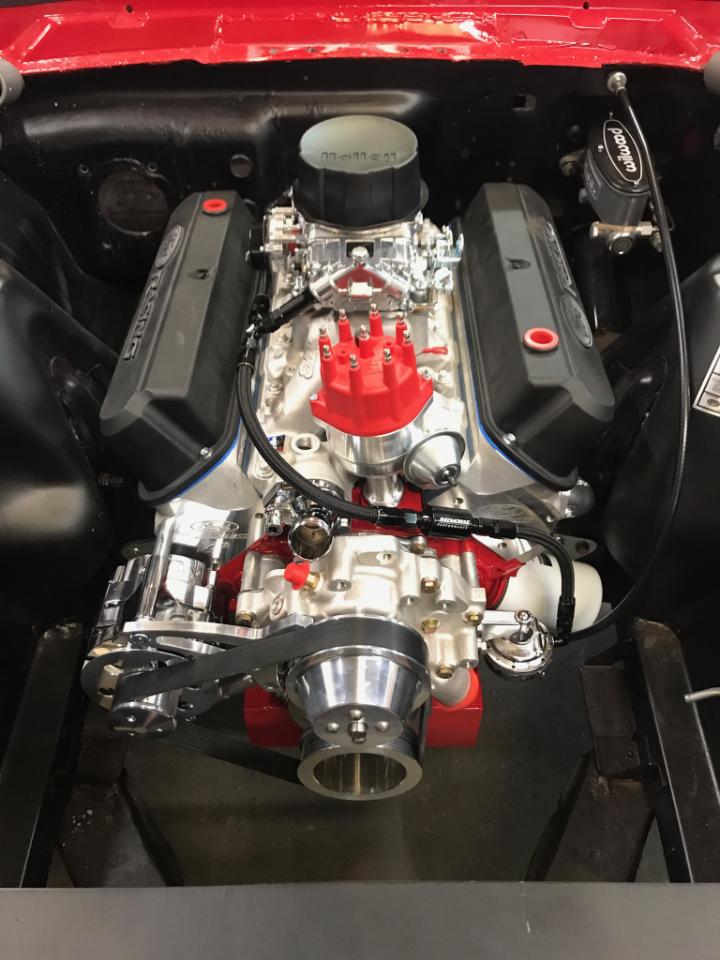

Progress is being made. Losing track of what day some of these were taken.
Got the transmission mounted and adjusted in place...didnt take phone under car. So this is what ya get.

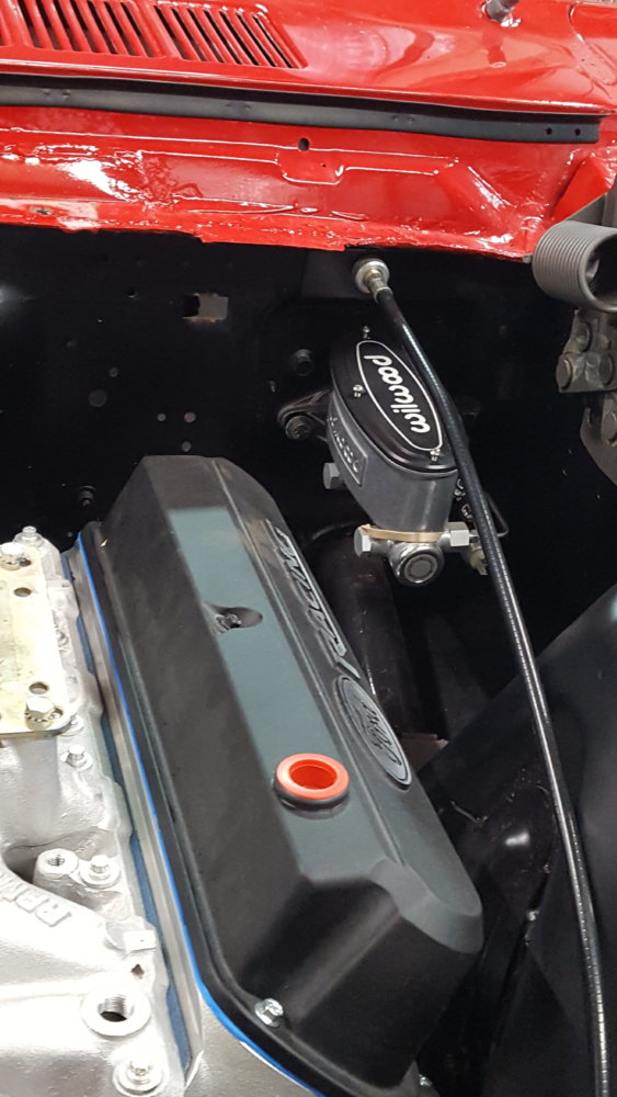

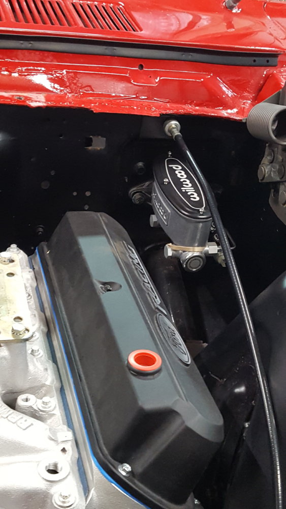

Got the new master cylinder in and the pedal set. This is a really trick piece. Has a built in adjustable proportioning valve to eliminate one line connection. I did a shity job of getting a pic of said valve...it on the right hand side. Current rear brakes are drum...future plans call for disc. This will allow the swap to be done on my timeline

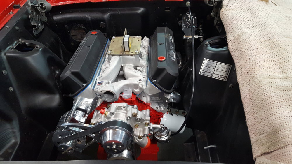

I hate hydraulic clutches because Im a dinosaur and ....but my knee problems make standing on a manual triple disk a bear so cable it is. This photo shows a better angle of the cable routing. Its heat shielded from under the oil filter back in 3 layers of nomex/kevlar/then hard barrier so it should survive despite being cozy with the header. Final hold backs arent on the shock tower yet but they are coming.

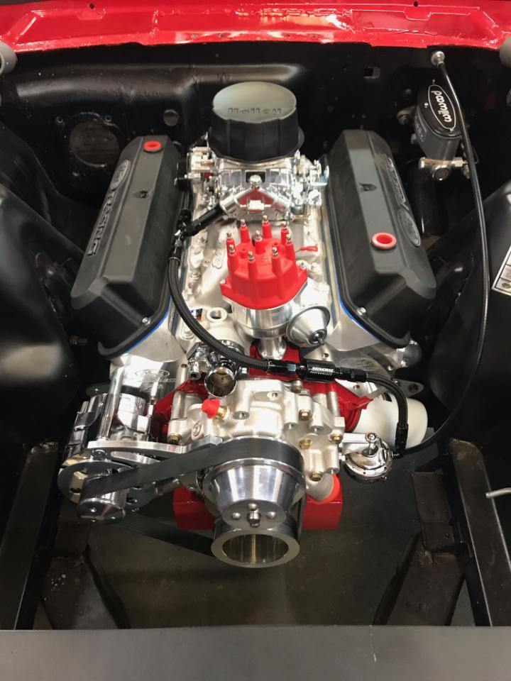

Finally the engine has too many unplugged holes in to. So I fixed some of that. The carb was supposed to be classic bronze but it came in wrong. It may go back still but it's growing on me.
We have outworked the supply house. Got to finish my hard fuel lines underneath and their brake line friends. They are all bent just need final mounting.
Will start throwing interior back together this week. I am really really pleased with the American Powertrain TKO600 conversion pieces. Shifter fell perfectly in line in stock location without hacking the tunnel. Conversion x-member lined up perfectly with stock holes...it was almost too easy.

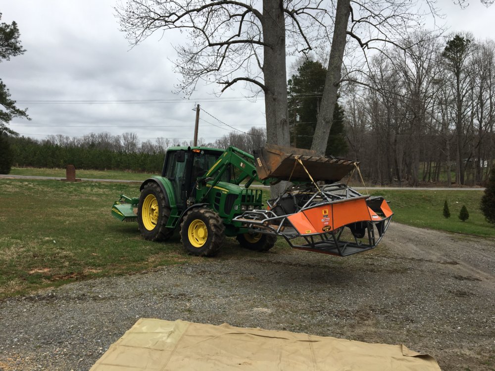

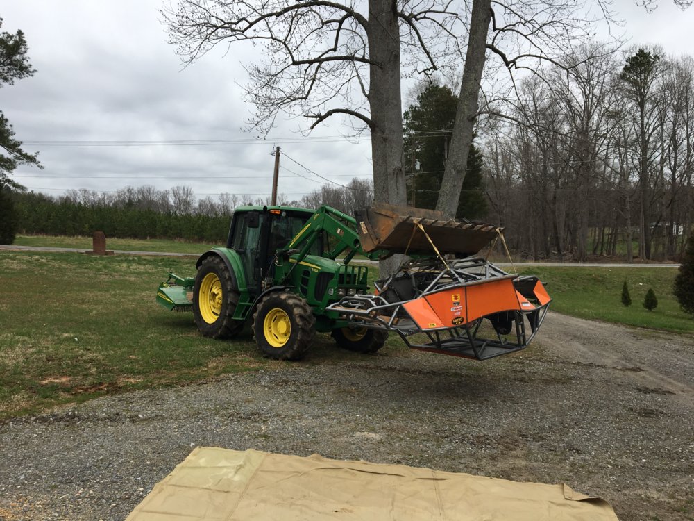

Sure you had enough tractor? :lol:
In the drag race world it’s “run what ya brung”. I’m sure the same phrase can apply here too. In this case, it’s not how heavy, but how high we had to reach.

Why not go efi?
Sent from my SM-G955U using Tapatalk
Why not go efi?
Strongly considered it. Came close actually.
Ultimately this build, this car because of the history of it and the overall theme went old school carb, mechanical fuel pump.
I am not a fan of the fitech or holley sniper style engine bay mounted ecms due to past issues so if I did it I'd be going with the terminator stealth or similar and getting the ecm in cab.
But this car has a weird combination of restomod.
Needs an LS. :D
Needs an LS. :D
Fwiw this engine specs out slightly higher than an ls7.
Less than half the price. Lighter and smaller.
It's a beast on paper...I'll let you know "soon" how it is on pavement.
