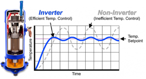

We all know that when it comes to comfort, nothing can match the consistency of an inverter compressor. Inverter-driven heat pumps are an ideal comfort solution in nearly any application and Bosch’s IDS system is no exception; it employs a top-of-the-line fully-modulating inverter designed by Mitsubishi.
Typically, when your thermostat makes a call for heating, it activates your furnace which then runs until your home is slightly above the desired temperature. After that, the furnace deactivates until the temperature has fallen below your desired temperature. This results in a system that keeps your home near the desired temperature rather than at it.
With an inverter-driven heat pump, you completely eliminate this short-cycling on/off cycle. The inverter can make precise adjustments to ensure that your home is being kept at the exact temperature you want. Furthermore, in addition to providing more dependable comfort, invert-driven systems also reach their target temperatures more quickly.
A vast improvement to the comfort provided is not the only benefit of an inverter-driven system, they also consume significantly less energy. This means lower energy costs, and since heat pumps are used in all seasons, those savings are year-round. These heat pumps are so efficient that they even qualify for up to $600 in rebates from ComEd!
