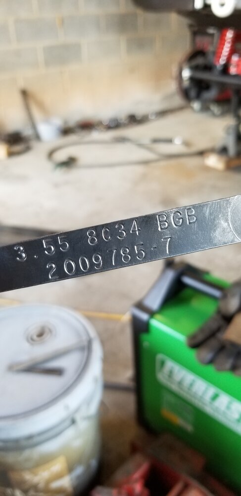

come on man.....so I totally forgot (been 6months since I went through the axles) that my rear is 3:73 and front is 3:54 dammit...for just wheeling purposes, will this work or do I need to fix it?

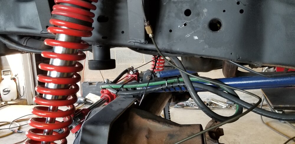

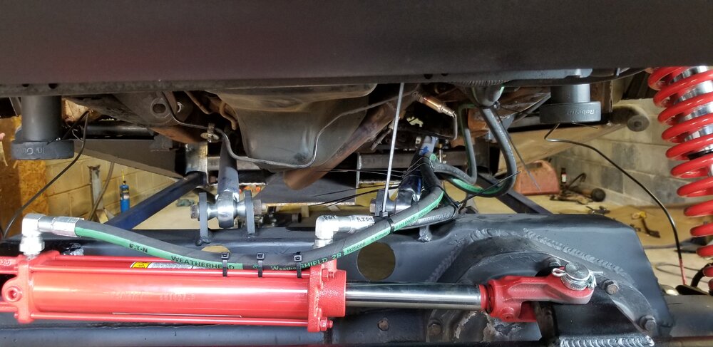

Yes I know it's just to get breaks working for nowThose hard brake lines aren't going to last long like that. A few good flexes and they'll break or fold....and then break.
Unfortunately yes, it is crazy rareSpeaking of the front...are you sure it's 3.55? It's rare that an 05+ SD front isn't 3.73.
