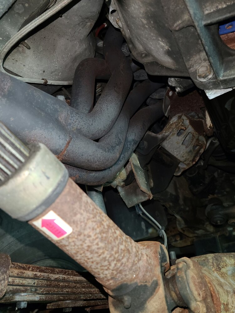

Ford uses a lot of them..called big ford cap 1330. No inner clips, they get held in place by tightening up hard. I'm gonna tack weld in 2 little tabs call it good
It's my rear case front ouput yokeI know WHAT a 1330F is...I was asking what in your setup is a 1330F. The yoke on that axle should be 1350.
They aren't, in fact, held in by "tightening up hard". Nothing is. If you distort a u joint cap, it'll bind up, wear super fast, and fail.
This is a 1330F joint/yoke on the 78/79 60 under my other Silverado. See the tabs?
I always though so too, but I wound up breaking a left rear 14 bolt shaft and Detroit in my CUCV. I figured the 1310 joint at the front pinion would have broken first...but to be fair, I WAS dragging a sled at a truck pullthe 1310 caps on a truck with 40s is asking for trouble.
So I have the wrong joint? But it fits like a glove in the spot. I tacked in full outer caps over the ujoint caps so they for sure ain't going anywhere...idk should hold up, it's on the intermediate driveshaft which stays straightThey DO use a u joint with inner retention snap rings. They're a 3R series joint, not a 1330F. 5-795X is the part number.
i actually welded a steel plate cap over the ends since the joint caps sit flush with the outside of the yoke so they're burned in good (joint was removed). they ain't going anywhere, not my first rodeo doing that either.The weld will likely crack at some point and then it'll spit out a u joint cap. Or it may already be toast from the welding.
Yes. You have the wrong joint. Who knows?
