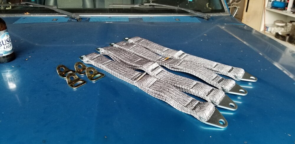

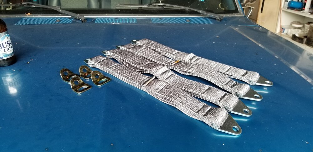

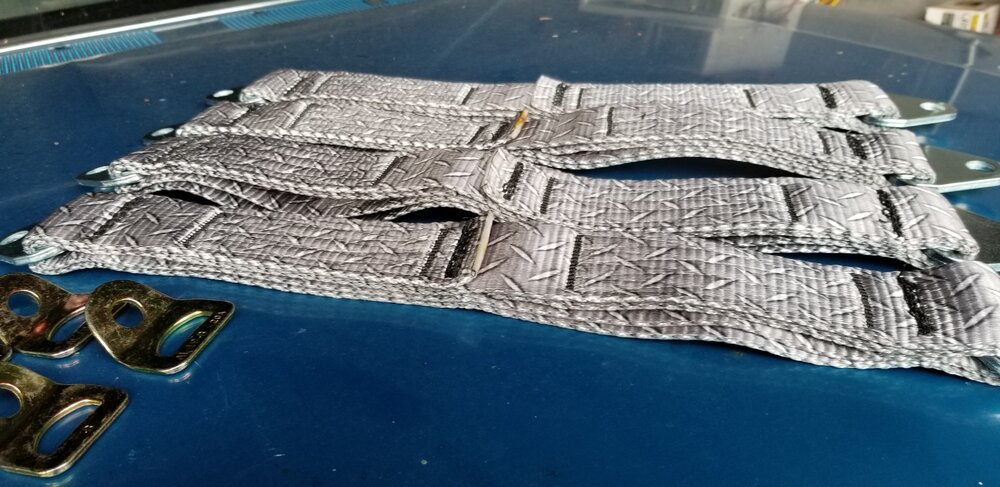

Some pretty bad ass looking limit straps. Slow on delivery but dang they look and feel awesome.
Got my new springs today, thanks a bunch to @BUCKEYE PERFORMANCE INC. And my straps are in, time to finish this rig in next couple days
am I correct to assume when mounting these kinda straps, mount the strap taunt but with 1/2" of shock shaft still showing? thanks
