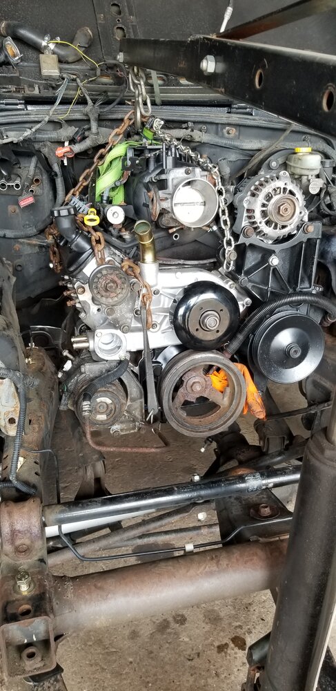

Is that the original water pump for that engine?
There's a few different style thermostat housing out there. That one looks like it's for a vette or something.
No it's a new one I ordered for a 02 Yukon which is what this motor setup came from. But like I mentioned, lots of info on places about replacement pumps being the updated kind like the one I got. I read a bunch a crap on these LS water pumps/thermostat stuff and kinda ticked me off to be honest lol. I get annoyed easily when something simple is made complex
That looks like a truck 5.3 water pump even without seeing the inlet. I would say wait until you get the engine and radiator in the truck first before even thinking about buying a tstat housing then you can get one that points the right direction. Hope you didn't tell this guy you could get this done cheap.
The thermostat will be the cheapest part of the whole swap. It's not super complicated. Some have a separate housing/thermostat and some are one piece. They're all pretty cheap.

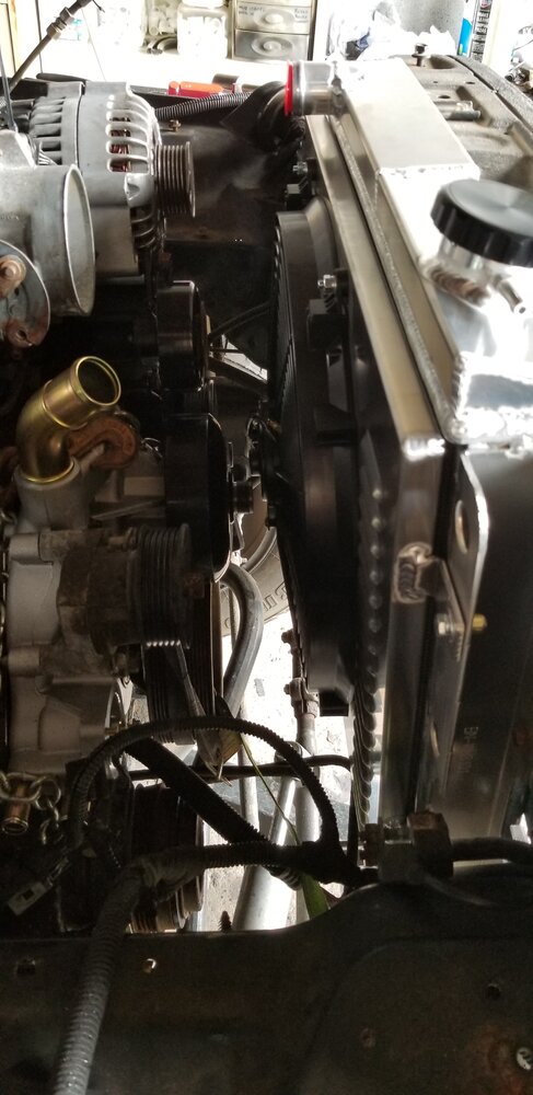

Dam yall weren't playing when you said its tight..whewwii!

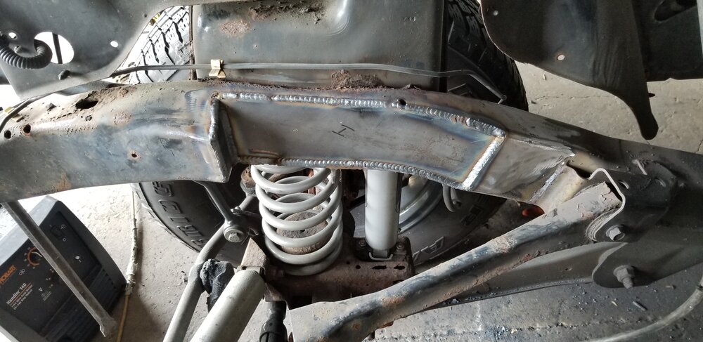

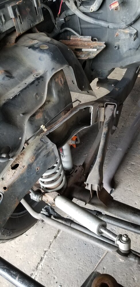

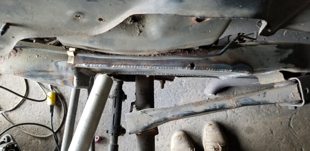

Frame notched for compressor and I gotta modify downpipes from factory manifolds but they do fit. More pics coming later
Daiuuuuum lol
Bruh...could we get any closer
Car accessories pull the spacing in quite a bit. It's only money!
That's not close. A Cummins swap in a square body Chevy with a mechanical fan...now that's tight. ¾" between the fan and radiator.
I can get my arm in most places of that setup. I mean there was literally ¾ across the whole surface of the radiator. You couldn't change the belt, radiator hoses, nothing. That didn't stay like that long.
As long as it's not touching, send it.
The real trick will be getting stock manifolds to clear completely. I was good but then forgot I hadn't put the motor all the way back yet haha, stupid
