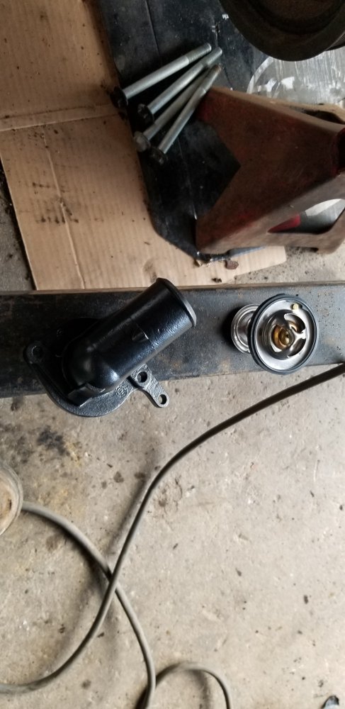

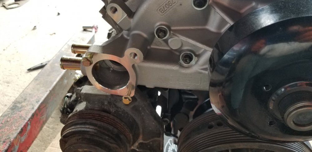

Ok I feel stupid but it appears engineers got screwy again lol.
Something with this thermostat and new water pump just ain't working here..little help?
