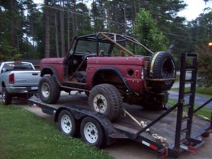

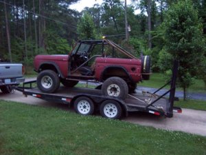

ok well John(Jph0913) towed the Bronco to my house Friday night.
so here it is arriving

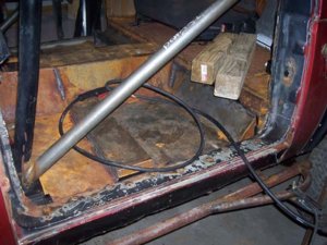

Craig(Scibetta) showed up at 9am and he and I got started.
1st we looked it over and got to work ripping out the floor plans, battery box, etc.

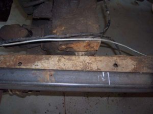

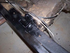

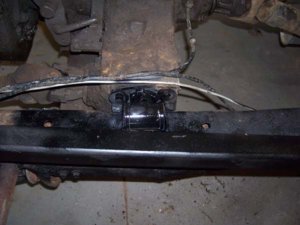

After we got them out we took off the solid mount transfer case mount and we made a bushing mount so it can move a little with the engine.
we also had to reroute the brake lines, fuel line and some wiring that were over the solid mount area.

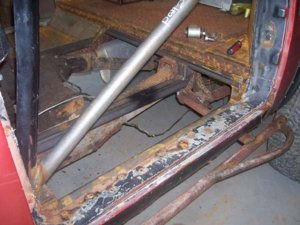

while he had the floor pans off we sprayed all the fresh metal with some under coating. this is an area that Blaze will not be able to get to, and it will rust if we did not paint it.

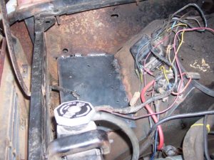

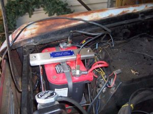

also with my experience of fords and there engines I knew that if we did mount the battery in the back and the engine would not fire it would not take long before the there was not enough power to crank it over with the battery being that far from the engine.
SO we re did the original battery tray with some new metal, braced it up and moved the nice battery box up under the hood.

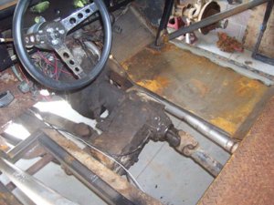

next we put the floor pans back in and finish welded them all in.. so floor pans are all in with just a few things to modify.

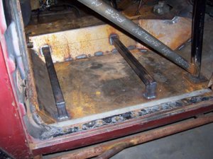

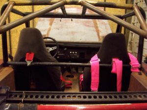

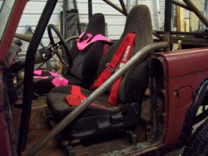

then we started to tackle the seats.. we got the passenger side bars made and welded in and just need to drill holes for the seat to bolt down..
I plan to be back on it monday and get drivers seat bars made and both seats mounted so we can put harness on.

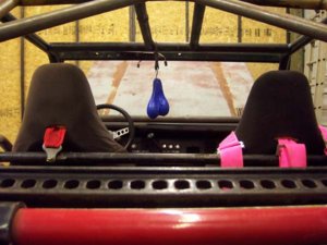

well Jph0913 and myself spent another 4 hrs tonight doing work

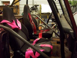

we got seat mounts finished, seats mounted and got harness in and tabs welded on but we need to get some more bolts for the harness to connect

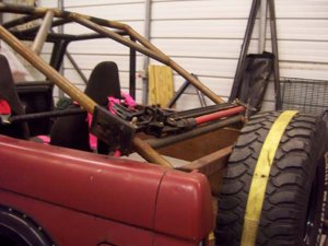

also mounted high lift in the back and attached windshield to roll cage so it will not fall off when racing :)
if all goes well I hope to paint it this wed night.
Very very nice Ken. Seats look good sitting in there. How did you attatch the windshield?
