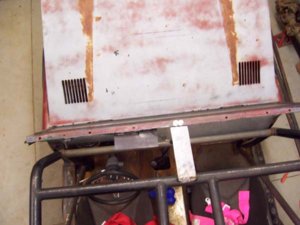

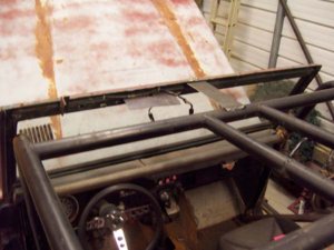

Very very nice Ken. Seats look good sitting in there. How did you attatch the windshield?
I cant say thanks enough! It's really coming together now.
I drill 2 holes in top side of windshield and bolted a plate to that and the other side is welded to cage. that way windshield can be taken off if need be.

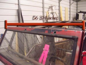

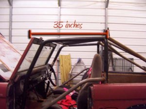

Can somebody please get me a few pics of the top of the windsheild frame, along with the roof line of cage? I'd like to get started on that bikini.
I can take some pics late tonight
fantastic
And if you could snag some measurements too that would be even fantasticker ;-)
pics of tab from windshield to cage
You need to put a rubber bushing in there so the body can flex from the cage some of the windshield may get cracked if Dylan gets it airborne.
Not to add any more work to the list, but as he said...it can't hard mounted to the cage or there will be problems.
The easiest and one of the best ways to do it is to put a small turnbuckle at each corner of the windshield to the cage. As such...
Just saying...less work for me to do when I win the bitch. :flipoff2:
I think what Ken did to the windsheild will prolly work. That hinge is in foul shape....if the windsheild does fly off..it will have that piano hinge attatched to it..lol
Those turnbuckles do look good tho...good idea there.
