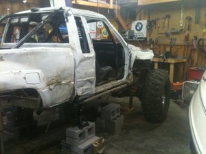

Torn down awaiting parts...
Itching for the 42s
Cinder blocks are supposed to support weight the other direction. :flipoff2:

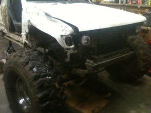

The front spring hanger kit from Sky and the Chevy 60 U bolt kit showed up tonight. Got a good bit of work done. Ditched the heavy ass front bumper that was on the truck, cleaned up the frame, welded up all the usual stress points around the front spring hanger and front crossmember that like to tear apart on these trucks and mocked up the spring hanger.
Tires and wheels should be mounted up. Will pick those up tomorrow and hopefully have the front end sitting on its own weight later this week.

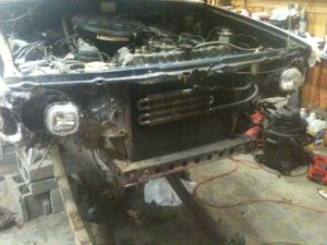

Front end tacked into place and sitting on it's own weight once again.
Dually hubs and 2.5" bs wheels are wiiiiide!
