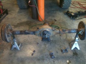

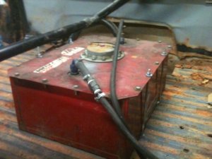

Got to working on this thing a little bit tonight. Torched all the unnecessary brackets off the axle and took the gas tank out and mocked up the fuel cell. Need to make some mounts for the cell and it will be moving again.
Going to order some 4link tabs/brackets and truss stuff here soon and start building the rear axle and links as funds and time allow.

Fuel cell is in and mounted. New filter, lines etc. Apparently I had mudwhompin residue in my fuel filter. Probably why my truck wouldn't idle well before this. Just a guess though.

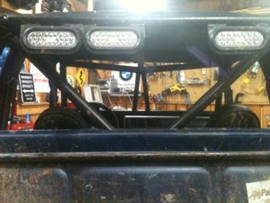

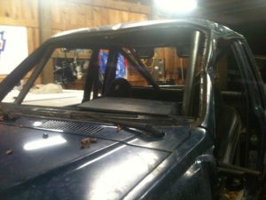

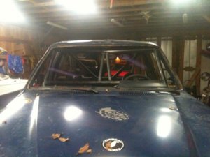

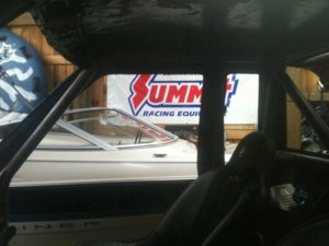

Got the cage about wrapped up tonight. Still need to figure out some sort of door bar at some point.
