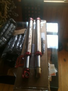

Is your shock hoop oriented so that the shock has to be mounted on the top of the axle? If you can't fit it vertically, or you need that much up-travel, you could rotate your axle-end shock mount so that it's on the back side of the axle, to get it a few inches lower.
If it won't work off the top or behind the axle I can always shorten the wheelbase an inch or so to make it work off the back of the axle tube. It's really going to come down to cutting everything out from under the truck and going from there. I've got some ideas for the shock mounts depending on how everything lines up.
