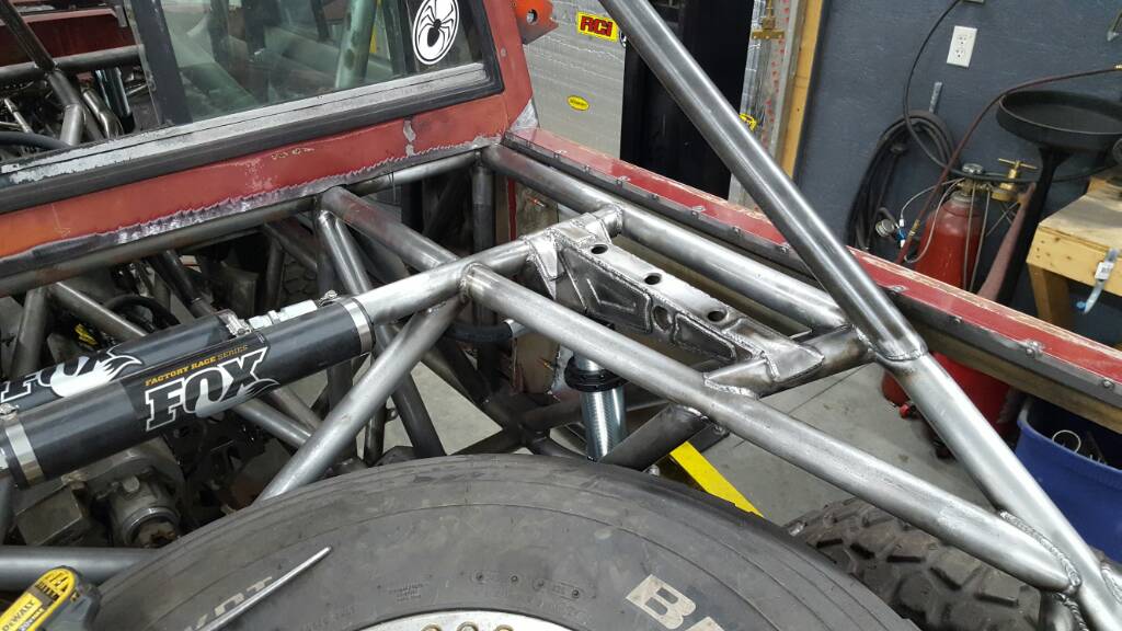

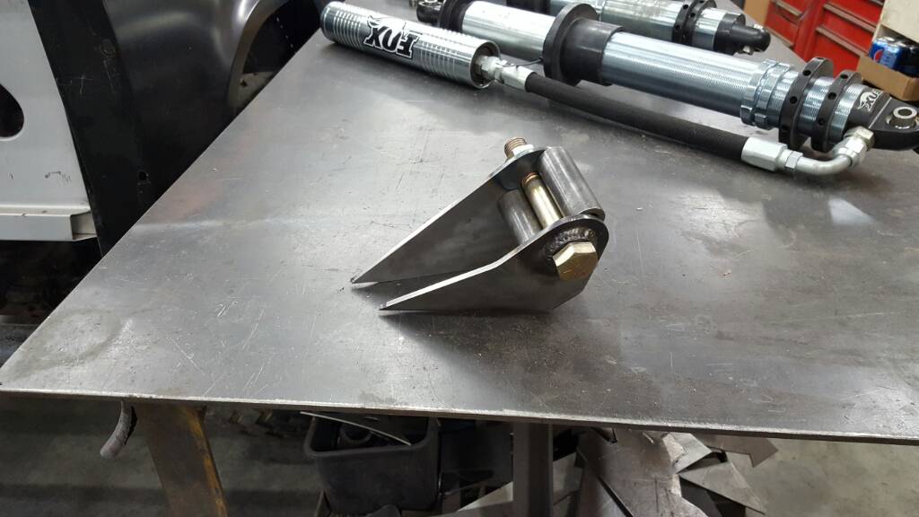

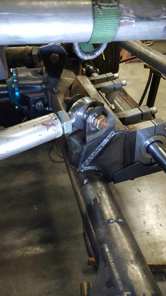

That shock mount is probably beefier than anything on my two rigs lol

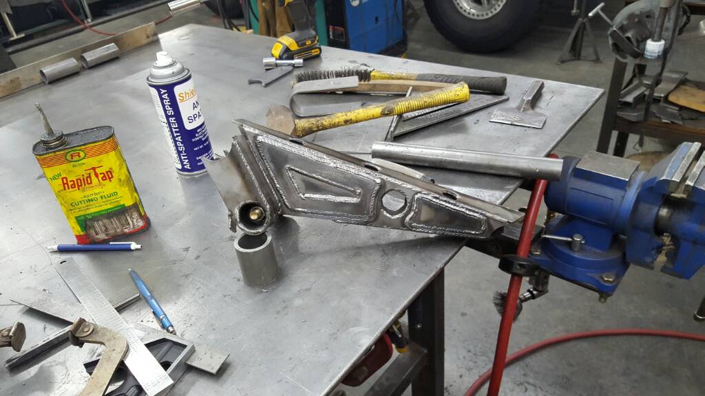

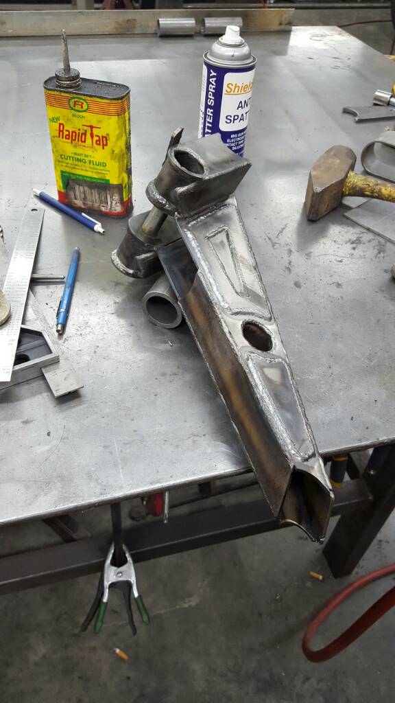

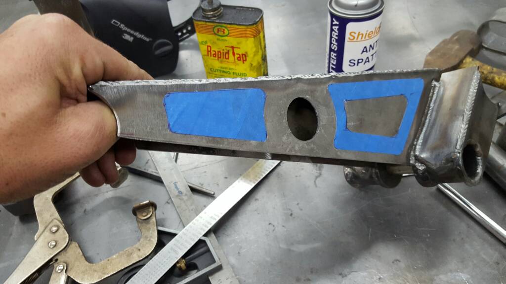

And not heavy.
The two tabs adjacent to the shock are 1/4. Everything else is 1/8, while the laminate is 14ga. Didn't weigh it, but I will the other side, for shits and giggles.

And not heavy.
The two tabs adjacent to the shock are 1/4. Everything else is 1/8, while the laminate is 14ga. Didn't weigh it, but I'll will the other side, for shits and giggles.

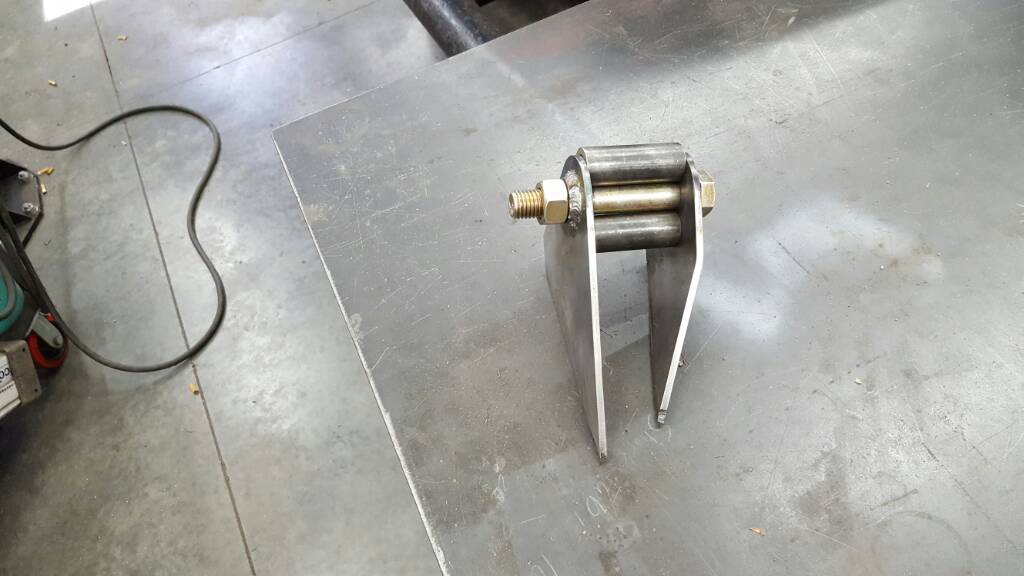

Back to doing work...

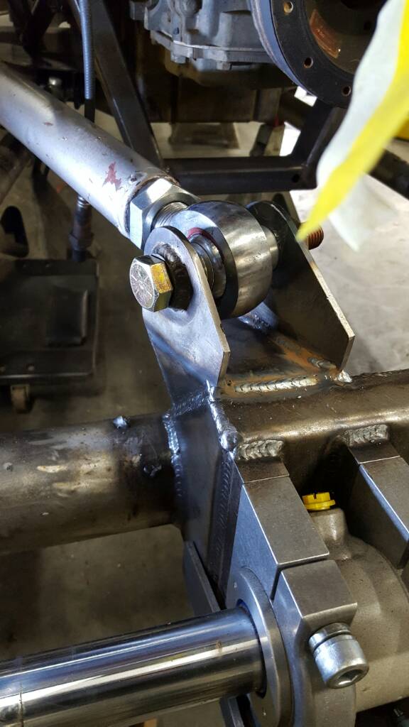

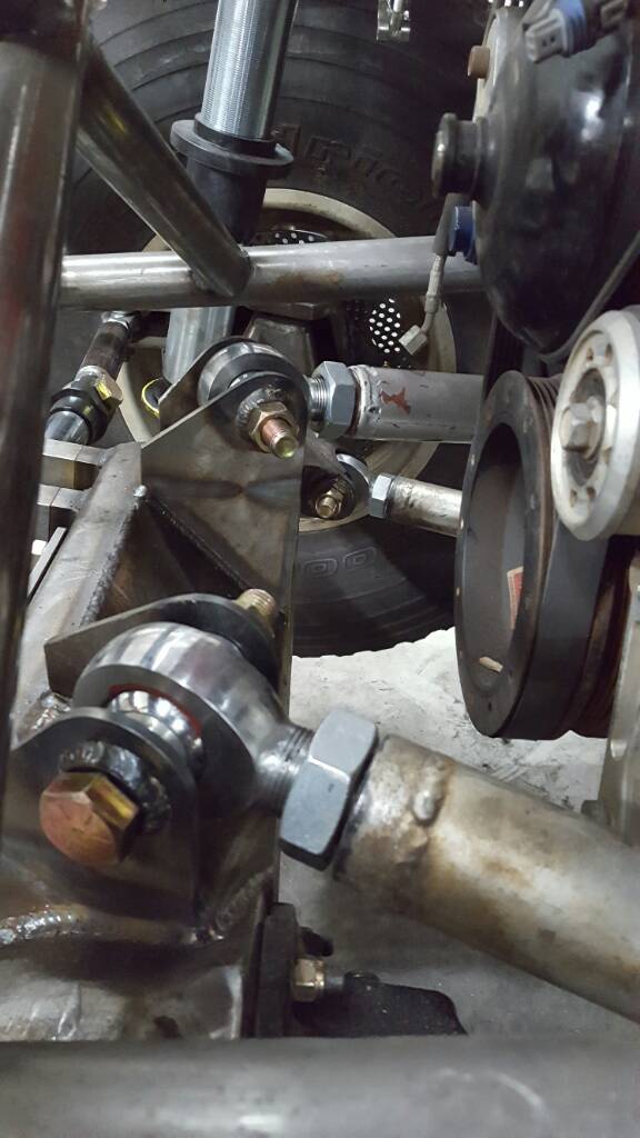

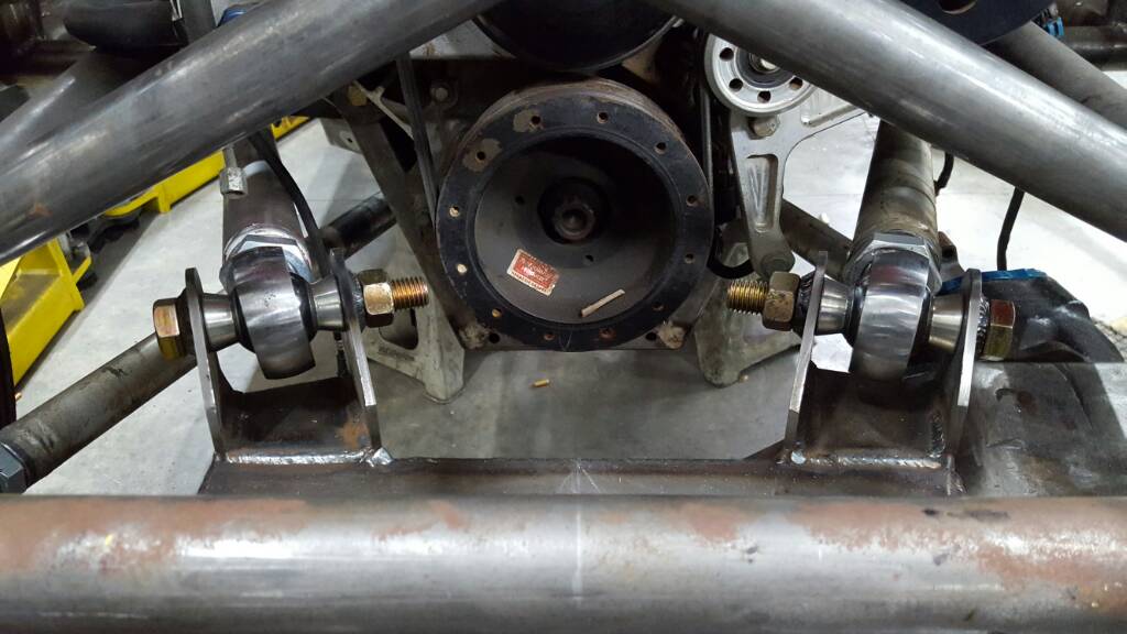

Working on the front end; finishing upper link mounts-from my booty fab temp mounts, and starting construction on the shock mounts, upper and lowers.

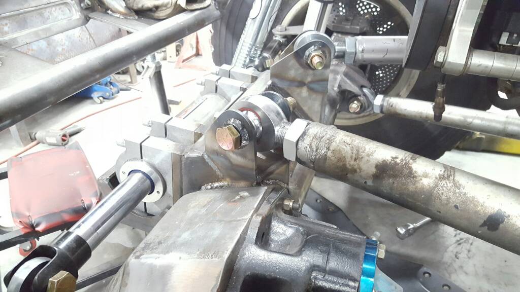

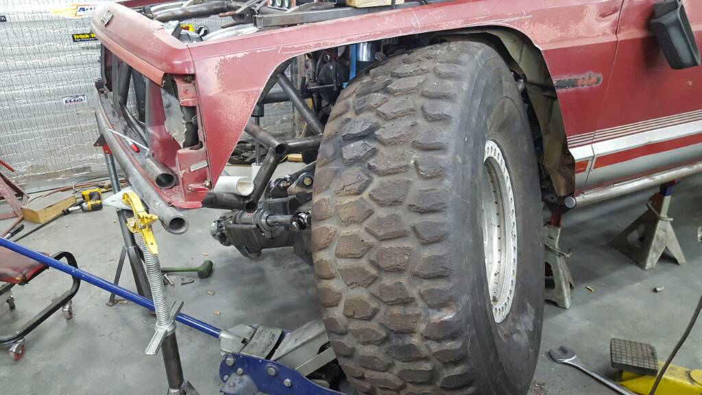

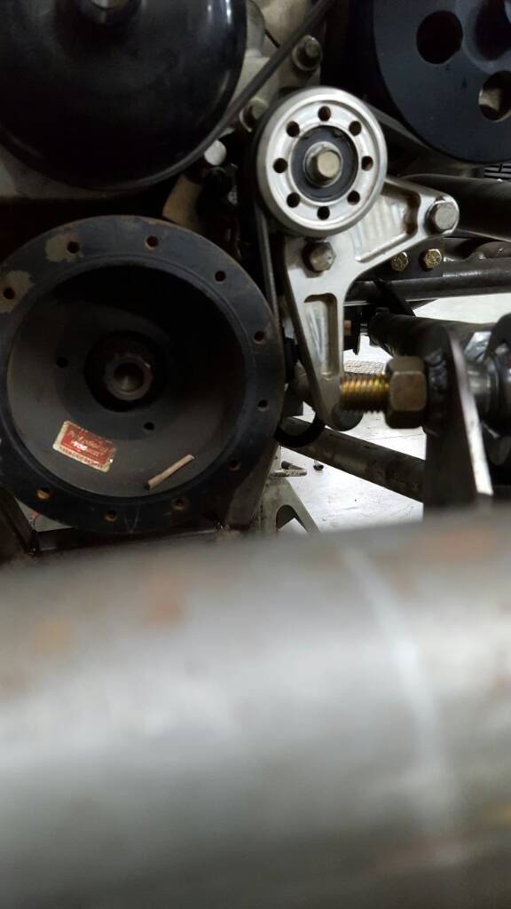

is this at full bump? if not can you take this same picture at full bump? curious to see where your links are in relationship to motor pulleys at full bump

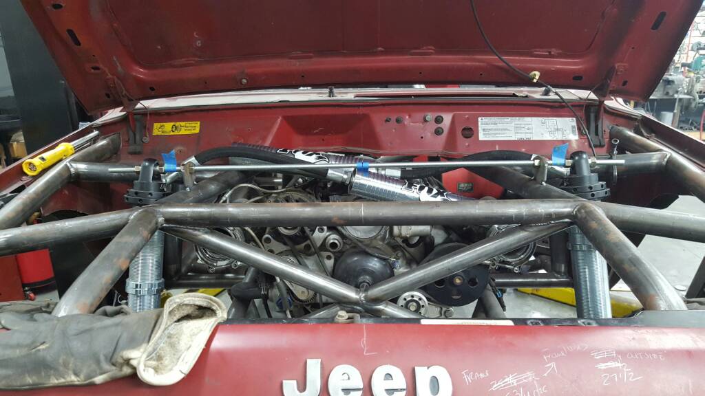

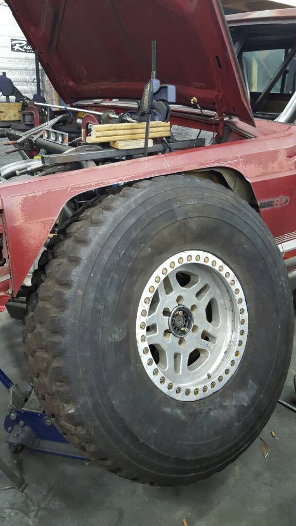

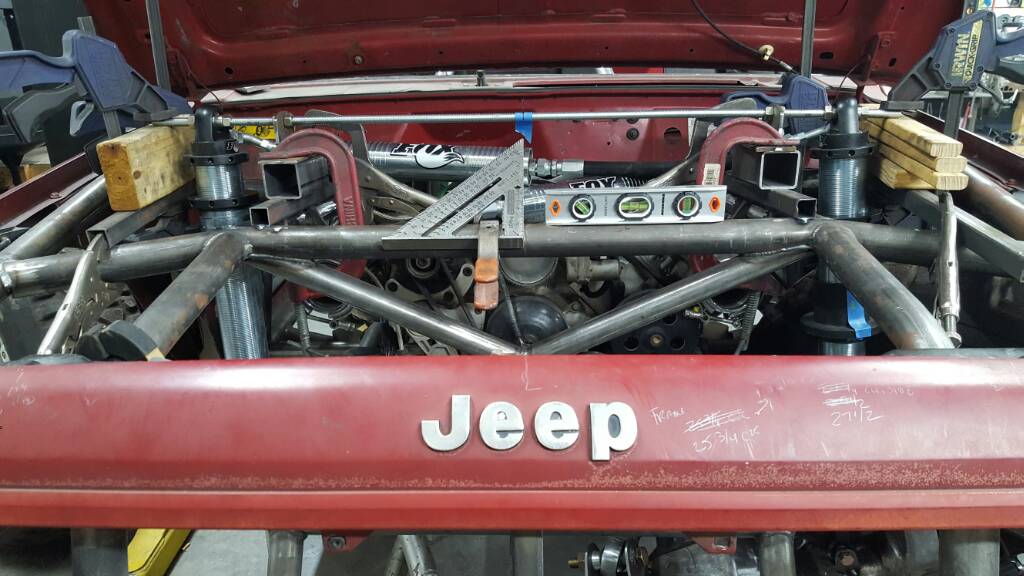

Here are today's pic. I dropped the uppers ".75, still maintaining 9" of separation and a 12.5" spread on center. Main reason for the change was to have more room for the accumulator and exhaust. Ya'll wouldn't believe how tight this bastard will be once everything finds a home. [emoji90]
Items left to go under hood; exhaust, bumps, accumulator, rad, expansion tank, overflow, steering resi and cooler, washer reservoir, shock resi's, of course the winch and possibly sway bar.

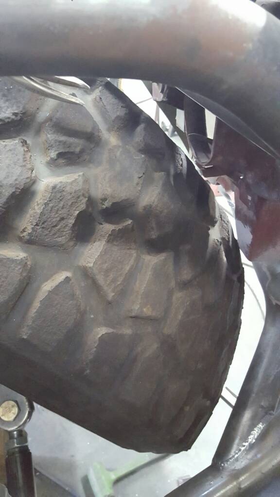

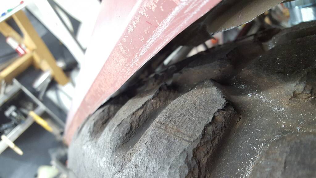

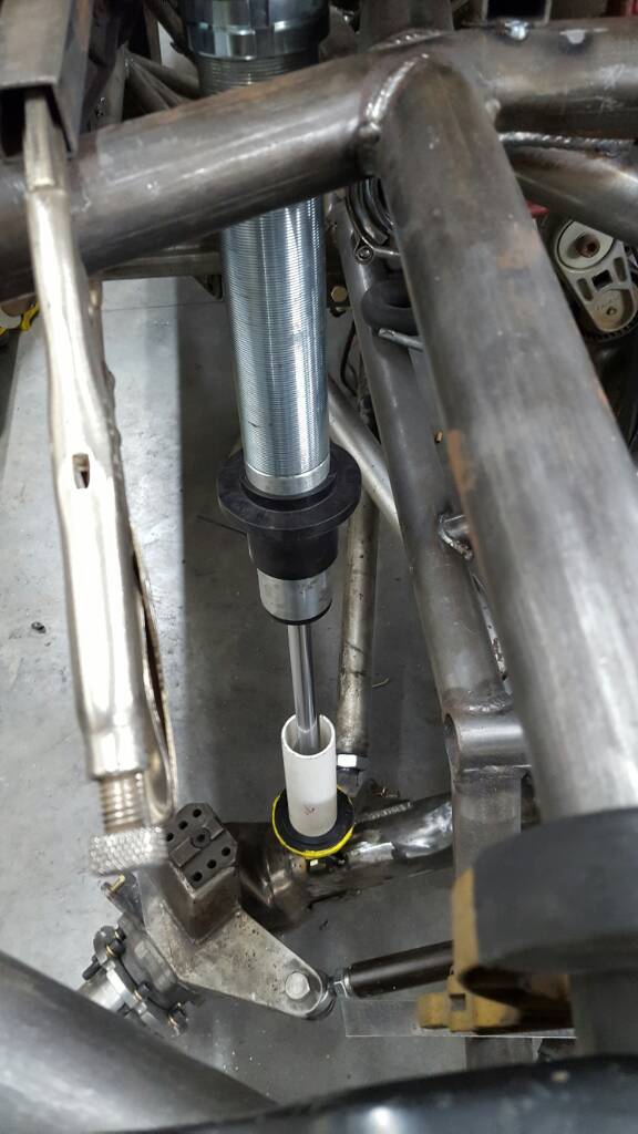

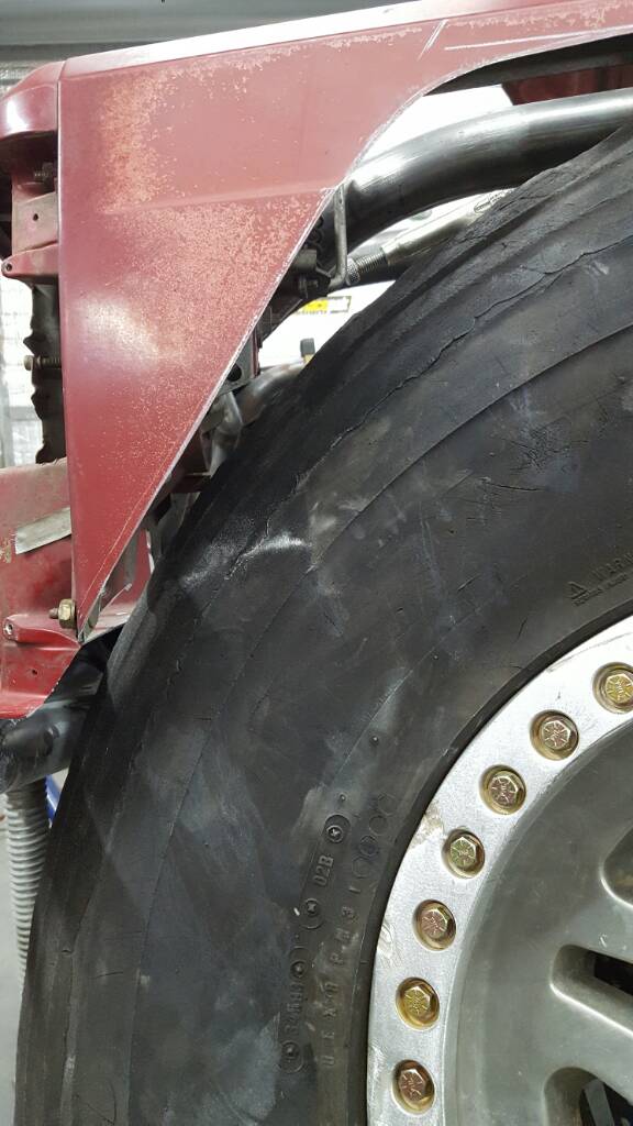

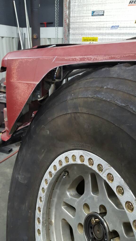

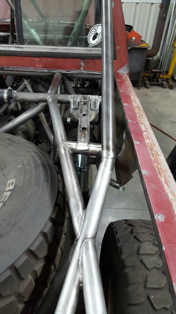

This front end is kicking my ass today. Attempting 7" uptravel; will work fine on the bumpstops but during articulation there won't be any fenders left. Will most likely raise the front ride height 1" but leave the travel at 7" to have articulation top out cleanly without interference. Also may have to put the shocks through the hood if I can't make the ride height change work...damn narrow axles...[emoji36]
(Raising the front will not give it the Carolina squat, it had a slight positive rake naturally in the body...)

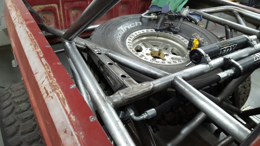

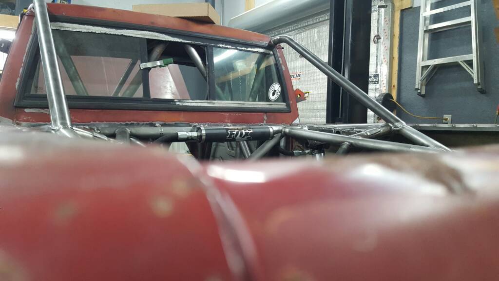

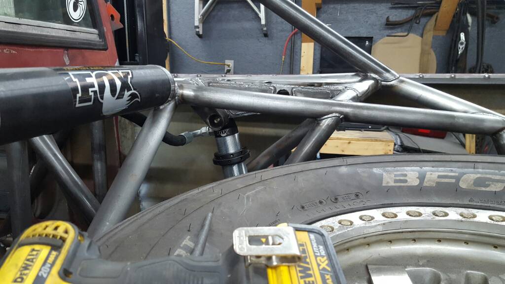

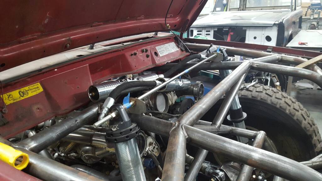

Do some body work try the thought of a double cowl where the shocks come through the hood. Give us a pin point of where the shocks come through the hood and how high they will be you may be able to pull off a small cowl that's suttle on each side cover that by racing stripes. Just a thought

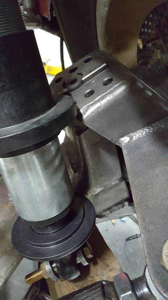

Finally! After about 12 attempts of resetting the shocks in multiple locations I was able to nearly attain the impossible, lol. 16" shocks on a manche with 40° of steering and 39's between the headlight and the door- (almost)...but alas I do have to go through the hood. Which doesn't upset me too terribly, aside from the sleeper theme, I do like the look of tasteful mounts through the hood.
Now I can rock and roll and finish the rest of the heavy fab before I can finally start the hanging of stuffs on the truck!
And here's the almost, had to get into the back of the market light area of the header panel. No biggie, was going to adapt an led light in there anyway.
