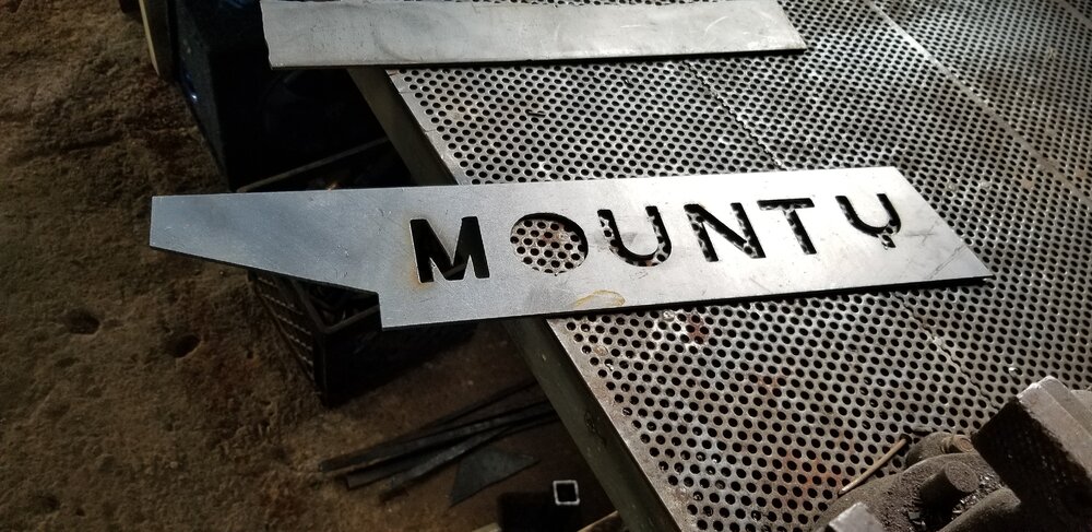

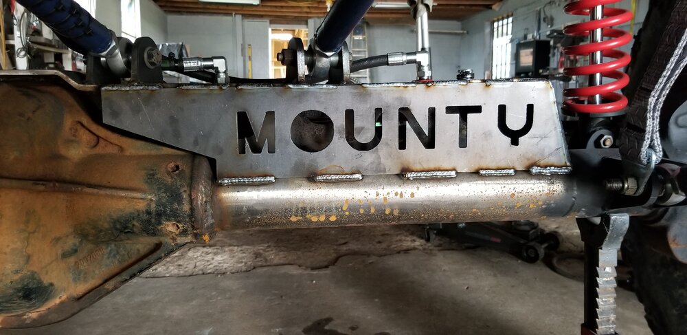

My first piece I cut...last piece on my rig, truss brace for front axle lol..not bad, I gotta dial in the circles still.
Could've been more precise but I literally spent like 10sec measuring lol

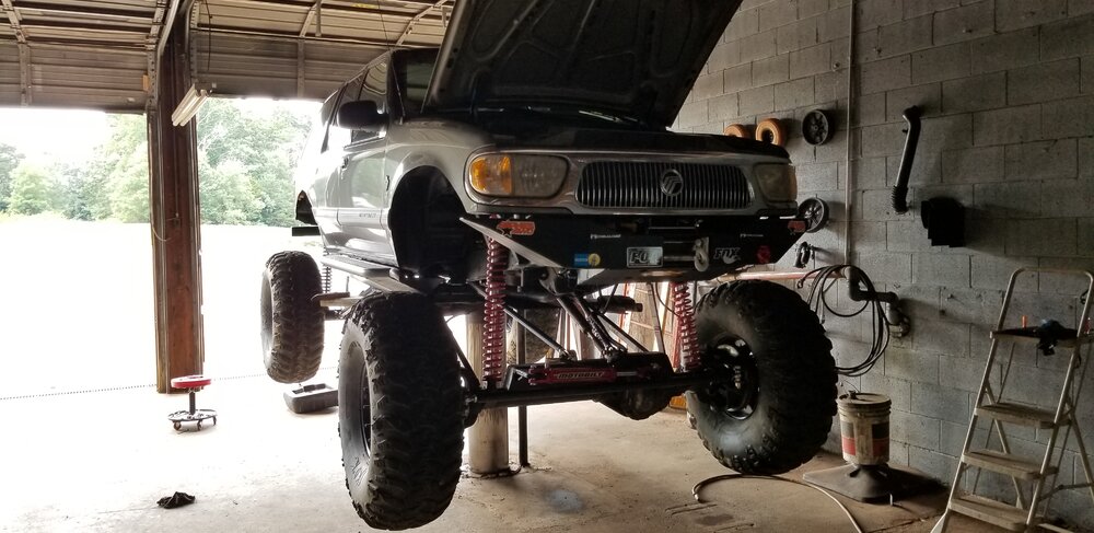

Oh yeah finally tested out my lift..holds this weight for 24hrs with only dropping maybe an inch...sweet

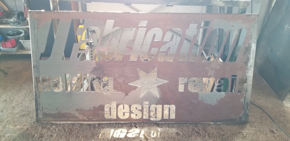

Dang dang dang I'm loosing my mind with this homing the table. It's the only thing I cannot comprehend. I have my business sign loaded in mach 3 but no matter what when I run simulator it doesn't go to right area and this would be a huge screw up...ayyayay

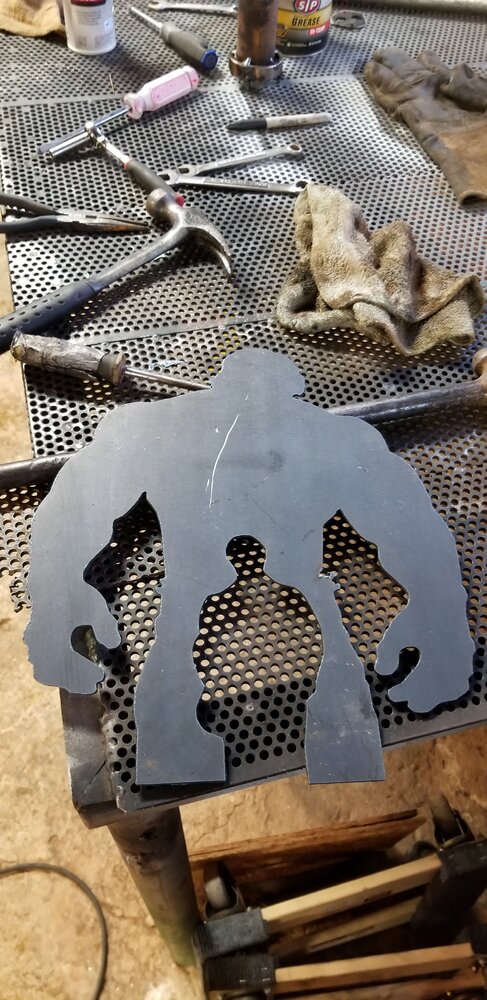

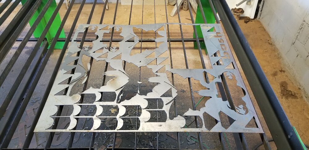

Cutting random stuff playing with the table, got my money's worth outta this sheet
