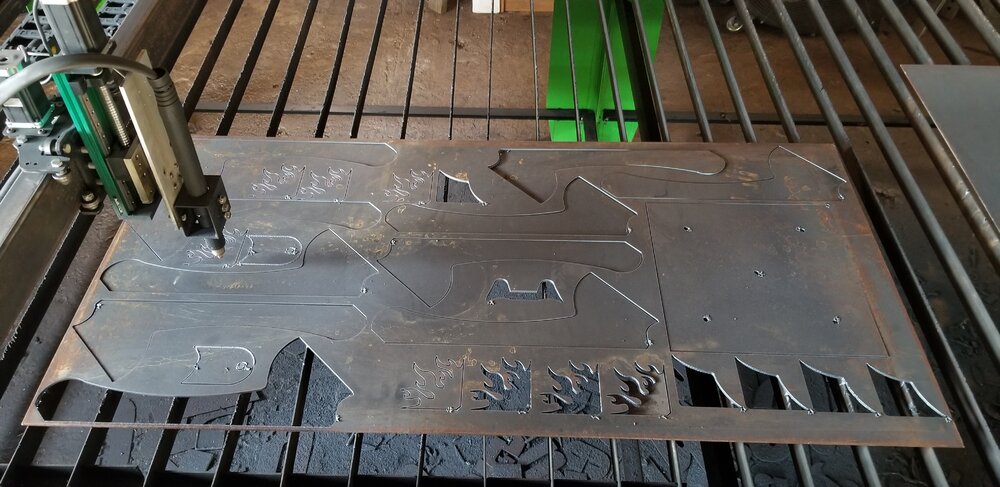

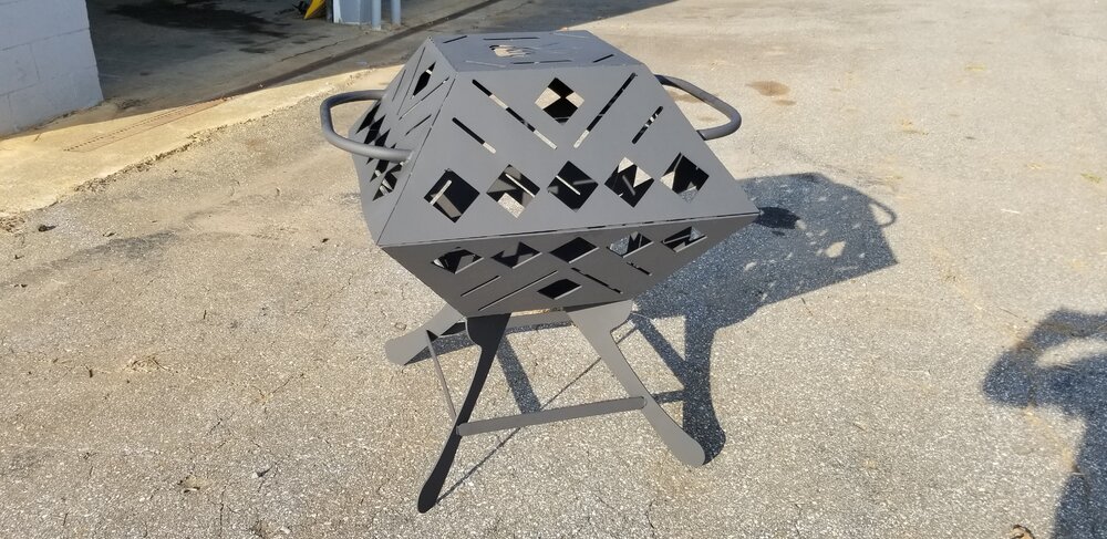

Well after burning up tips like crazy, pulling what little hair I have left, thought about selling it a few times and 4weeks of hell I've finally got this cutting pretty good...mostly flawless.
These are 30" wide top, 16" wide centers, 30" wide legs.

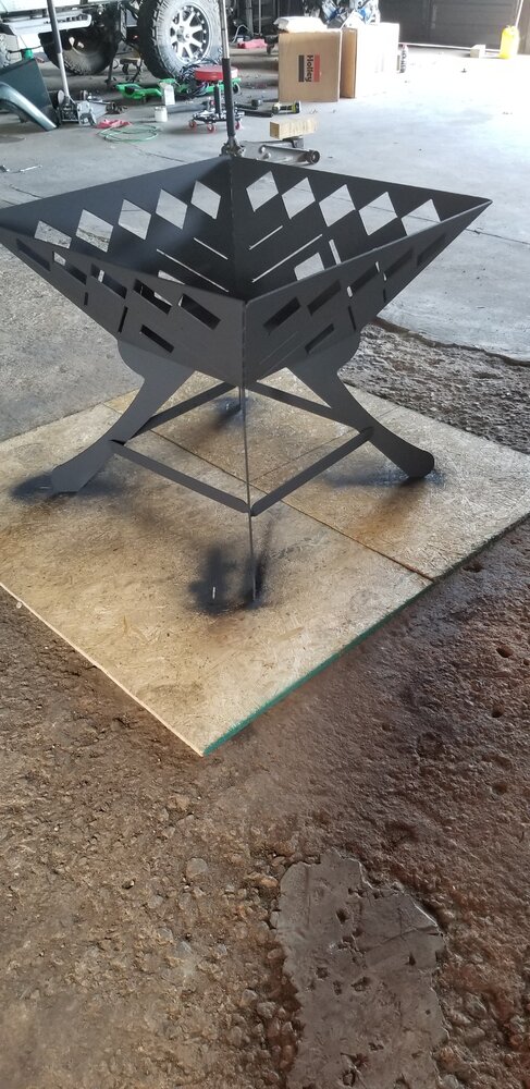

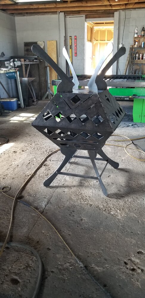

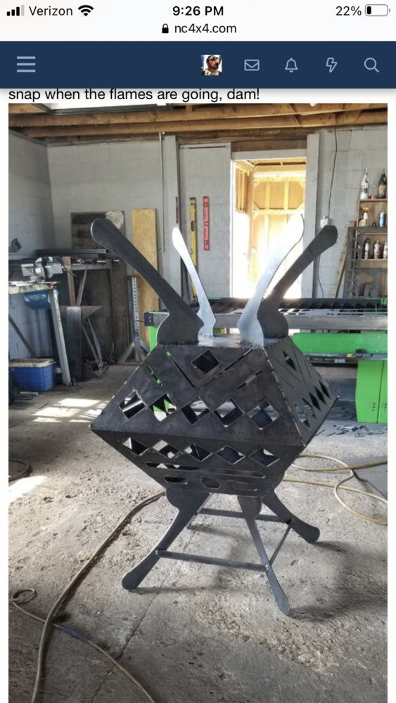

I think I'm addicted.....no i know I'm addicted cause today I'm going to make a top for one of these firepits you see above...basically make another one identical but lighter material and set it on top as a closed in pit, put some handles on it and boom, gonna be one bad ass firepit ...stay tuned
Imagine this but obviously without the legs on top...oh snap when the flames are going, dam!

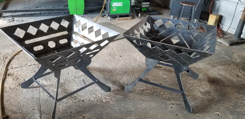

What thickness material are the firepits John?

10g on these,

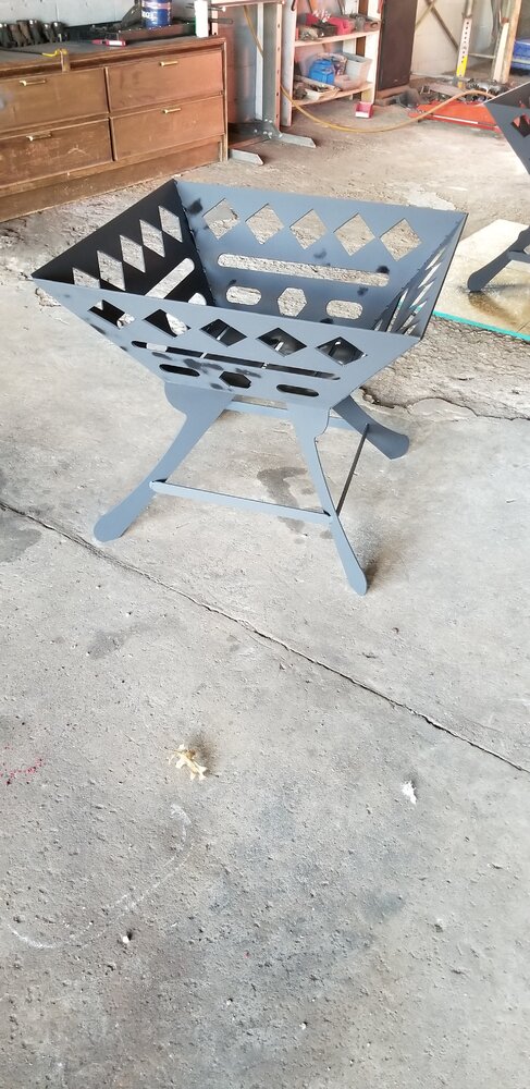

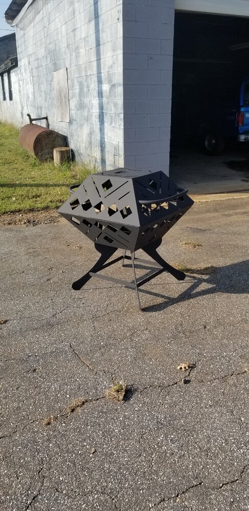

10g firepit as shown (with your own decals and not being crazy involved) without a lid $275 local pickup, cash price.
Same firepit with the lid, $440.
I've based my price off internet sales of similar products but they charge shipping plus tax and there's a lot that are simpler but cost more so I think I'm descent price....?!?

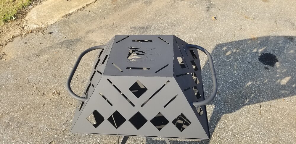

Thought - its probably going to warp over time. If you add some kind of small flat horizontal space in the corners, even just a 2-3" gusset then it will make it a lot easier to set the top onto the bottom without it being perfect and easily falling off.
So put gussets on the inside of the top piece
