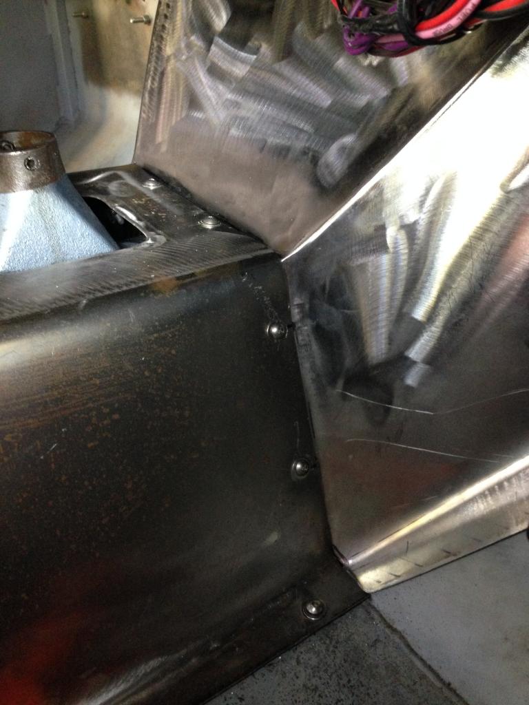

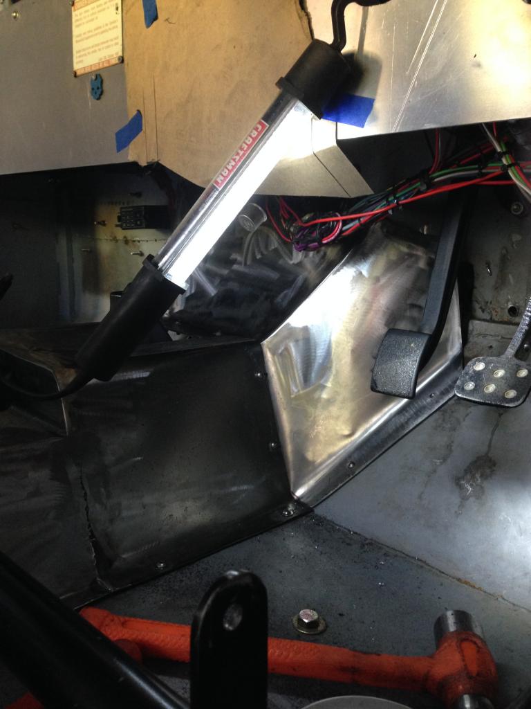

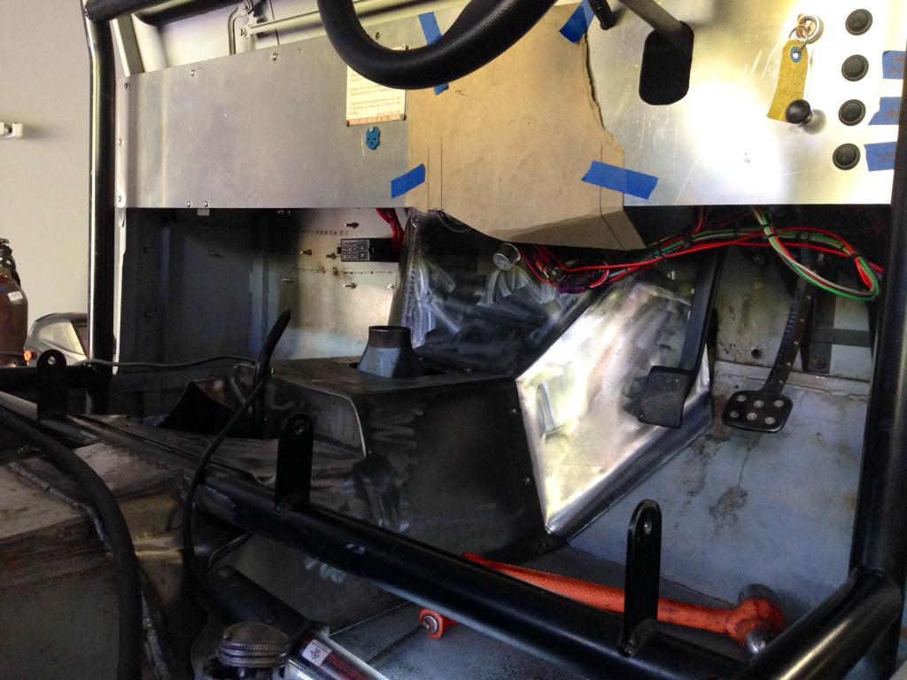

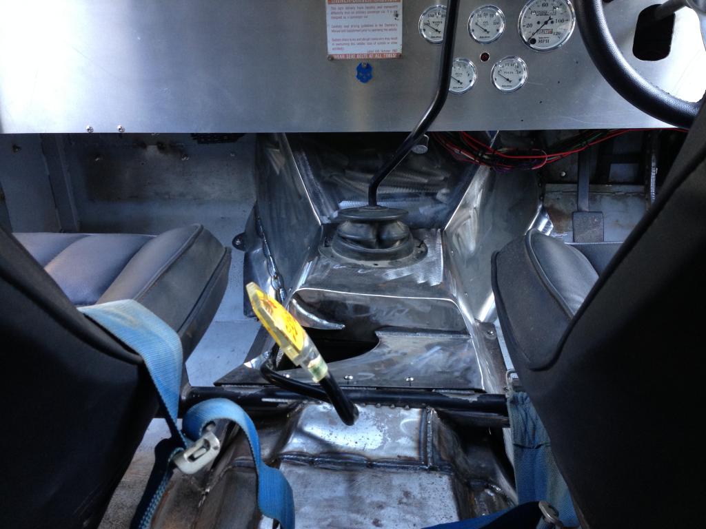

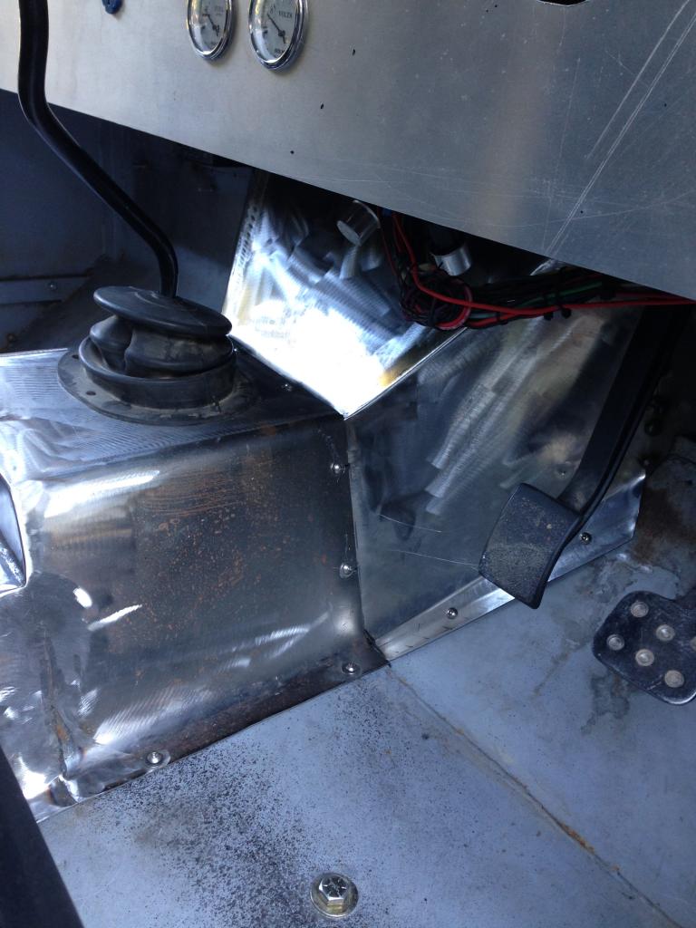

Back at it again this weekend. My main goal was to get the transmission tunnel finished up.

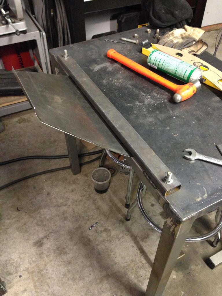

First off, I couldn't find my c-clamps in the garage so I just made a home built make shift metal brake. It worked great. Basically, the bolts are welded to my welding table, then holes were cut in this random piece of strap rectangle tubing. That way you can slide the piece you want to bend in between the table edge and tubing, tighten the bolts down, bend the piece, loosen the bolts then voila! Bent piece of metal!
ai1024.photobucket.com_albums_y309_95builtjeep_gone_20postal_photo255_zps5eb89dc7.jpg
Gettin' it done! I made the front portion of the tunnel removable as well.
ai1024.photobucket.com_albums_y309_95builtjeep_gone_20postal_photo256_zpsd78ff459.jpg
I welded nuts on the backside of the tabs I have on the underside of the tunnel so you can take the tunnel out with just one person and one hand.
ai1024.photobucket.com_albums_y309_95builtjeep_gone_20postal_photo258_zpsb0f98212.jpg
Another.
ai1024.photobucket.com_albums_y309_95builtjeep_gone_20postal_photo257_zps3c7a7850.jpg
All done with the seats back in. I took a test drive, what a difference the closed in tunnel made! Very happy with how it quietened down the cab and also prevented exhaust fumes from getting into the cab like before.

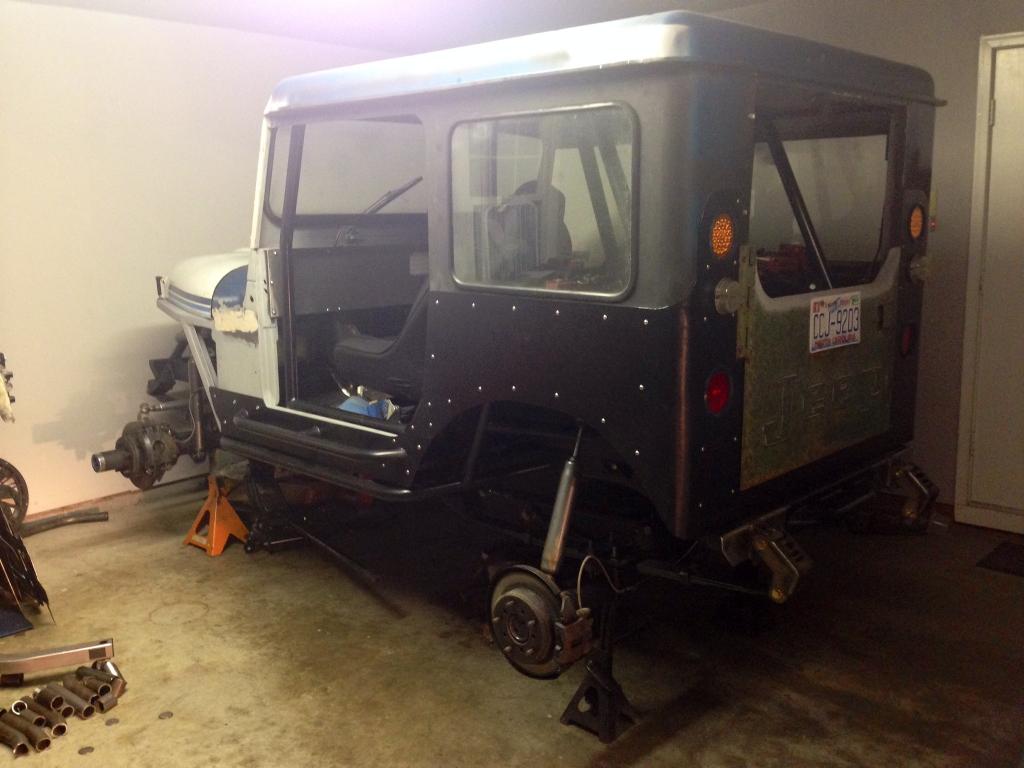

I took my buddy, Joe, for a test drive after I got it all back together and too much throttle, traction and locker made my short work of my driveshaft. This is a shot of me pulling the broken rear driveshaft so I could limp my jeep home using the front axle. :D
ai1024.photobucket.com_albums_y309_95builtjeep_gone_20postal_photo260_zpse4d101de.jpg

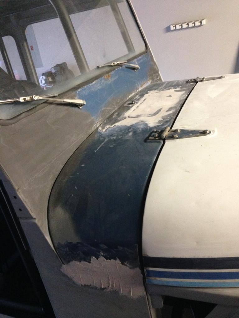

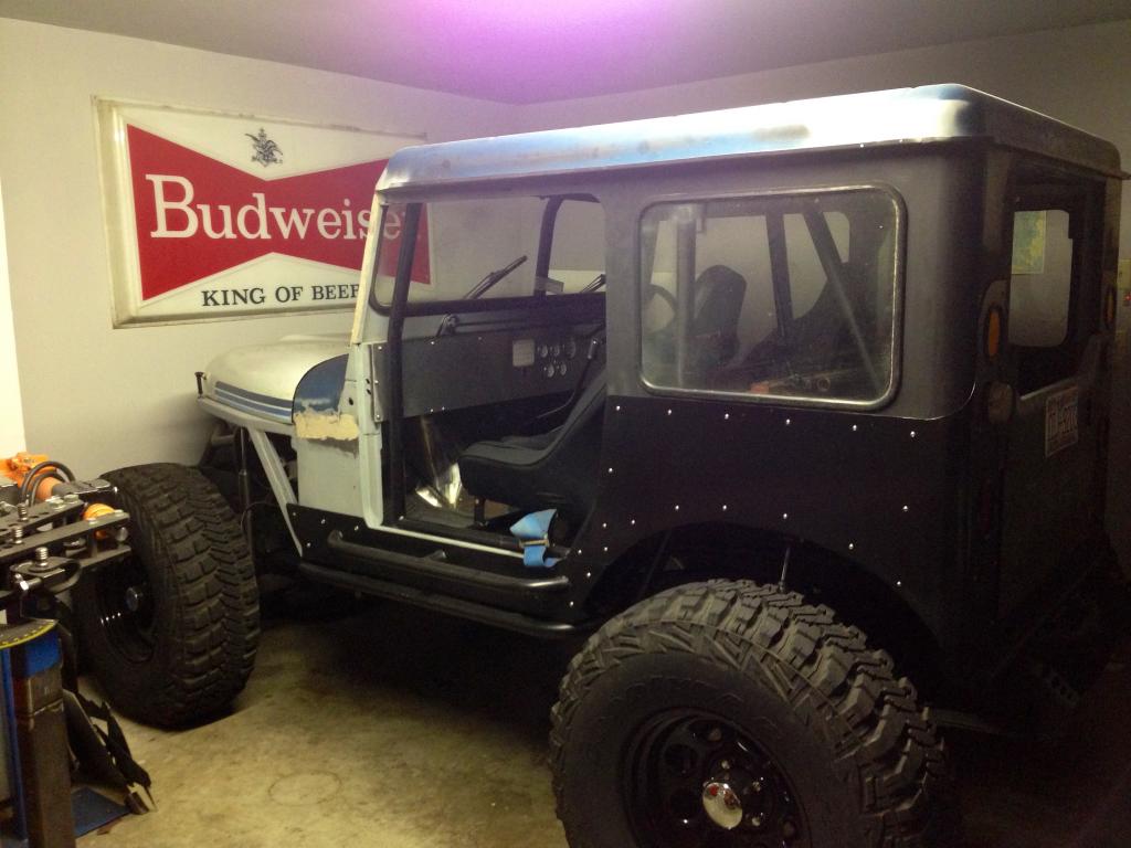

Body work SUCKS! I've been doing bondo work on all the sheet metal I've added so I can lay some paint on it. I also welded and filled in the cowl area in front of the windshield since I don't have heat in my setup. That way my feet won't get wet. :D
ai1024.photobucket.com_albums_y309_95builtjeep_gone_20postal_photo262_zps7b27ffae.jpg
I also changed my idea on the paint scheme. I'm now looking to do a patina style paint job. I am going to finish all the body work then lay down some grey primer, then a few colors, maybe white, red and then the final color as blue, then sand and modify the paint job so it looks weathered. Then once it's exactly how I want it, I'll put some clear over the whole jeep so it stays like that. I am going to pick up an air brush kit and have some fun with it. It'll be like an art project from college. Yes, I'm an artist at heart! :flipoff2:

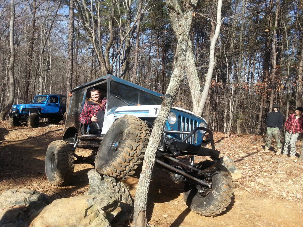

Haven't done any work to the jeep lately. I drove it down to Uwharrie again last weekend to do a day trip with some friends. My jeep did great again. No issues at all. I gauged my fuel economy on my drive down to Uwharrie. My jeep averaged 19.7mpg on the way down going about 55-65mph. I was SHOCKED! I still need to get the engine tuned because it's running rich still. So that number should get even better!

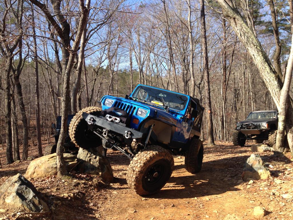

Here are some shots of the group from the weekend.We didn't get too many photos. We were too busy burning up the trails.

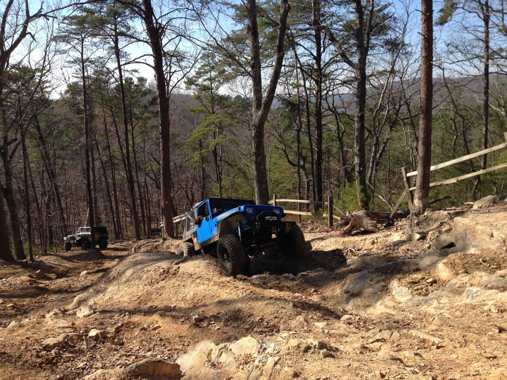

My buddy Joe flexin' his choptop XJ.
ai1024.photobucket.com_albums_y309_95builtjeep_gone_20postal_photo264_zpsee7a3d18.jpg

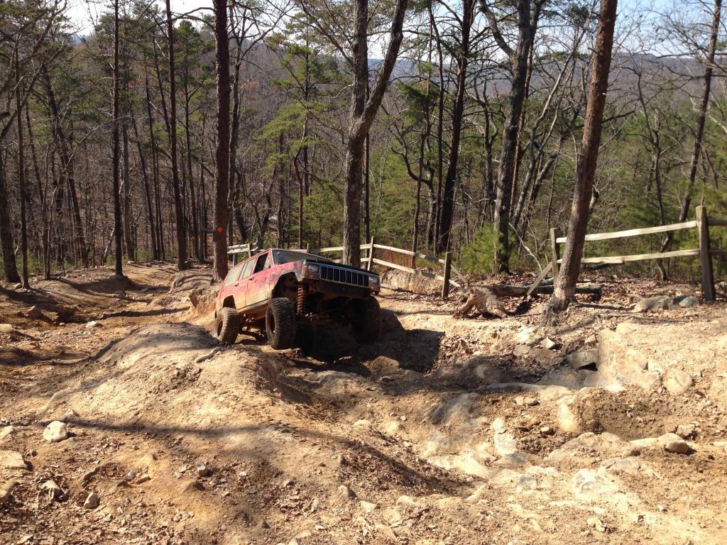

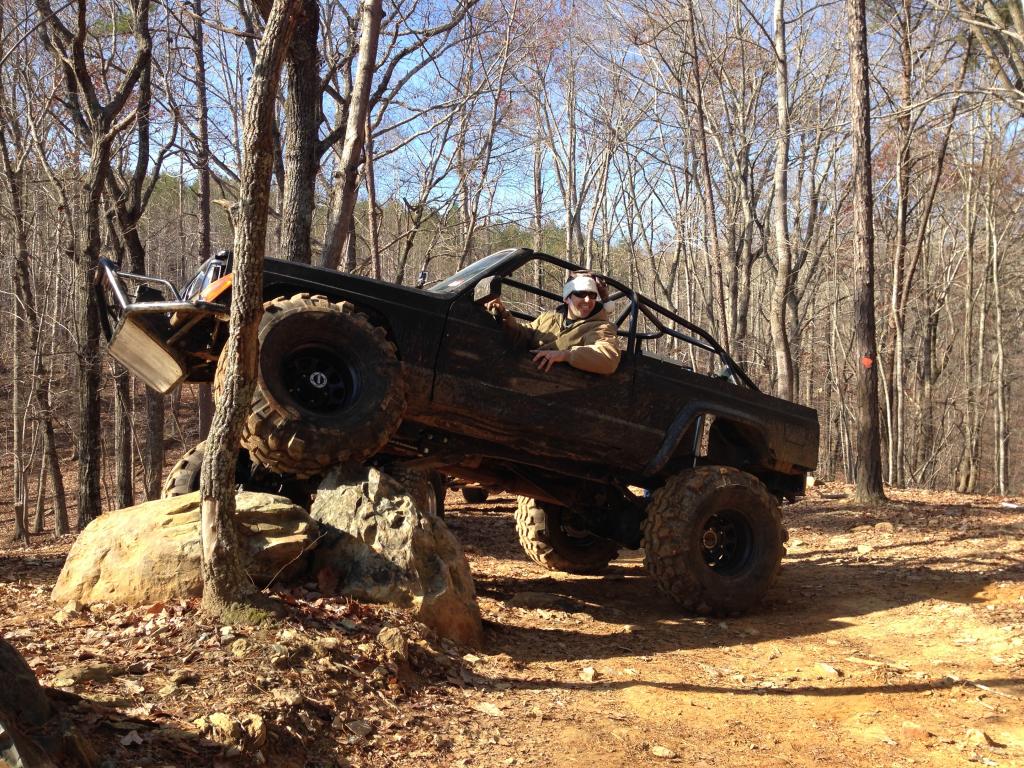

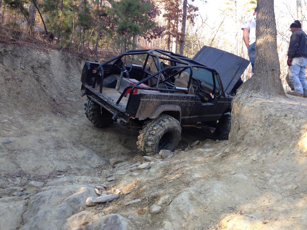

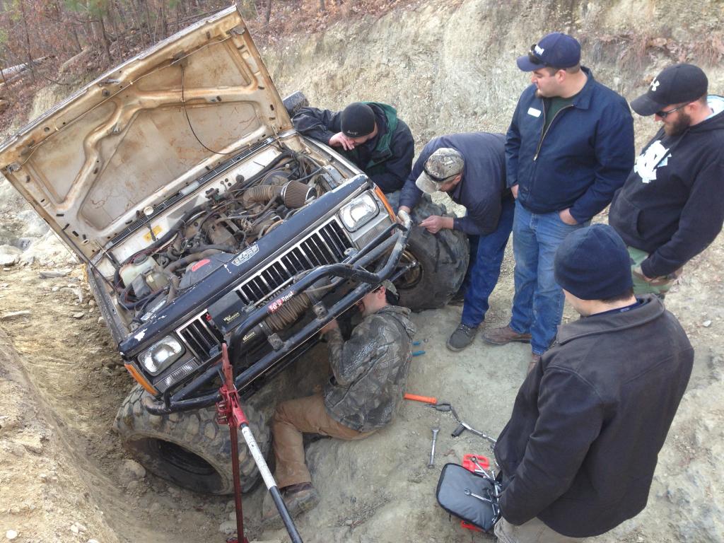

Then this happened. Joe's XJ tried to lay down and take a nap on Daniel trail. 2nd XJ we saw at Uwharrie with sheered steering box bolts from the day. MarsFab has a brace design he created to fix this issue. Can't wait to see that installed on it!
ai1024.photobucket.com_albums_y309_95builtjeep_gone_20postal_photo272_zps47350a2d.jpg
Best thing about Joe's broke XJ was the fact that he now owes me one because he used my tools, hardware and jack to get it off the trail and back on the trailer. haha!

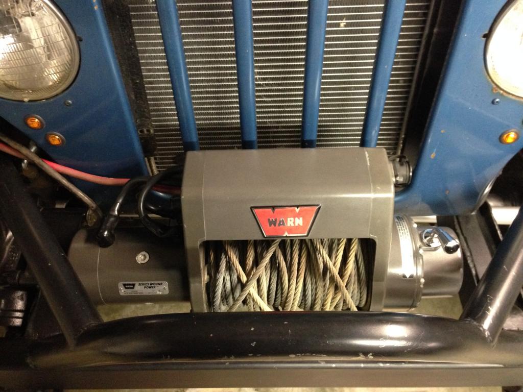

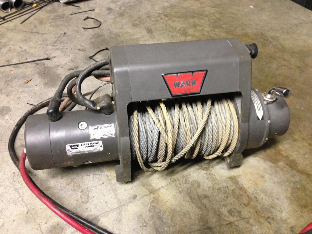

I picked up this little jewel from Craigslist on Friday. The guy I bought it from didn't realize what he had. Lucky for me. Cleaned it up and mounted it over the weekend.
ai1024.photobucket.com_albums_y309_95builtjeep_gone_20postal_photo274_zpsdb03fff9.jpg

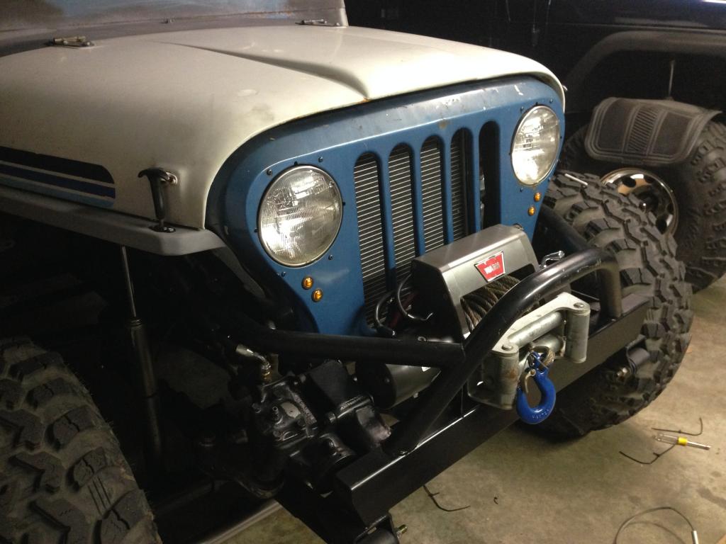

Mounted up minus the fairlead.
ai1024.photobucket.com_albums_y309_95builtjeep_gone_20postal_photo276_zpsbd260bb1.jpg
Cleaned up. Yeah I did wax it. I'm OCD like that! :D
ai1024.photobucket.com_albums_y309_95builtjeep_gone_20postal_photo275_zpsf1755030.jpg
All done. I painted the winch hook blue too. Kind of stupid because it'll get chipped up whenever I use it, but Oh well! I thought it looked good.

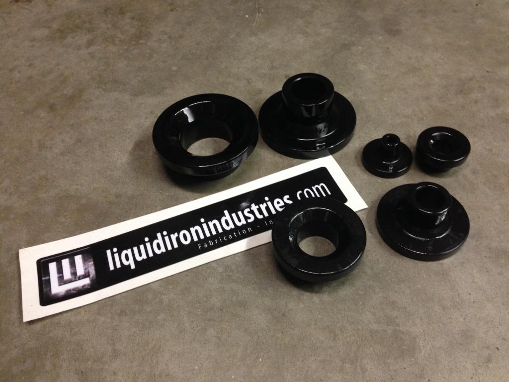

I called up the guys at Liquid Iron Industries and picked up a few more things. Some dimple dies and poly bumpstops. What a great bunch of guys to order from. Placed my order and had it at my door in 24-48hrs.

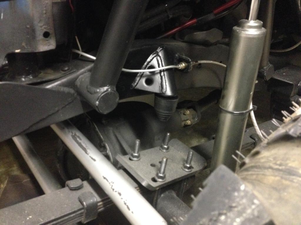

I never made bumpstops on my rig which it definitely needed because my steering was getting into the framerails. If that continues, I'll notch the frame a little bit. I pretty much set the bumpstops so they bottom out with the suspension and not the steering. I didn't want to lose any up travel due to steering interference. This is side #1. I wasn't too happy with these welds but whatever. I'll do better on the other 3. For my design, I welded a nut on the backside of the round plate to hold the bumpstop. Then welded it to a piece of 1.75" DOM tube. Then used my new dimple dies and put a few holes in a gusseted piece and welded it on also.
ai1024.photobucket.com_albums_y309_95builtjeep_gone_20postal_photo279_zps46a4ac6a.jpg

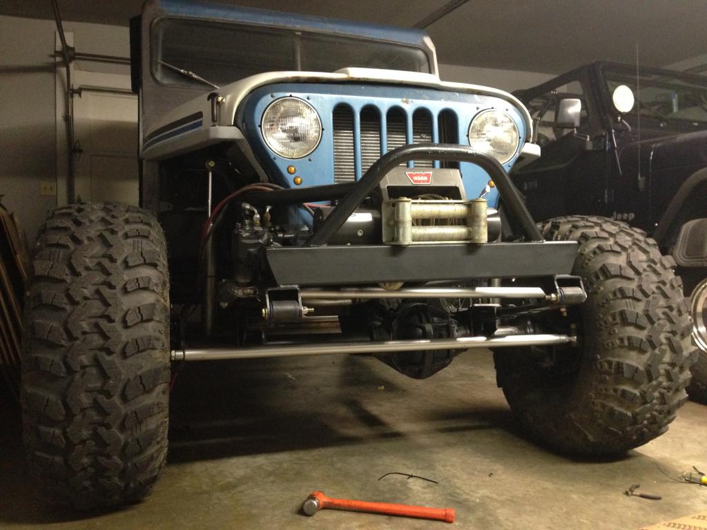

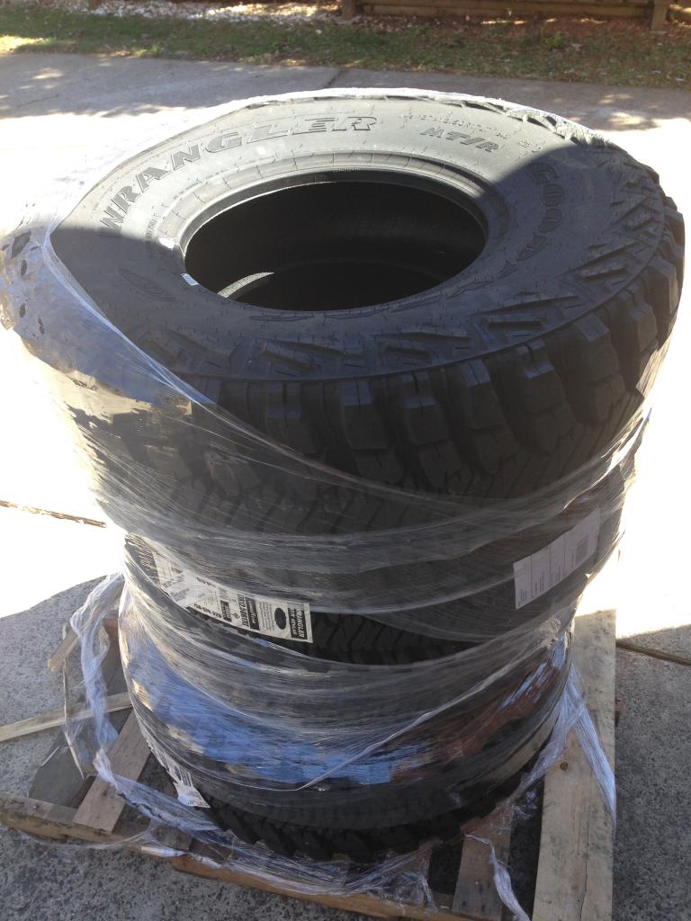

Special delivery for my postal jeep today! :D I picked up a set of 37x12.50x17 Kevlar MT/Rs. I'm really excited about the new tires. I am ordering some 17x9 wheels tomorrow. Then hopefully within a week I can get them mounted, balanced and on there so I can see how much better it rides on the highway.
ai1024.photobucket.com_albums_y309_95builtjeep_gone_20postal_photo287_zps2d6709f9.jpg

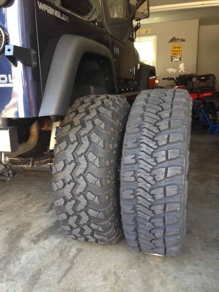

I rolled them next to my 37" irok radials and the MT/Rs look HUGE! I know they'll get shorter and wider once I mount them on a wheel, but these tires are still really really tall. I like it!
ai1024.photobucket.com_albums_y309_95builtjeep_gone_20postal_photo288_zpsd945fac4.jpg

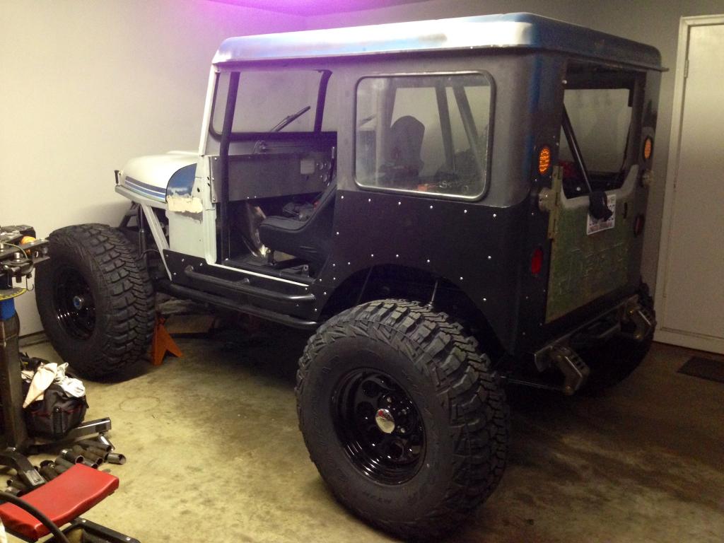

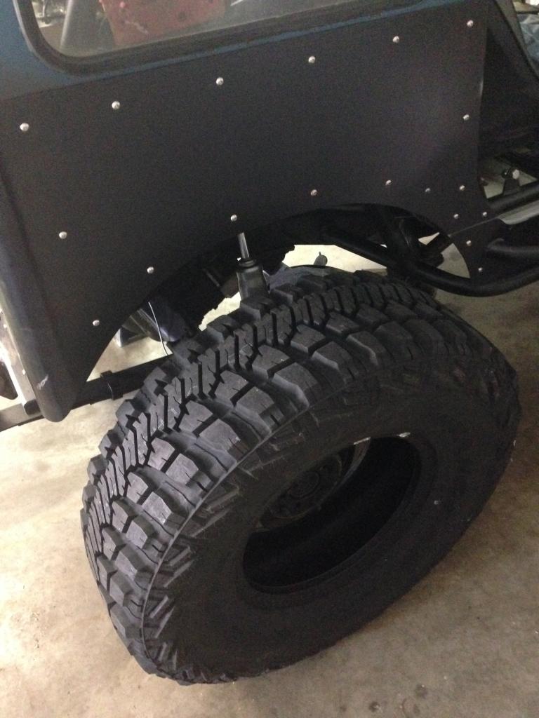

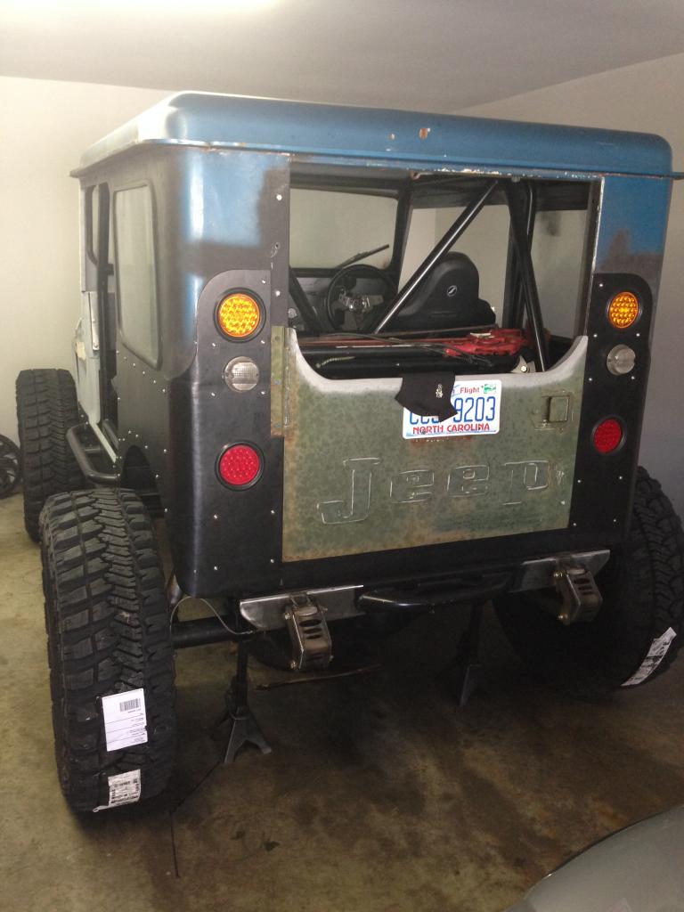

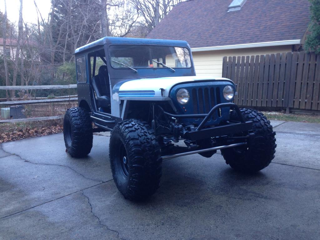

Not a huge update. I did get my tires on, cut the rear fenders a little more to accommodate the bigger tires, threw the new driveshaft in and drove it to the gym. The new tires are amazing on the road! Very impressed with the initial quietness and drivability versus the bias ply iroks I had. I'm not used to the narrower treads because I was unintentionally spinning tires at every red light. I'm basically getting the jeep ready for the Uwharrie Spring Jamboree that I'm heading to on Friday. I'll get some action shots this weekend hopefully.
Poser shot for you guys.
ai1024.photobucket.com_albums_y309_95builtjeep_gone_20postal_photo293_zpsf2ad98e0.jpg

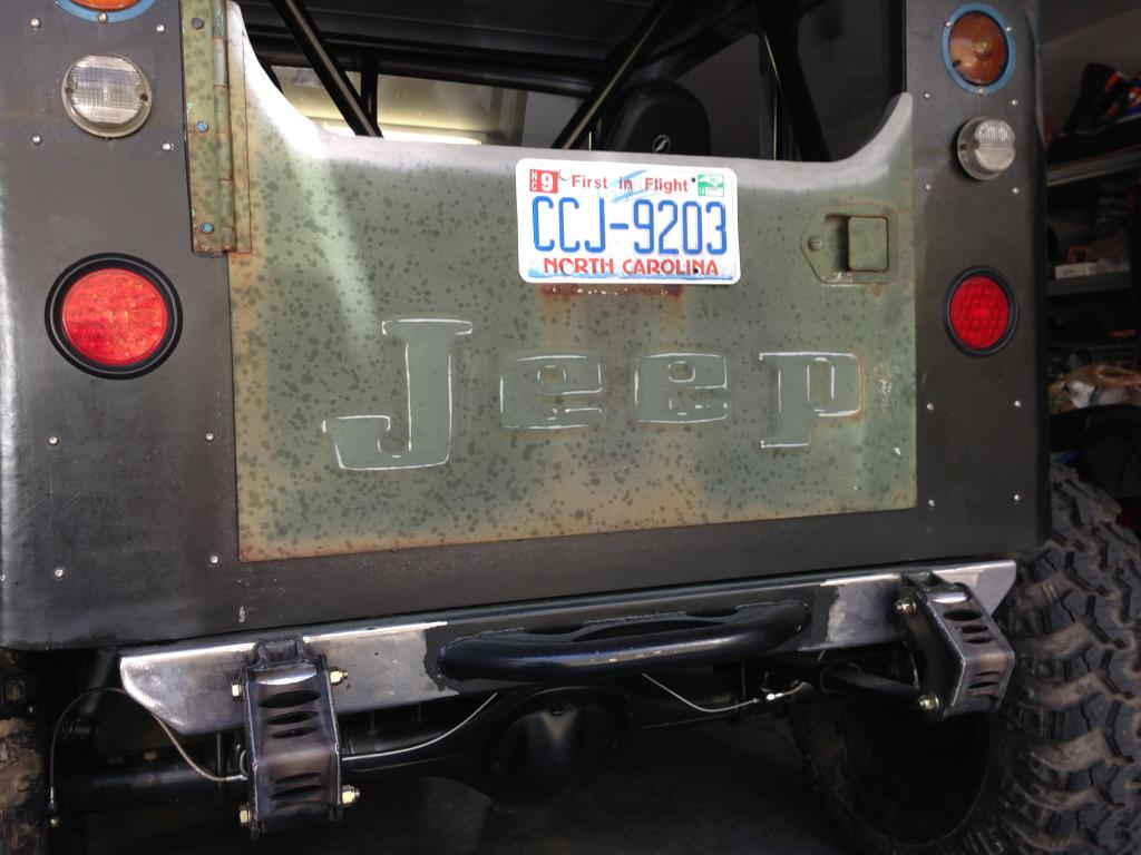

I did go to the Offroad Unlimited show in Kentucky a few months ago with the MarsFab guys. That was a kick ass time!

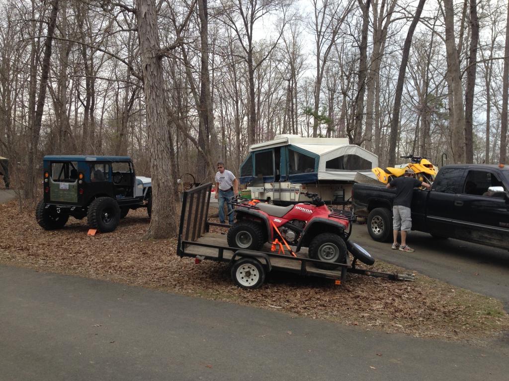

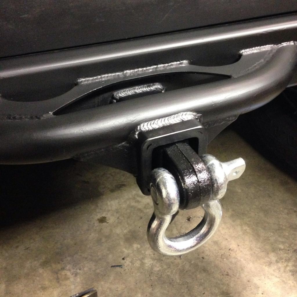

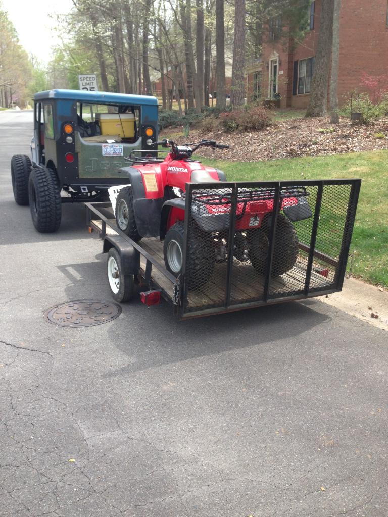

Before the Uwharrie Spring event I did build a tow point off
of the back of the jeep. I hauled a trailer with my 4-wheeler on it all the way too and from URE. I was pretty happy about that.

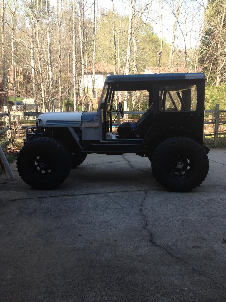

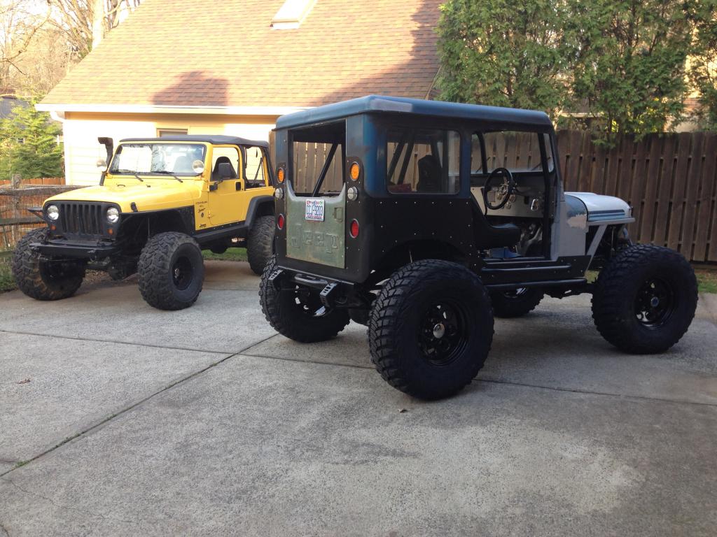

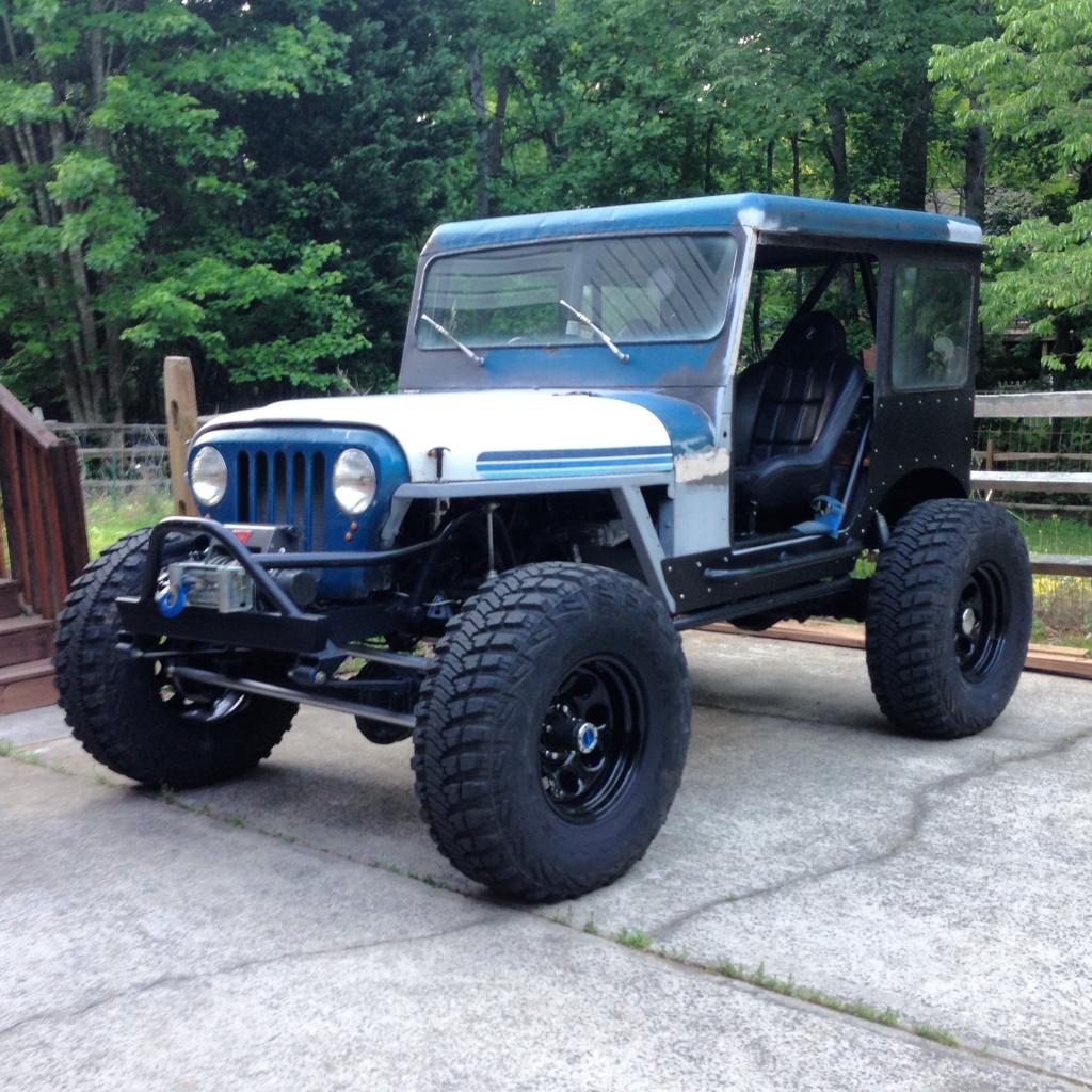

New stance with 37s. Side view. Nice approach and departure angle. Still very happy with the overall setup.
ai1024.photobucket.com_albums_y309_95builtjeep_gone_20postal_IMG_1590_zpsf9f63798.jpg

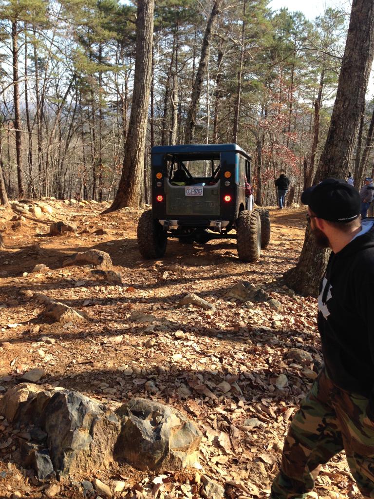

Video from URE. Going up the Dickey Bell hill climb.
ai1024_photobucket_com_albums_y309_95builtjeep_gone_20postal_th_IMG_1620_zps12e268dc_mp4_.jpg
