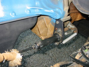

I got the YJ hydraulic clutch cylinder adapted to my bell housing, and the clutch appears to be releasing as it's supposed to. I'll know the final word on this once the beast is up and running.

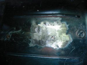

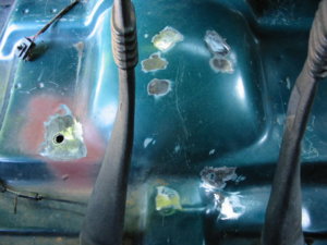

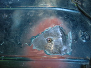

Next, I tackled some cracks in the floor where the seats mount. A couple places had been patched before, but not very well. One place on the passenger side was so badly cobbled up that I cut a section out and replaced it. I also had a number of drilled holes in the floor to weld shut and grind smooth. It all came out pretty nice, and paint will hide it nicely. Oh yeah, I also got my paint ordered.

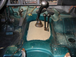

I also had to alter my twin-stick setup to fit a tighter area than what the old one did. This came out nicely. I then made a new floor pan cover for over the transmission.

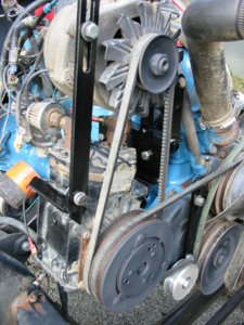

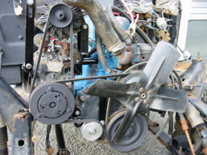

This weekend we were supposed to be in the Charlottesville VA area attending a military vehicle rally, but that didn't go quite as planned. All was well when we left home Thursday morning and we were making good time. However, when we got just past Danville my wife got nailed with some sort of a nasty bug/virus, etc. Needless to say, we turned around and headed back home, and that was the end of our Labor Day outing. So-o-o-o... as a plan-B, I worked some more on Granny 2.

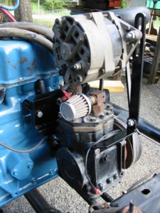

Since my last progress report I have cleaned up a lot of small stuff. I also got creative this weekend and made new brackets for mounting the on-board air (York) and alternator. The next fabrication project on the list will be a new (and better) bracket for the power steering pump. Hopefully, I will have a gas tank soon. My new radiator is supposed to be delivered on Friday. I am starting to see light at the end of the tunnel, but there is still much to do. More to come as I get it done. :)

Don, I am wondering how the belt on the York will hold up. I was always under the impression that that type belt was designed to bend to the inside, not the outside, as it does around that idler pulley?? Also, I think given the distance the alternator is from the York and the long adjustment bar, might need to use the factory hole in the back with a gusset off of it to prevent it from vibrating.
It's the same configuration that it's always been... just made a little bit simpler, and a little bit lighter. It's also the same idler pulley I've had on it for several years... again, just a simpler bracket that makes it easier to adjust. As for back bending the belt, I dunno, but if it's bad for a belt to bend backwards I hope no one tells the folks who make lawn mowers. Think of the recalls! :lol:
