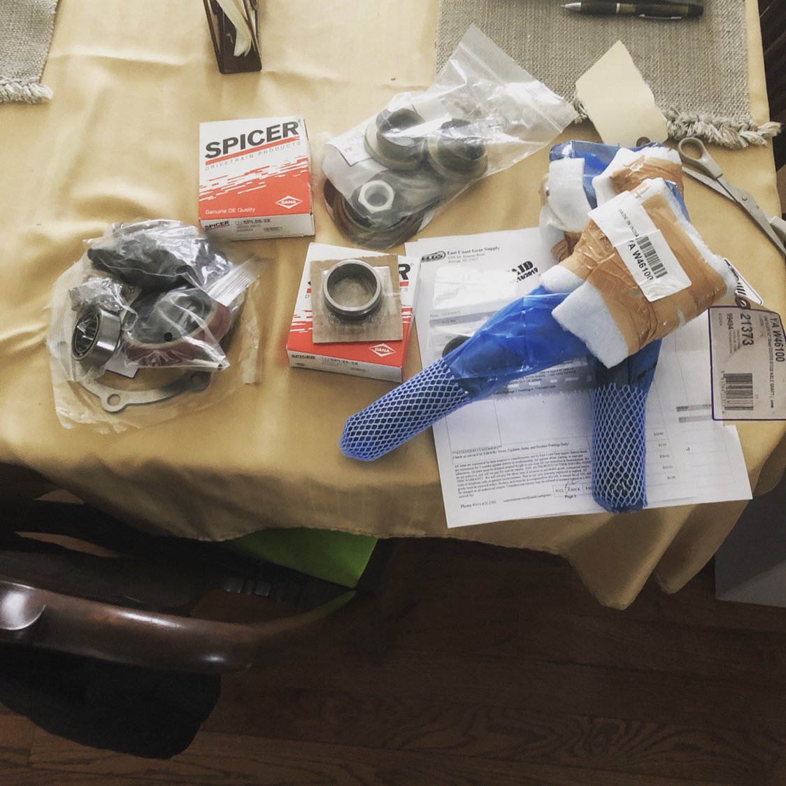

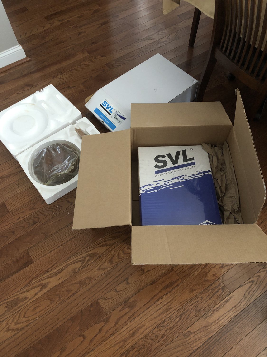

Ordered the 5.38 gears for it this morning, I’ve got $575 of ECGS gift certificates so I can get all my stuff I need to run my 35 spline hardcore hubs I’ve got sitting on the shelf and to install the gears. I’ve still got a shit ton of stuff left to do. But inbetween making some tool money, I hope to get it back on the road and ready for wheeling by March. Hoping the next few jobs I’ll be able to get the hydraulics for my tubing bender and buy another die so I can my rear bumper. I can’t wait to get back on the trails, I really miss it and haven’t really been wheeling in NC much in the last almost 3 years.

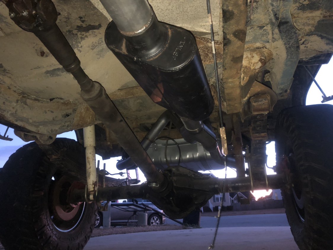

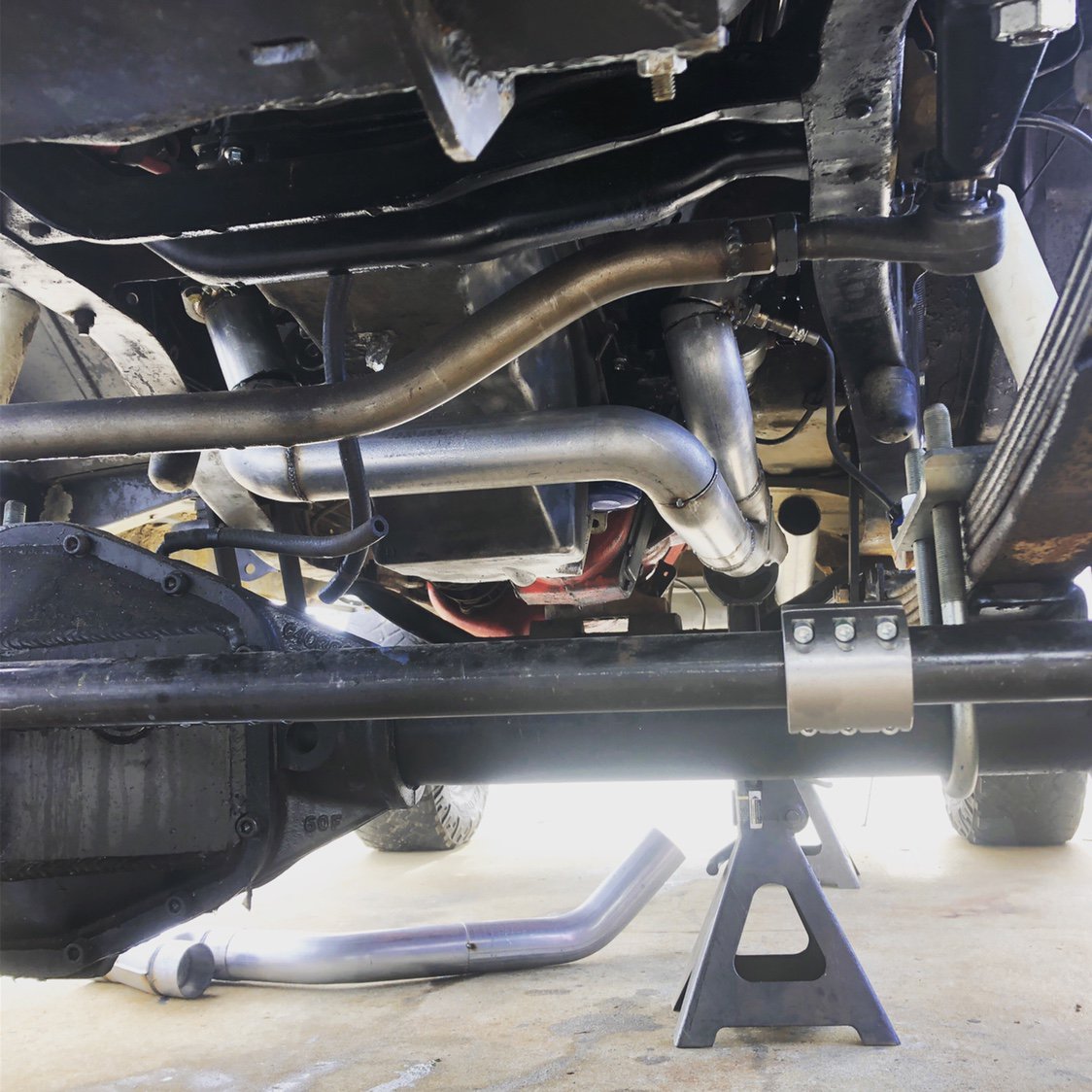

Redid the Y pipe, unfortunately the 2.5” tubing going into the flow master merge collector just can’t be equal length like it’s supposed to be. But it ain’t too bad. I need to adjust my tail pipes so they are even. I went with 3” mandrel bent tubing dumped just behind the axle. I haven’t even started it up yet. Still need to tighten the collector bolts and add another hanger or two. Hope it’s not stupid loud I’m getting older
I finally bought gears for it, and cashed in all my gift certificates from over the years. Gears I got off rock auto, and everything else from ECGS. There was 18 of them and dudes computer crashed and he had to call me back and get me to read them off to him. I felt bad for the dude.

The y pipe isn't equal length when it's stock anyway.
If you wind up not liking the flow master, the DynoMax ultra flo welded series sound and flow quite well.
The muffler is some summit brand 2 chambered that flow master merge collector is the most expensive part of my exhaust, lol.
I thought you used a Flowmaster muffler too...my bad. Sounds like that's basically what it is though. The DynoMax I used wasn't cheap, but that's probably because it's dual 3" in and out.
Yeah I used a single in and out then Y after it for the duals. I already feel red neck as hell with the duals on it, lol.
Just don’t lift the rear and you’ll fit right in with the rest of the Greenville crowd :lol:

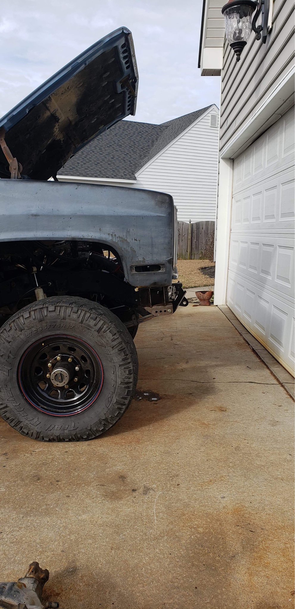

I’m pretty stoked with the approach angle, it’ll get better once I put the 38.5s on it. And I keep eyeballing some 40 nittos or 42 SX2s. Really debating putting radials on it since I want to drive it to a from the trail for a little bit till I decide what I want to do for a tow rig.

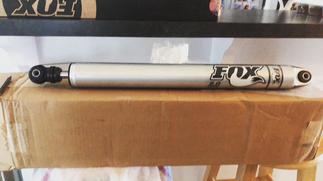

Picked up some 14 inch stroke fox 2.0s to use. And ordered a 1.5 die fo do the shock hoops and engine cage up front and the bedcage/hoops for the rear. I’m pretty stoked about it.

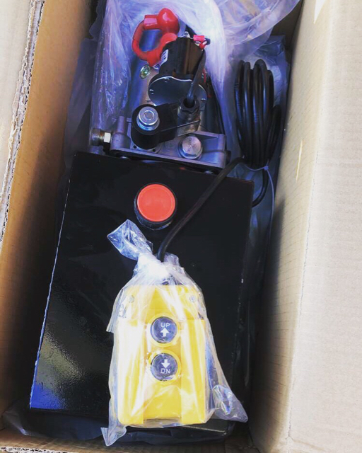

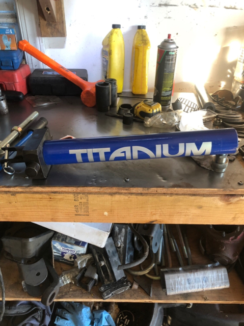

I bit the bullet was ordered everything to build an electric over hydro setup for my bender. It was $500 for the ram, the pump is for a dump trailer and 12v. I can use a car battery no biggie. Gotta pick up the hose but they are SAE fittings so no biggie on that either. This is how I justied not putting lag studs in my garage floor and I have some caster wheels rated for way to heavy duty than a bender cart will be. I’m excited I haven’t done much tube work but I picked up a cheaper notcher last year that I’ve started to get the hang of pretty good. Got the materials to bend up the front hoops and I’ll probably have to pick up some for the rear. Big thing is I’m having fun dicking around in the garage. Ordered my 5th wheel so I can have a full size spare for the k5 and will likely get the tires swapped over to those wheels once I put the shock hoops on it.

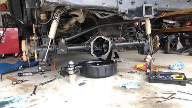

Didn’t get much done but prepped a frame for me to plate because the steering box ripped off on a k10 and helping another friend rebuild his rear diff after he tried to find the bottom of a mud hole. Dirt and water reeked havoc on his pinion/carrier bearings
I think water came in through the ARB locker bulkhead. Axle seals looked like they did their job, pinion seal was good and stuck. Overall homie got a crash course in diff work and learned muddy water sucks.
Had some stuff show up. I’ll likely start making my cart for the bender tomorrow, all I really need now is to build the cart and get a hose for it. The ram is the same you’d buy from JD2. Fits the JD2 hydro mounts perfectly and is much much cheaper($210 shipped). The hydraulics portion is a 12v setup for a dump trailer single action ram and has an 8 quart reservoir. I know I should have calculated it, but they are cheap enough I can get another resi for dirt cheap. The whole electric/hydraulic setup was only $210 on Amazon. The ram I’m using has a built in return spring and a 14” stroke, literally the same part number as the $400+ one JD2 sells. So $550 or so in a electric over hydro setup using brand new parts and JD2 cylinder Mount.
