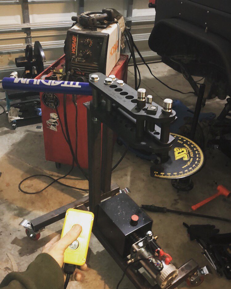

Are you going to put a monster inverter on that thing, or a few deep cycle batteries and a good charger? Im not sure what that pump draws, but most of them can pull pretty high amps under load.
I’m gonna try it with a car battery and see how it responds. It’s actually for a dump trailer. I’m sure under load it does draw a good amount of amps. But it’s my weekend project to see how well I can get it to work. I’ve got to bend up some 1.5x.120 wall DOM for my front shock hoops. Hopefully I don’t just kill batteries with it. Guess worse case have the Jeep or k5 hooked up to it and running while I bend.
My dumbass ordered the wrong fitting.... so I’m just gonna make Transformer noises and pretending I’m bending up a tube chassis. But really I need to get some tin and dimple die up a battery tray, make my notcher mount/die holder, and maybe add some fancy gussets.
Depending what kind of fitting you need, slowes, homeless deathspot, or cracker surprise or your friendly local hydraulics joint may have what you need. Unless it's metric, then you're out of luck... Do they make metric pipe thread? They make metric everything else...
It’s a union for jic fittings, all the local hydro shops are closed over the weekend. No biggie, ordered it last night, should be here by Tuesday along other a longer hose for only $20 including shipping. As much as I want to bend up some DOM for my shock hoops they can wait a few days while I finish some other work.
Surely Orileys or Agri Supply has that fitting?
What size? I have a few at the house
I completely forgot about Agri supply. I’ll head out there around lunch and see if I can find one. It’s a Jic male 9/16 to jic male 9/16, the ram side is some quick connect coupling that I ordered correct.
I've got a local CarQuest that has hydraulic stuff and makes hoses.
You know my buddy at oriellys had a dumbfounded look when I asked him. Is it common for auto parts stores to have that kind of stuff? I don’t mess with hydraulics often
CarQuest/Napa is the only ones I've seen with it. They cater a little more to the commercial/big rig/agricultural crowd too, so that's probably why they have it.
I'm glad they do, I just had four hoses made for my excavator last week.
Orileys advertises that they stock tractor parts. I’d assume that also means some hydraulic fittings. I just bought 10 gallons of tractor hydraulic fluid from them.

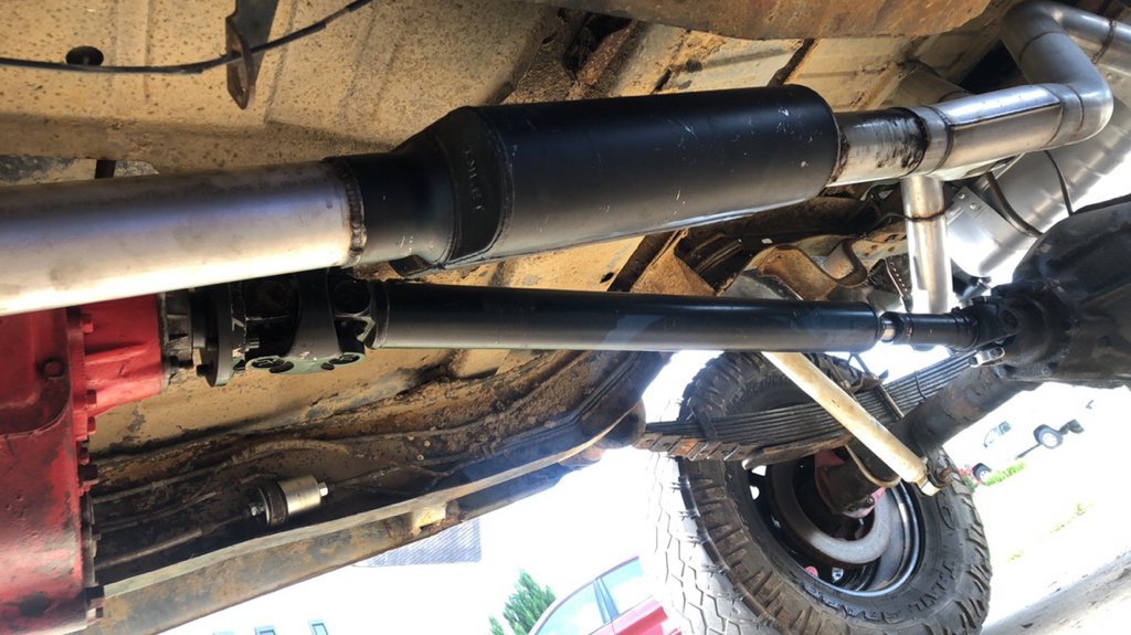

Swapped in my stupid duty front 1350 drive shaft and WFOs flange for the rear output of the 205. Put 17 miles on it after getting a plate and now I need to put the 38.5s on it. Still gotta a shit ton of stuff to do but I’ll start knocking out things off the list as I can. Hoping I can do a shake down run at uwharrie next month. Gonna do some small road trips to Farmville then little Washington to build my confidence up in it. I think it’s stupid to just take off 2-3 hours without attempting to work out any bugs.
80 fun tickets later it was full, gas gauge still screwed which brings the gay. I can’t decide if I want to retrofit a factory style tach into the cluster or just put a printed circuit board in it and just find the rev limiter when I need it, lol.
A 99-04 7.3 manual trans front shaft fits the rear perfectly for now. I really think I’ll just keep the 4.10s and keep saving up for a 241 based doubler. 2nd gear is fun as shit on this ugly POS. It’s really quiet at idle but really aggressive when you get into it.
