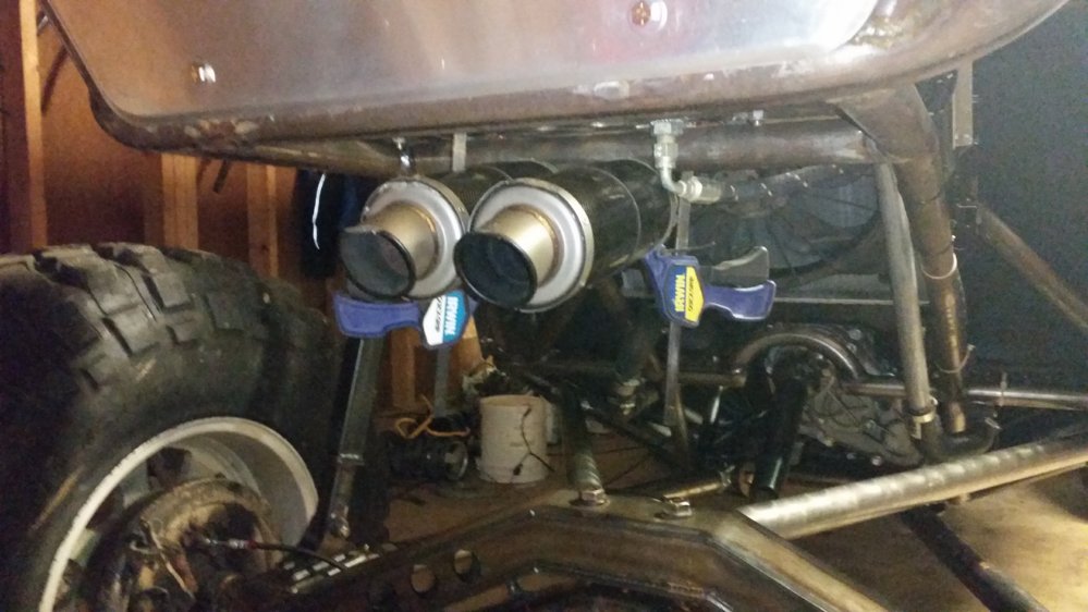

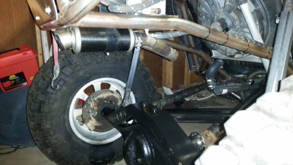

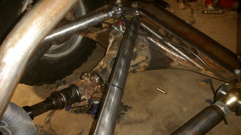

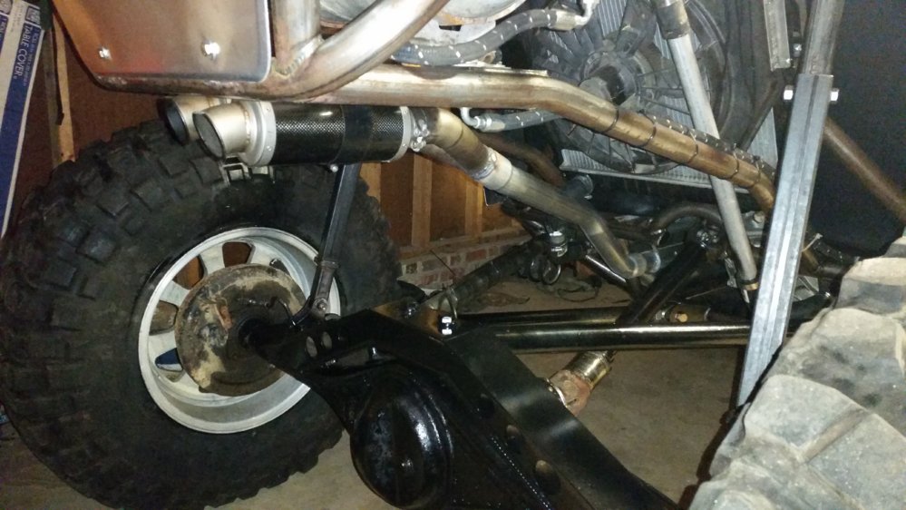

Almost forgot I have to finish the exaust also had these laying around there carbon fiber so should stay pretty cool I'm going to move my propane bulk head over just to make me feel better

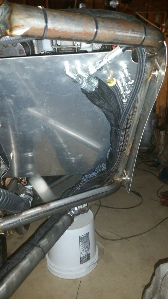

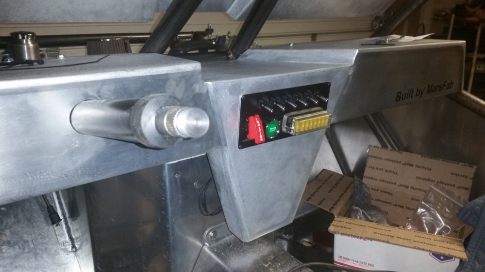

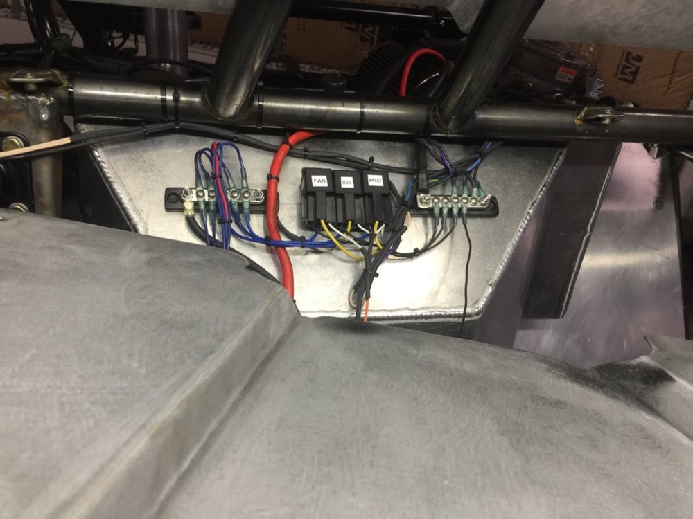

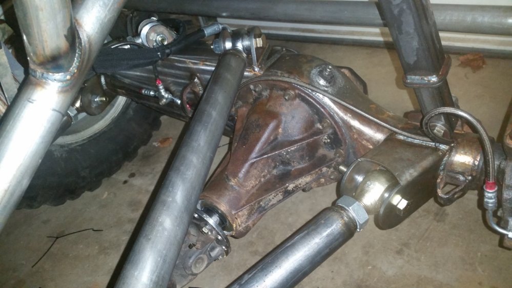

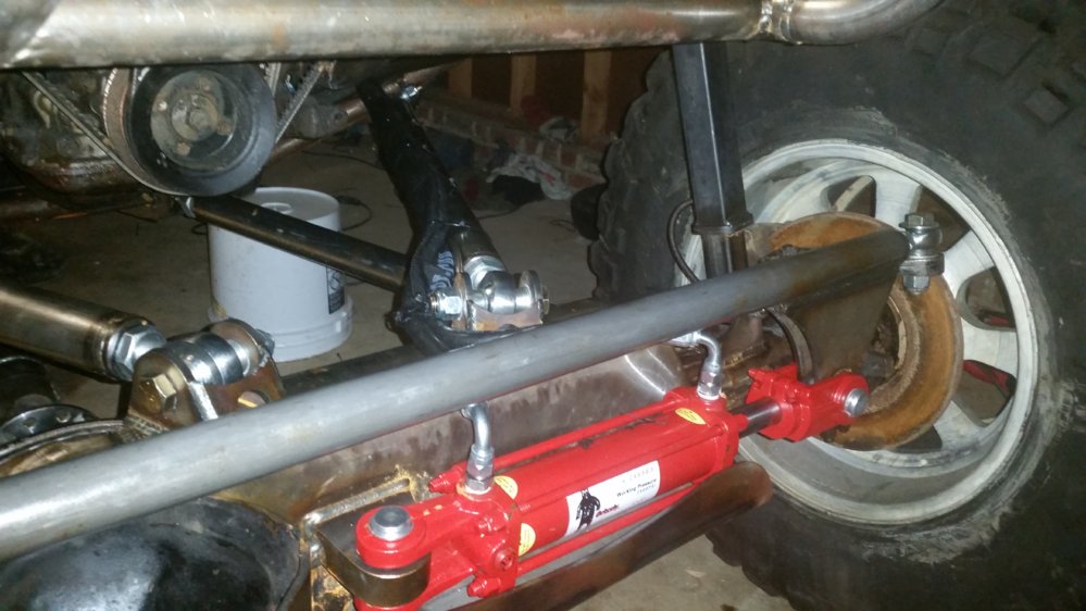

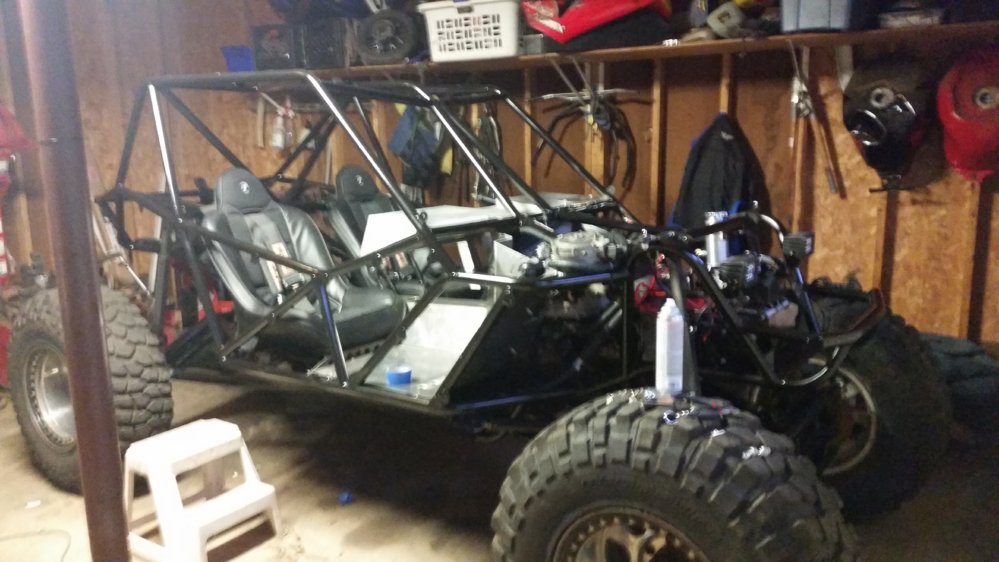

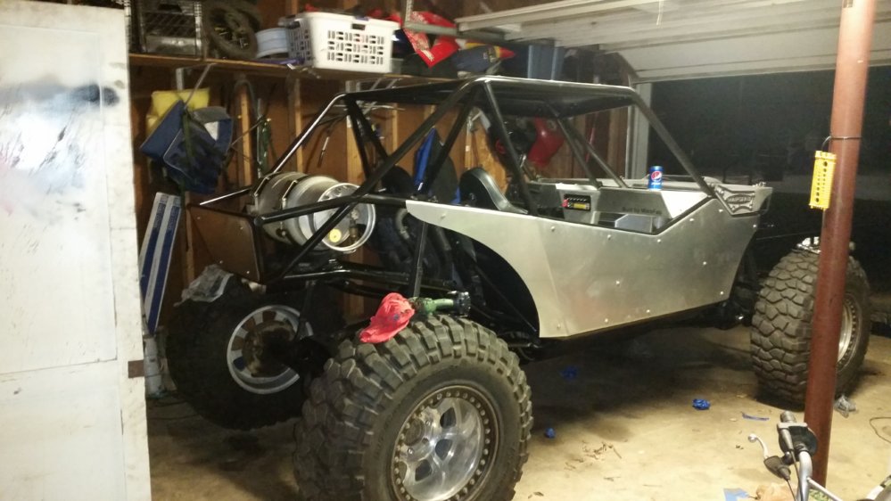

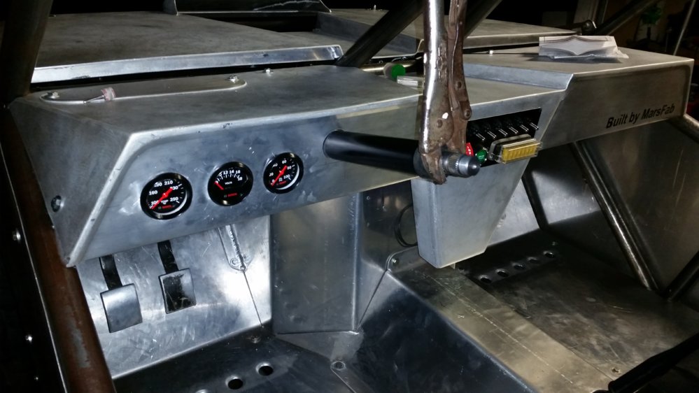

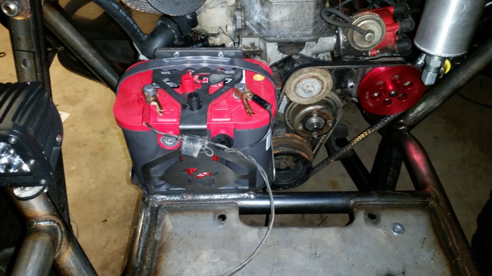

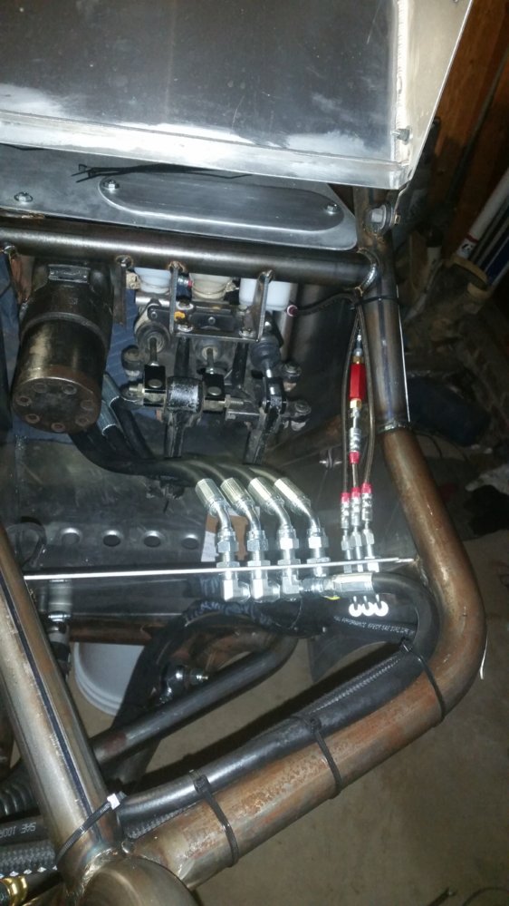

Got a good bit done tonight finished up all the plumbing and got my panel installed going to to add fluids to everything tomarrow and see what leaks

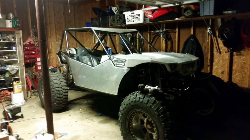

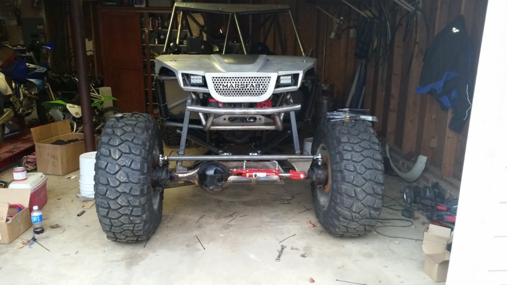

Got the exaust finished up today and got my new xrc8 winch on Wich made getting the buggy loaded alot easier 9n the to do list is 1. Wiring Wich should get done this weekend gas pedal and stering wheele and shock springs I'm going friday to use my buddy's race car scales but I'm going to have to save up to get some springs Holidays have hit the wallet pretty hard

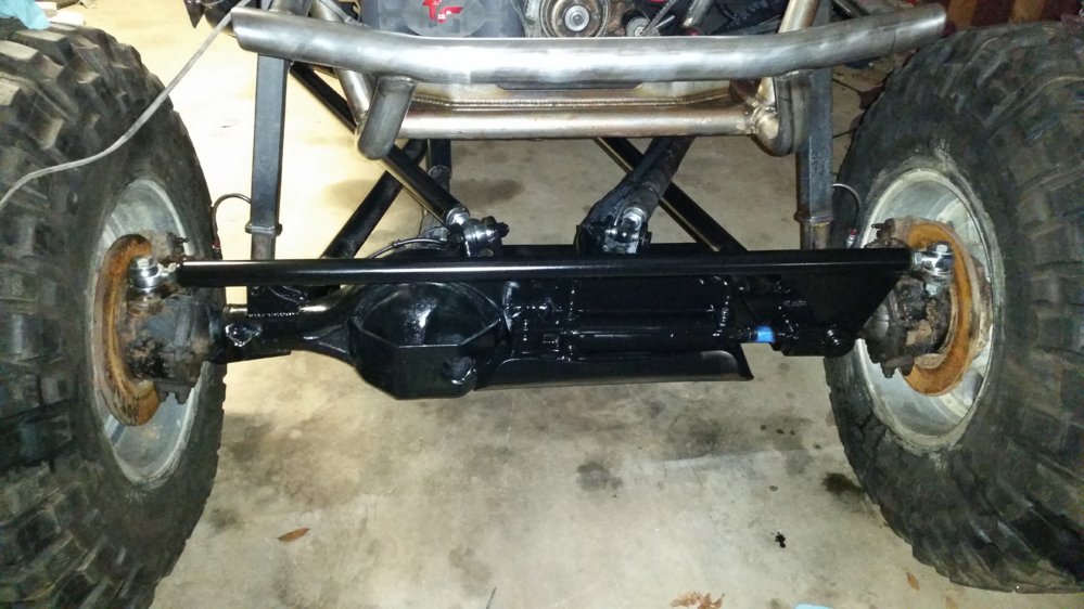

Had to do a little chassis painting today surface rust was killing me

Got it wired up and and even drove it onto the trailer today big thanks to snappy for the help still lots of bugs to work out But it's getting there
Bring it on out to DPG next weekend. Loving this thing.

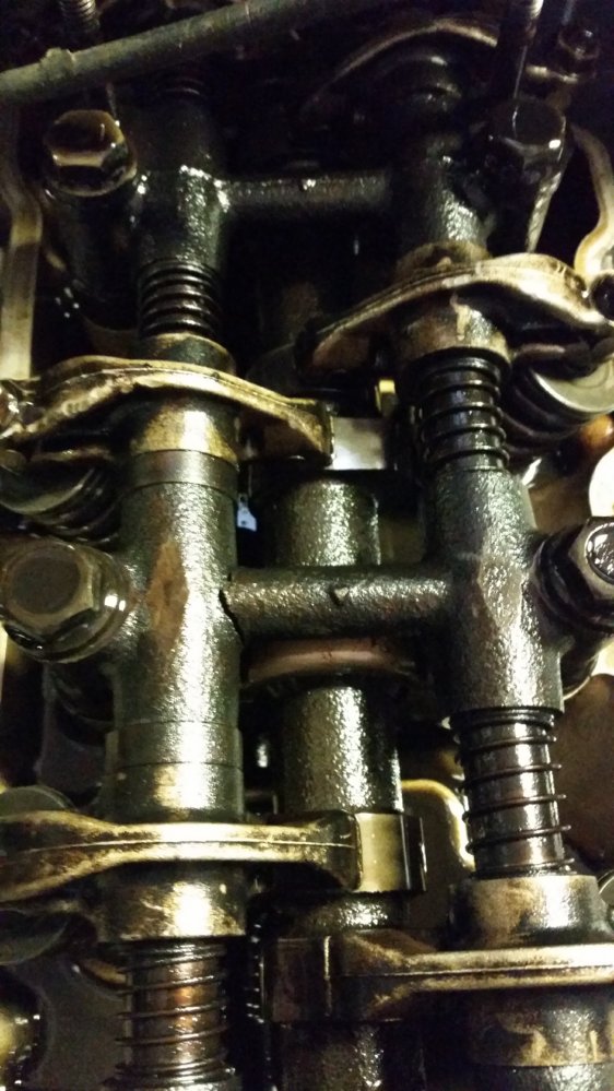

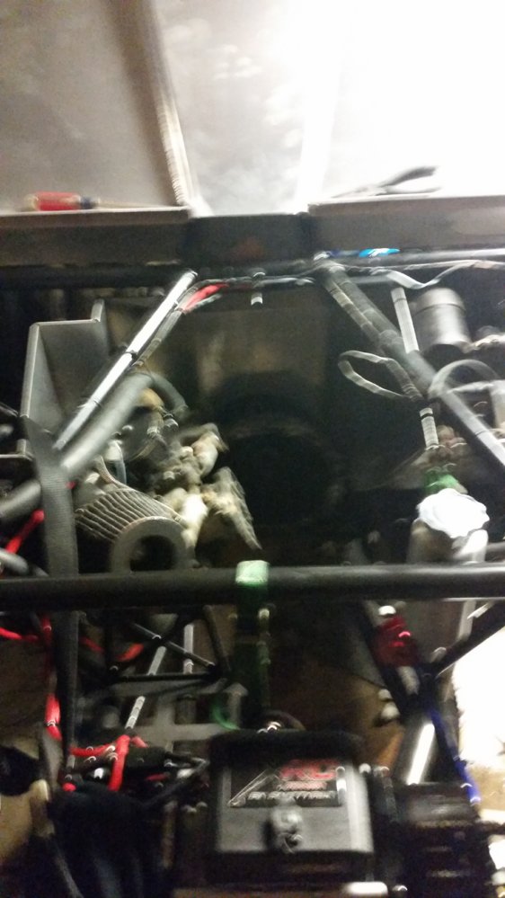

Jonathen cam over and helped me button up some loose ends buggy was pretty much ready to ride other then shock springs noticed I had some exaust pressure in my cooling system pulled the valve cover and found a broken rocker arm holder I don't think the two issues are related not really a huge deal but dose suck

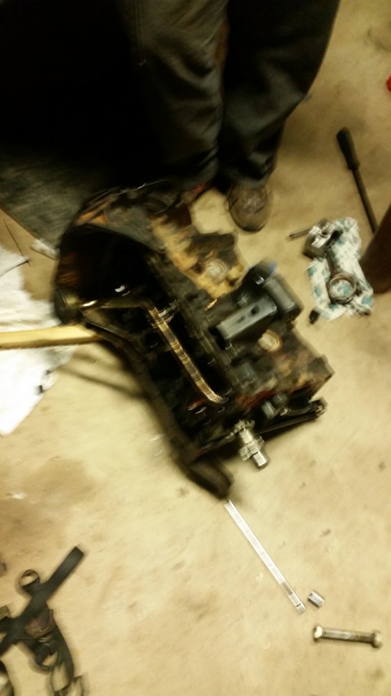

Well this kind of snowballed pulled the head and found a gasket failure found a Crack in the front cover Which where no big deal pulled the rod and main baring caps and they where tost so ended up pulling the motor last night I didn't have a hoist luckily jonathen and dustin where here to help thanks guys
