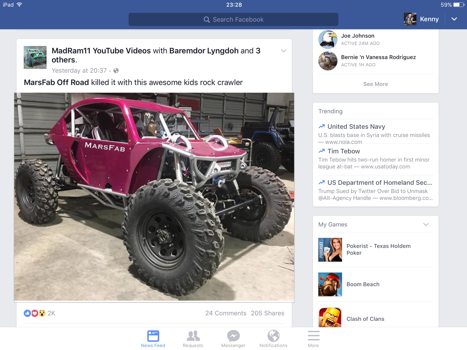

Maybe one day you'll all be able to look at other buggies and say "Man... that looks like a MarsFab buggy".
So does that mean a scaled up version of this design is going to be the "MarsFab standard chassis"? same belly and approx chassis height, taller tires and longer wb, and it sounds perfect to me.
Very badass. That picture makes me want to climb in it and trash.

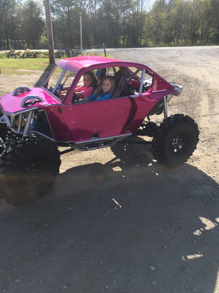

Power is no issue at all. The t-case has 6.5:1 low and the engine also has a hi-lo range. With the case and trans in low it doesn't even move lol. You'd literally over rev the engine and grenade it if you drove it like that. We've had the best luck leaving the t-case in high range and using only the trans selector to go between R-N-L-H. it's simpler for the girls and works pretty well.
In hi-hi when you floor it, it gets up and goes quite well but it's no tire burner or drift car. I estimate the top speed to be somewhere around 35-40 mph. It's probably 3 times the weight of the ATV the engine is intended to propel. Also there is no rear wheel drive, the transfer case is mounted backwards in order to line up with all the inputs and outputs so 2wd in the case is actually front wheel drive. Makes front digs easy but not really practical.
I'm very happy with the look and style of this chassis, it's a design I've wanted to build for a while now. Fortunately rob was cool with giving me the freedom to do most of the designing. My plan has always been to build it as a full scale chassis but this happened first and it was a great way to try it out. I think it's been well received and hopefully someone will come along now wanting a full sized version.

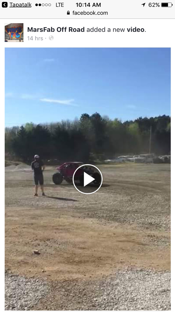

I have a couple cool videos but I'm not smart enough and am too lazy to convert from an iPhone format to post. If you follow me on IG or FB, you can see the videos of the girls driving it. :)

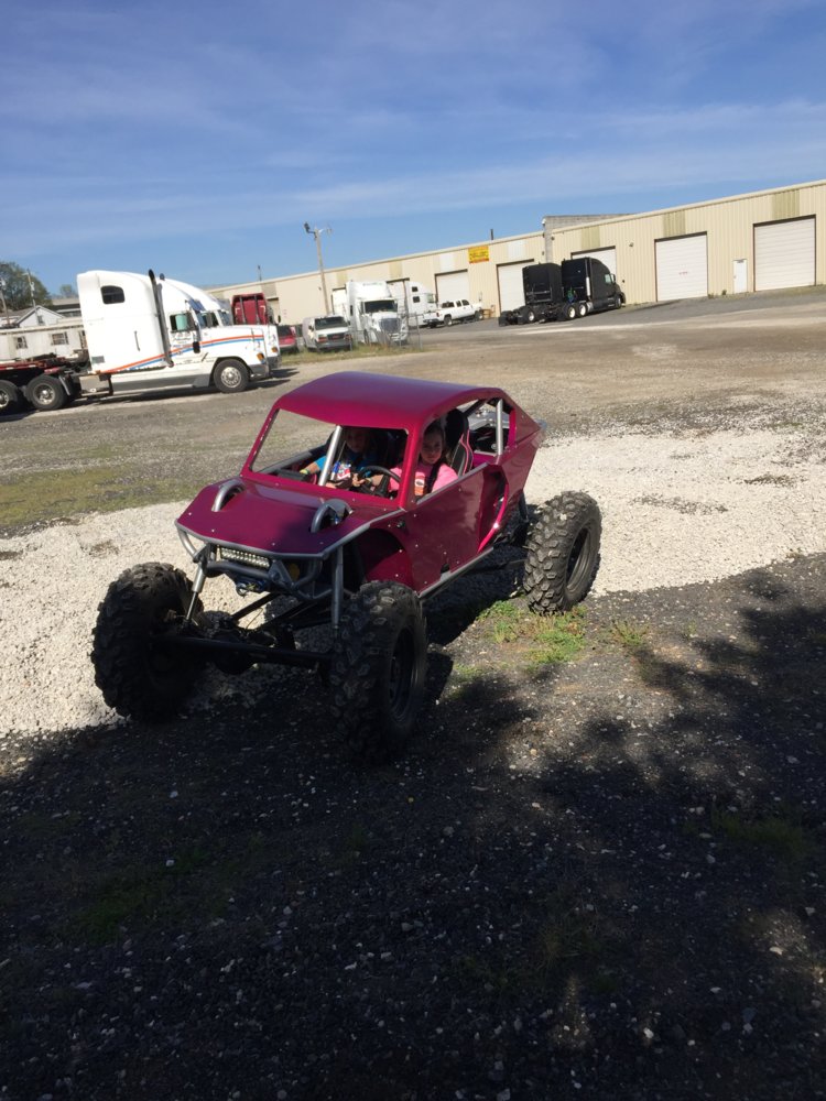

We've been working out all the little bugs over the last two days and have pretty much everything handled now except the steering. The brake master cylinder may is a little small for the 4 calipers were using. It is very easy to push but takes full throw to lock up the tires. Probably going to switch to a 7/8" master but with the adjustable prop valve we're able to bias more to the front and it helped a ton.
The steering works well. Better than I expected. It has decent power to turn the tires, the problem is that it takes a little too much effort to turn for young girls to drive it comfortably and the single ended ram makes it even stiffer to retract the cylinder than extend.

So I am guessing the issues were figured out, or not issues after all?
Most all issues figured out. Steering is the only last notable issue. It works ok but my girls still aren't quite strong enough to steer it easily.
