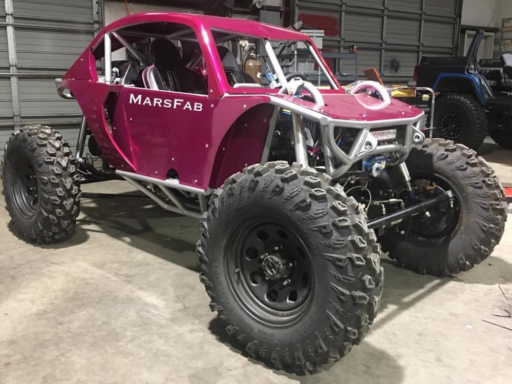

Lil' Smoke kid mini buggy rock crawler
Time for a decent picture!

Belly height is about 15". Wheel base is 80". Roof height is a little over 48" I believe but I'll have to check tomorrow.
It actually handles pretty amazing. @zubs drove it around a good bit yesterday. The shocks have less than 50psi in them and it is extremely soft. Even being that soft it rides level with Andy on the drivers side, corners almost flat at speed and has almost no dive under hard braking. In one of the posted videos he drove it up on a rock and kept all 4 tires planted with the passenger front around 40" up and had much more shock to go. That's great for an 80" wheel base. We've been working out all the little bugs over the last two days and have pretty much everything handled now except the steering. The brake master cylinder may is a little small for the 4 calipers were using. It is very easy to push but takes full throw to lock up the tires. Probably going to switch to a 7/8" master but with the adjustable prop valve we're able to bias more to the front and it helped a ton.
The steering works well. Better than I expected. It has decent power to turn the tires, the problem is that it takes a little too much effort to turn for young girls to drive it comfortably and the single ended ram makes it even stiffer to retract the cylinder than extend.
