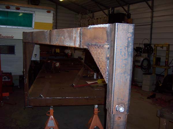

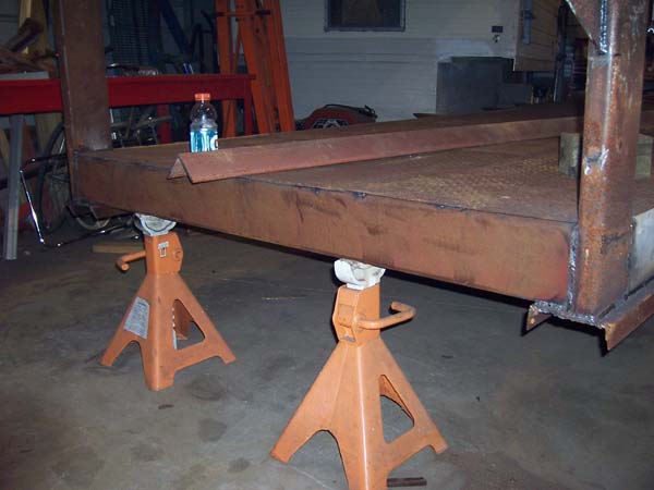

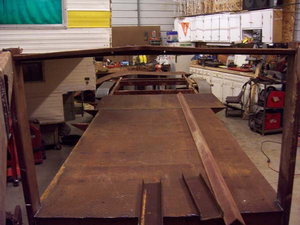

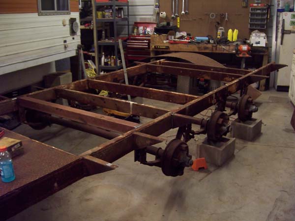

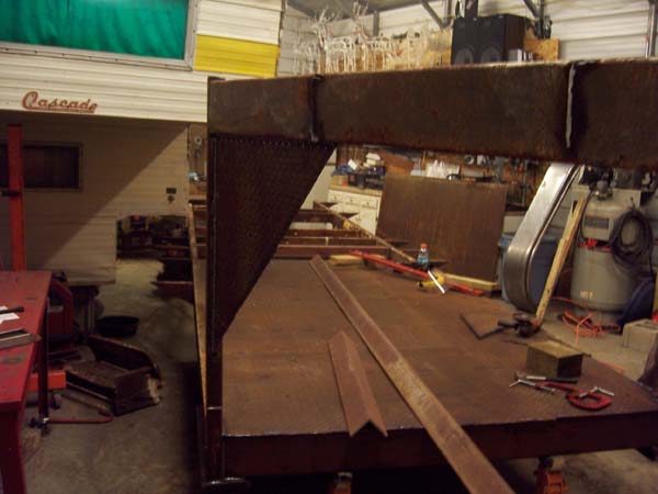

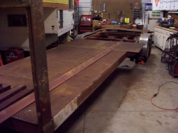

I added a bunch of cross braces to frame, used wire wheel to clean the heavy rust of trailer ( just nasty ).
then I got the deck area that will go under camper all fitted and welded on.

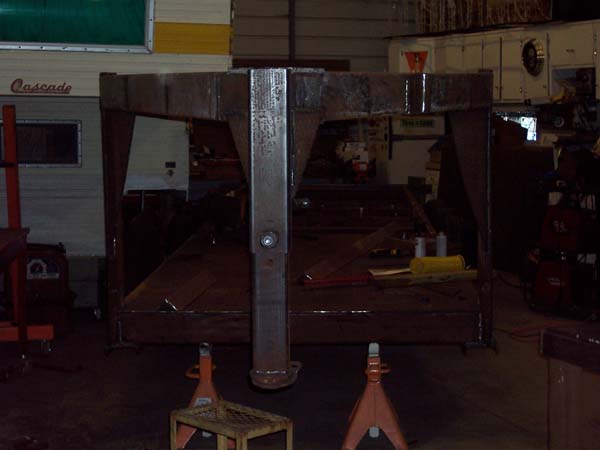

I also cleaned up gooseneck, so now I can get the neck braces all welded on. then I will cut off the old bent c channel on top of neck and replace with 1/4" wall steel.
I also put fenders in place just to see how they look

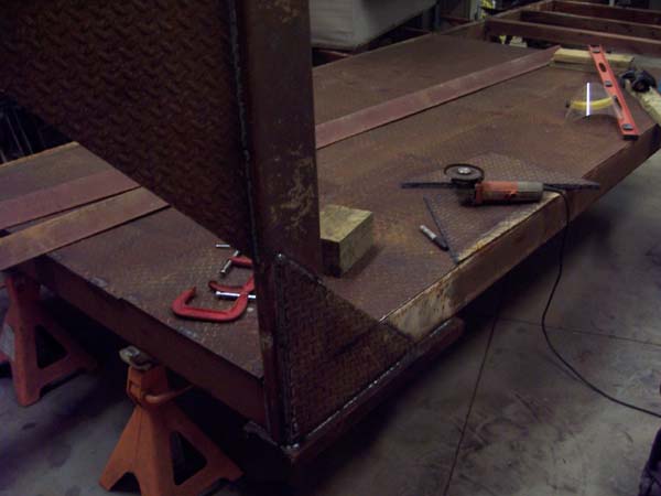

well got a little more done tonight..
fyi.. I hate cut off wheels. I am now buying a plasma for myself for x-mas :)

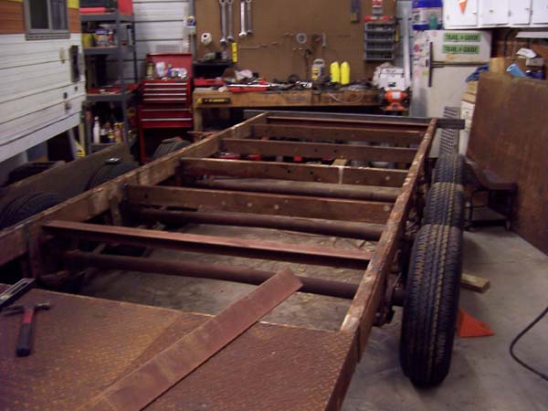

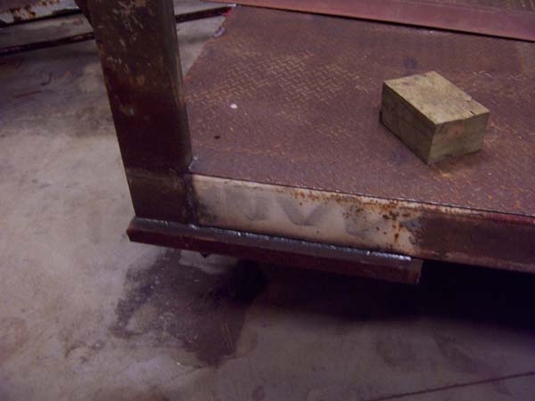

I got bottom support welded on under front area of trailer
it took me 30 mins to cut this angle piece with a cut off..
but atleast I got one side cut and welded in.. will cut the other pieces tomorrow at friends with plasma :)

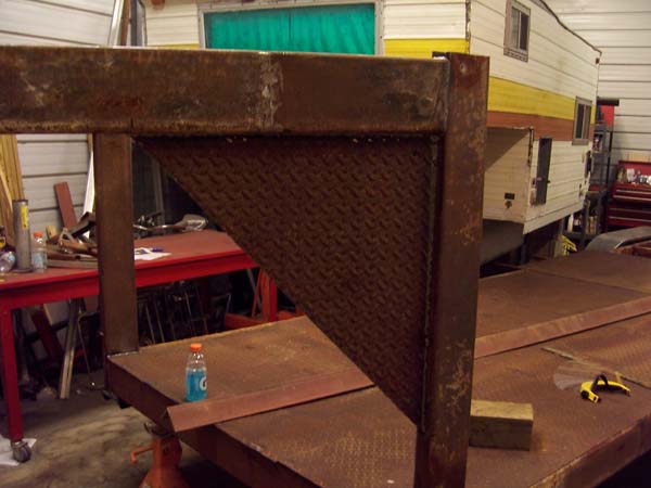

well only had about 1 hr tonight in shop..
got other side neck brace in and one bottom brace in also.

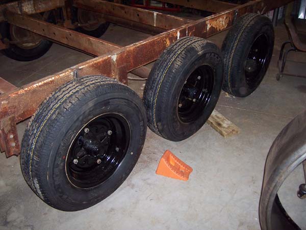

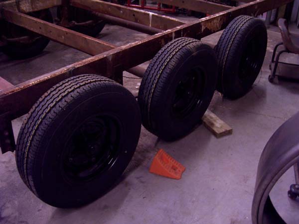

then I took off rims and tires and loaded them into truck..
I order 6 new Maxxis trailer tires.. hope to have the rims and tires back sat if the tires come in.

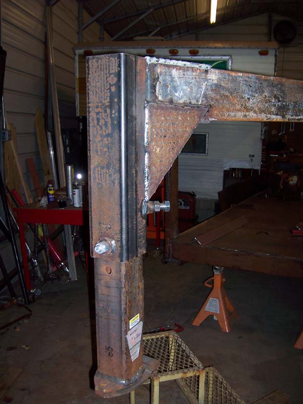

Well today I got all neck bracing DONE :)
and then wire wheeled the old rims and got them mounted on trailer also.

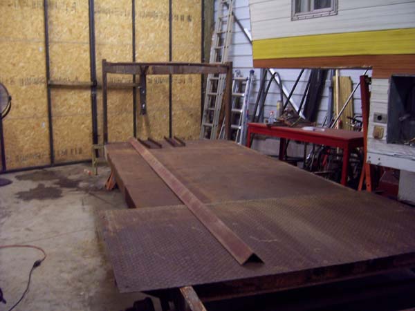

I then cut out all rear braces and re welded them back in space correctly and lower so I can install a wood deck on rear area.

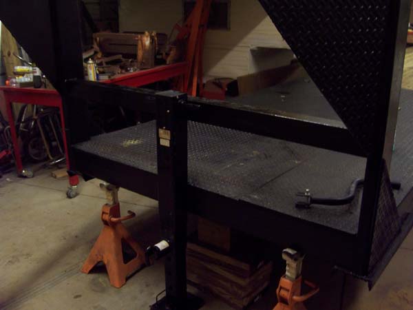

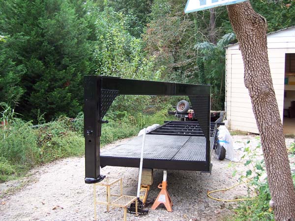

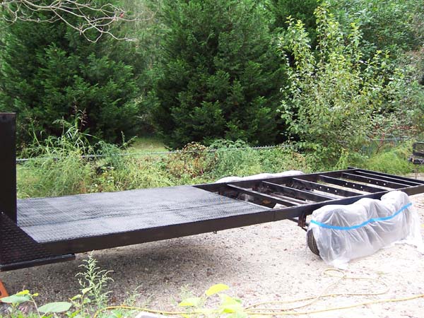

well got some more done..

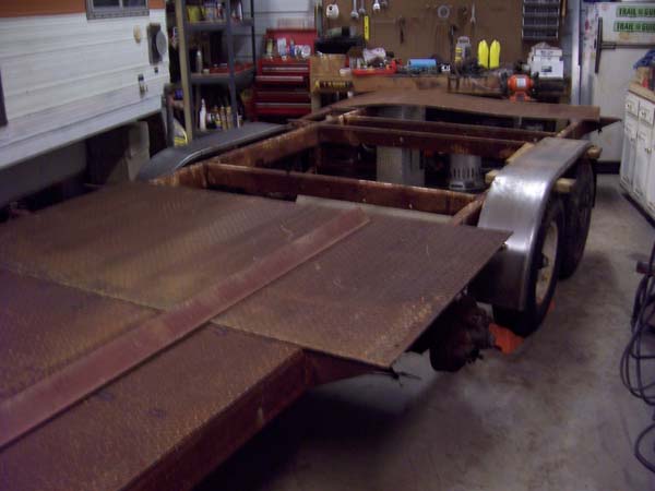

I got everything finish welded and all deck bracing in.
Then I pulled it outside and painted all day..used rustoleum black oil based used my paint gun to spray it on...

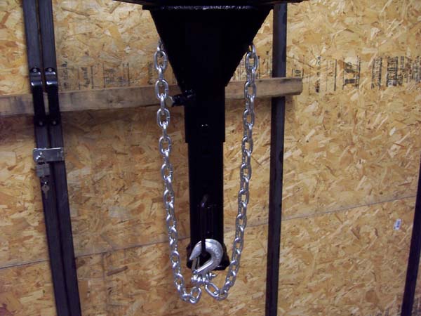

well got 12,000lb front jack this AM
can not work on trailer tonight.. but plan to start wiring and attach jack wed night

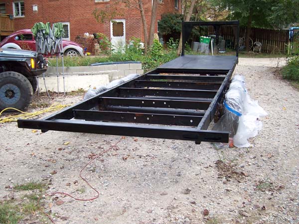

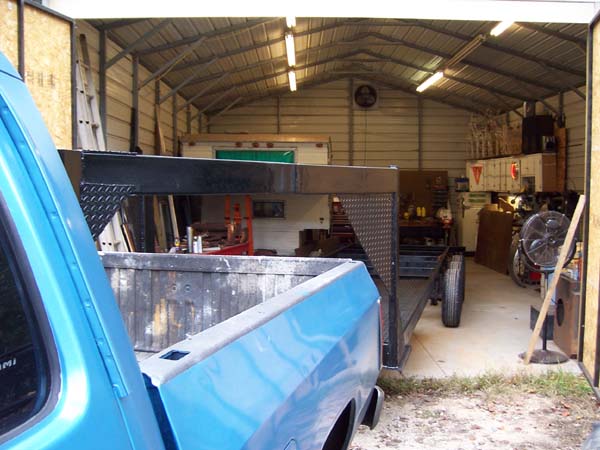

more getting done
I got brace in place and welded in for jack and extra support for main uprights
I got jack in place.. just need to add extension bar for handle
I also got safety chains done

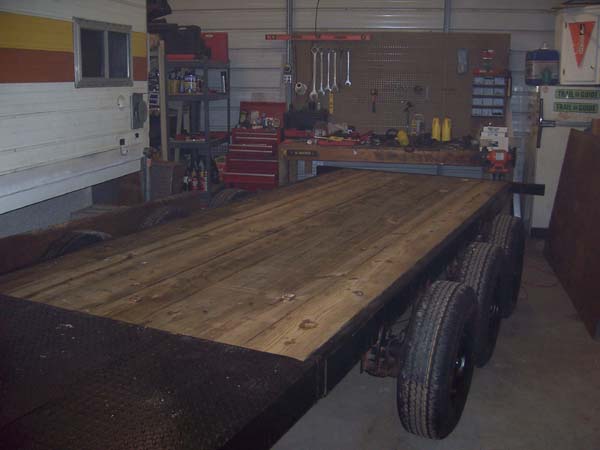

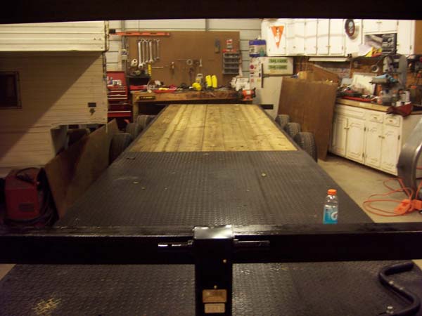

I got wood deck in place
tomorrow the plan is to get all the lights in and wiring done..
still trying to get it inspected friday :)

Just wondering your reasoning for the half and half on the deck? Does it serve a specific purpose?
yes.. camper is going to sit on metal deck,( i also got that metal very very cheap), then when you walk out of camper you have a nice front porch with the wood deck. so you will be able to walk bare foot if you wish onto wood and not burn your feet on the wood.
