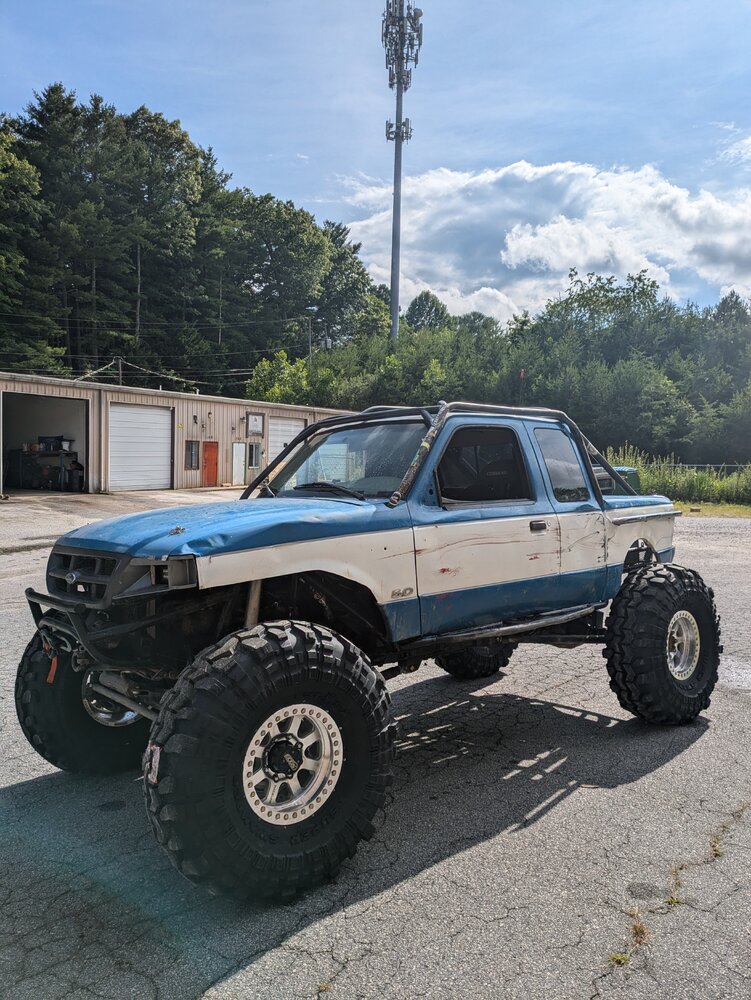

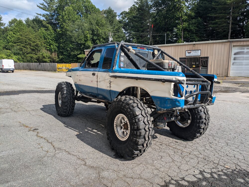

Busy day getting my truck ready for my birthday ride at The Ranch next week.
Couldn't get the rear brakes to bleed after replacing calipers. As luck would have it, found a hard line on the firewall that had been smacked with a (supposed) rock. Ran a new line from master to cutting brake and we're all good.
My recent muffler install turned out way too loud. So I poured myself some Metamucil and replaced it with a Dynomax Super Turbo and new piping. You can actually stand to be in the cab now.
Cleaned up some wiring I had apart when chasing a recent fuel issue.

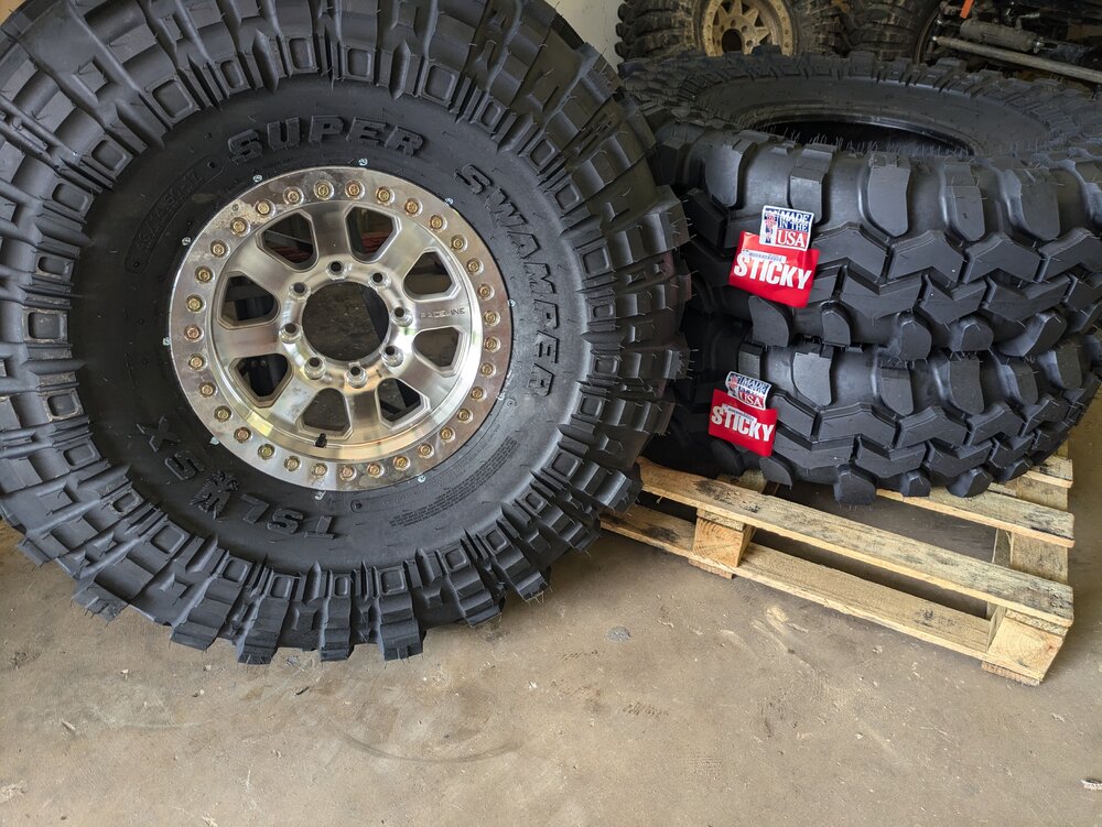

Wrapped up the day with new wheel and tire installation. Huge thanks to @thebrotherinlaw for mounting all 4 of my sticky SX on Raceline while I did the mechanicals. He saved my butt getting ready for the trip.
For this, you can keep my sister another 30 years
Ready to wheel and scuff the bad boys in!
View attachment 420268View attachment 420269View attachment 420270

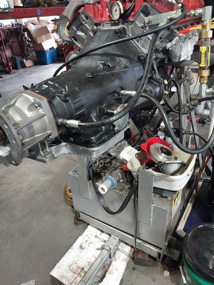

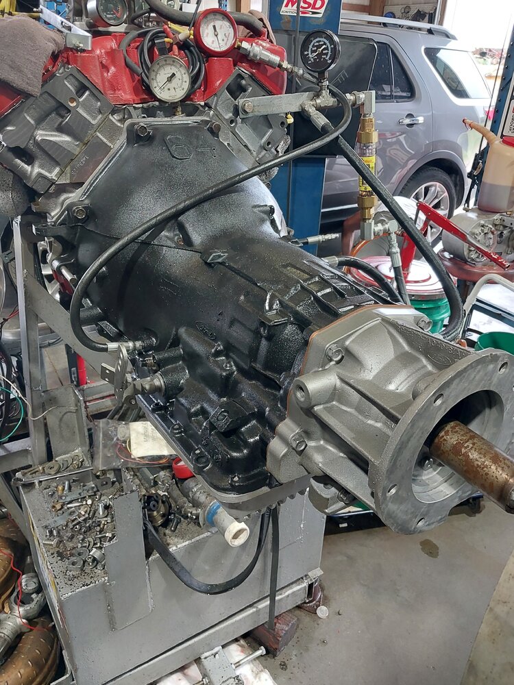

Is that a transmission dyno?Fritts Transmission wrapped up my new C6 build. This one was @drkelly spare back in the day. Pretty excited to get it in and see how much better the trans shifts.
Still gotta tear into the engine and see what happened. My gut says a couple injectors got clogged when I got bad gas. I'll take them out tomorrow and ship them to Race City Injector for cleaning and flow testing.
We're super busy with house stuff and work stuff for a couple months anyway, so taking a break until it cools off is fine with me.
Cliffs: got a bad ass transmission for an engine that doesn't run.
View attachment 423281View attachment 423282
Yes sir. Fritts Transmission in KY runs them on a dyno after building to verify repair.Is that a transmission dyno?
