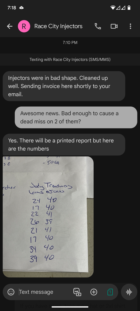

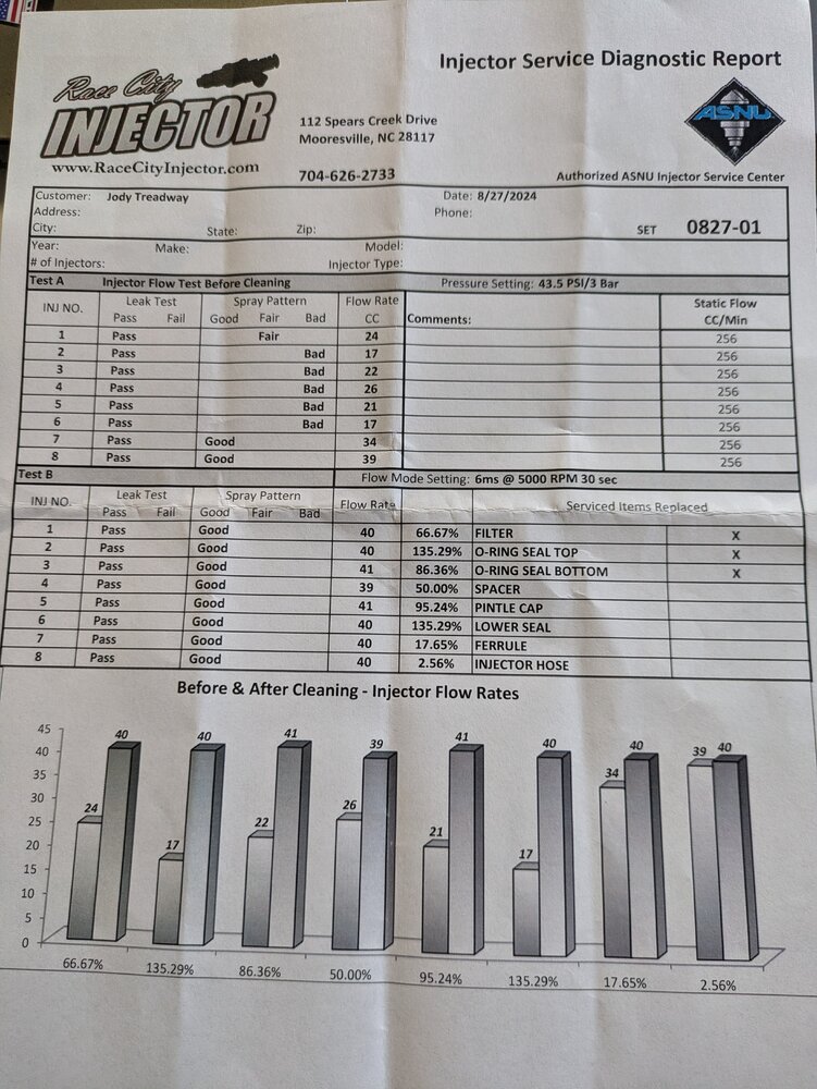

So that brings me to present day. I shipped my PCM off to be rebuilt at Fox Restoration in Locust. Shipped the injectors to Race City for a good cleaning and flow testing.
This all started when I got a bad tank of fuel at Circle K on the way to Gulches back in June. I drained the tank, cleaned filters, etc. But some debris must have gotten in the injectors.

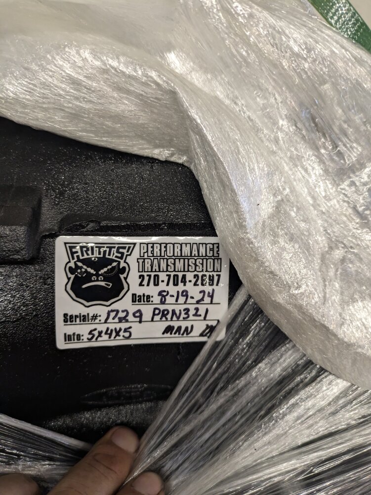

Either way, next week I'll have known good injectors, PCM and my new transmission will be here.
