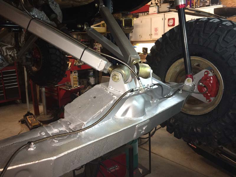

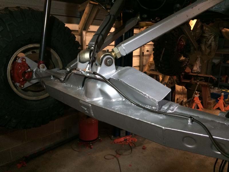

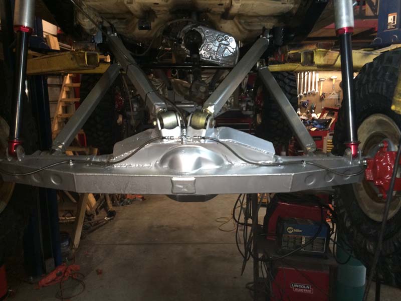

Been working on the trac bar.. got the passenger side done and installed.. also picked up all the new soft brake lines and some tube to finish trac bar.. hope to have all that on and done this weekend
well like a lot of things it takes longer then planned.. had to travel for work a bunch with kept me out of the garage..
but I did get a little time tonight and got the rear brake lines done.
Thanks to @Cperry at ECGS for my new lines

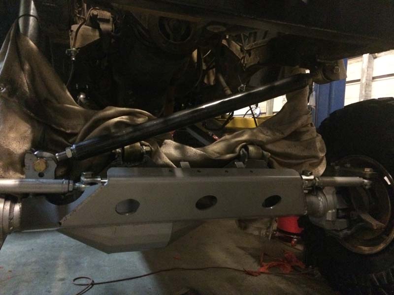

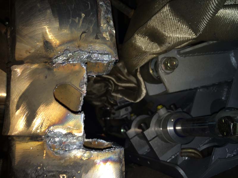

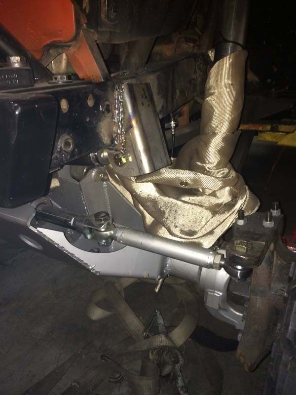

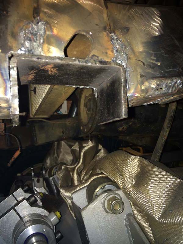

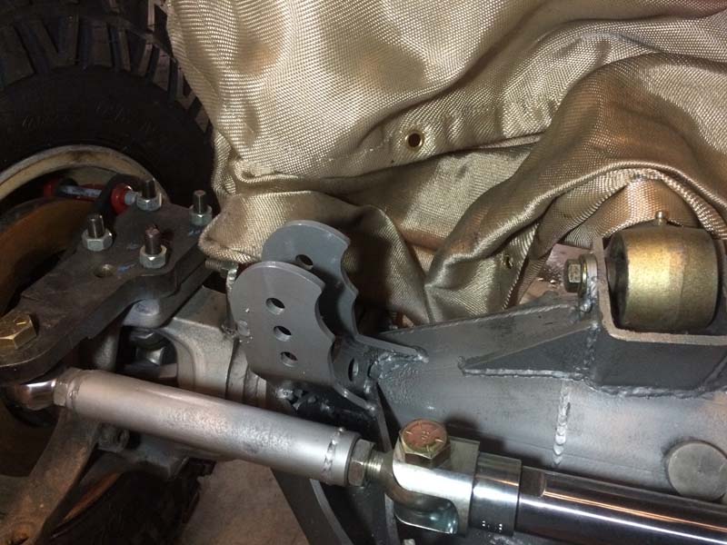

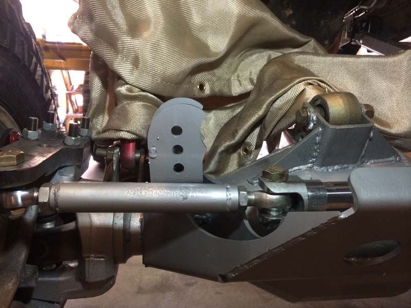

I needed to add a trac bar and I had some parts laying around so I built one with the parts I had and also picked a few to finish it off.. my trac bar is what you would say over kill.. 2" 1/4 wall tube with johnny joint and huge heim on other side..
to get the clearance I needed when flexed I had to cut frame and recess it some into frame. but it all clears by about 1/8" to 1/4" so we are good.

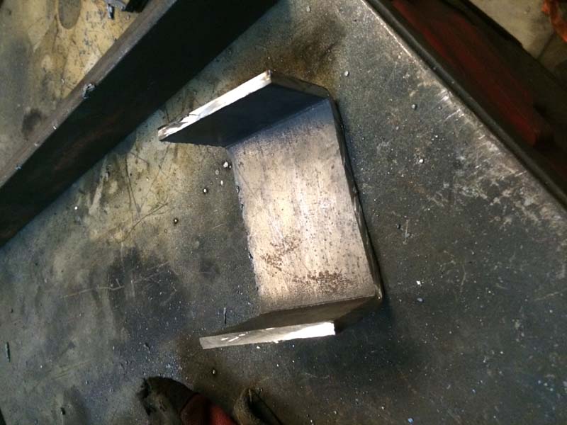

frame notched
piece to fill notch
I did 3 weld passes to make sure it was good and strong on all sides
trac bar in.. I now need to take it off smooth all the grind spots and paint then reinstall and one step closer to driving it

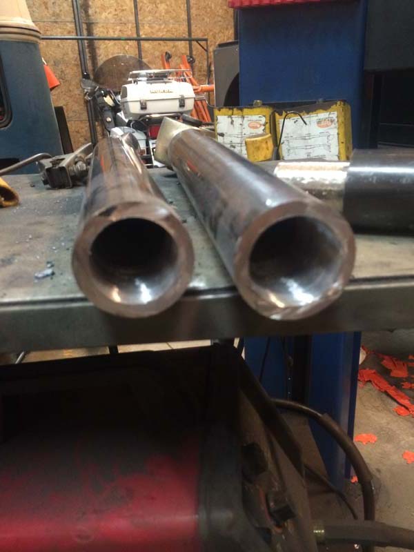

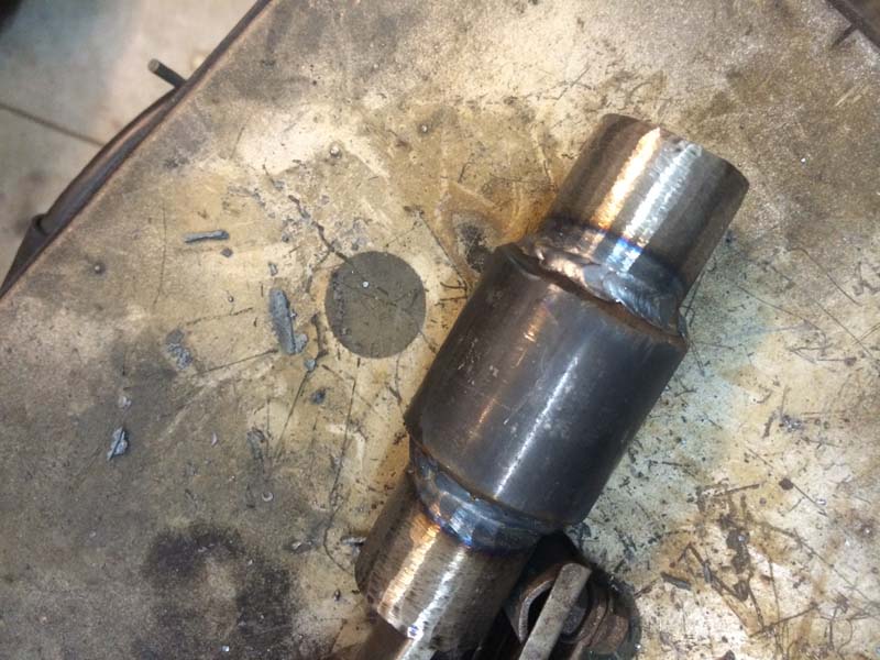

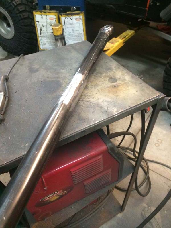

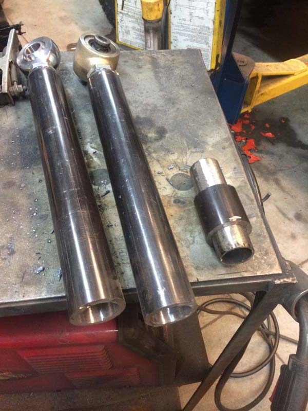

Well I have been know to build things over kill and I guess you can say this is one of those times.. I did it because I had half the parts already so I figure why not save some money and make it even stronger. well then of course I screwed up and did not measure twice I guess because the dang trac bar was short.. so last night I cut it in half and made it longer.. atleast this part I will never have to worry about breaking on me :)
showing cut in half and the sluig and spacer I made
spacer welded to sleeve
showing how overkill this is
all done just need to paint and install
correct in that it will likely never fail, but it would likely be even more strong to have placed the slug near one end.
was going to but I was not 100% if I was going to smooth out welds or leave then and clearance is tight so the center was best option for clearance of other items on axle etc
Since its a two force member, and unlikely to see side loading due to external contact (since it's a panhard tucked above the axle) the only load case that it would matter is buckling... if you managed to get anywhere close to the buckling load for that tube you are doing some crazy shit.

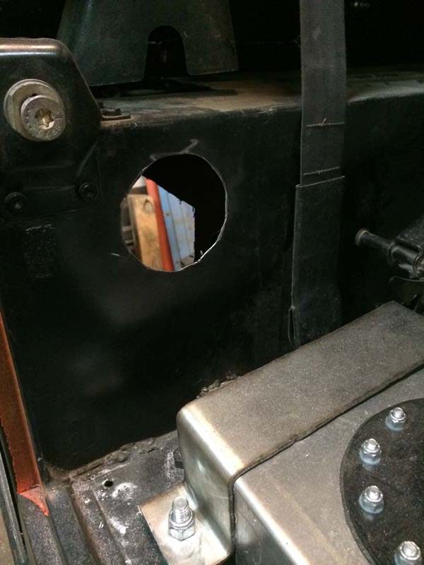

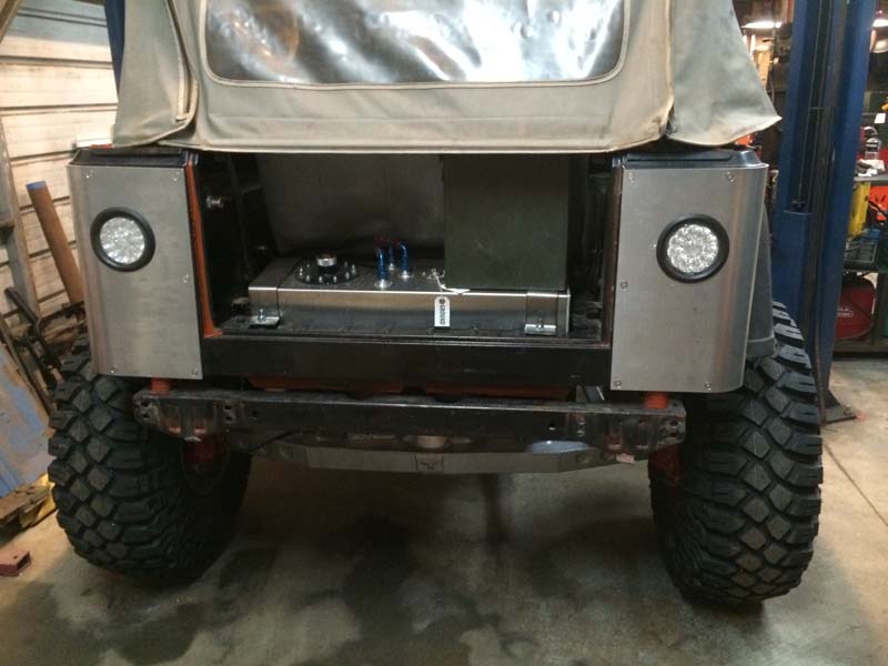

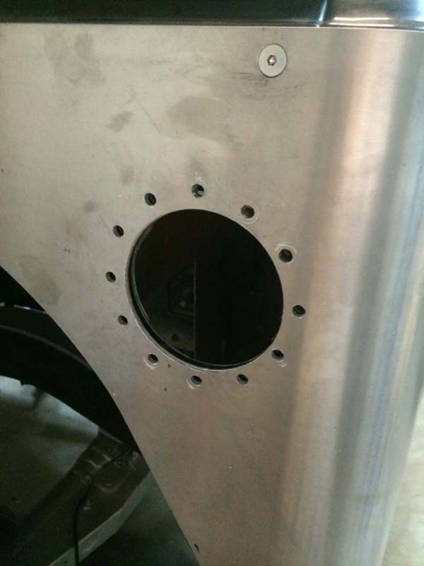

I cut some holes for rear tail lights and also started on the fill neck for the fuel cell so we can fill it up from outside the jeep and not have to open the back every time
tail lights
inside the tub hole for filler neck
from outside

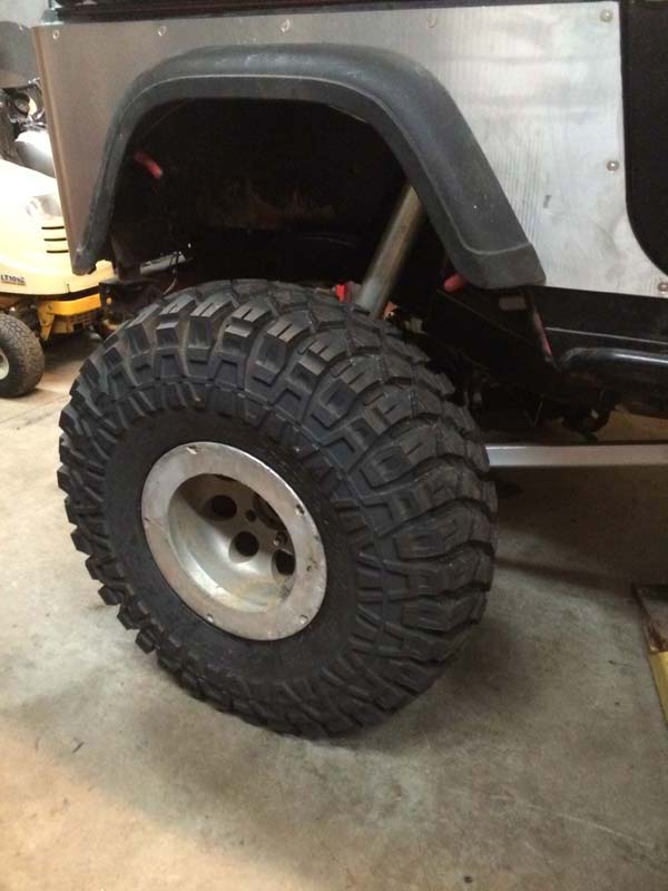

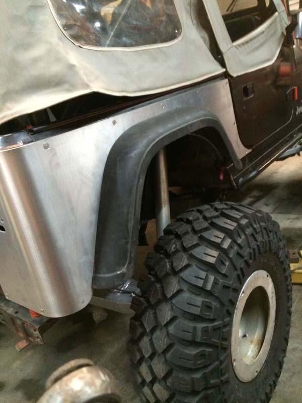

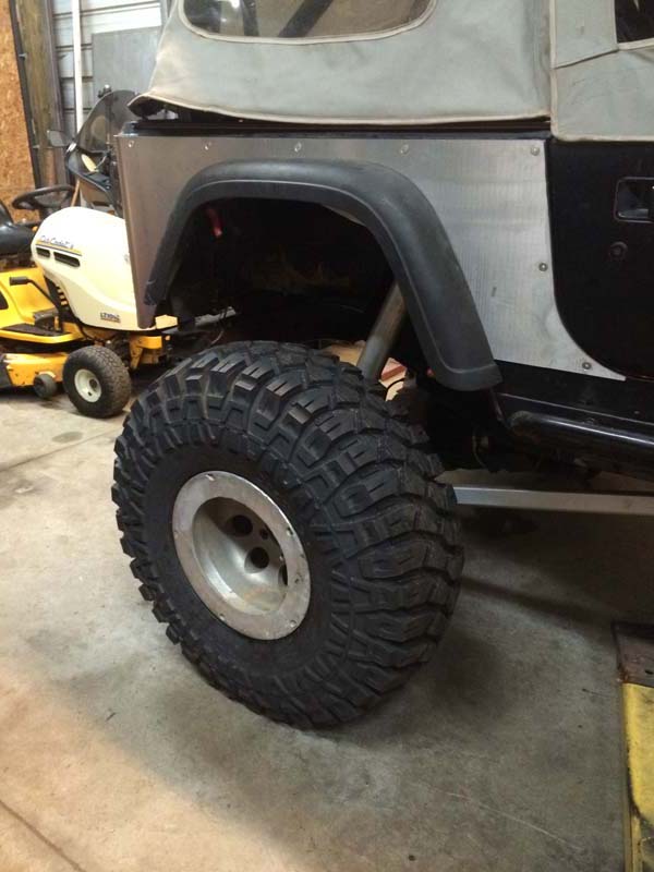

the last thing is I have been trying to decide on a rear fender.. just to help keep a little dirt out of the kids when they are riding in the back seats
so I held up the stock YJ fenders and I think I kind of like them.. what do you guys think?
I know lots have done TJ fenders or even tub fenders but I kind of like the idea of keeping the outside Yj..ish
flares on backwards to get an idea
flares on correct
I like the flares!
