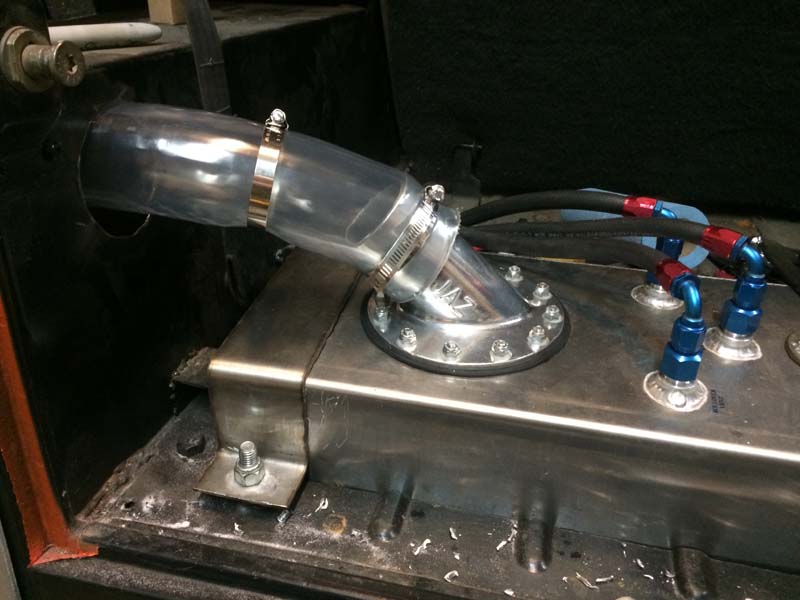

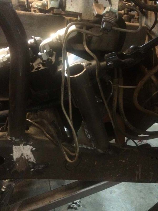

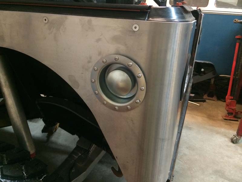

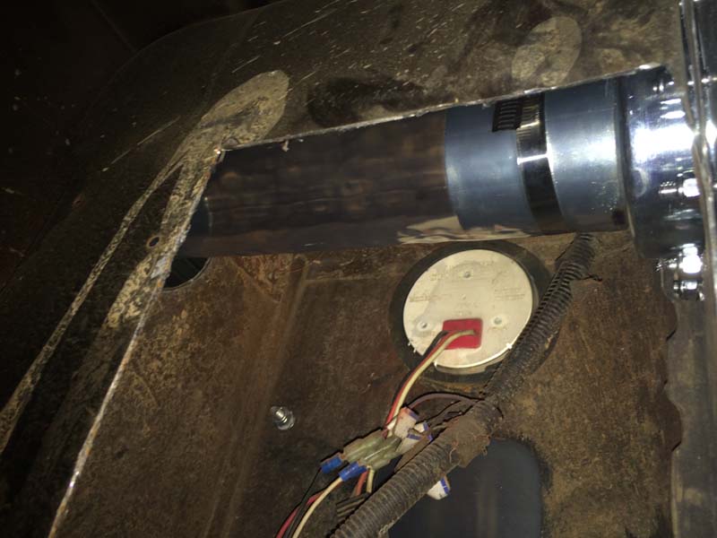

well got the filler tube in place.. the middle clamp is just to see if the crease will come out or not
outside
inside the fender well
That might be too shallow of an angle. That fuel hose will fold up pretty easy as youve noticed.
ya I will mess with it and get it to work some how.. may need an aluminum sleeve on outside and clamp to keep it round and not let the hose fold up

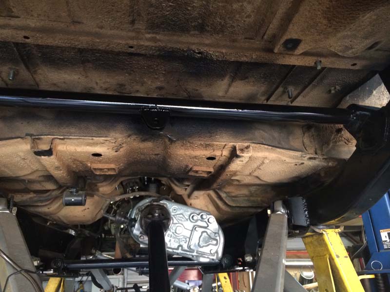

I also bent up some tub and made my shock tower brace and got that in.. so once the rest of my PSC stuff shows up I will get that on ASAP and after that it is all down hill :)

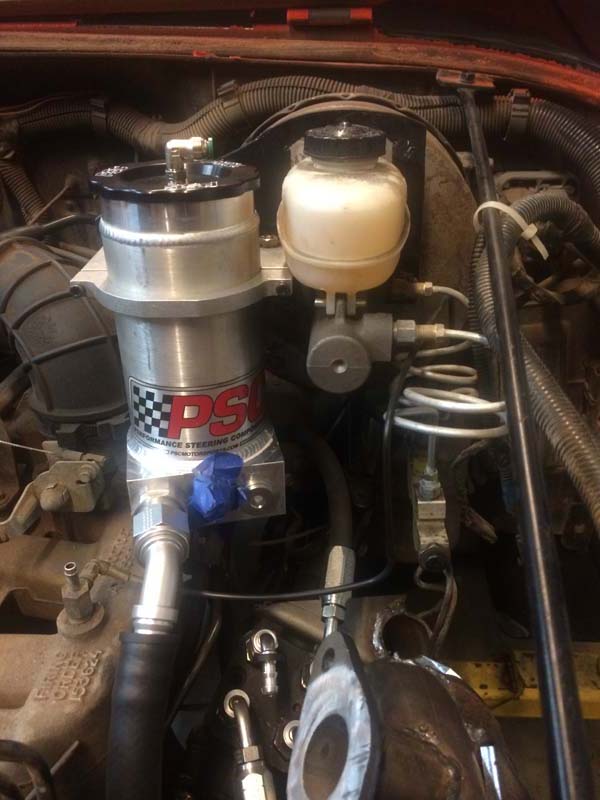

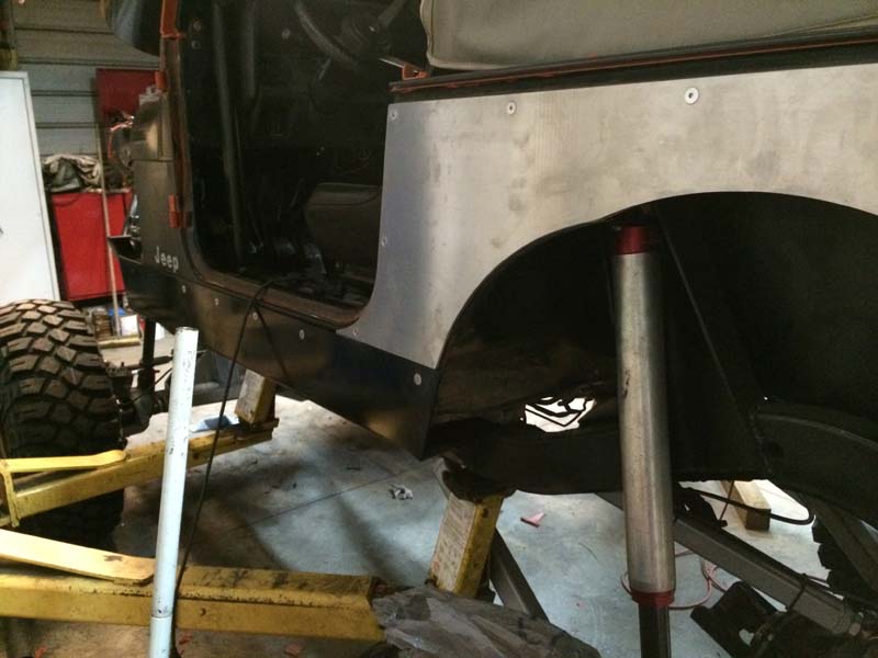

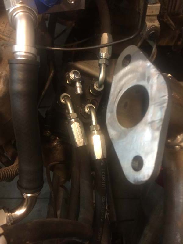

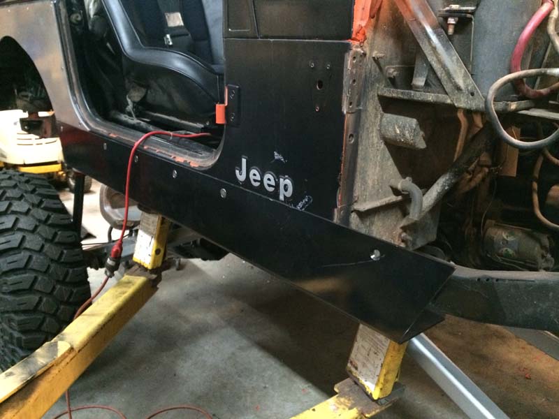

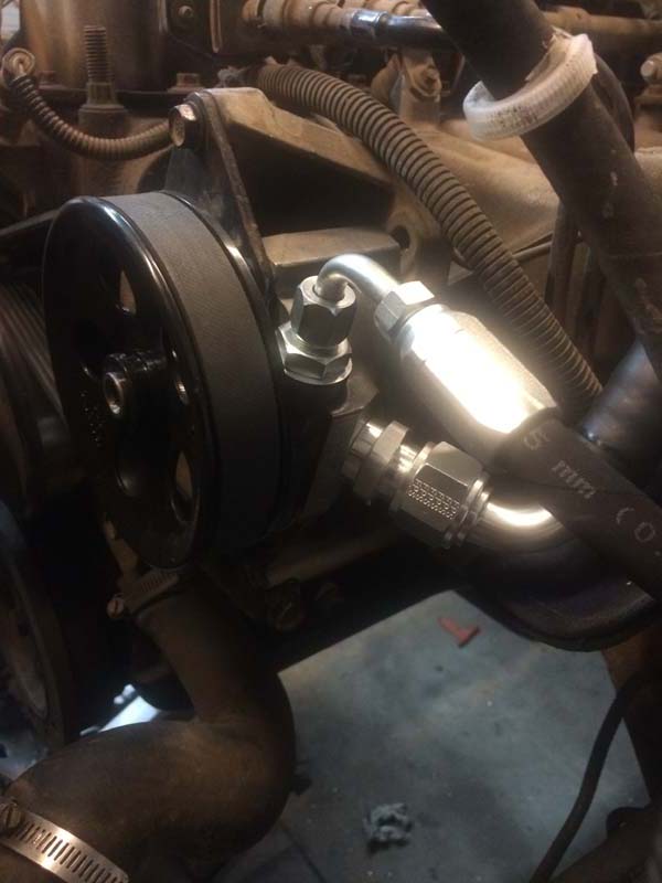

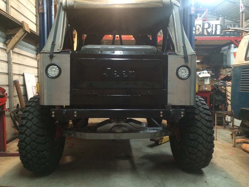

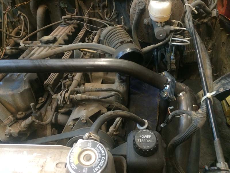

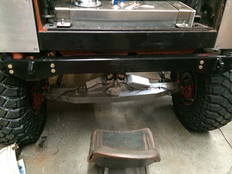

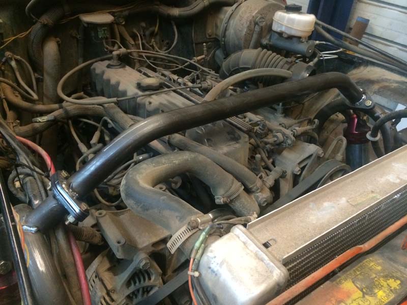

We got rock rails on, rear bumper on, Transfer case shifter mount made. Shock tower support tabs made and tacked on. New power steering pump installed. Reservoir pump bracket made and reservoir mounted. All hydro lines made and on except the line to cooler And brace that goes from shock tower to tower cut and painted ready to go on.
Next is to finish the Welding and paint everything fill fluids the. Start making driveshafts.
Making progress
new pump
orbital
Reservoir
orbital mount ( ned to fix brake lines)
rock rail
rear bumper

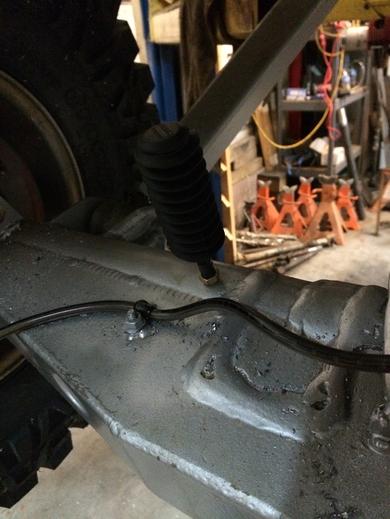

here is rear breather installed
I also finished the power steering line install and I started bleeding the steering system, so much I made a mess of fluid on the floor.. oops

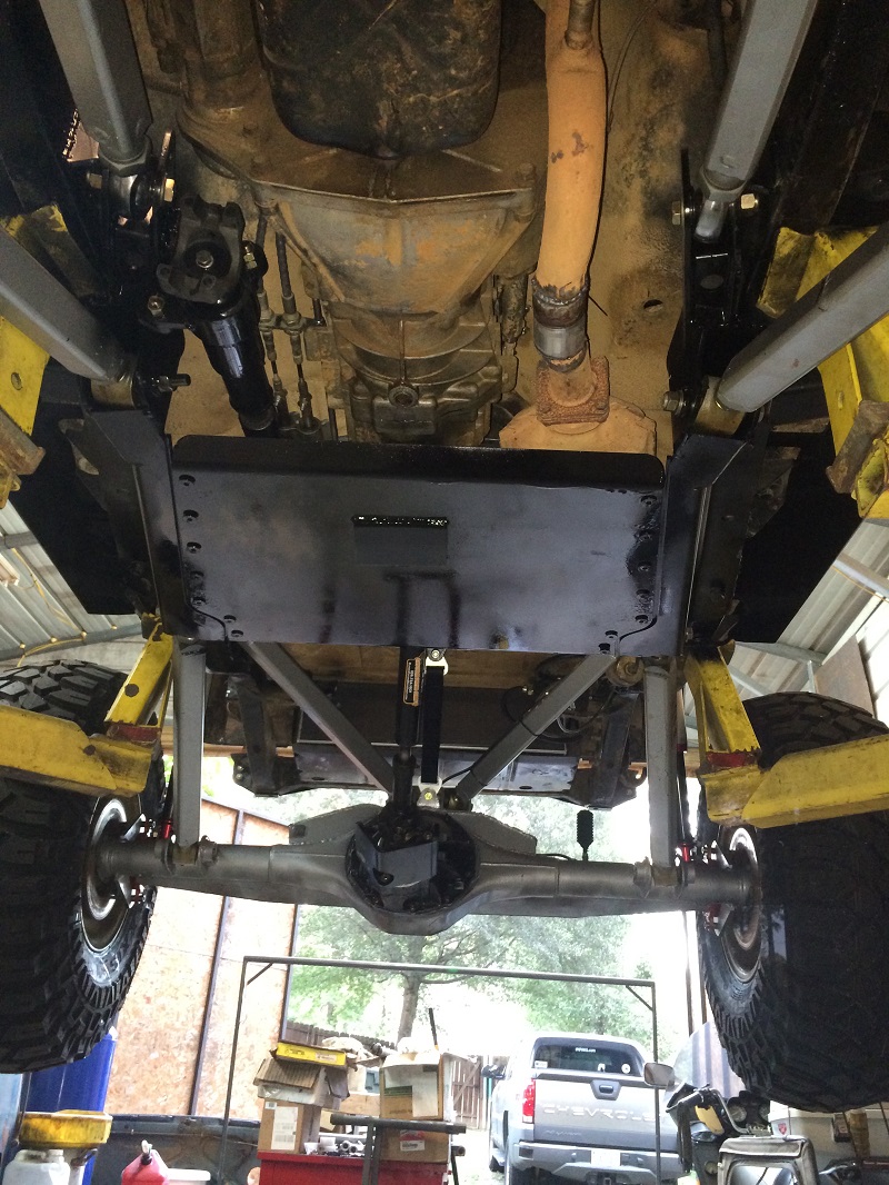

Well axles are filled with fluid and both breathers are in.
Dana 300 seal replaced and filled the 300 with fluid.
Tighten all bolts on rear of jeep.
Finished the gas tank filler neck.

- I finally got all the correct bolts for control arms, shocks, etc and they are all in and tightened down.
- front fenders are back on
- tires are on with all lugs nuts finally
- installed air cleaner
- got my rear drive shaft back ( I learned to make sure you measure twice.. I told the driver shaft place exactly 1 inch to long.. so I had to cut it up and shorten it.. I bet it is not balanced anymore )
- added rear frame brace for limit strap ( rear has way to much droop for the shaft )

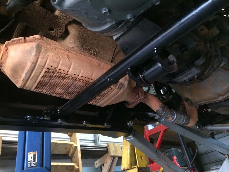

- welded in exhaust cat, which will be enough for this trip
and I am happy to say I moved the jeep 3 feet forward and backwards and then I learned my brakes SUCK.. so I am gonna replace the master with dodge 1 tom to see if that helps

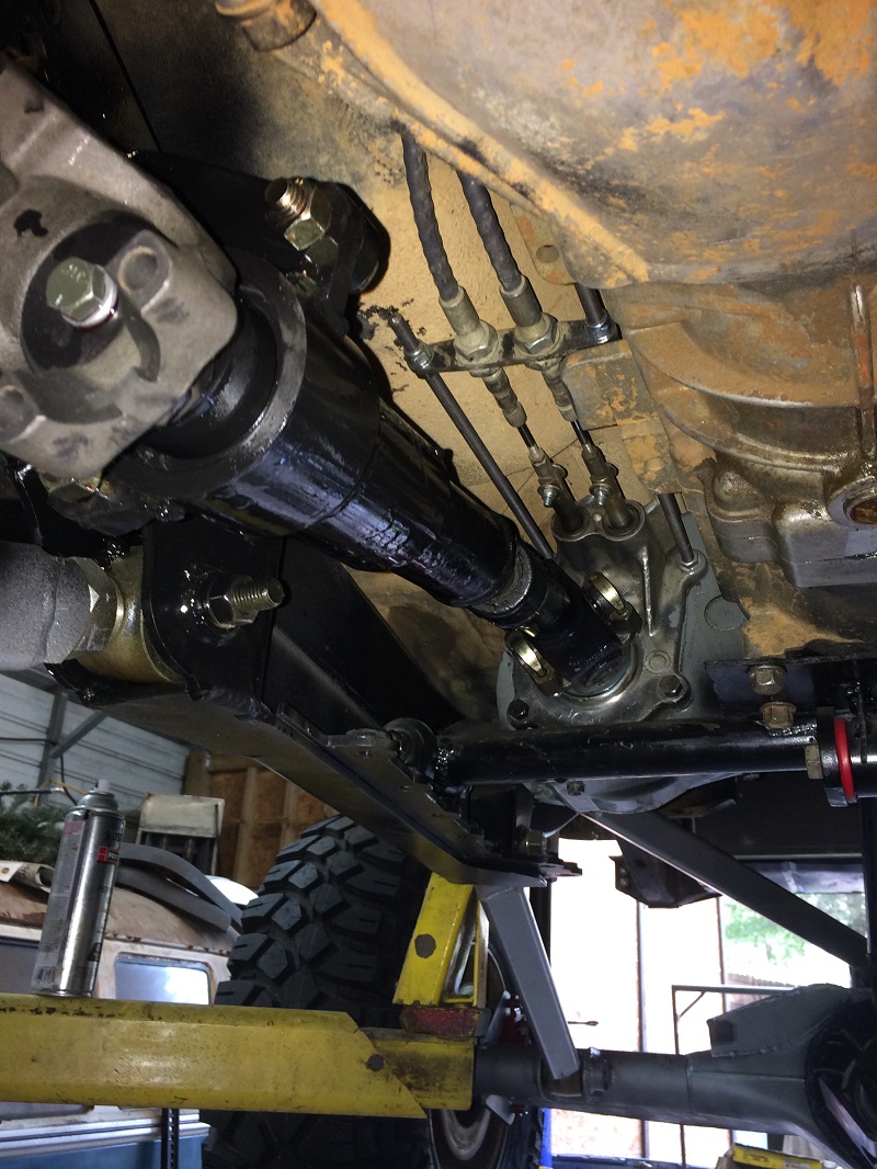

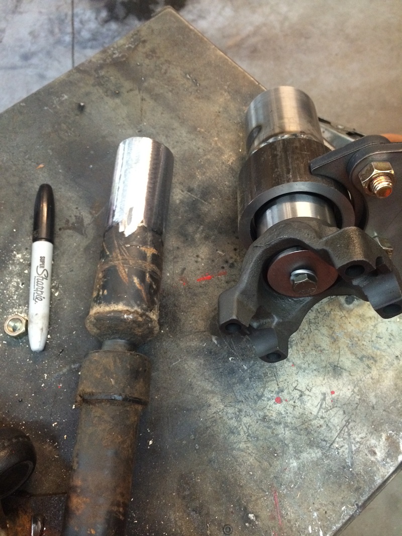

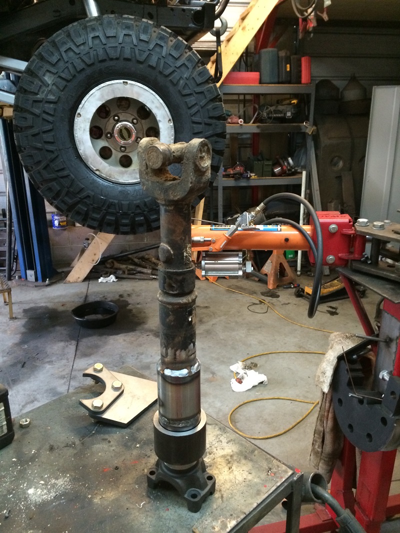

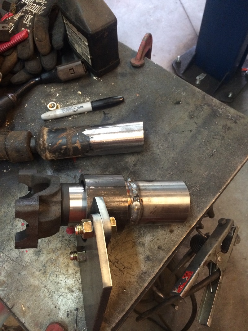

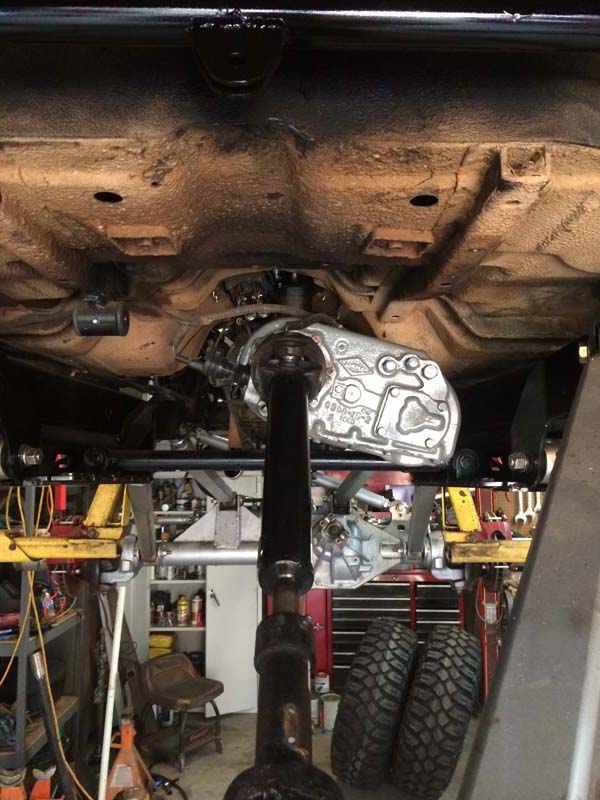

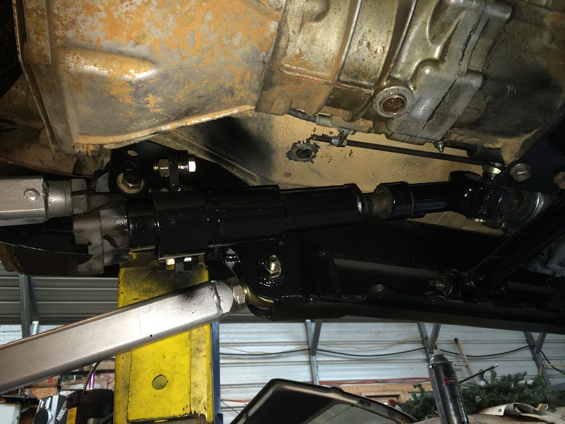

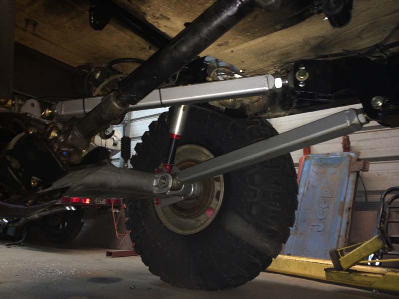

ordered a two piece bearing kit from wide open and make the first driveshaft, not the prettiest but it is straight and works great
took and old shaft I had and cut it down. I also sent the yoke to east coast gear supply and they machined it down to fit inside a 2" tube.. fit perfect
here is shaft all welded up

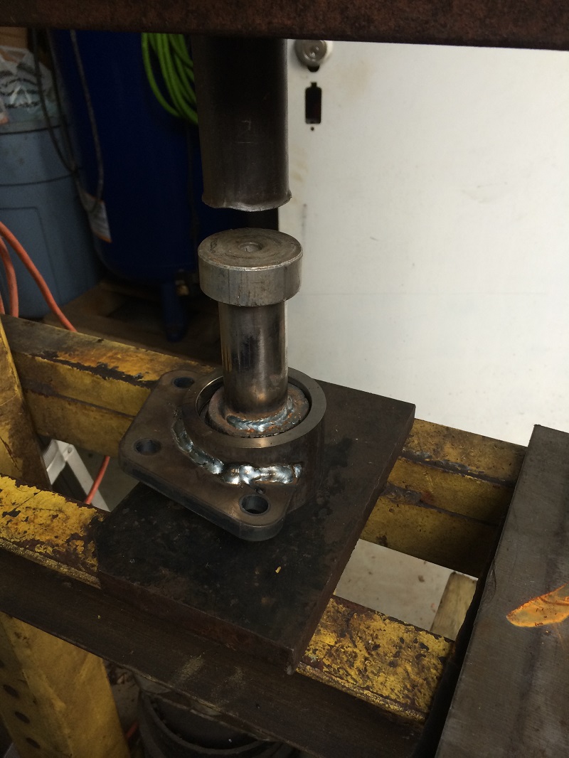

had to press out bearing so I could weld the bracket on and then press it all back together.
here is shaft installed

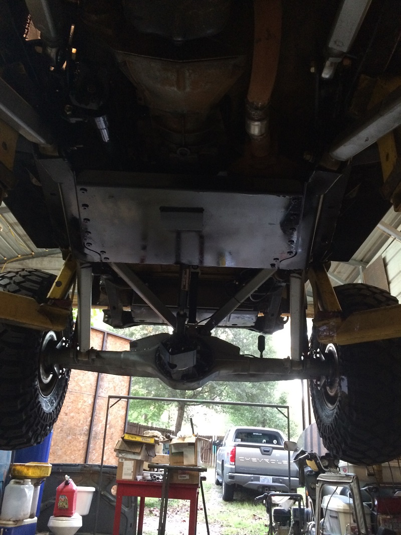

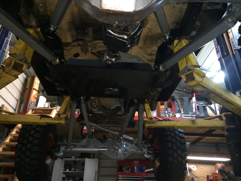

after that I installed the moto bilt skid plate so it is ready to rock
Poke a pin hole in top off that thing, they will blow out axle seals.
Looking good. Looks like the yoke worked out.
with out your help with these driveshafts parts I would be up a creek
thanks

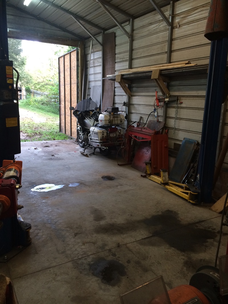

so great day when you finally get to drive it around the block
and when the shop is finally empty even better

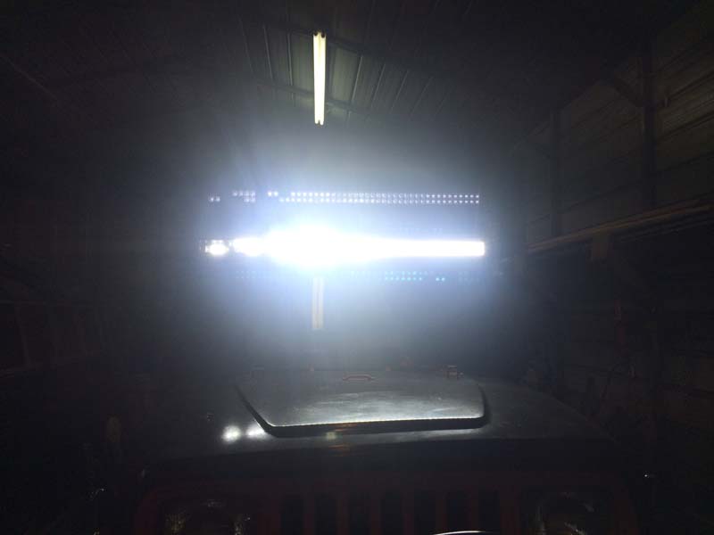

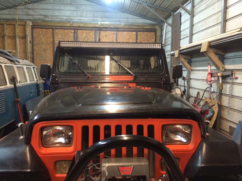

Well now I waiting on some parts for this weekends first trail ride.. so I figured why not wire up some stuff.. so I started wiring up the ARB compressor and also the 50" light bar I had.
here is light bar mounted

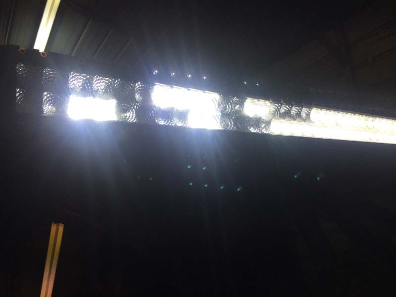

and what a pissser.. it has some lights that dont work :(
well good news is I started jeep to get full 12 volt power and all the lights work now.. thanks to Dan @motobilt for the heads up

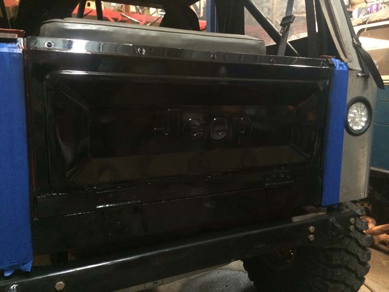

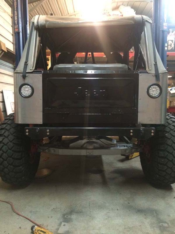

I took an old rusty CJ tailgate, cut the rust off the bottom and welded up a new bottom and back bracing and put it on YJ tonight.. I am happy with it
and yes it opens and has a cable to keep it flat when open to make lunch sandwiches for the kids
